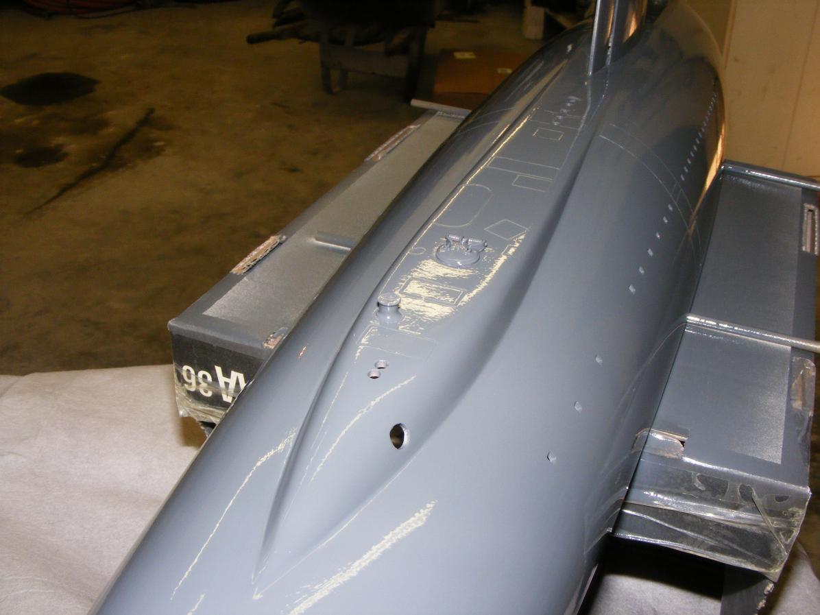

      #287
      Increase the 'crease' between turtle-back and hull. Scribe a line in there.
      The vertical line on the sail at the trailing edge -- just before the leading edge of the dorsal rudder -- and the trailing edge of the dorsal rudder are not straight lines. Fix them. I can't see it, but I bet you also buggered up the leading edge of the sail too!
      Start using a sanding block damit! You're rounding off corners. You're free-handing it with the sandpaper, aren't you, race-boat-boy!?.....

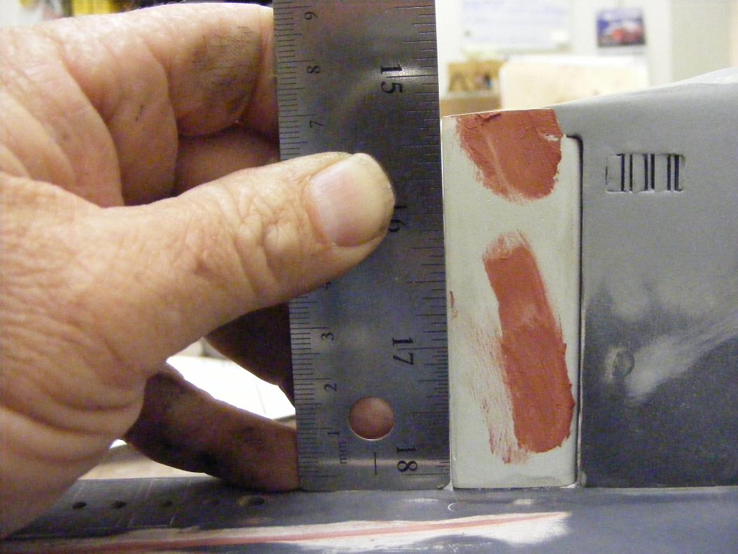

        #288
        OK Dave, thanks for the feedback.

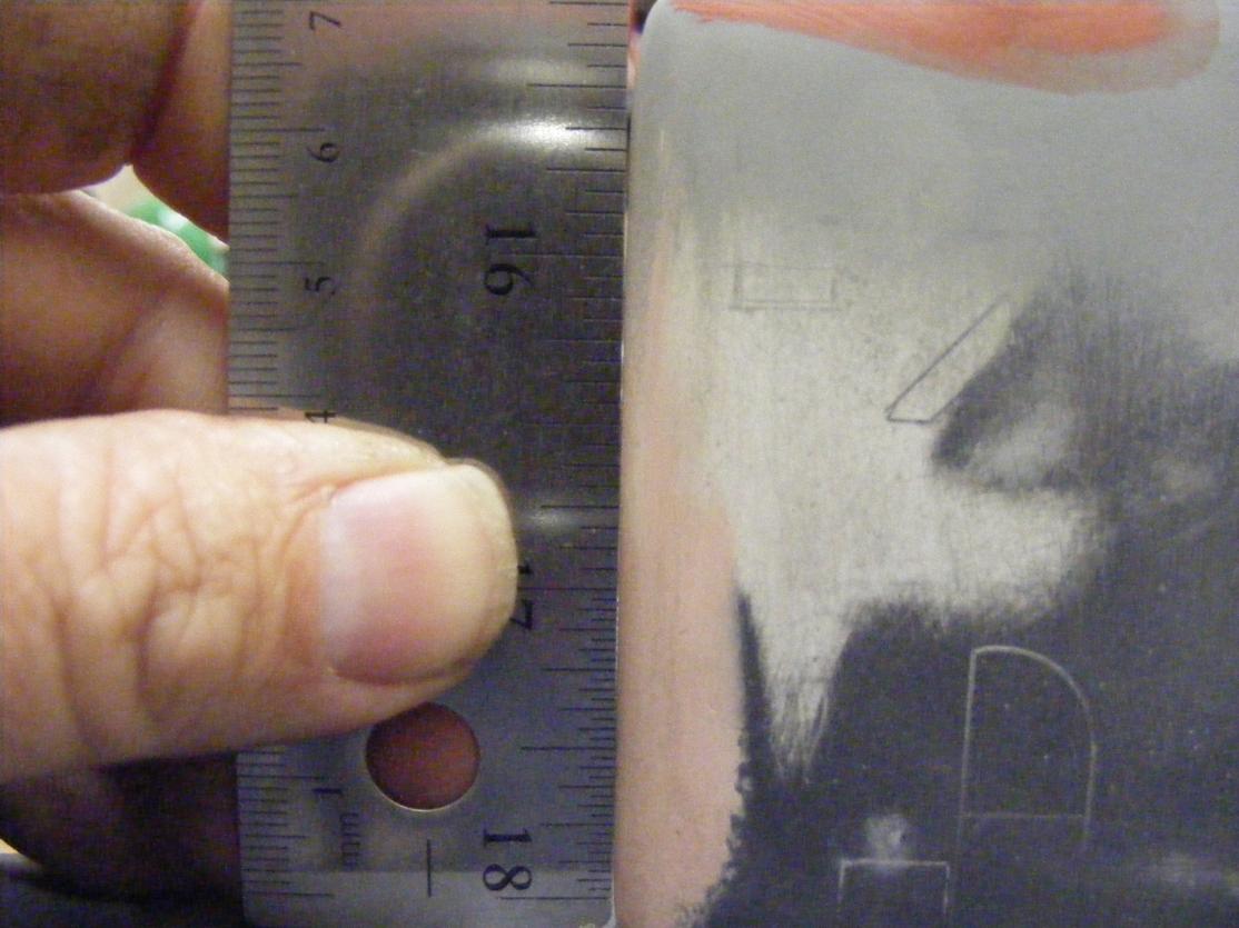

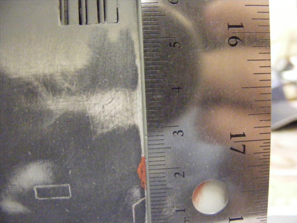

          #289

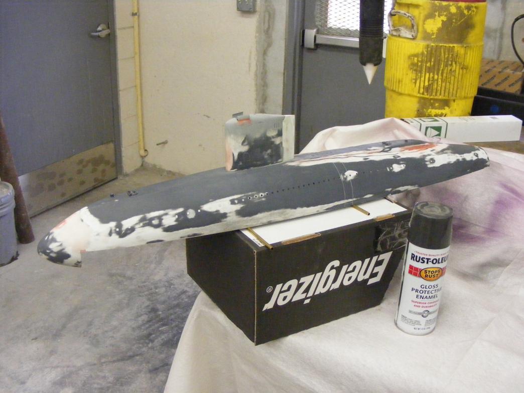

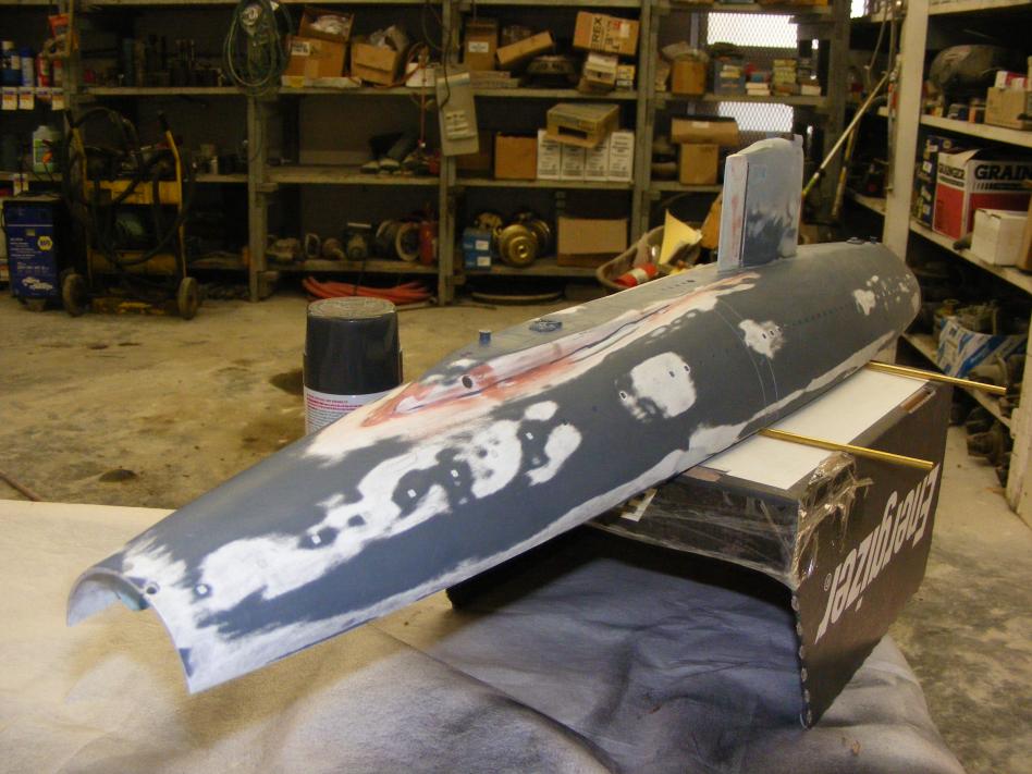

          The first picture is a end view of my sanding block for getting into tight places. Its a brass tube wrapped with sandpaper. I used it to sand the turtleback where it joins the deck. I will, however score the joint lightly with a scribing tool. I put a straight edge along the edges that you refer to. Using the straight edge they look pretty close.

            #290
            Not perfect by any means but not bad.

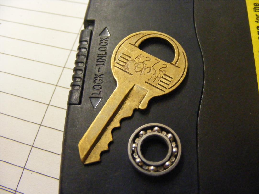

                      #295

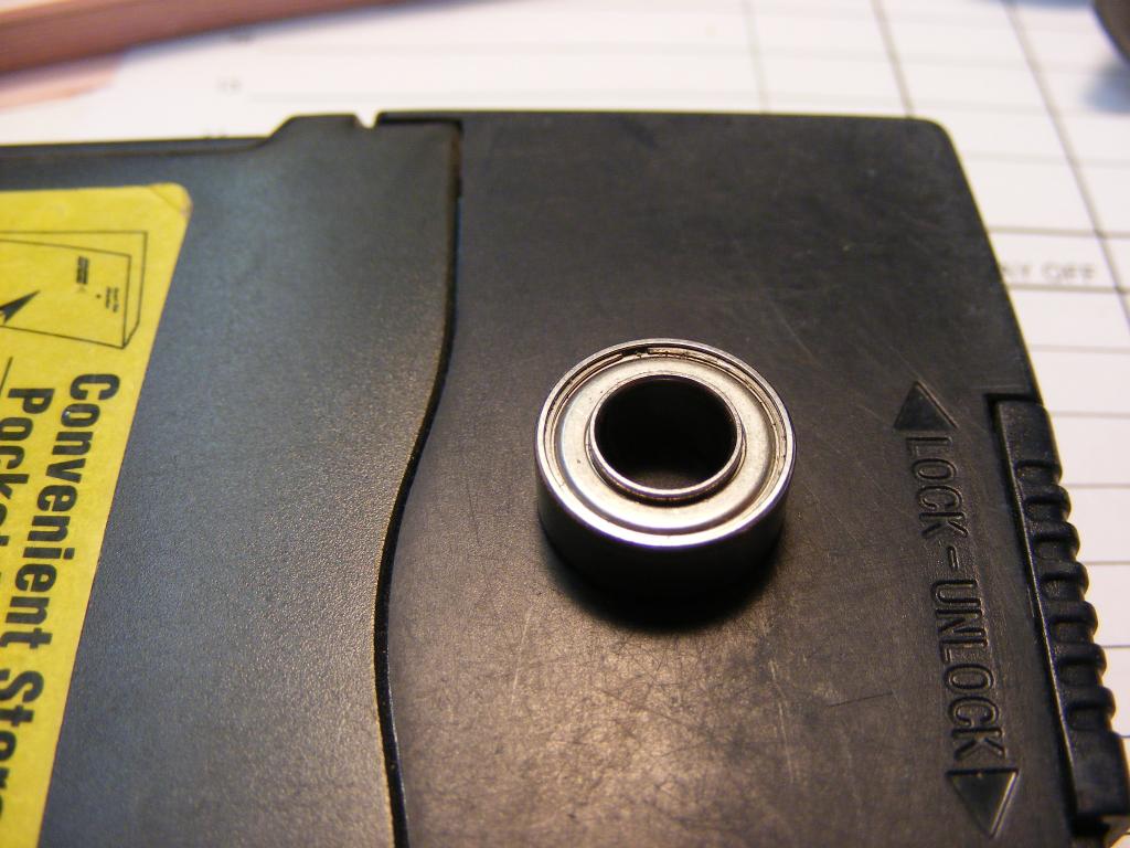

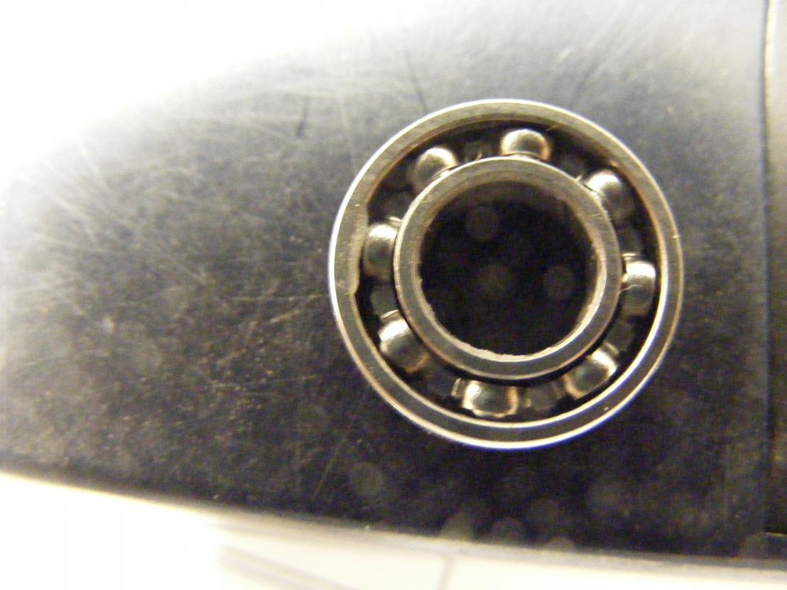

                      Going back to the Duo-prop setup. I decided that I dont like the rear most bearing. Its sealed. In the past I have removed the seal flashing from the bearing. This one you cant remove the flashing. Im afraid water will get in and you will have no way to flush it. With an open Stainless Steel bearing you can flush it before and after entering the water. The first picture is of the sealed bearing and the next ones are the new open bearings.
ID:	67705Click image for larger version
ID:	67706Click image for larger version

                        #296
                        I'm with you. Just hit it with some air to blow out the water, then splash on some oil after each use and you're good to go.

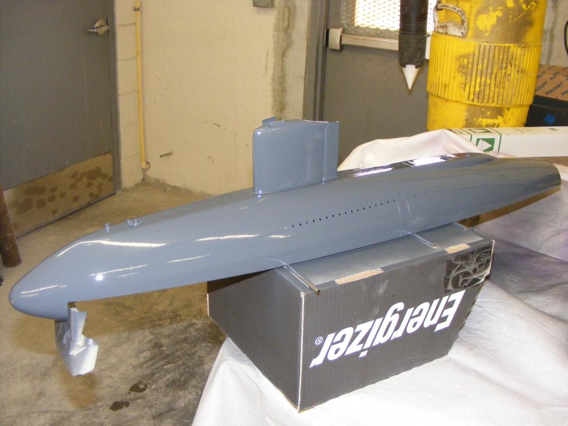

                          Lets get some paint on this thing........tonight.
                            #298

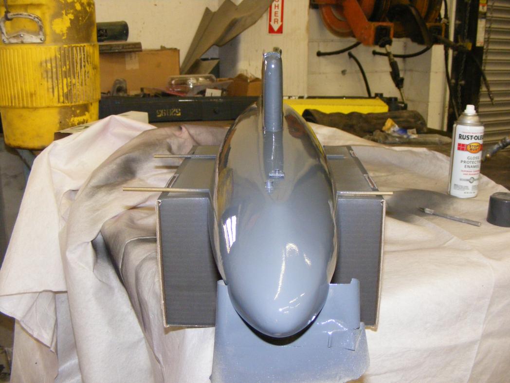

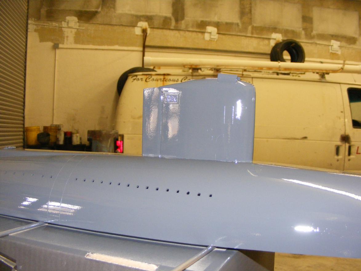

                            OK, before and after. Its still wet. We will see after it dries to see what color we will have.

                              #299
                              It looks a little more grey than I wanted.
                                • 3757
                                #300
                                Wow, what a difference some paint makes! Great work Mark!
