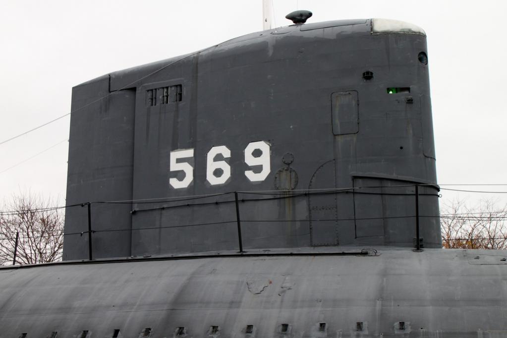

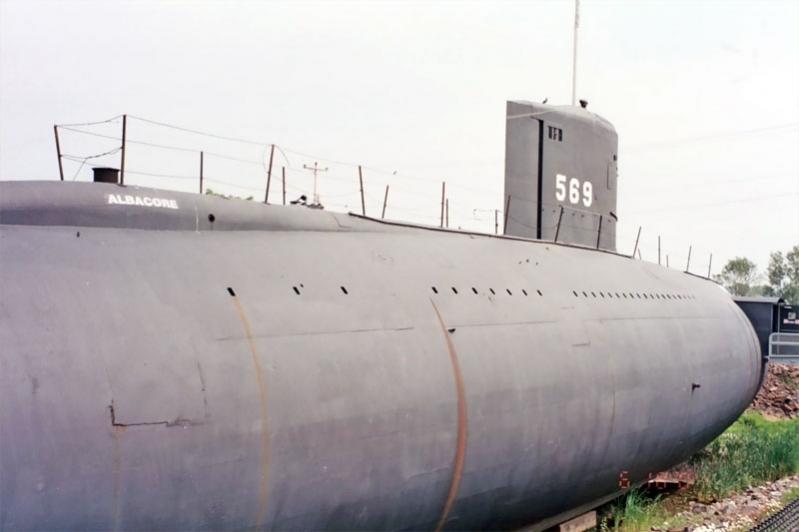

      Note these two pictures. Im trying to establish color for painting purposes. If these pictures are anywhere near accurate then I would say that its almost a dead ringer for Testors "Panzer Grey", which is what I used last time. However Im looking for a upgrade in the quality of paint. Anyone have a comment on the color of this sub?

        #138
        I mean..............its certainly not black......................right?
          • 14010
          #139
          No. Unless you want the bleached black of an old, poorly maintained museum boat left out in the elements!
          Black, slightly doped with white, to get a very, very dark gray. That's what you want for a scale model of a reasonably well maintained American post-war submarine in SubLant scheme. Actual 'color' is black, but you bleach it out a tad for 'scale effect'.
          I have Spoken!
            #140
            Well then, its looking more and more like "Rustoleums" Charcoal Grey, without the flat coat. Its darker than what I have on there now and it fits the description of Dark, Dark, grey. Yeah, Im still stuck in the rattle can mode.

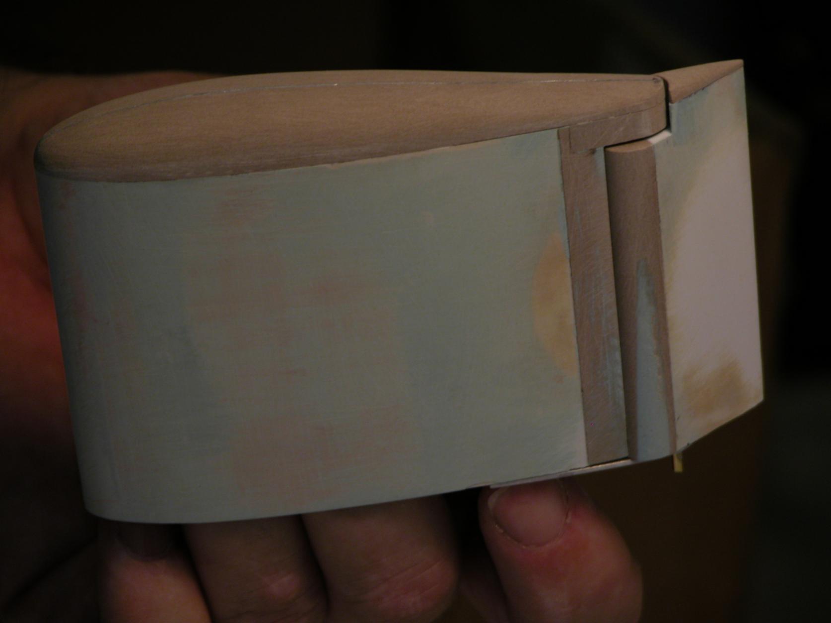

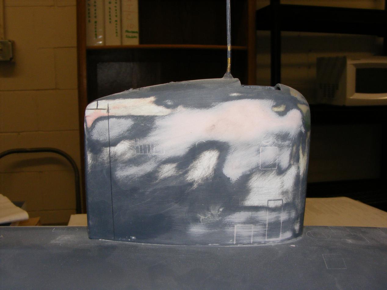

                        A couple of closeups.

                          #147

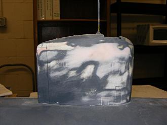

                          My trigger finger is getting itchy! ONWARD ever Onward! I have been unable to secure a sail drawing for my Albacore so we will make due with good old fashion seat of the pants calculations and sipherin(as Jethro would say). I have a drawing on my computer so I measured overall length of the hull and sail and converted the sails length(on screen) to the hulls length(on screen) as a percentage and converted it to a measurement using the Subtek Albacores hull length as a reference. The drawing must be off because it would make the sail too long. So , since "The One Who Must Not Be Named" is so fastidiously accurate with his creations Ill use his picture of his sail as a visual aid in further progress.
ID:	65941Click image for larger version
ID:	65942 If you compare his modified sail to mine I think that you can just make out that the top of his sail has less slope than my unmodified sail. Therefore Im going to build up the top of my sail with some JB weld first to reduce the slope and then some easy sand on top of that to recreate the bump. Then when the top appears satisfactory we will cut off the back of the sail and add a rudder that I will make out of sheet plastic.
