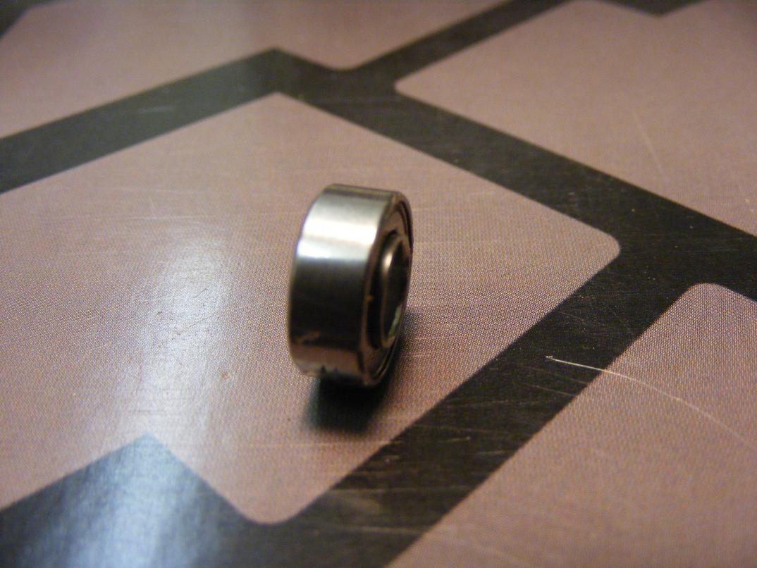

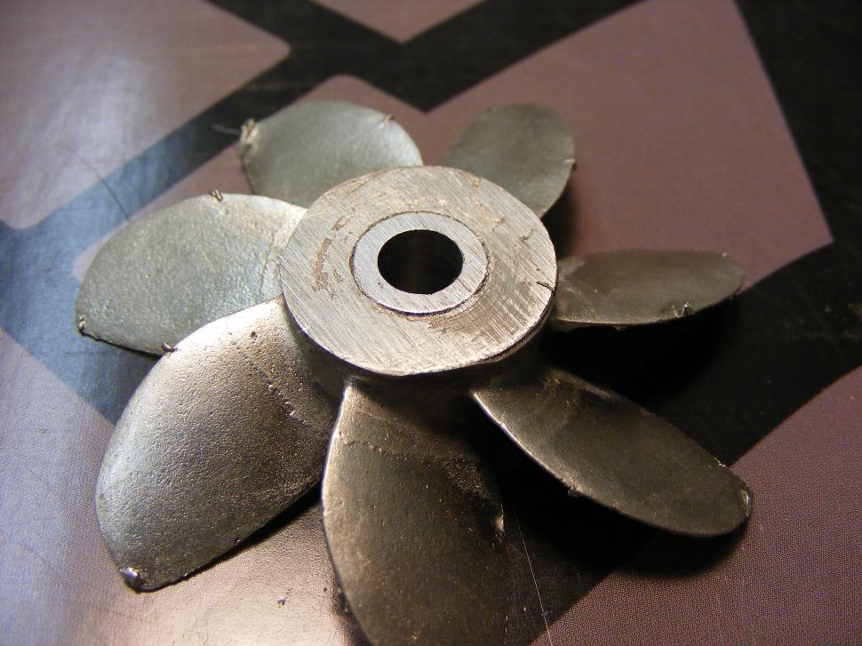

    Since I have no machine tools , I sent one of the propellors to my favorite machine shop to have a bushing installed. He did a perfect job. One of the benefits to it is that now that thick walled bushing will run right against the extended race of the rear bearing, absorbing all of the thrust load.
ID:	65254Click image for larger version

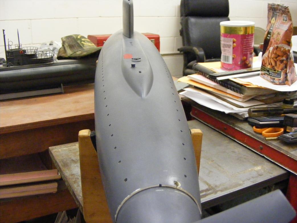

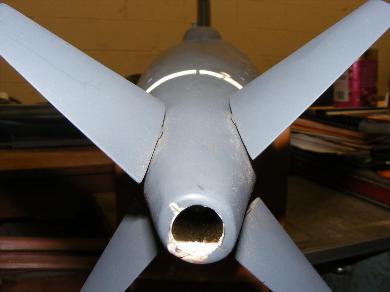

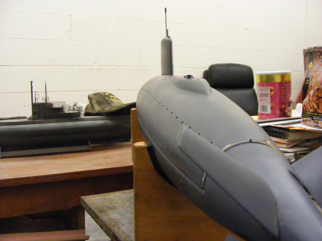

      Here are a few more quick shots taken at the same time.
ID:	65256Click image for larger version
ID:	65257Click image for larger version

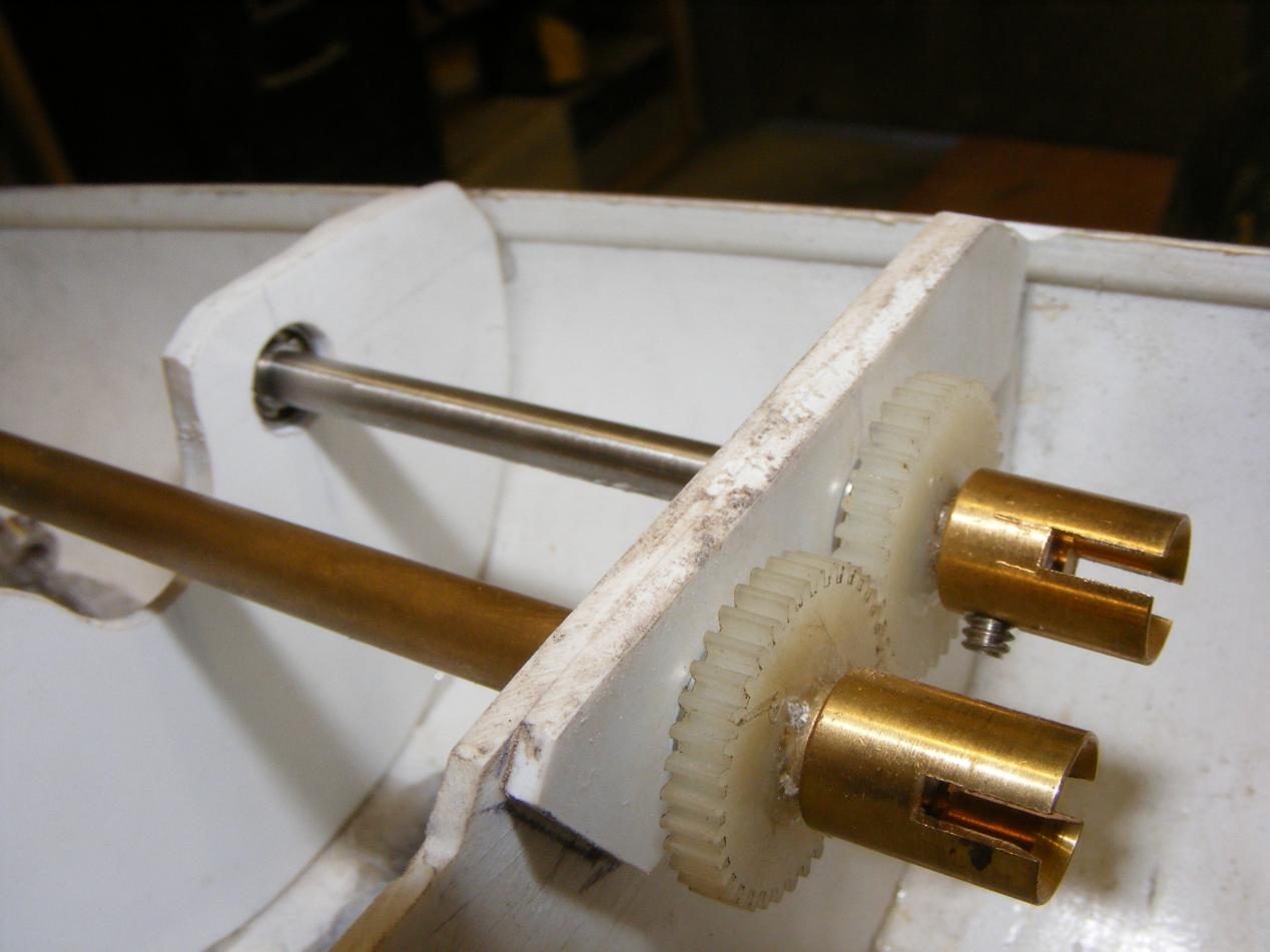

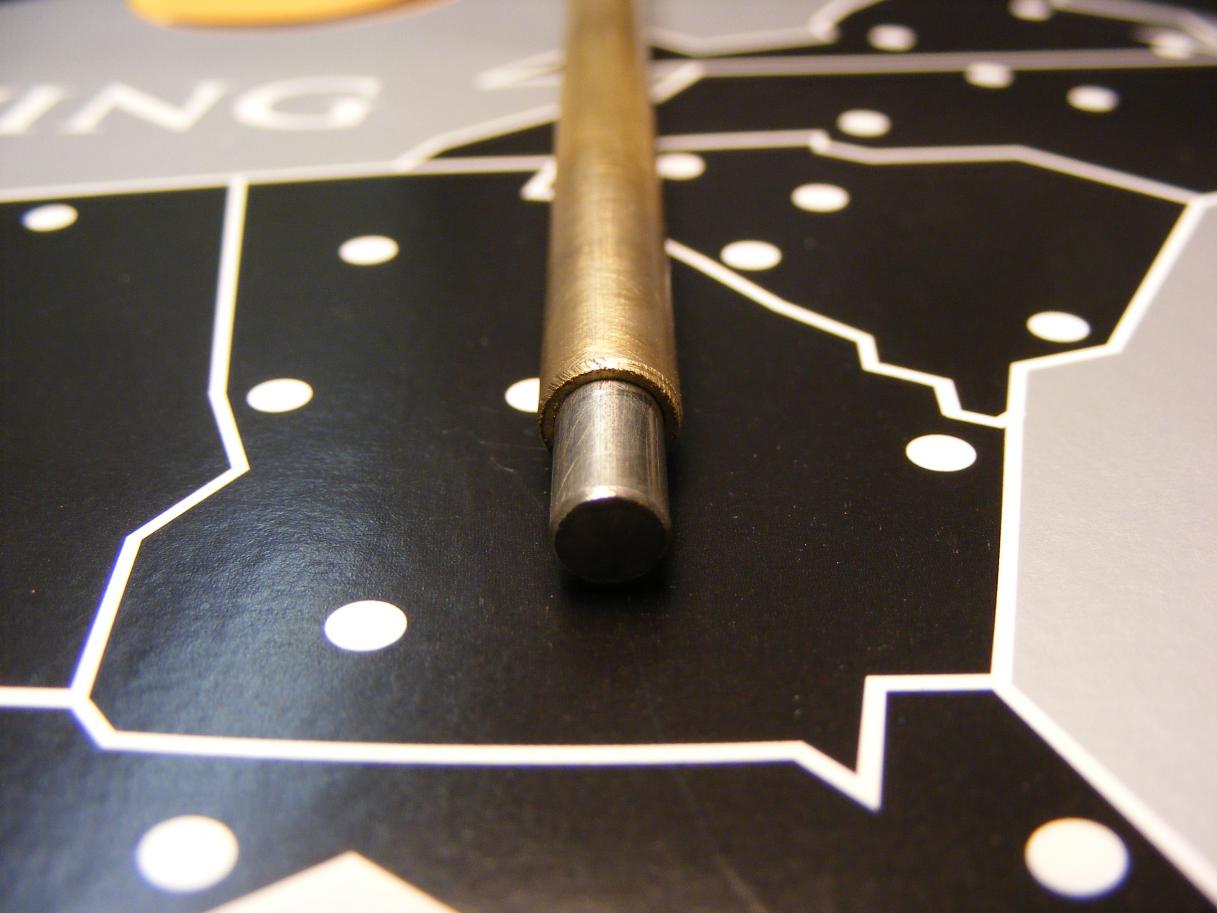

          Problem: The first propellor must be attached to the tube shaft. At the point of attachment it is two tube thicknesses thick. Inside of that spins the 3/16" S.S. shaft. If you were to tighten up a normal set screw you would crush or deform the tube causing drag and still not have a reliable connection. How do you do it?
          Answer: You drill down thru both sections of tube and use one of these special set screws with a small extended tip. That way, after blue loctiting the set screw you have a positive conn. without binding. Im going to do it in two places. I dont want to lose this prop!
ID:	65290Click image for larger version

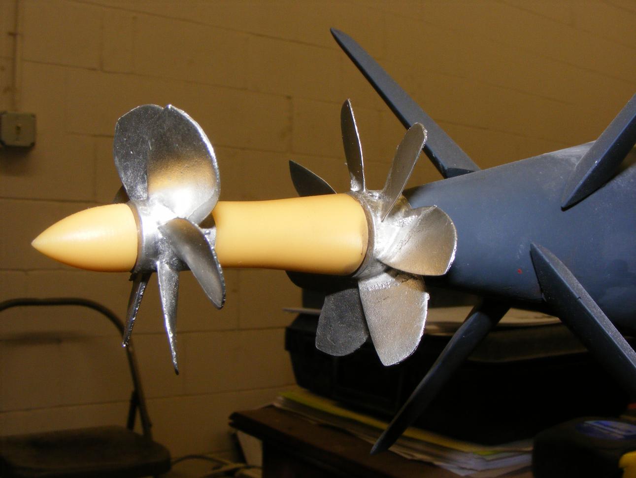

            I just reached the point where I could slide all the parts together for a test fit. SO FAR..........SO GOOD!

              Notice the paint scheme for the props.

                The props will of course, have to be cleaned up and then plated with the Cawell nickel plating system. That should change their color drastically I would think.

                                Alright, here is a step by step picture rendition of how the drive goes together.
ID:	65485Here you can see the two shafts installed and the nearest shaft is made up of the tube shaft and inside of it is the S.S. 3/16" shaft now properly cut to length. On the end of this S.S. shaft you can see mounted the brass drive dog.
