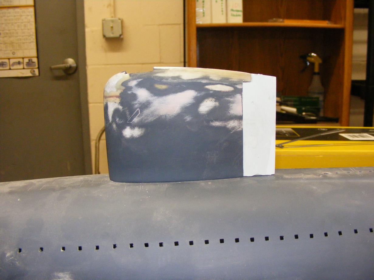

    In the bottom picture you can make out the anchor door as well as various bumps and bruises.

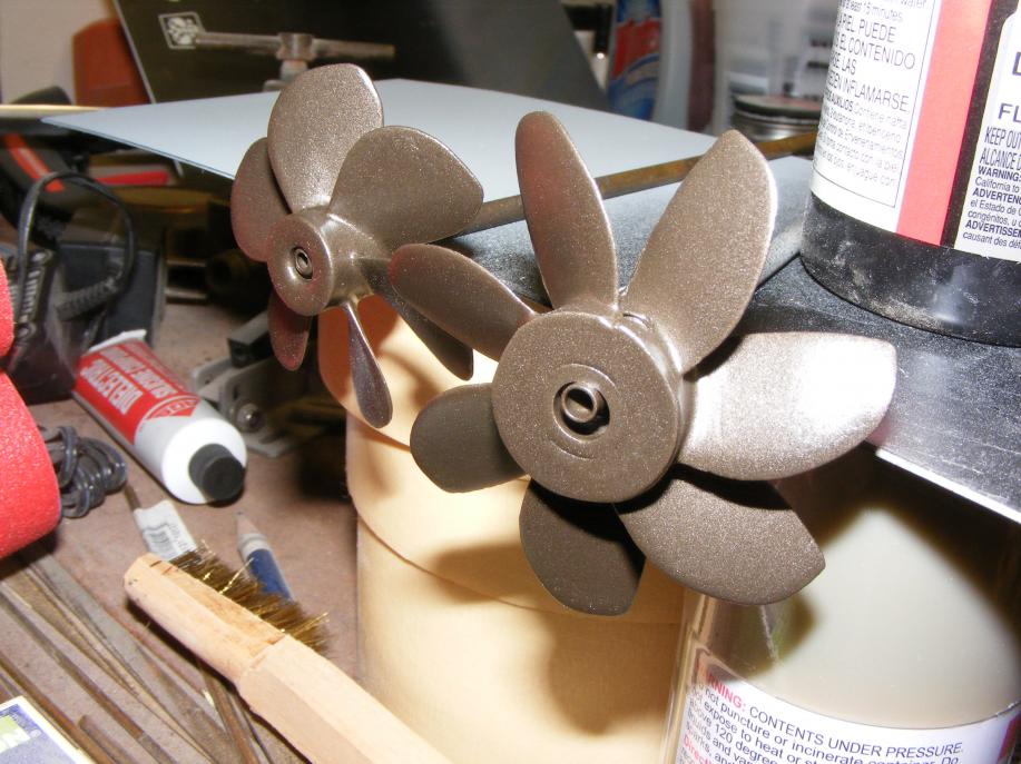

      Work continues on the sail and its rudder. At the same time I elected to get some paint on the props. As you recall, I Nickel plated the props for the purpose of adding strength. My next step was to sand them down with 400 paper and shoot them with automotive grey primer and then a Bronze color. Its drying as we speak. To top it off Im coating it after that with a epoxy clear flat. Ill post pictures when the paint has dried.

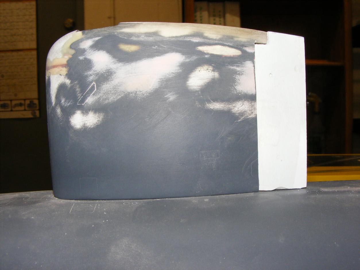

        Heres some " under construction" shots, just to let you guys know that Im not sloughing off. Next, the periscope and masts and bridge doors.

            I think those props came out real nice! They have a solid look to them and i like your technique to get them to that point.
            Peace,

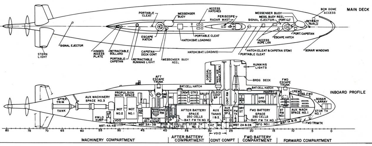

              Just recieved this from John Maier at Albacore park. It helps a little bit with the Mast problem. Ill keep at him for more.

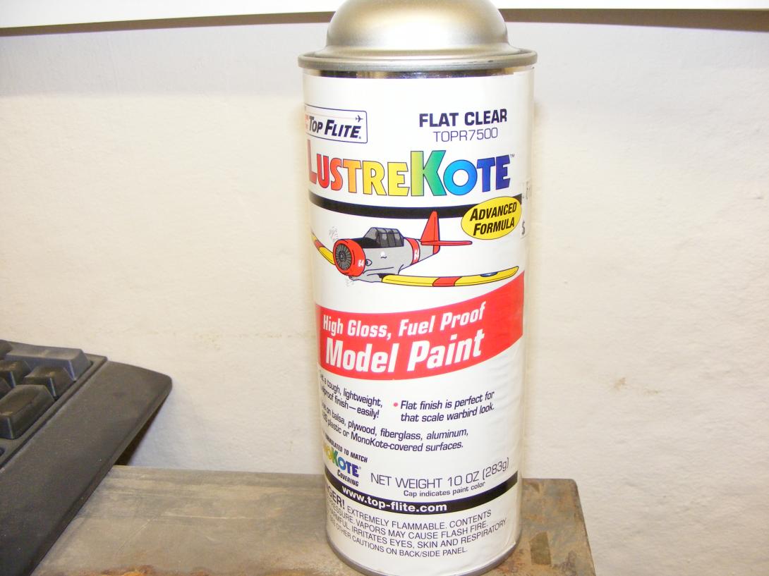

                Also, the props are going to be sprayed with this. Its a Epoxy flat clear thats waterproff and fuel proff. Hopefully it will seal and encapsulate and make the props durable without any paint chipping over time.

                  The sail rudder also has to be finished and mounted to the sail. Then comes the "Bump". The bump on top of the sail will be the next big item.

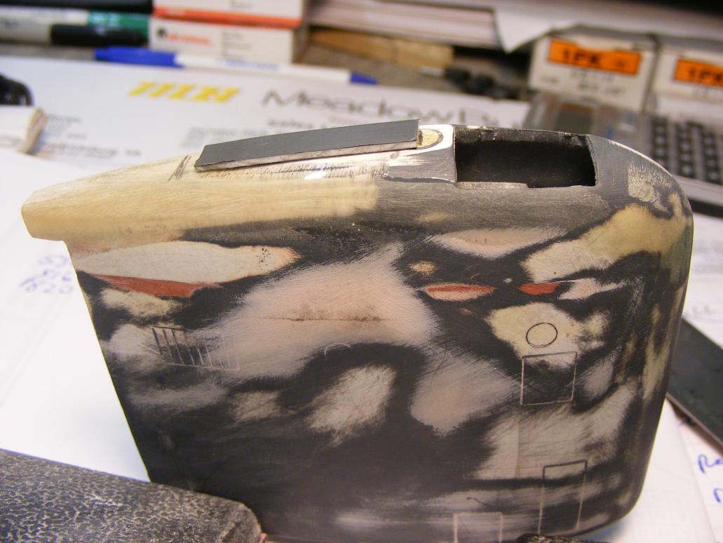

                        I borrowed this Idea from "He who can not be blamed".............I mean named. To help form the bump and locate it I cut from thin sheet plastic this 1/4" by 1&1/4" piece and CAed it to the proper location. Then using filler Ill contour and smooth and shape. First Ill shape the plastic, then Ill put the Goop on.

                              I am bitterly disapointed. After spraying the props with the clear flat, now they look milky white. Apparently, too much flat pigment was put in the can. I wouldnt recommend that stuff to anybody. However I cant see myself spending hours trying to sand down these things. Perhaps paint stripper.............We will see.

                                Jim Wakefield, who is in charge of maintaining the Albacore emailed me that the Phase 4 configuration only has two masts. The periscope and a radar mast. He also said that the messenger buoys on phase 4 are painted black to match the hull. Good info.
