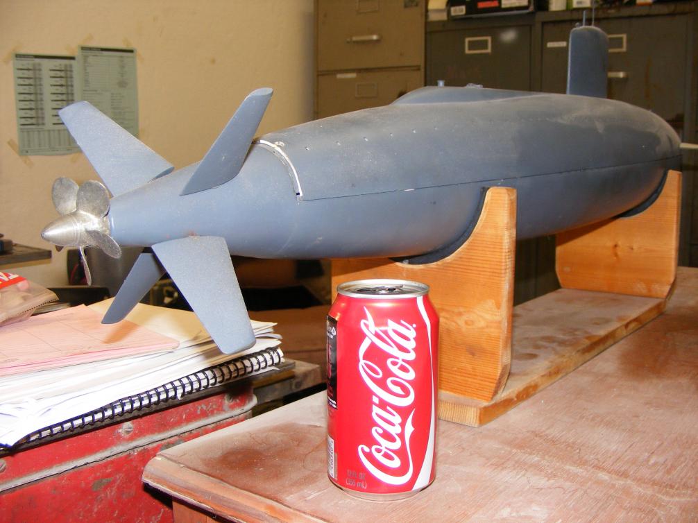

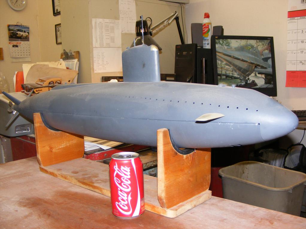

    Originally posted by Merriman
    Me.
    It's the 'beauty' model Skip used to promote the product.
    I got another a-building that will knock your collective socks off.
    Well that's probably the best paint job I have seen yet on any sub. Might be a good piece to document for the Gazette -(as if you didn't have enough to do already).

      What I learned when painting and weathering miniatures for video and film recording was: OVER-STATE!
      Unfortunately, what appears subtle and appropriate in a picture taken by the less than exacting optics of a ground-glass lens system (big screen motion picture, and stills) is a bit too garish when the same work is examined directly by the MK-1, Mod-0 hairy eye-ball.

        #33
        Well it looks **** hot to me.
        Then again I have the Mk 1 Four-eyed system in permanent operation.

          #34
          unfortunately i find that the new mega pixel all singing all dancing cameras with flash seem to make subtle look garish

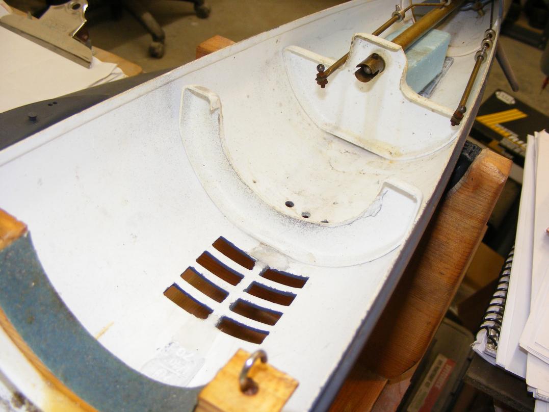

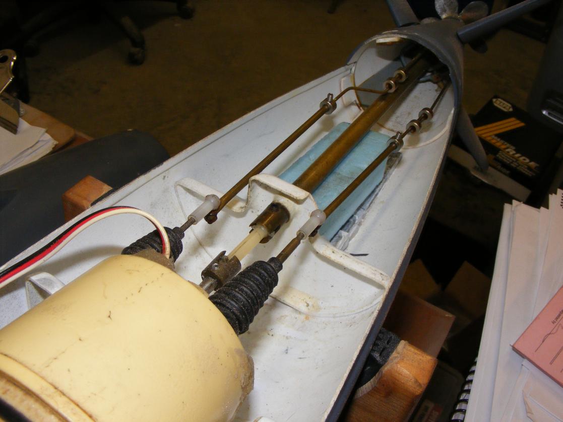

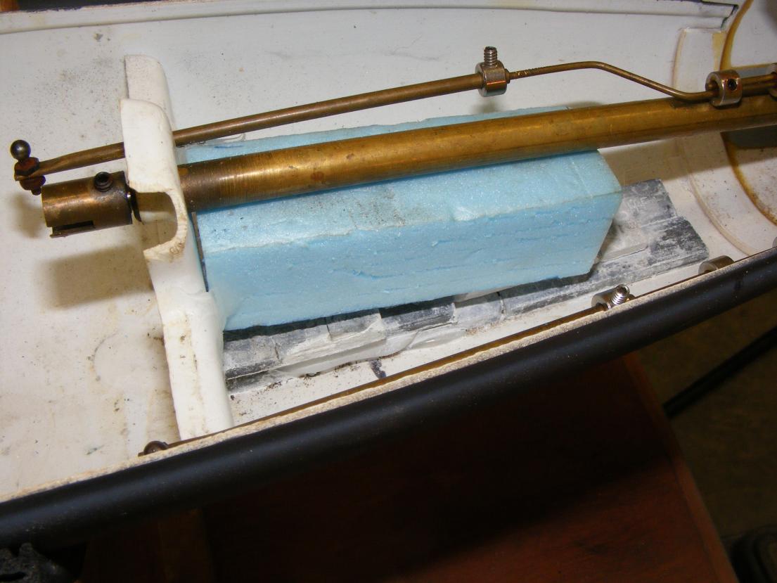

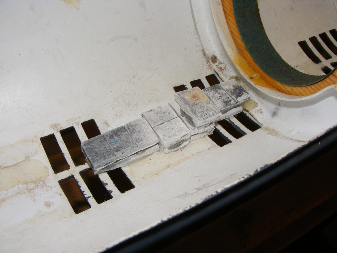

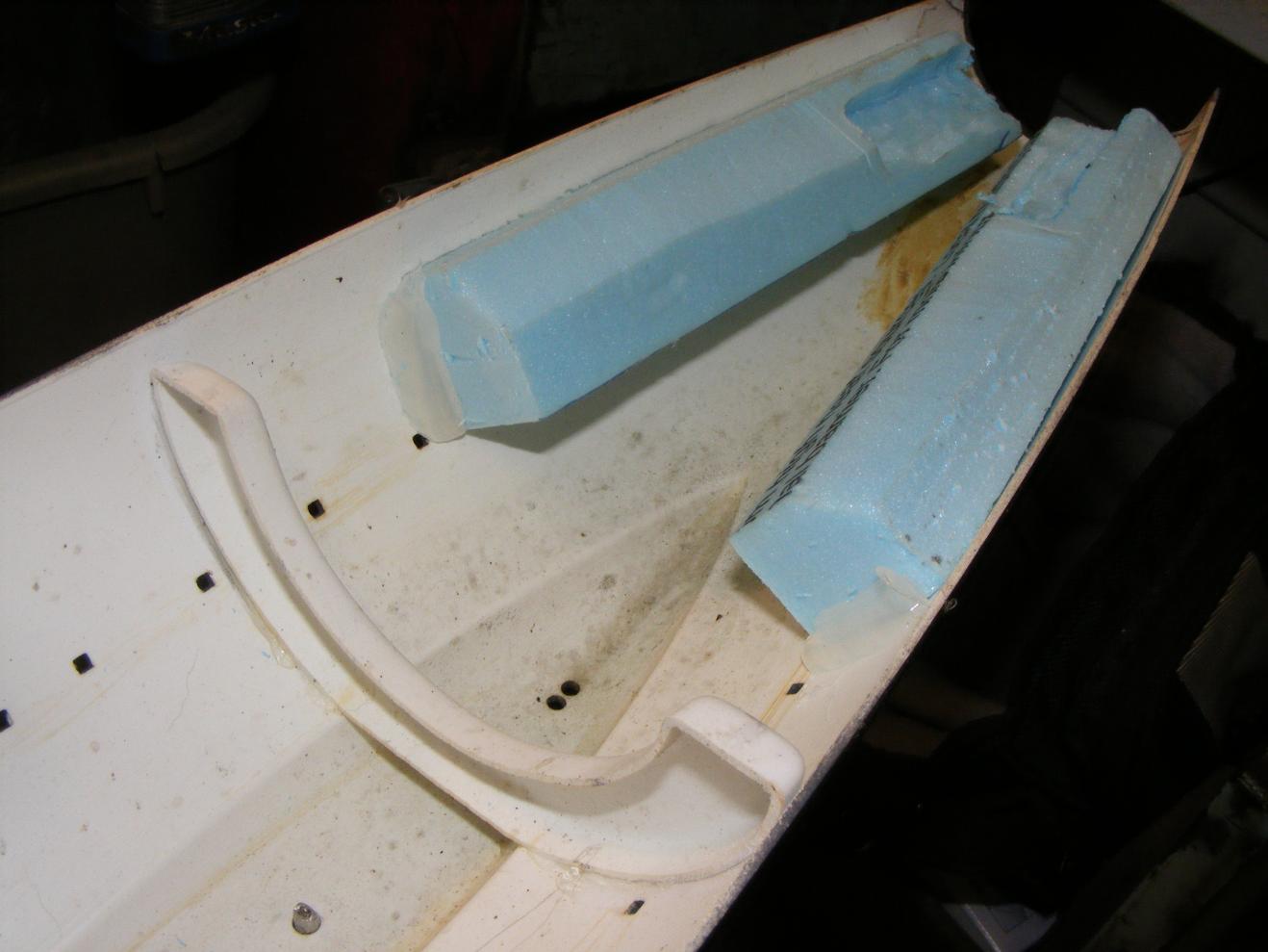

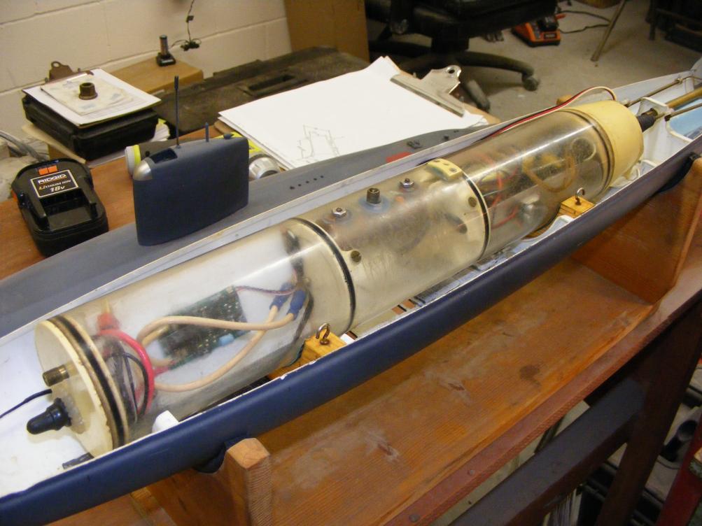

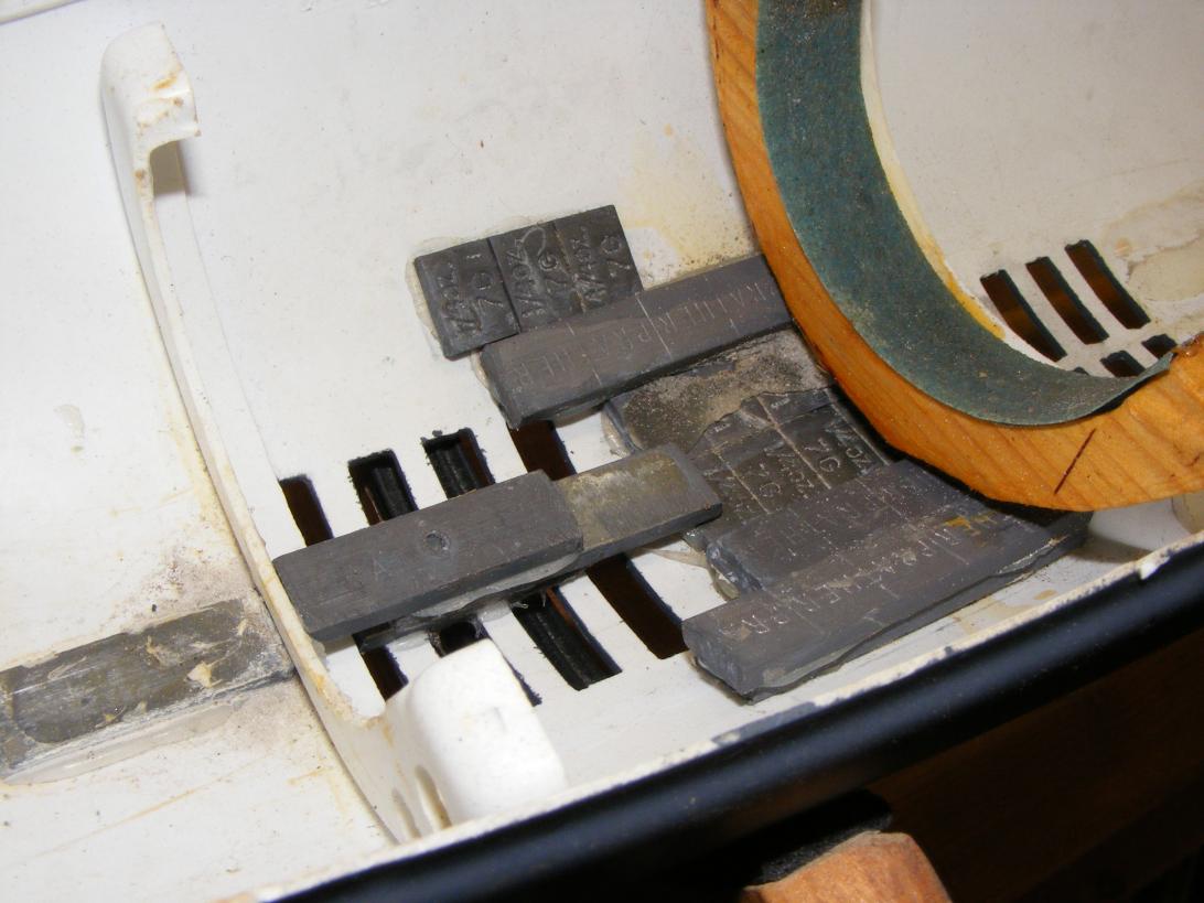

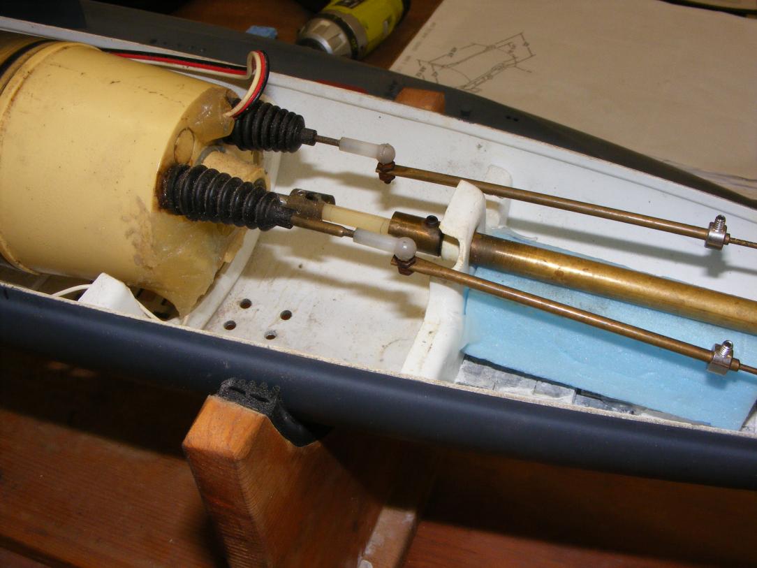

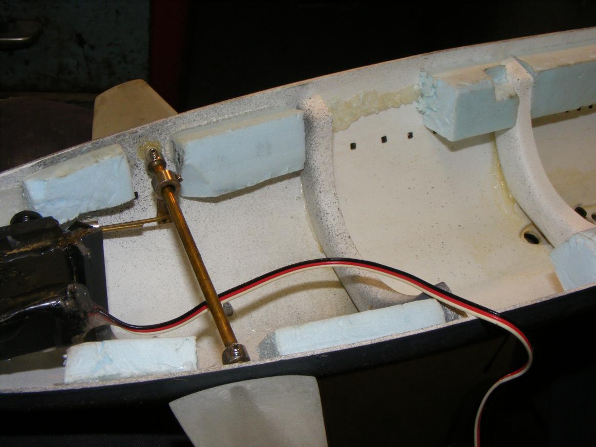

            I took these photos today to give me a reference to where the WTC and foam and weights are in the before modification state.Click image for larger version
ID:	64931Click image for larger version
ID:	64934Click image for larger version
ID:	64935Click image for larger version
ID:	64936Click image for larger version
ID:	64937Click image for larger version
ID:	64932Click image for larger version

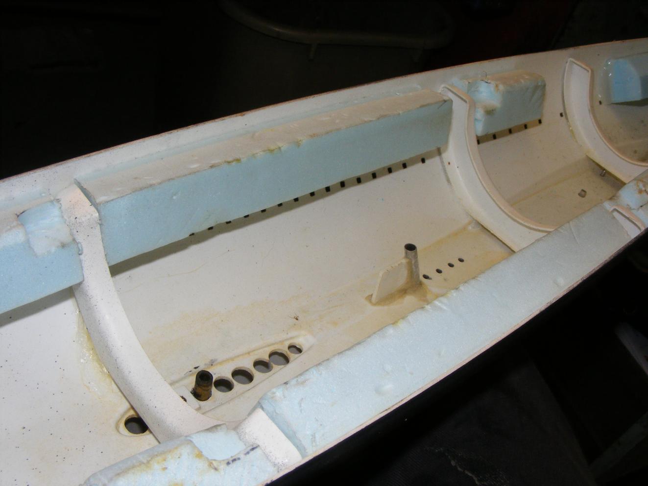

              #36
ID:	64938Click image for larger version
ID:	64939Click image for larger version
ID:	64940Click image for larger version
ID:	64941Click image for larger version
                #37

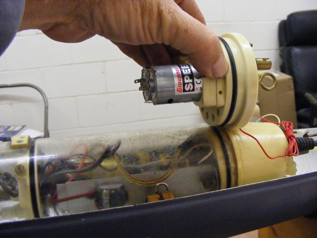

                You can see here one of the tasks ahead is to compress all the same stuff thats in this WTC rear compartment into that same space after this new engine bulkhead with dual motors is put into place. The single motor in the old configuration is comepletely housed inside the motor compartment that you see atached to the WTC now which effectively is outside of the dimensions of the Acrylic tube. A tight squeeze to say the least.
