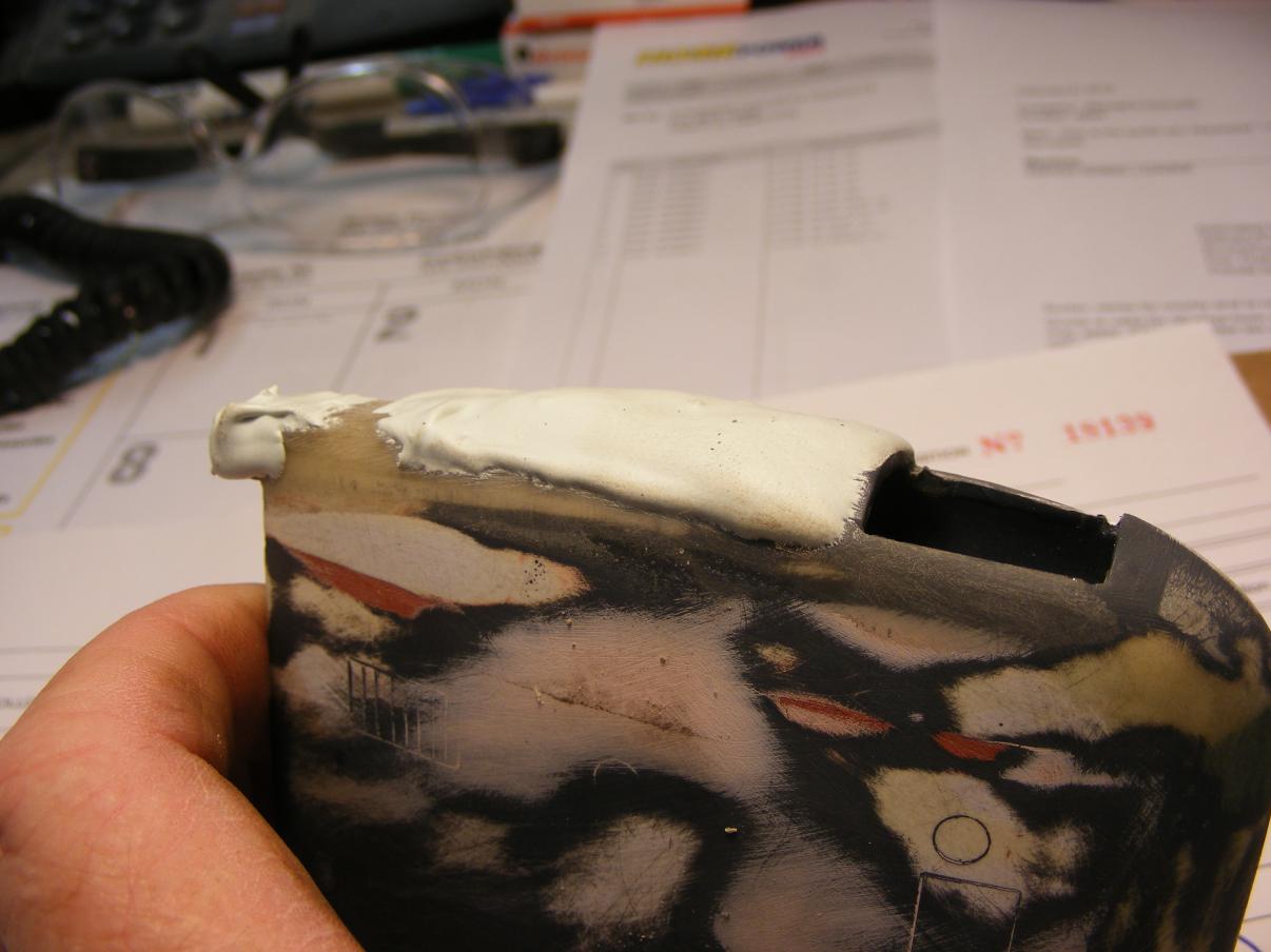

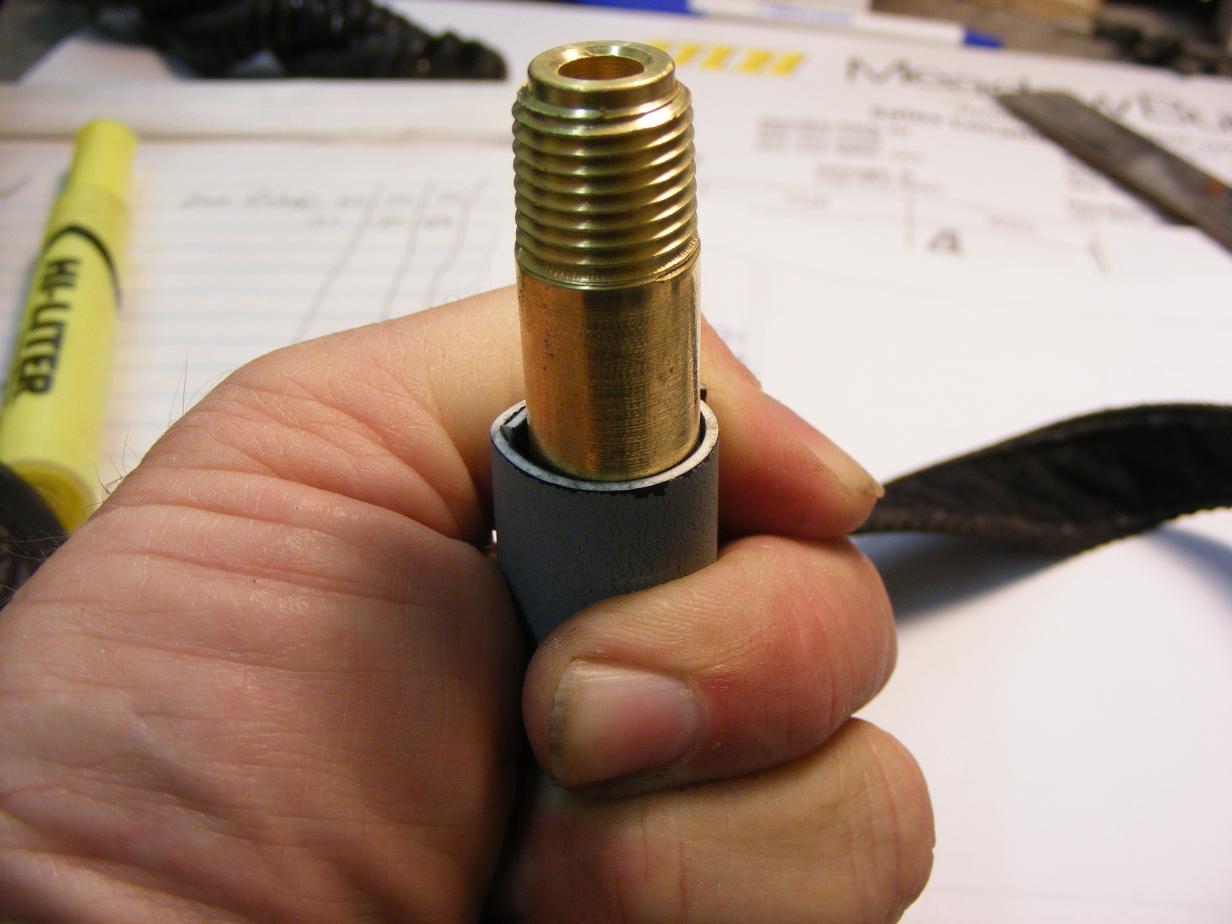

            I managed to get some filler on the sail and rough cut some doors for the bridge. First I took some thin sheet plastic and rolled it around a pipe nipple to acheive some curvature.

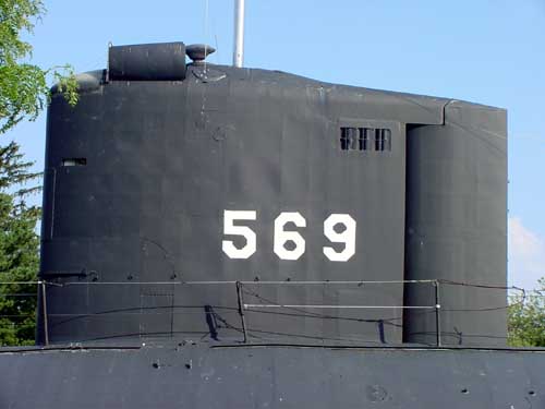

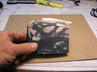

                  Heres a teeny weeny update. Using this picture of the full size Albacore at the museum im carefully contouring my sail to look as close as I can. Were getting there.

                    • 2640
                    #204

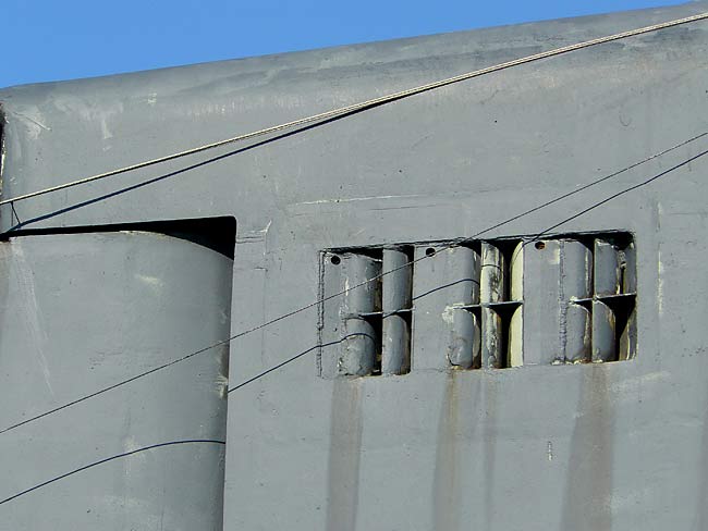

                    Looking good. Are you going to make the vents near the top right of the sail, they look like a major feature to me.
                      #205
                      Yes, Im going to make it look as close as I can. If you look at those vents youll see that they are very complicated. I dont know if scribing will be enough. Ill probably have to cut out the full size of the grill area and try to fabricate some bars or louvers or something to insert in there. Notice the picture. On this side it looks like some repair welding has taken place. It also looks like the grill is divided into three seperate areas. Ive got an idea on how to do it. I probably wont try to reproduce the horizontal bar though. Forgive please.Click image for larger version

                        Very tricky piece to make with those aerofoiled blades. However it looks like if you made a mould, you would only need to construct one third of the vent, as it repeats itself, and for the other side of the sail, you would only need to flip it 180 degrees.
                          #207

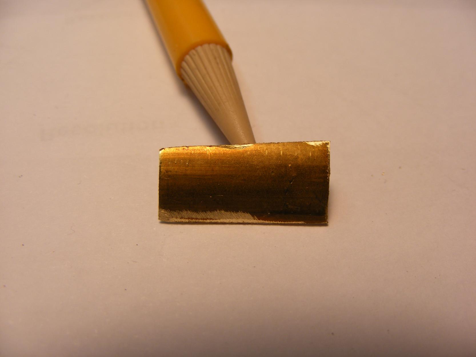

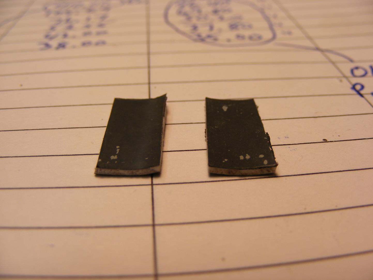

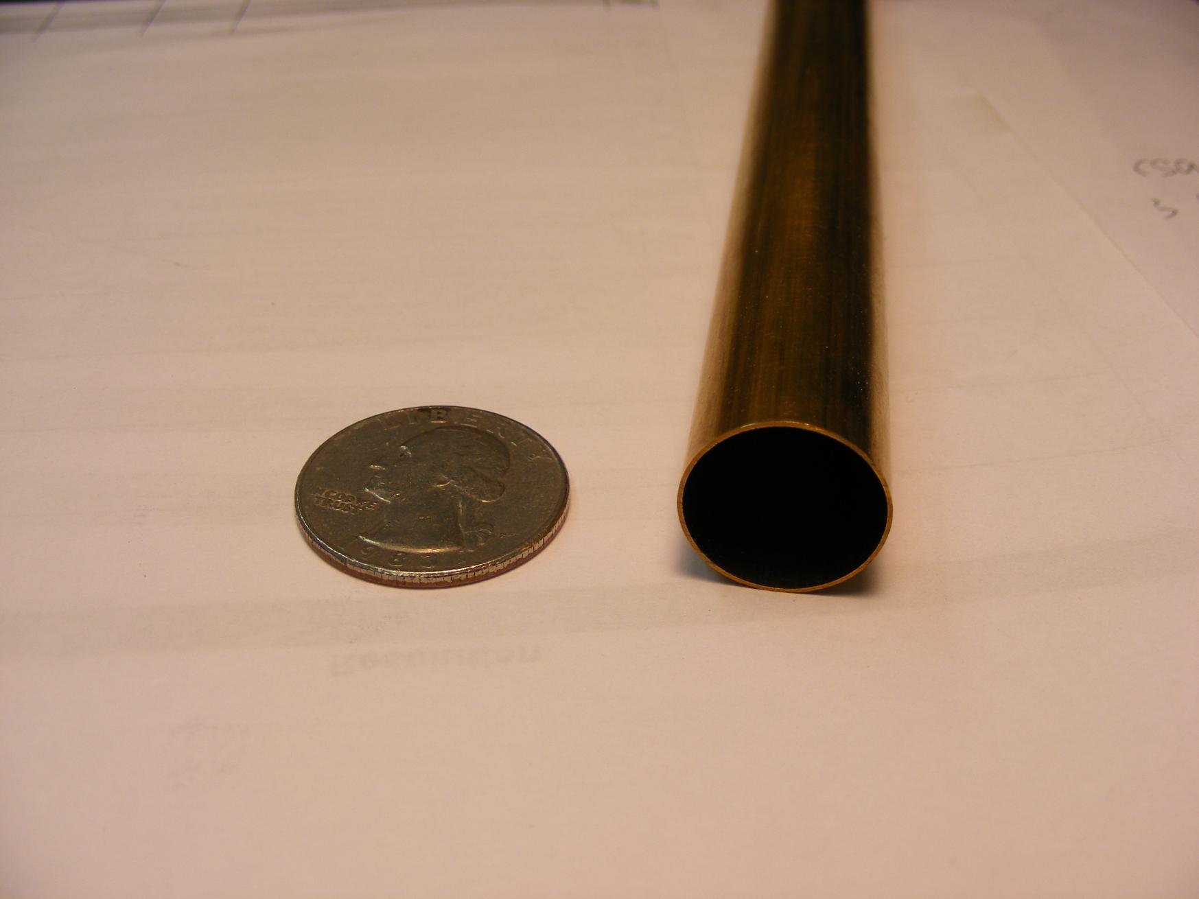

                          MAKE A MOLD???!!!!! Oh Man, youve got the wrong guy. I dont have near your patience or ability. No, I plan to cheat, Ill find something to put in there. In the meantime I purchased a large diameter brass tube from the hobby shop. After measuring and marking ,I cut out one of the bridge doors.Click image for larger version

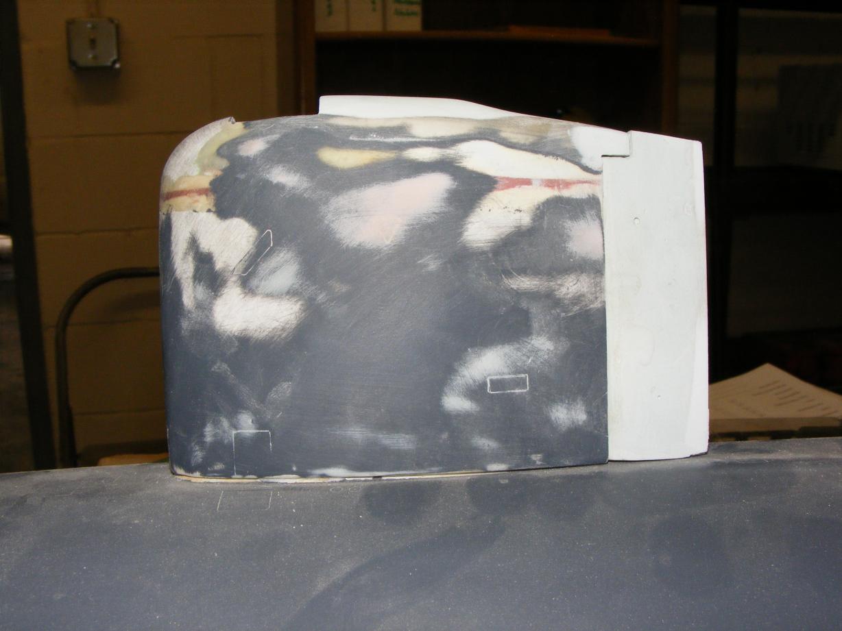

                            Continuing to fine tune the shape of the top of the sails "Bump". It has a sharp rise in the middle now properly represented here. The rudder attachment and shape is now the direction of my present efforts.

                              #209
Name:	Albacore port sail.jpg

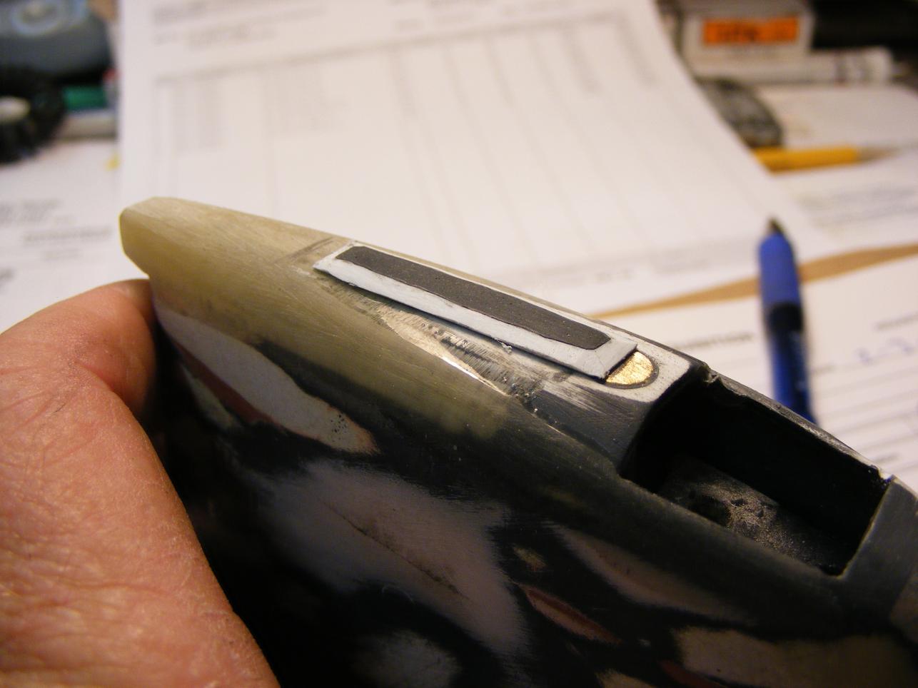

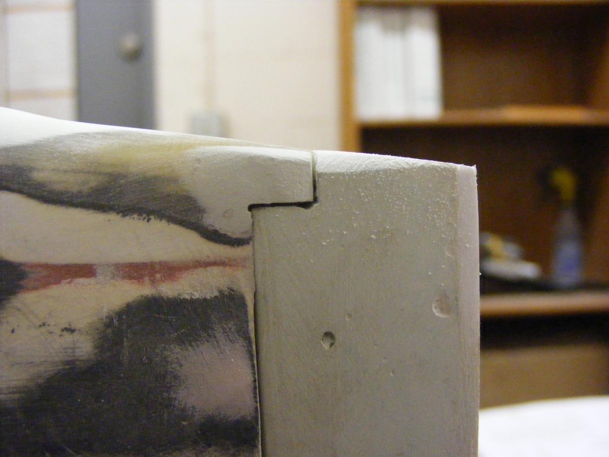

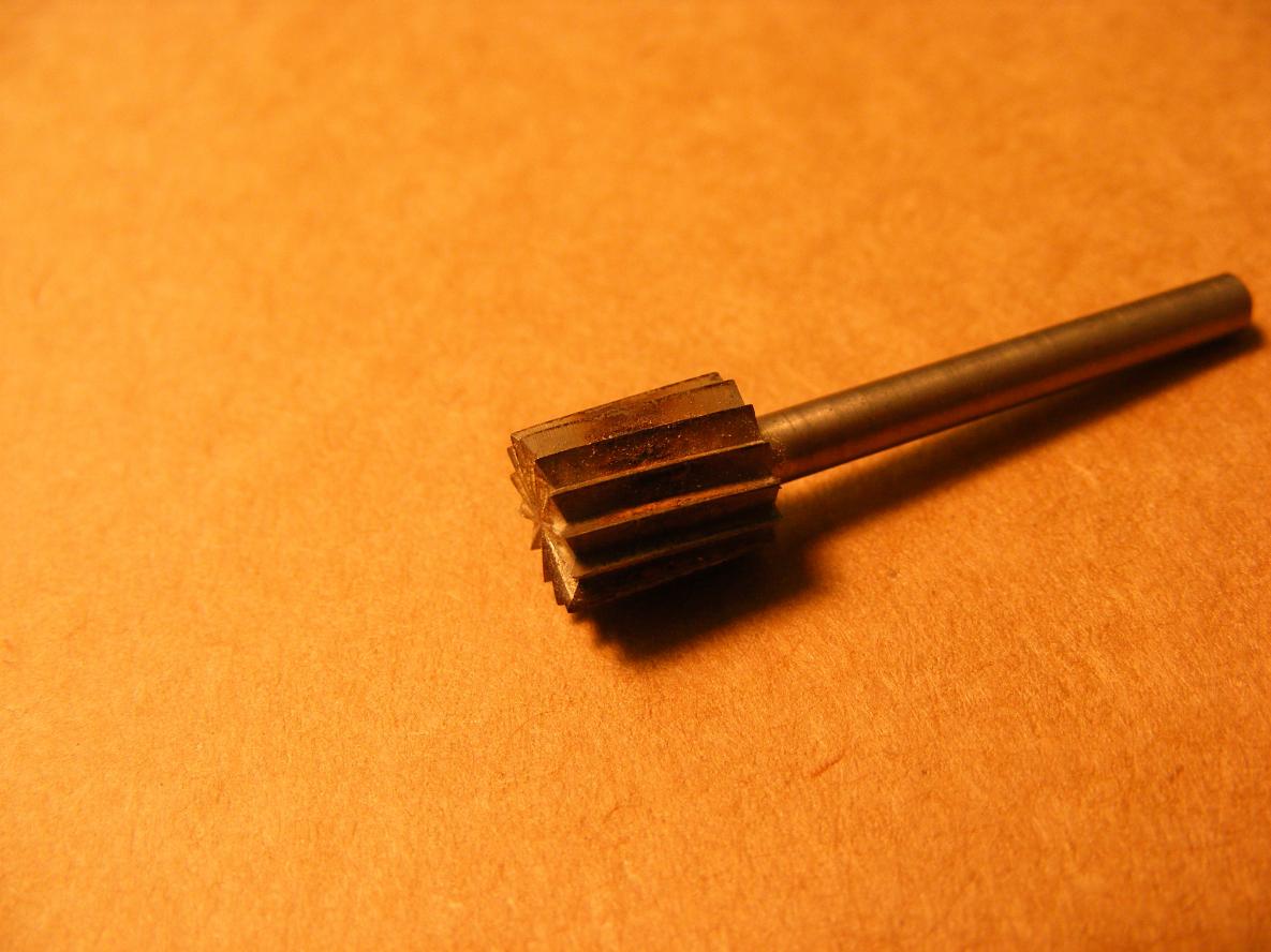

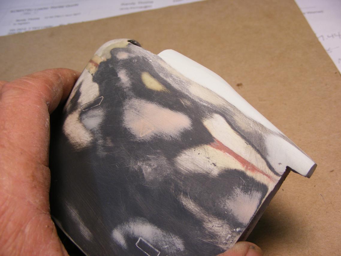

ID:	66692 In this shot you can see the radiused look of the rudders attachment with the sail at the top. So I filled in the cut at the top of my rudder and using a round Dremel cutter I am cutting it out in a rounded fasion.Click image for larger version
ID:	66693 Dont have a picture yet.
                                • 13982
                                #210
                                This rudder started out looking like dog-poo, but you're beating this thing into shape, Mark.
