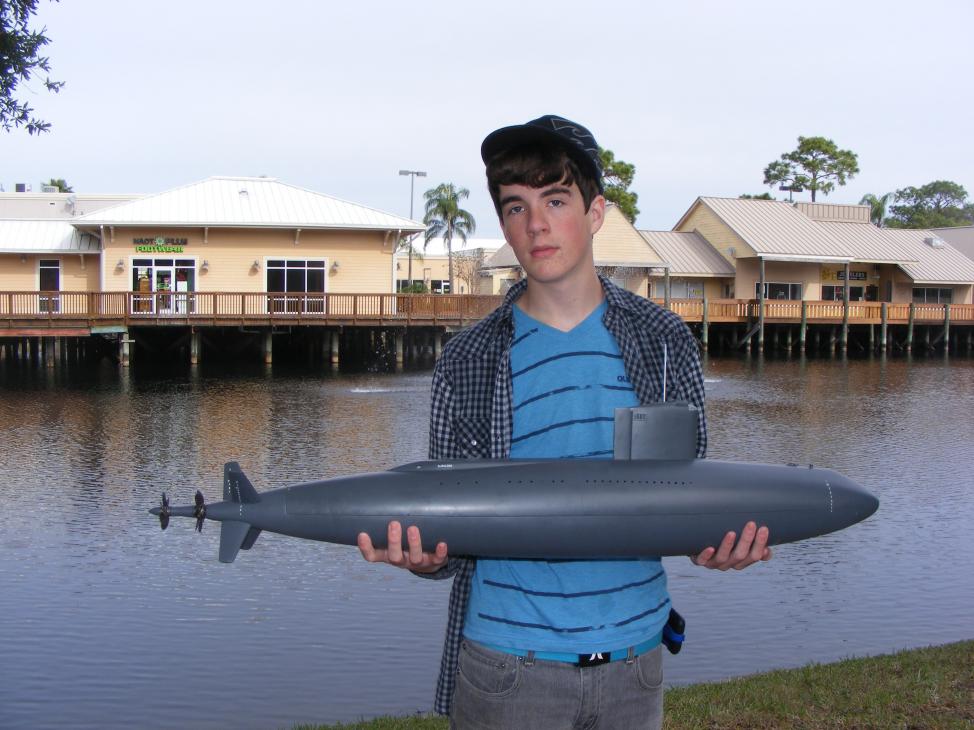

      Look at that Dashing, handsome Gent. This is my youngest, Nathan. Part time camera man for me. Poor Kid. Cares nothing for this Hobby, he just humurs the old man. He does enjoy driving my 1/8 scale gas buggy. There is still hope for him yet.Click image for larger version

        One thing that I have noticed is that the difference in turning ability between the single prop Albacore and the dual prop Albacore is that the new configuration doesnt turn on a dime like the previous configuration. Now it turns on a Quarter. Perhaps and most likely because of the pivot point, which I would think are the stern planes is now a greater distance from the propellers. The Props are further away. The distance went from 1" to 3". So now we have an overall length of 42 1/2".
