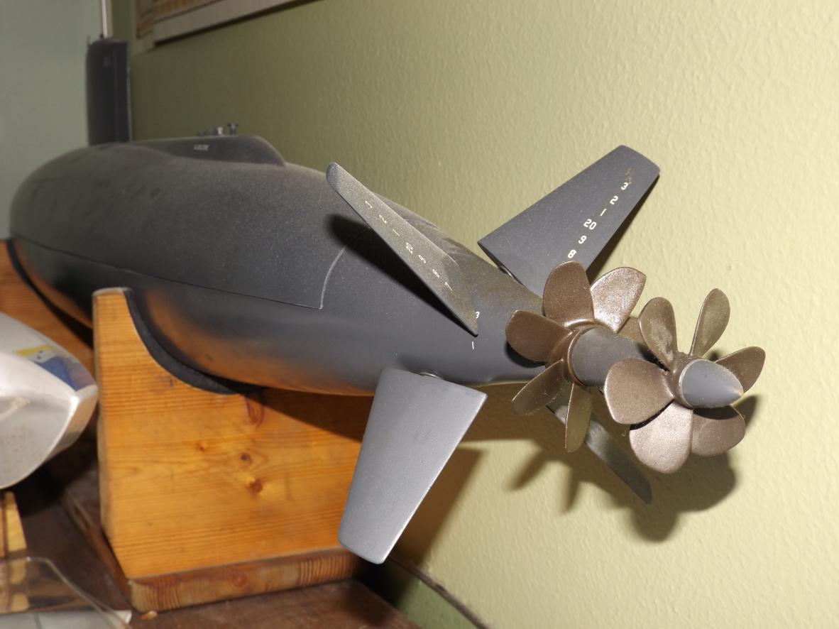

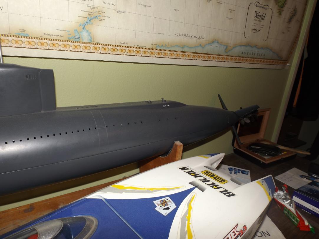

        I wasnt satisfied with the last pictures that I put up because I couldnt figure out how to get the flash to work on my new camera. There.....thats better. Ive got to tell you about this new camera.......soon. Sorry about the dust.

          "Nasty" looking sub!! I'm sure she commanded plenty of respect from any combatants!!!
          Very sleek, and with that prop arrangement, pretty danged fast, too!!

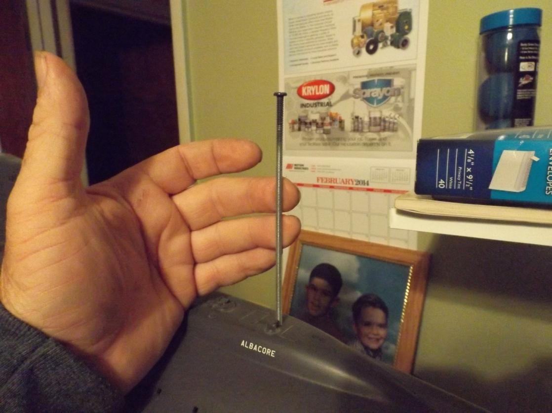

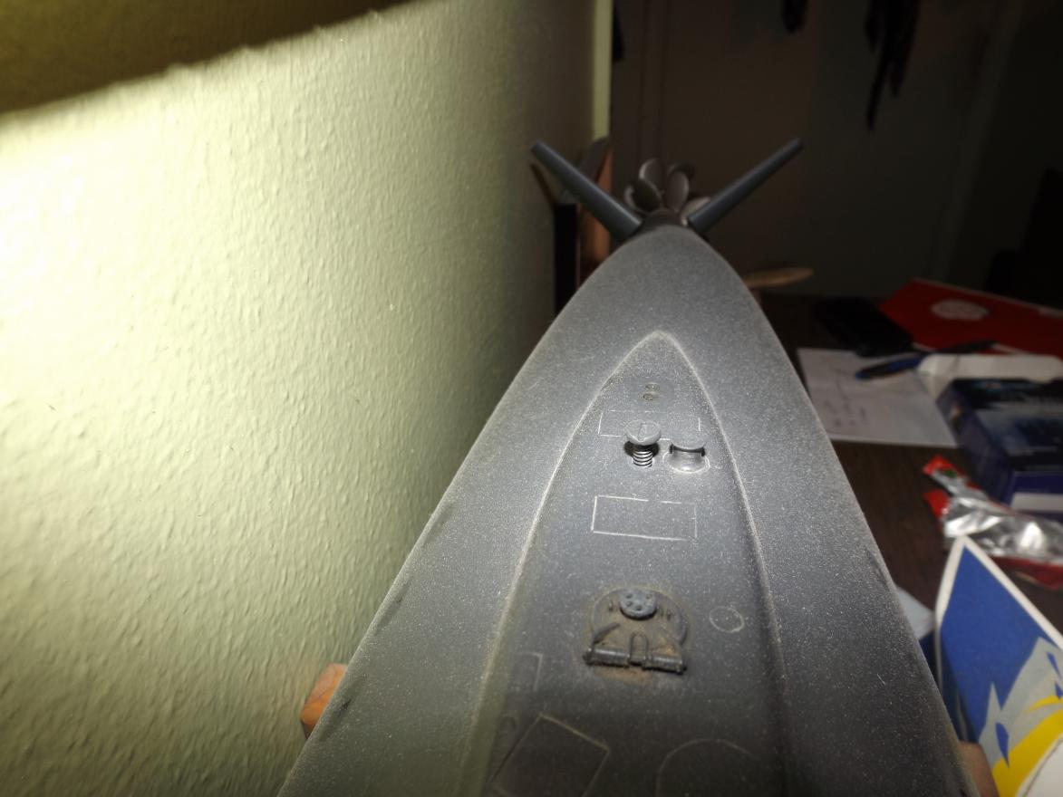

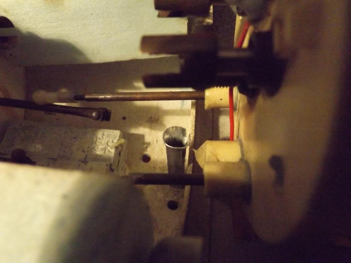

                And another thing! The Subtek Albcore is made of a very thin plastic. The Revell/Moebius Skipjack is much heavier. At any rate, if I run this sub into something hard, the possibilitys are very real that I could lose it. Because, if the upper hull comes lose and comes off then all the foam that helps this thing float will be gone with it and it will never come up. The only thing holding the top on is that little screw(4-40) and the forward lip. Therefore I did this:Click image for larger version
Name:	Fuji transfer 379.jpg
ID:	90180Click image for larger version
Name:	Fuji transfer 376.jpg
ID:	90181Click image for larger version
Name:	Fuji transfer 375.jpg
ID:	90182Click image for larger version
Name:	Fuji transfer 378.jpg
                  #548
                  I used a long 6-32 screw and a blind nut to hold it together right behind the Subdriver. To feed the screw and guide it to the blind nut I used a length of alluminum square tube that I opened the end up with a mandrel like a funnel. No fishing around, it goes right in. NO FEAR NOW!
