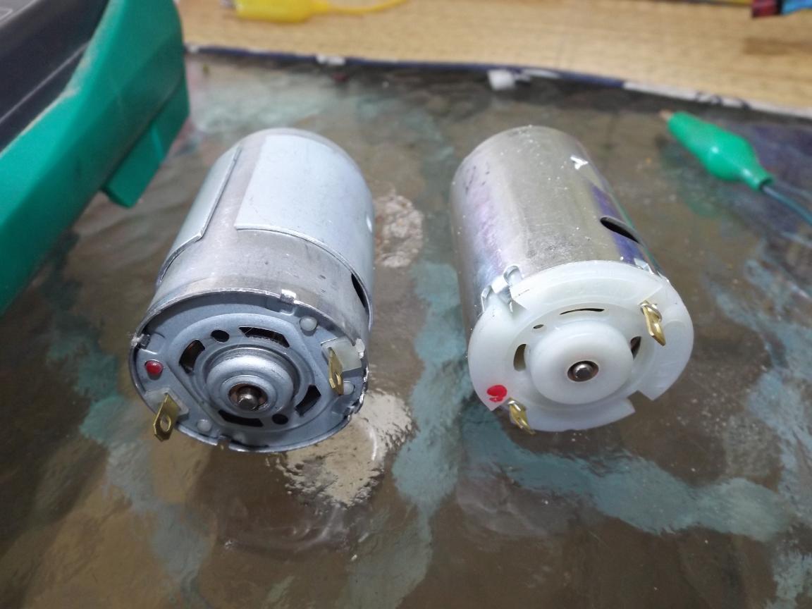

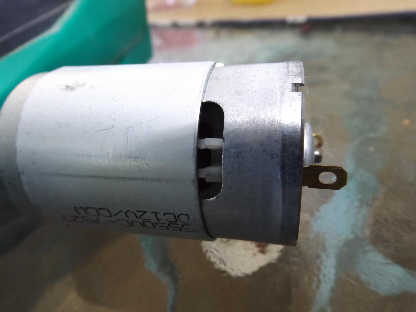

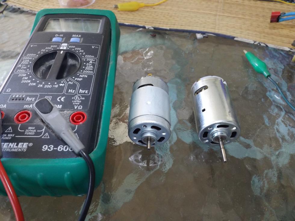

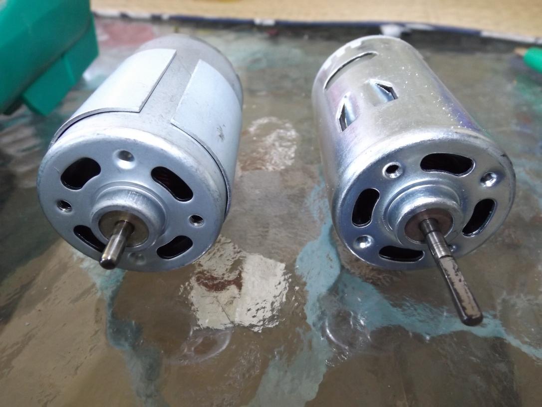

                As good as my word. Just got these yesterday. Using my volt/ohm meter, set on DC amps, I got .25 amps no load on the 12 volt Caswell motors, so we will use that as a bench mark. The new motors pull .45 amps no load. To test torque output I used a very precise and ingenious method. I put on a leather work glove and tryed to stop the spinning motor shaft. On the Caswell motor, I was surprised at how strong it was. But I was able to stop its rotation by squeezing between gloved thumb and forefinger, running at full RPM on a 3 cell Lipo. The new motor, however there was no stopping it. I was able to slow it down somewhat, but I could not stop it.
                So, there you have it Folks.....a very precise and reliable way to test your motors. Did I mention that I charge for this service???
                At any rate , I plan on putting two of these motors in the Duo-prop, X tail Albacore when I redo the WTC. Also Im going to stick one in the 1/72 Revell/Caswell/Merriman Skipjack. Yep, I plan on adding more ballast weight and upper end foam to try to help keep it from becoming a High Speed Drill Bit. Bonapetit. Oh, did I mention that the new motors are fan cooled. I dont know if thats good or bad inside a confined space like a Subdriver. In the pictures , the New motor is on the left.Click image for larger version

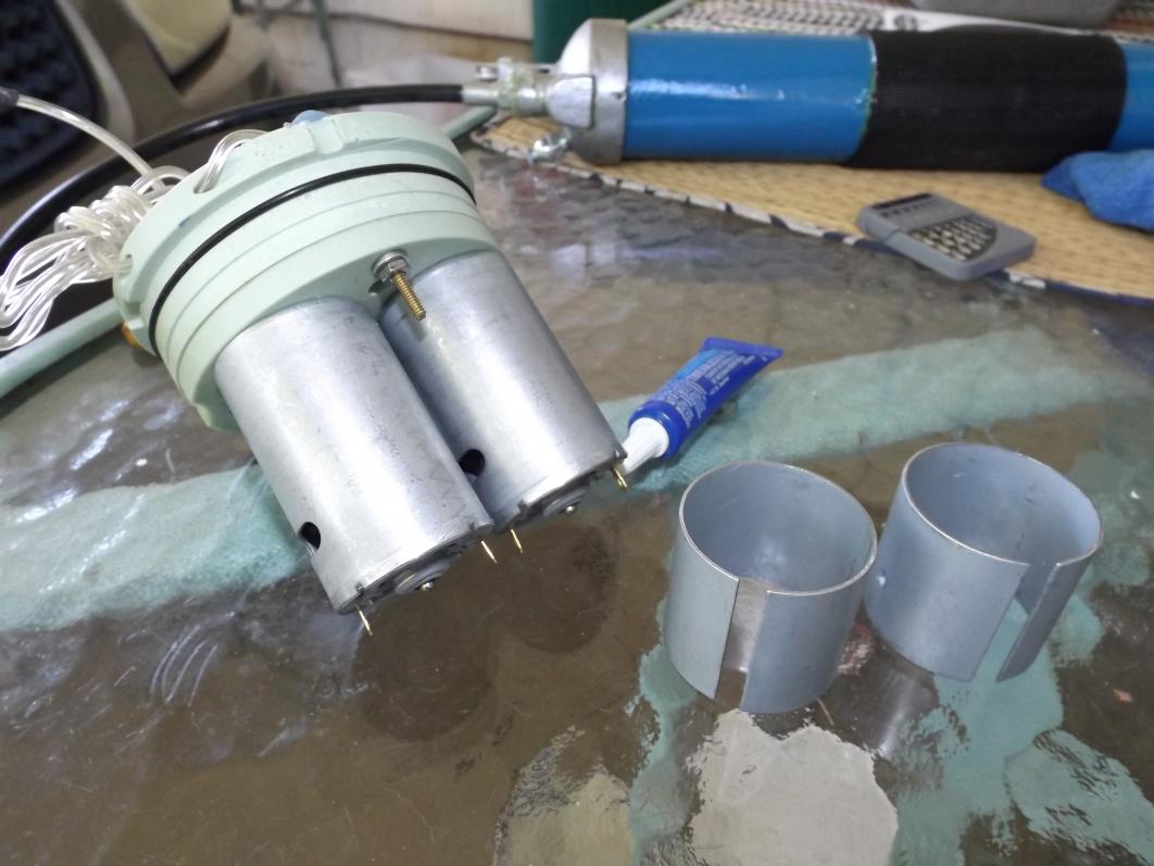

                      IT IS DONE! Installed. Dave, what do you use to affix the brass gears to the motor shaft? OMG!!! I heated them for 45 seconds with a propane torch and still couldnt getem to come loose. I had to cut the motor shaft and drive the shaft out of the gear with a pin punch. Green Sleeve retainer was used to re install the gear on the new motors. Now Ill have to get some 3&1/2" lexan tube on the way. Oh yes, I had to remove the field sleeves off the outside of the new motors to get enough clearance to get them to fit inside the Lexan without hitting.Click image for larger version

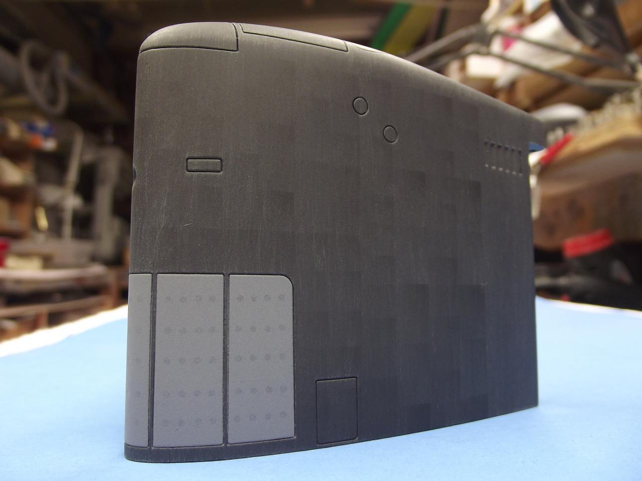

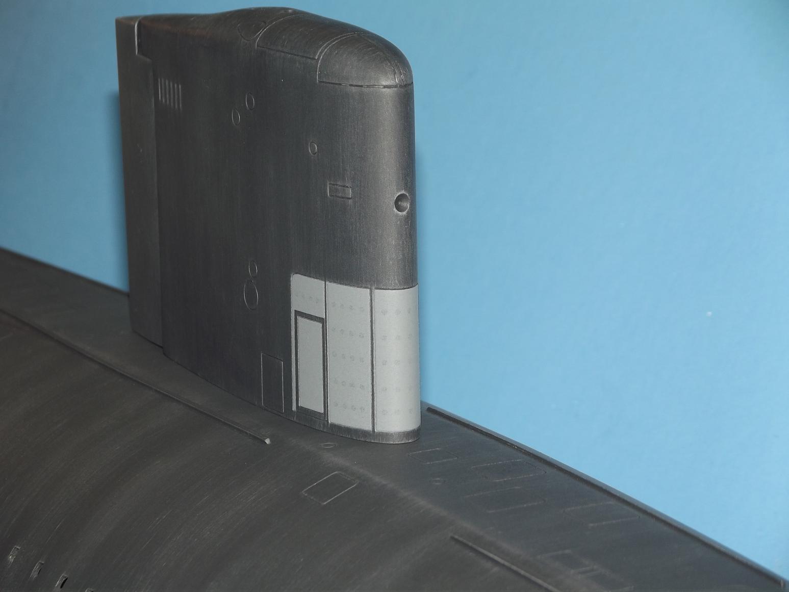

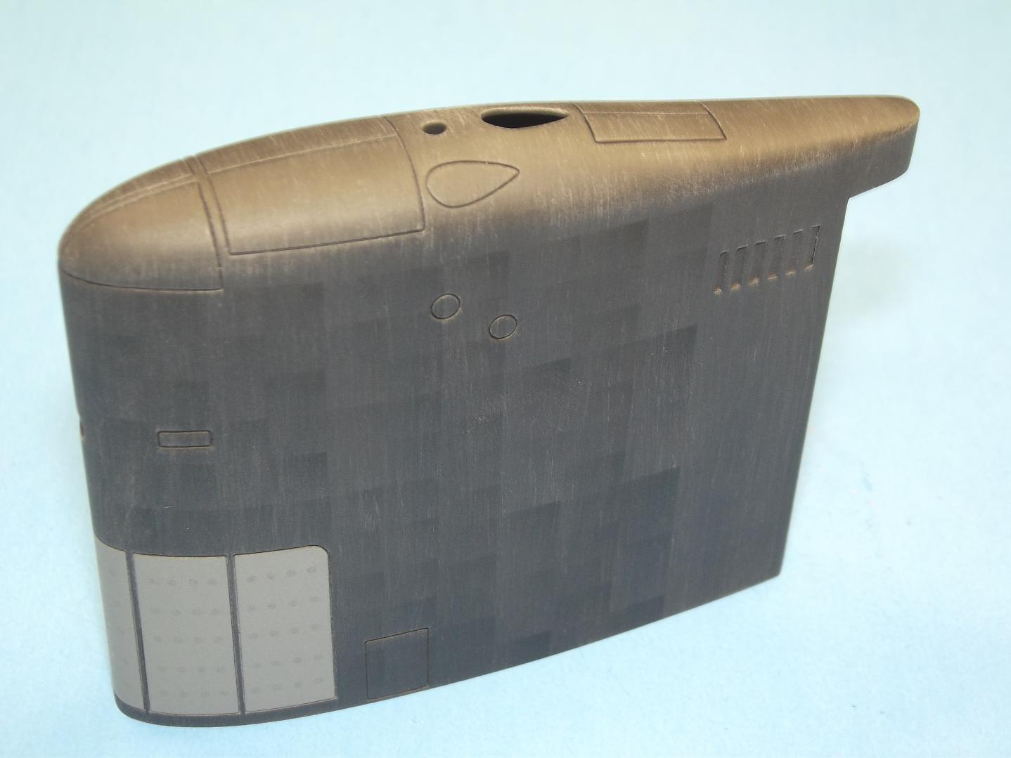

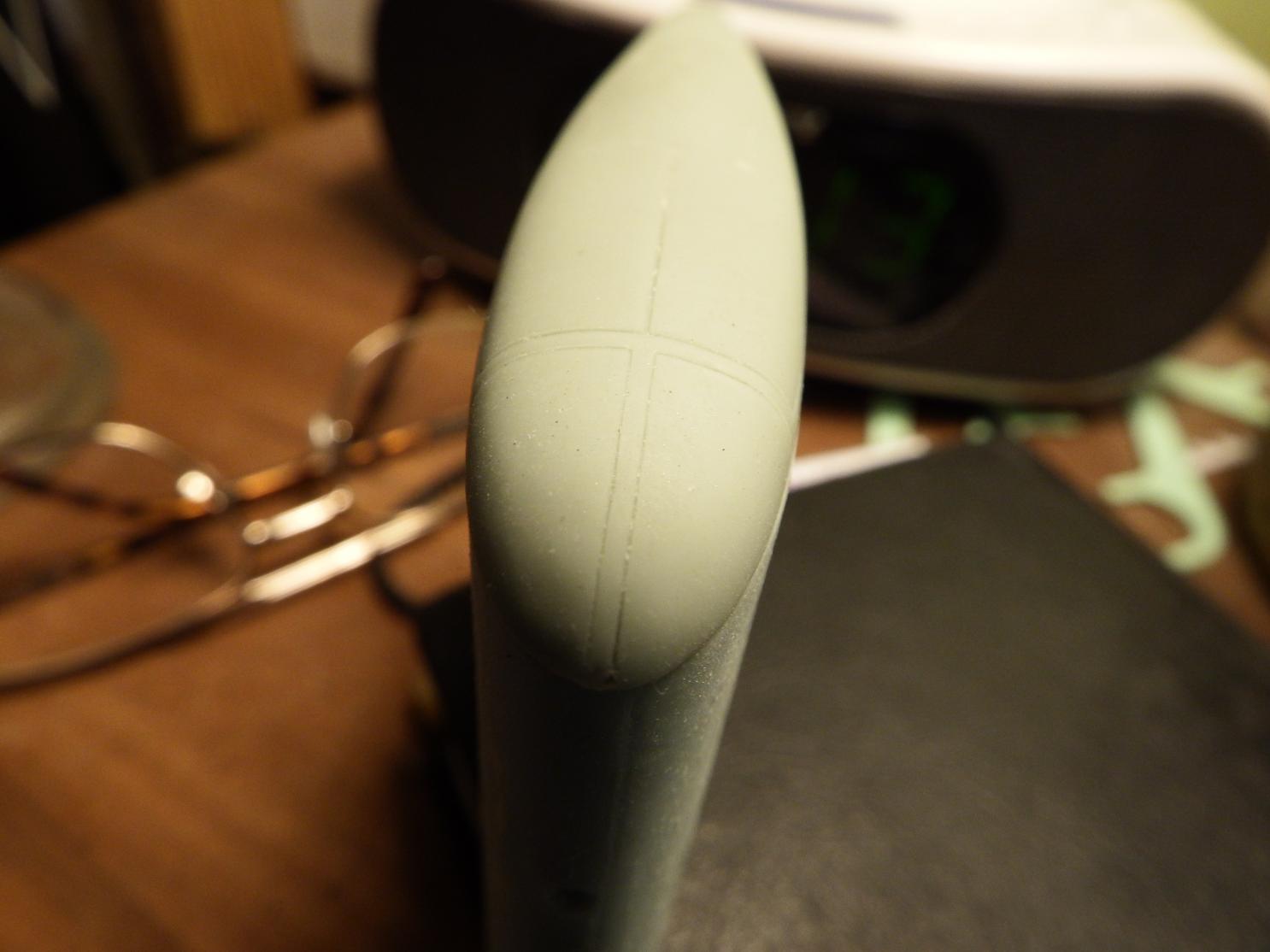

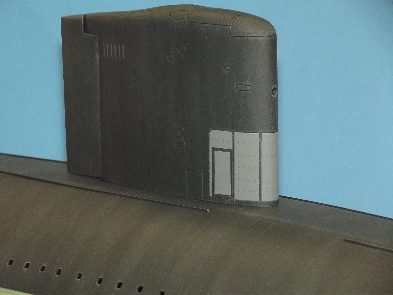

                            LOOKY, LOOKY!!! LOOK WHAT JUST ARRIVED FROM "THE CAVE"!! Once again Dave Merriman has come through with a work of art! We all saw how Dave posted about his new Albacore hull and sail with the built in rudder. I dropped a few well timed "hints" about wanting to retrofit one on my Phase IV X-tail. Well it seems to have worked because I am now the proud owner of one of those sails. Im sorry about the photography as these pictures do not do it justice. Its beautiful!
                            Im going to start work right away on it as the top has to be CAed on and the seam filled. Ive decided not to put a periscope on this sail or to open up the cockpit area to eliminate the resulting drag. And now..........BEHOLD!

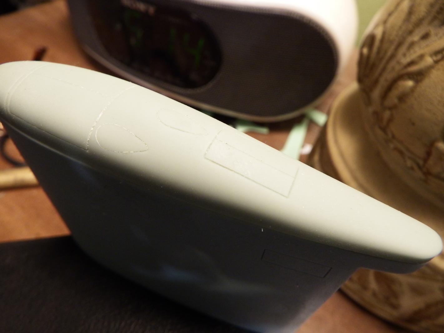

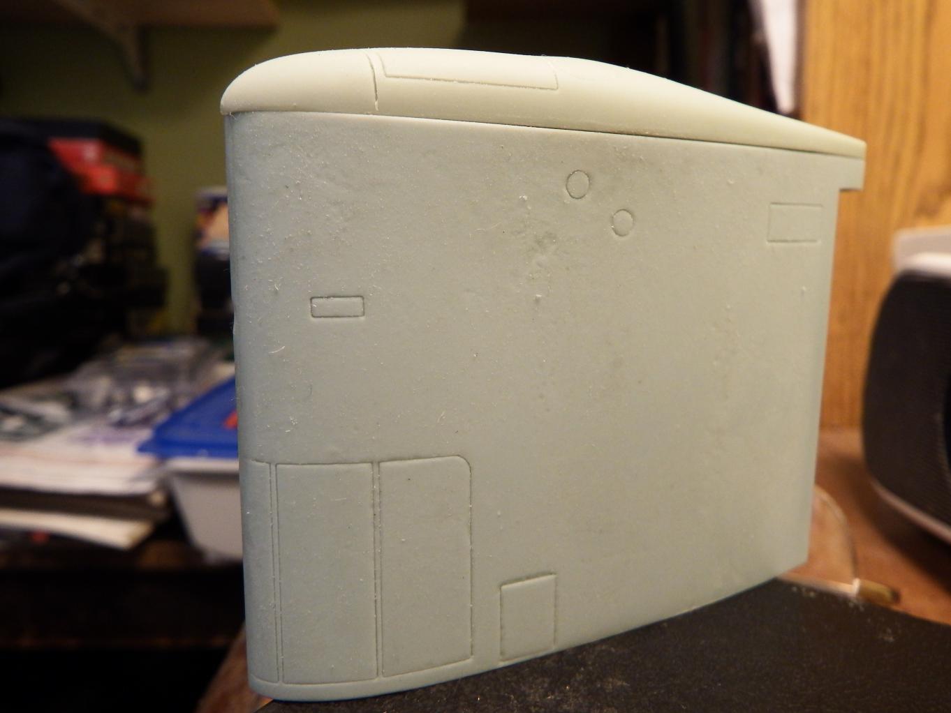

                              The end-game (have not yet painted the 'clear' parts)

                                #570
                                I LIKE IT! However.....it would look better if it were on my sub.
