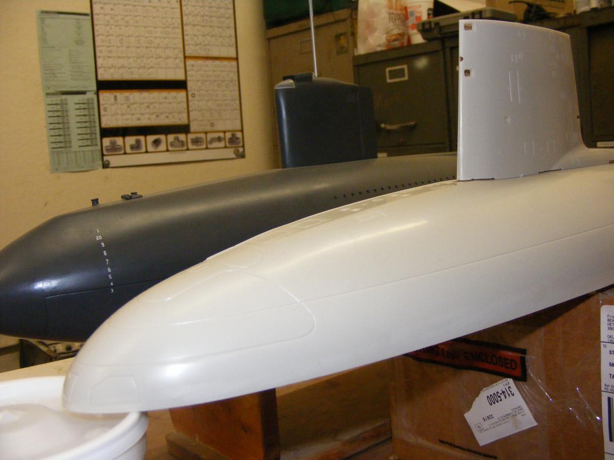

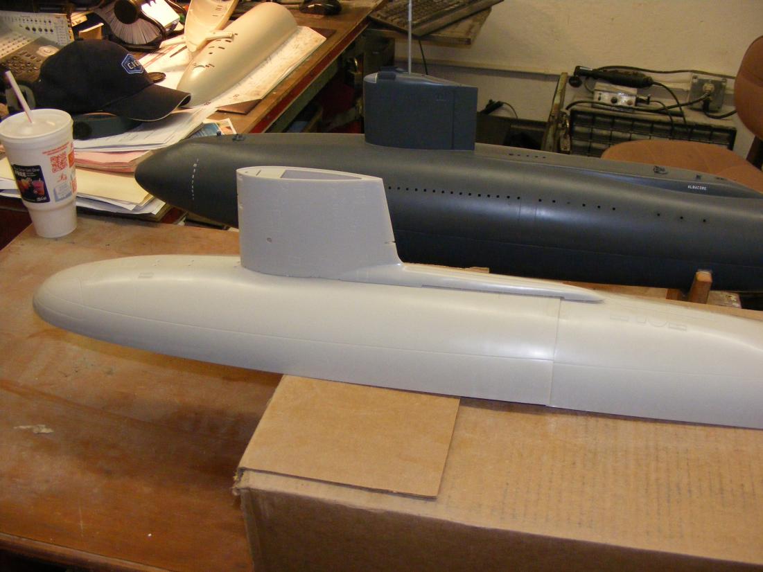

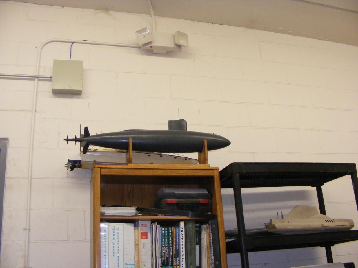

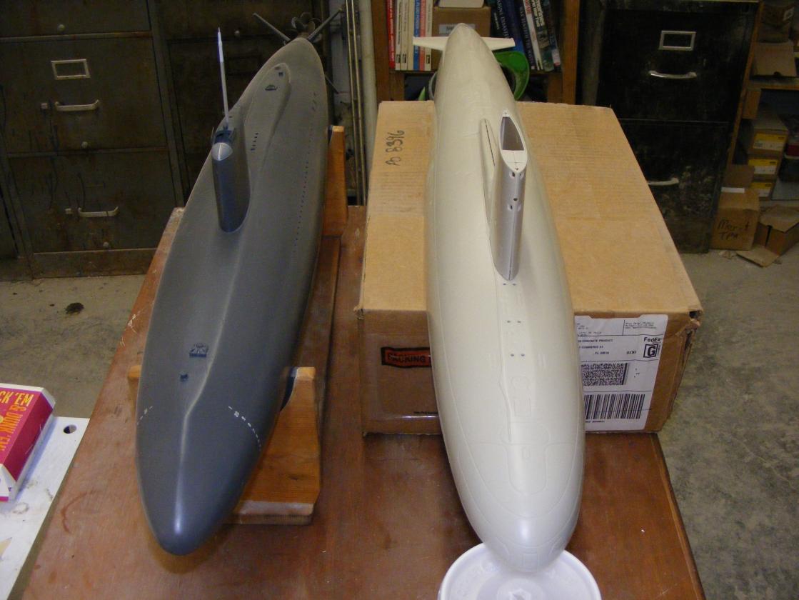

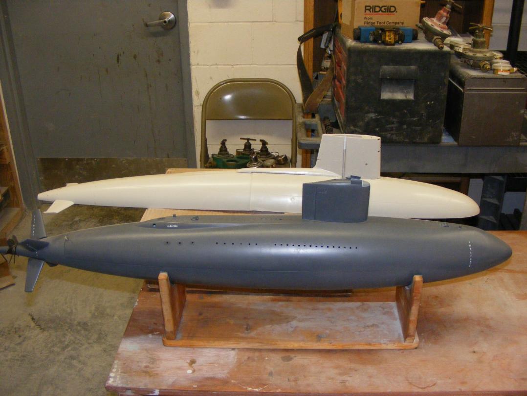

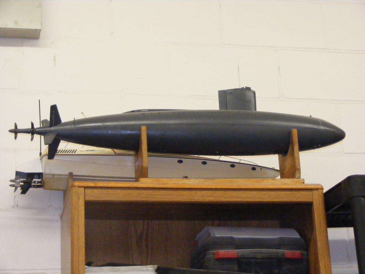

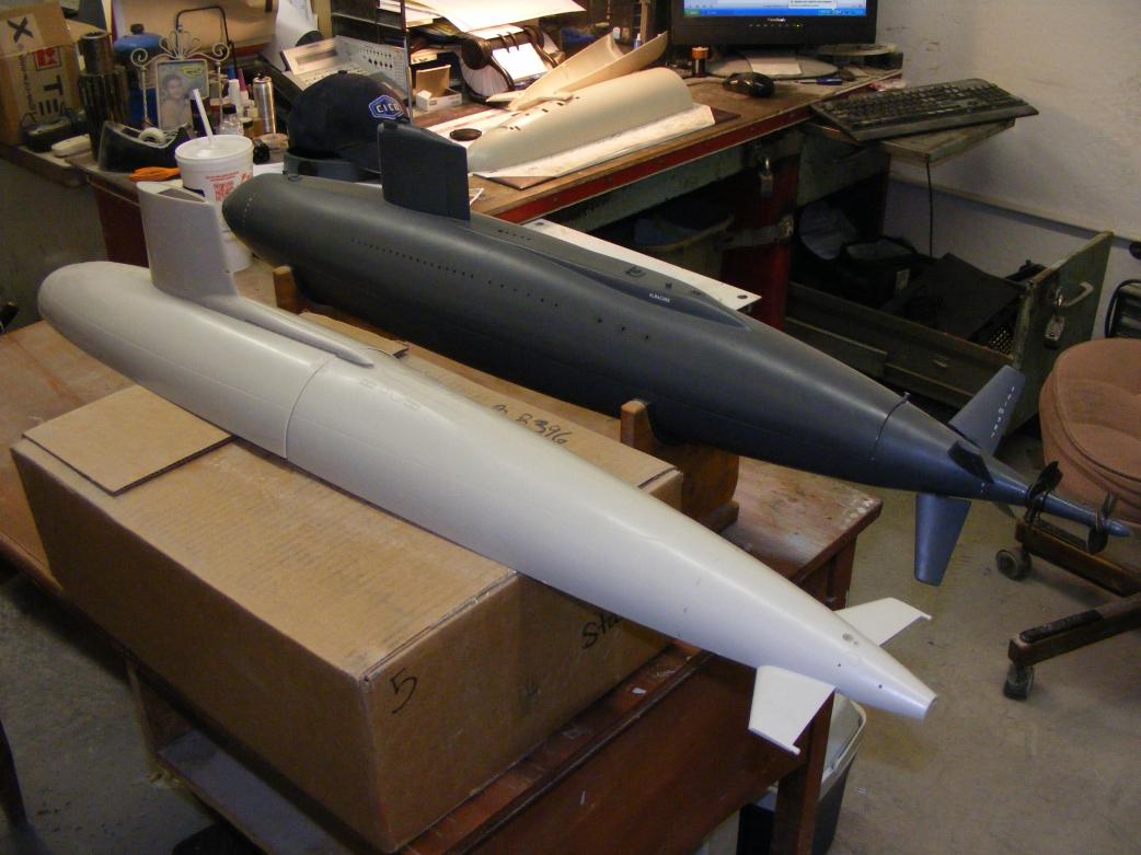

    Since I am working on the 1/72 Moebius Skipjack, I thought that it might be interesting to compare its size and shape to the Albacore. For one thing, my version of the Albacore is an X Tail. I expect that the Skipjacks maneuverability will suffer If compared directly to the X tail. Also being a single propellor driven submarine I expect it to suffer from torque roll If not ballasted properly and too much throttle applied all at once. I can "Floor" my Albacore with no roll at all.
    I remember when I was building my Albacore about 5 or 6 years ago. I didnt have enough ballast weight in her. When you advanced the throttle the thing would spin thru the water like a drill bit! It was so cool!!!
    Also my plans with the Skipjack er...Scamp, is to use the New SAS subdriver with Gas backup.
    Another cool difference is that the Scamp will have controllable sail planes. Im looking forward to exploring how much real affect they will have on operation.

      There she sits........awaiting the Glib comparisons and confrontation to come.

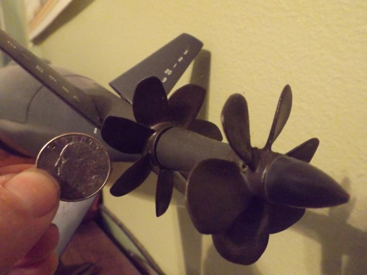

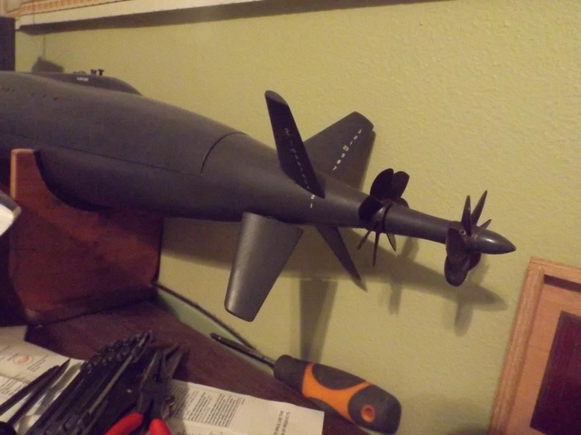

                Since I appear to be "In The Mood", the Albacore needs some further enhancements. Since I know that the Seaview will benefit greatly from installing a 3&1/2" section with 550 motors, Im going to do the same thing with this boat. Those huge dual propellors can only go faster and more efficiant with 550 motors. I havent checked it but I bet those Speed 400 motors are getting real Hot trying to turn them, even with gear reduction. Ill use my new 3&1/2" twin motor, twin drive bulkhead in her.

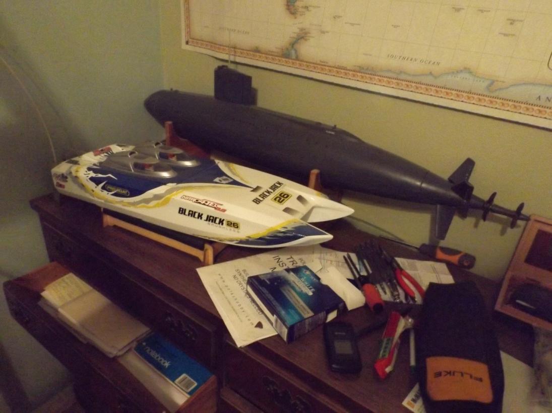

                    Cool! Heres a couple of pictures of the Albacore on my dresser, awaiting the next phase of modifications. In addition to upgunning the Drive motors it will also get a Big 3 cell Lipo for a power source instead of the 7.2 volt NIMH I used before.Click image for larger version

                              Not at all. I use an electronic mixer. You just move the joystick in the direction that you want to go and the mixer takes care of the rest. The neat thing about a x tail is that all four fins serve as rudders, and all four fins also serve as planes. That translates into extreme maneuverability. However, the faster you go, the less maneuverability you need.
