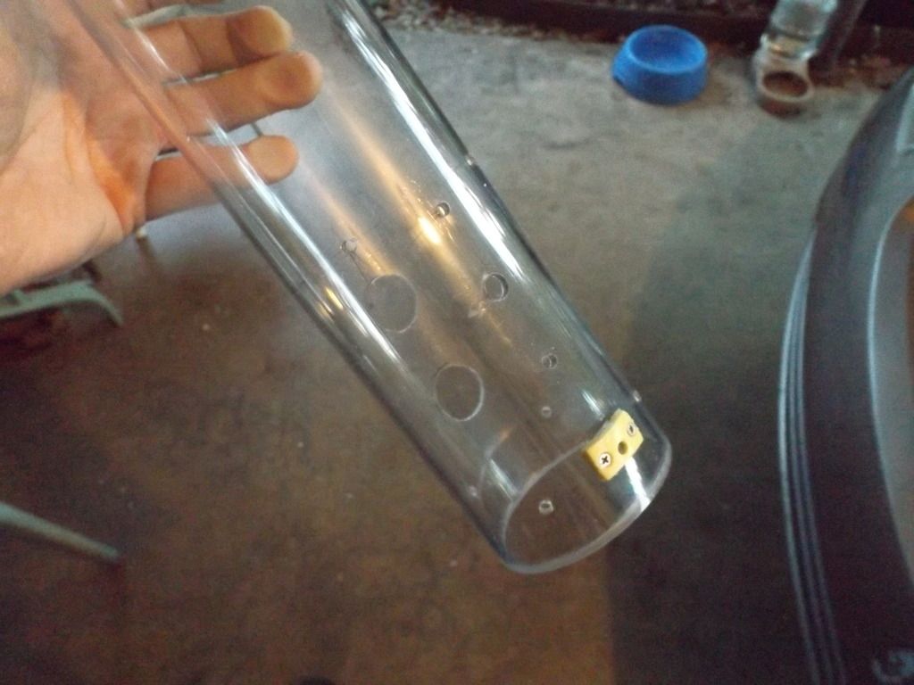

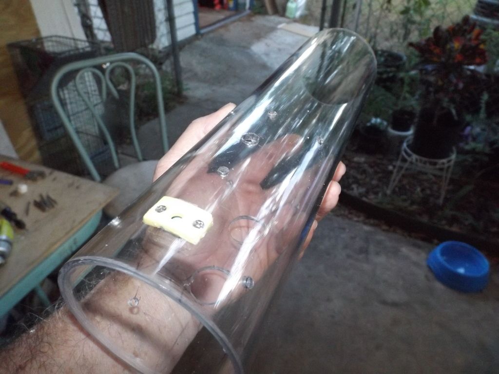

                Today I cut the new 3" diameter portion of the WTC to length, drilled the holes and tapped the 2/56 screws for the vent. I ended up adding a 1/4" of length to the battery compartment to help with all the stuff in there. Next will come the removal of the equipment from the old WTC and there install in this one.

                  Are those cracks in the holes you punched into the Lexan?!...... what are you using, a Mason's bit?????
                  You people!
                    #684
                    Cracks? No, no cracks. I think what you are seeing are the fine marker marks that I used to locate my holes. No cracks I assure you.
                      • 14010
                      #685
                      Are you ... shhhuuuurrrrreeee?
                        #686
                        Yep. I also know that you are just messing with me, trying to get a rise out of me. I know you!
                          • 14010
                          #687
                          (busted)....

                              Re cracks in the lexan tube. - David I have always used a drill press, cradle for the WTC and stock standard plastic/ wood / drill bits, and drilled small pilot holes first. What technique do you use to ensure there is no cracks forming?
                              Cheers
                              John
                              sigpic
                                • 14010
                                #690
                                Cheers
                                John
                                Nothing special for Lexan. Standard drill bits at moderate speed and feed.
