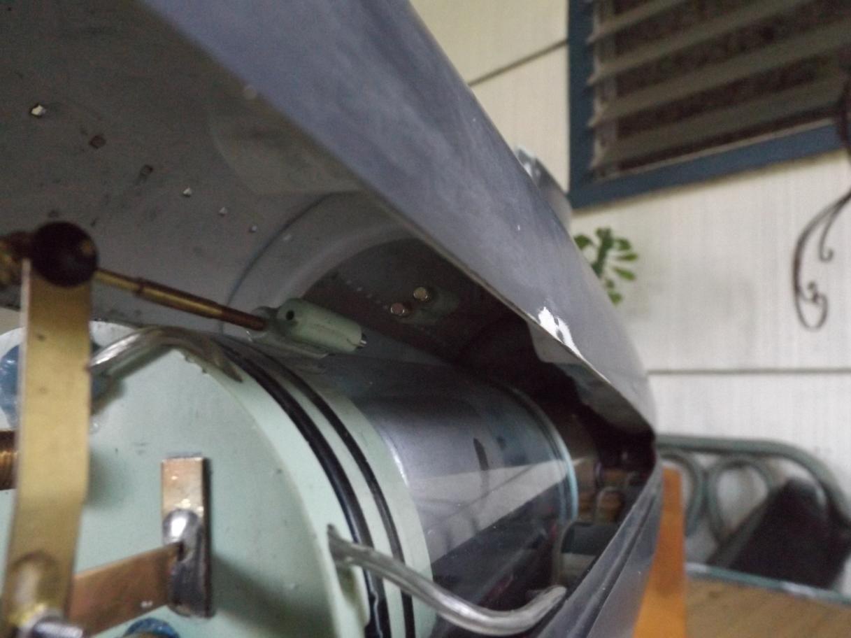

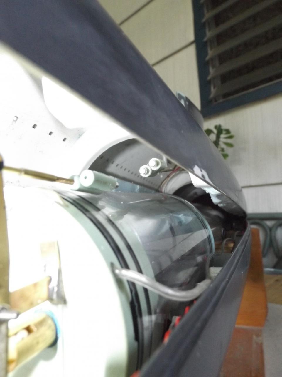

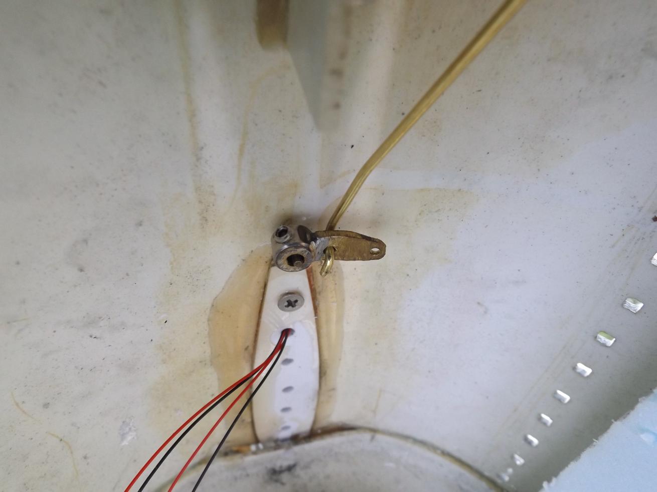

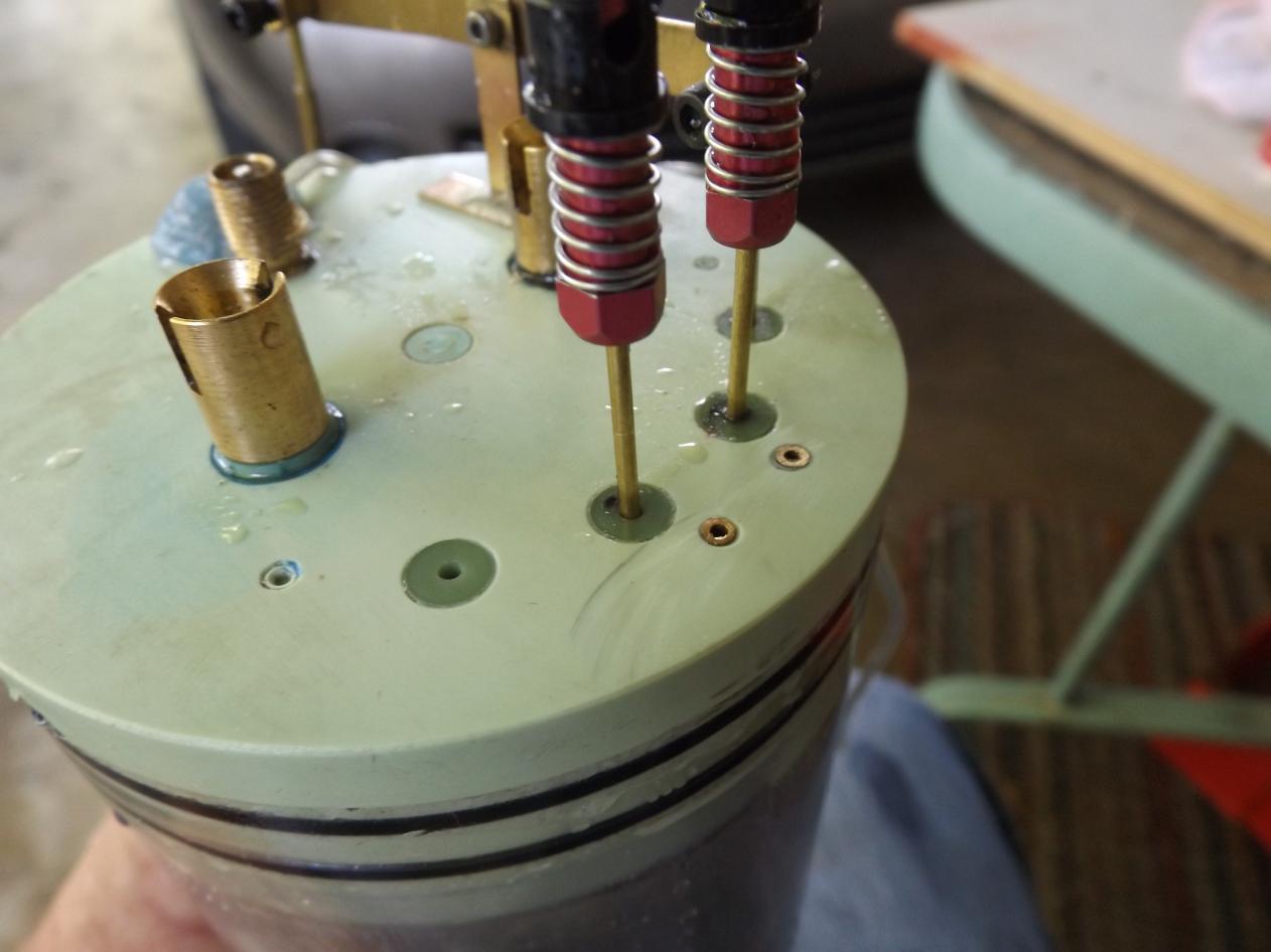

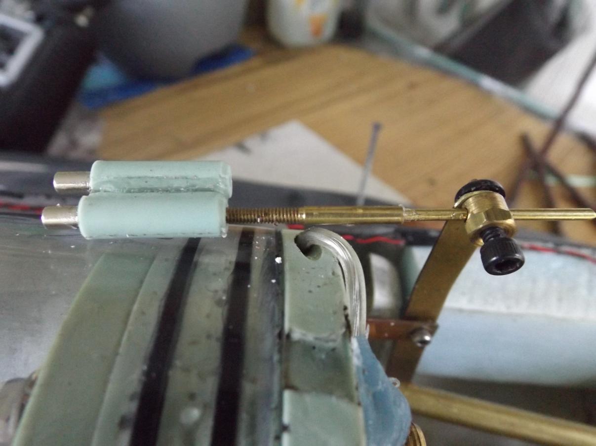

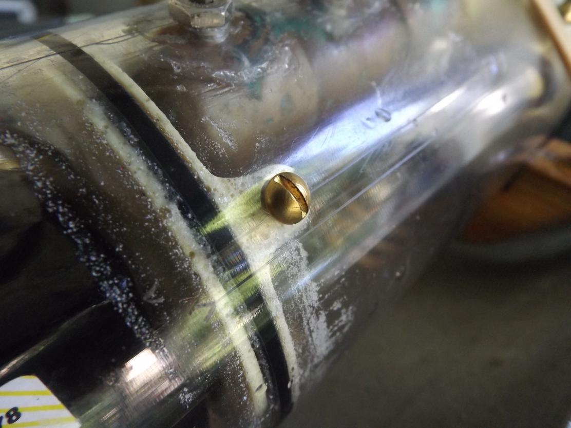

      Into the kiddie pool it went without the top on it so I could see if water was getting into the wrong places. I didnt like the number of Air bubbles appearing at the back of the Sub-driver and escaping to the surface. So I pulled it out to find too much water in the engine space. It came from the extra pushrod seal and the two brass tubes for the SAS not being sealed off. Also, my brilliant idea of not countersinking the ballast tank header screws was fine.....................except that I forgot to put some CA around them. After that was taken care of I put her back in da water. The trim is way off, so Ill have to deal with that next weekend. The good news is that at full throttle youd better hang on to it. Its got quite a pull on it in the pool. Also the stern planes are ROCK steady at all rpms, which is what I was trying to achieve. So next weekend the trim and the LED hookups.Click image for larger version
