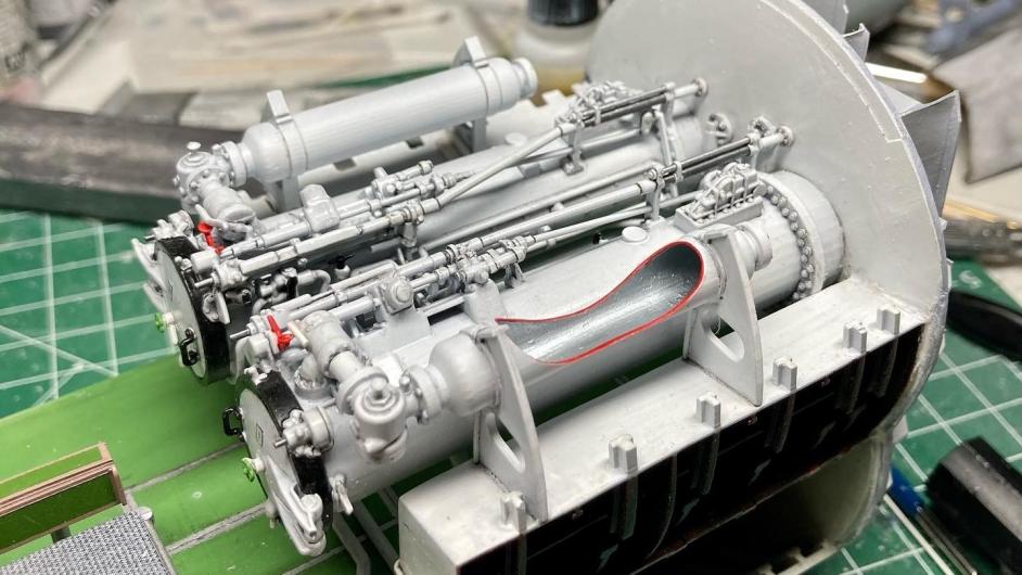

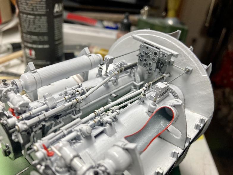

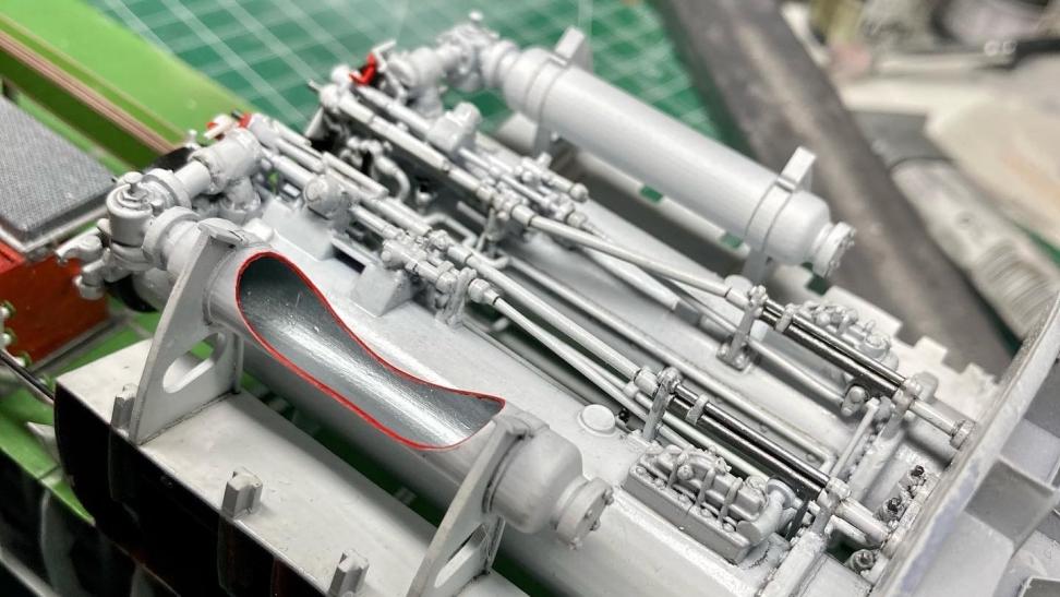

                Worked some on the torpedo tube assembly. Between the tubes and the pressure hull wall were two compressed air bottles that contained the air used to expell the torpedos. I installed both, but as the starboard bottle would have excessively blocked the view inside the torpedo room, I depicted it hollow and cut away. Like it allot!

                        The interior will go into a 1:35 Bronco XXIII kit
                          #252

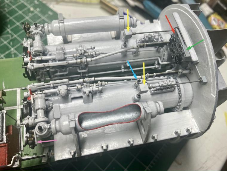

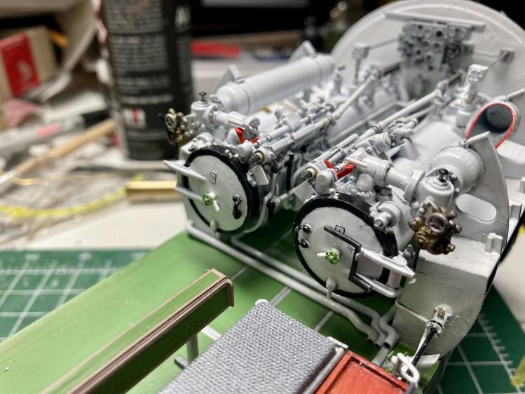

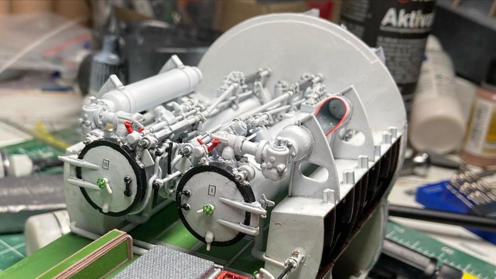

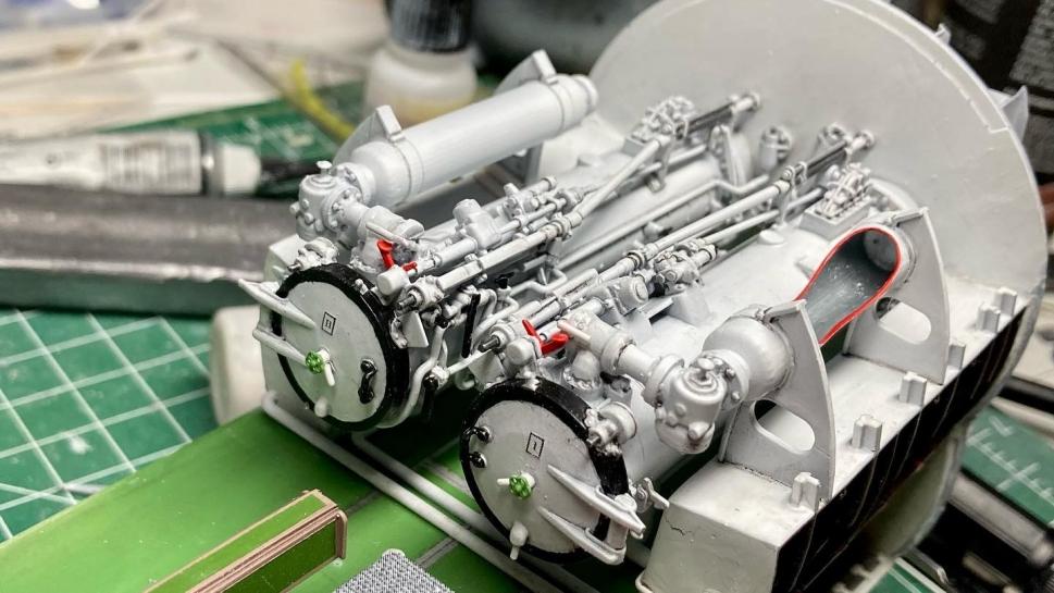

                          Worked a bit more on the details of the torpedo tubes. I installed the depth setting gears (blue arrow, port one is hidden). The running depth of the torpedos was set manually. Via a plate one could drive a shaft into the respective socket in the torpedo and then, via a hand crank, one could set the running depth. The gyro angle for the torpedos was set via gears (yellow arrows) and shafts via a hand crank below the gyro angle receiver (green arrow). The shooting solution was calcuulated using a "Torpedovorhalterechner" (torpedo data computer, red arrow). I also added the "Ausgleicharmaturen" (torpedo control panels, pink arrow), that were used to flood and vent the tubes. Via a angled adapter plate they were directly screwed onto the firing valves. The firing vales sat directly on the compressed air bottles. As a neat detail I added the hand crank, used to operate the muzzle doors and torpedo hatches, to the starboard torpedo hatch.
