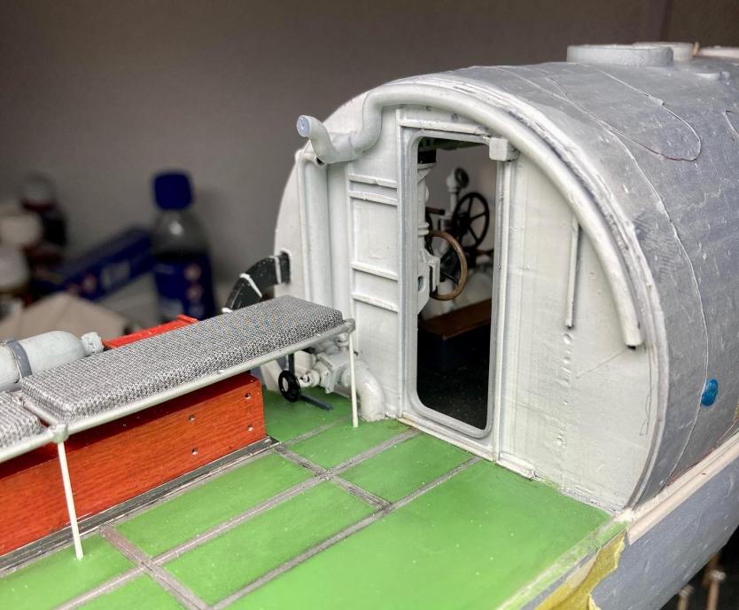

                A little bit of progress on the bow torpedo room. I printed, painted, and added the foldable tables. Also the curtain on the door to the control room is done and found its place. So the back part of the room is getting ready. Next will be the front part with the torpedo tube assemblies.

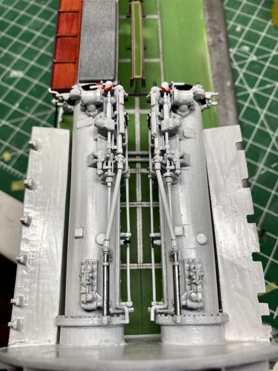

                                A little bit of progress. This time the two torpedo tubes that were printed in one piece. Took several tries, but now I'm quite pleased with them. Only the hand wheels on the hatches had to be re-printed and the loccking levers were replaced by styeren profiles. I then glued the tubes to the bow bulkhead using epoxy to have a bit more time for adjustments. Finally I glued the feed throughs for the sea water hoses into place. Now I have to belnd in colors with some washes. Getting there.....
