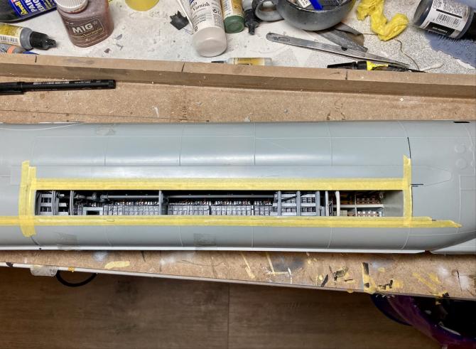

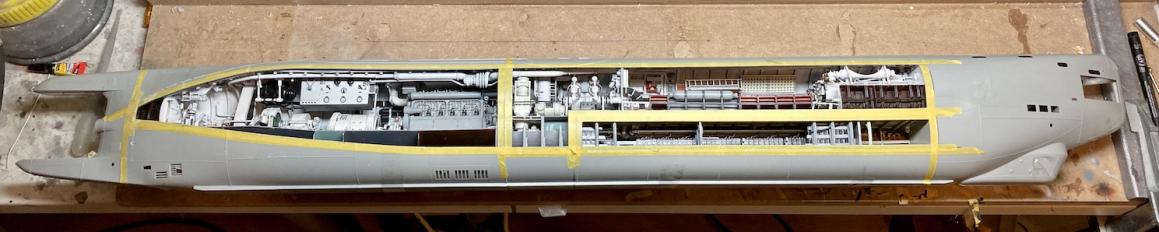

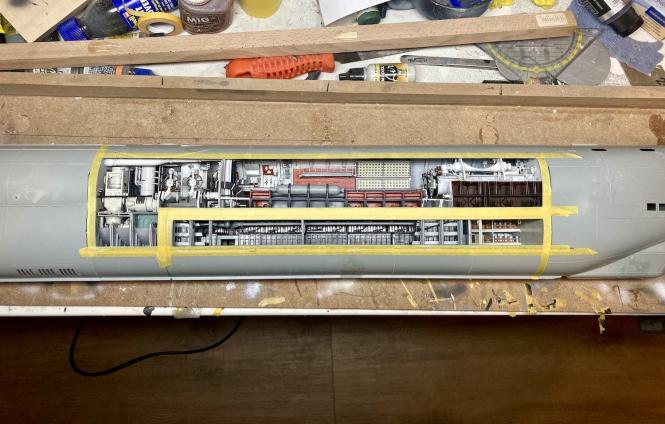

        Had the patience and guts to start making the cut out on the starbord half of the hull. First taking precise measurements, then starting way smaller, and then opening the cuts to the final dimensions. Slow and messy, but one ends up with the right look....

          #304

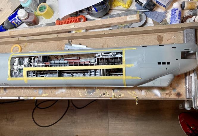

          Last one for this year....

            Would be nice if you add some crew members.
              Andreas,
              In its full glory! Beautiful! "Happy New Year"
                I have some…

                  #308
                  Andreas,
                  "Firemen can stand the heat."
                  Andreas - That’s fantastic!

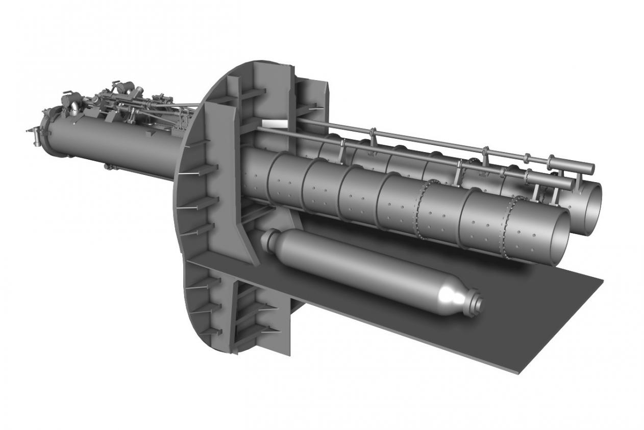

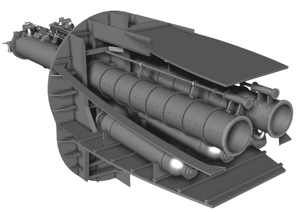

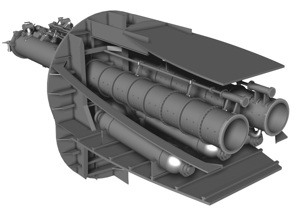

                        Now that the pressure hull and the openings in the fuselage approaching the finishing line, one can think about what else to display. For the bow I'm thinking about the space between the pressure hull and the muzzle doors. For the XXIII that'd be the forward ballast cell with the both torpedo tubes and the forward pressure bottles. The oil bunker below won't be displayed, and I think I'll keep the muzzle doors and the respective cowl panels closed, too. That's what I got so far in the new year...

                          Very nice 3D modeling work there Dr.
                            #313
                            Thanks...and the prints look good to ;-)

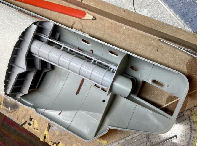

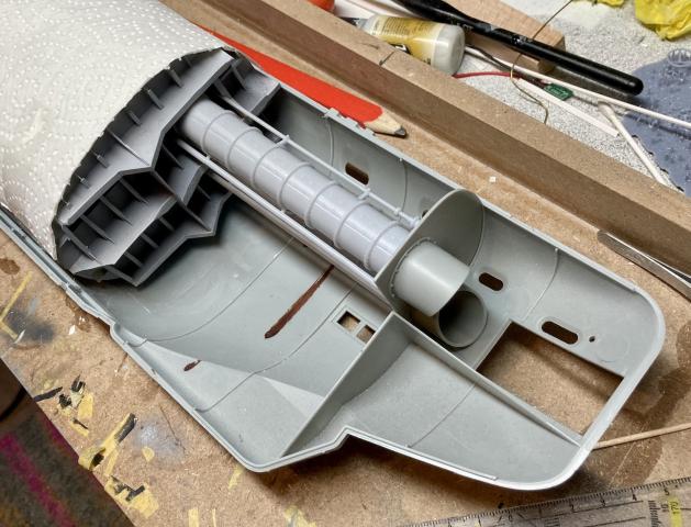

                            Made a fitting test and this seems to work out quite splendidly.
