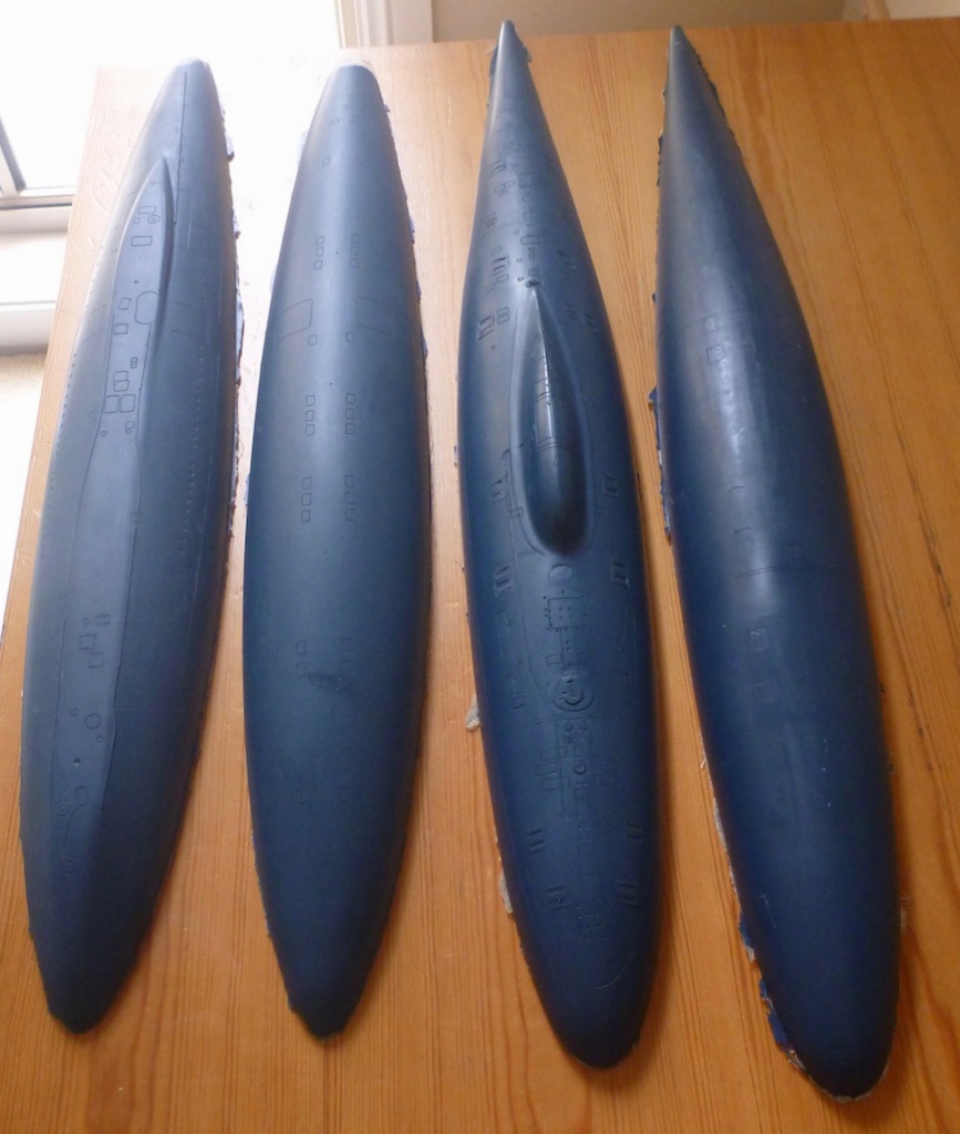

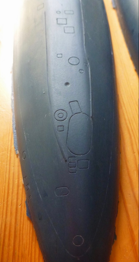

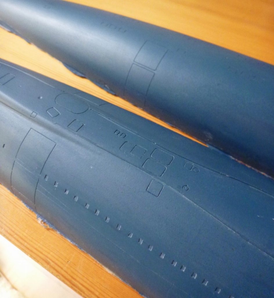

                                This is the first production hull for the Albacore. The gel coat is made by a company here in Australia called Technirez and I have to say that it really works. Who would have thought that using correct tools, correctly would result in a better job!

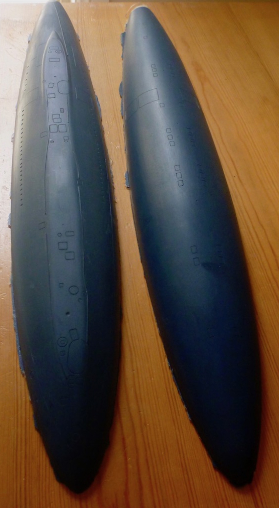

                                And one of both the Beluga and Albacore together.
