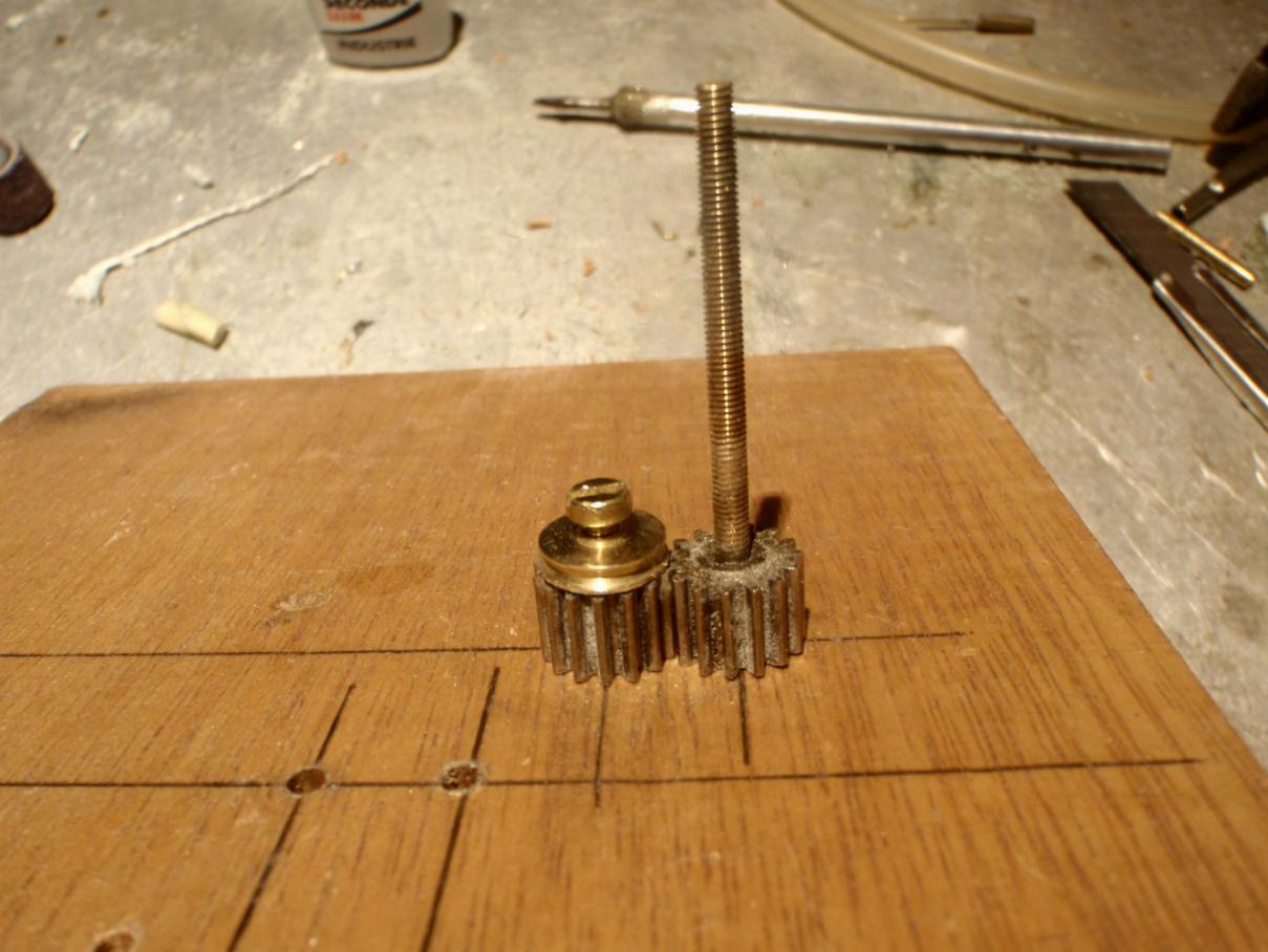

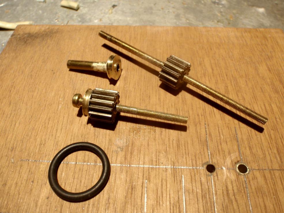

              I can blame Bart for this, this evening i made a kind of mockup of his idea.
              These are the needed parts

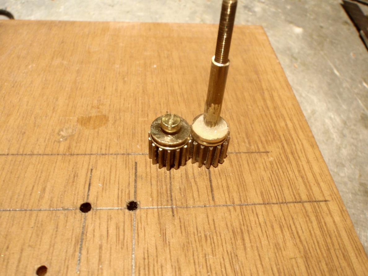

              Step one, placing the gears together.

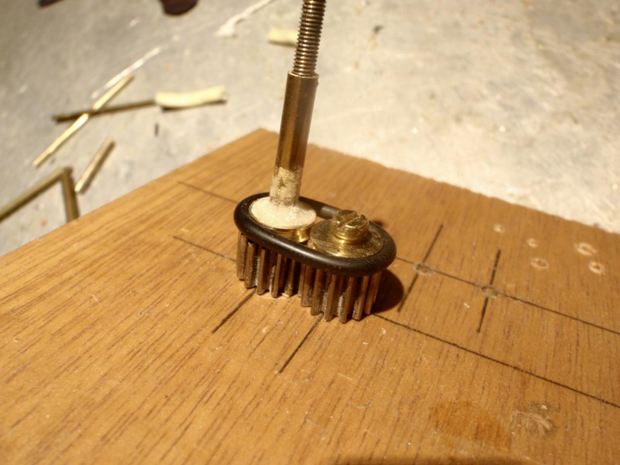

              The tube which will contra-rotate placed.

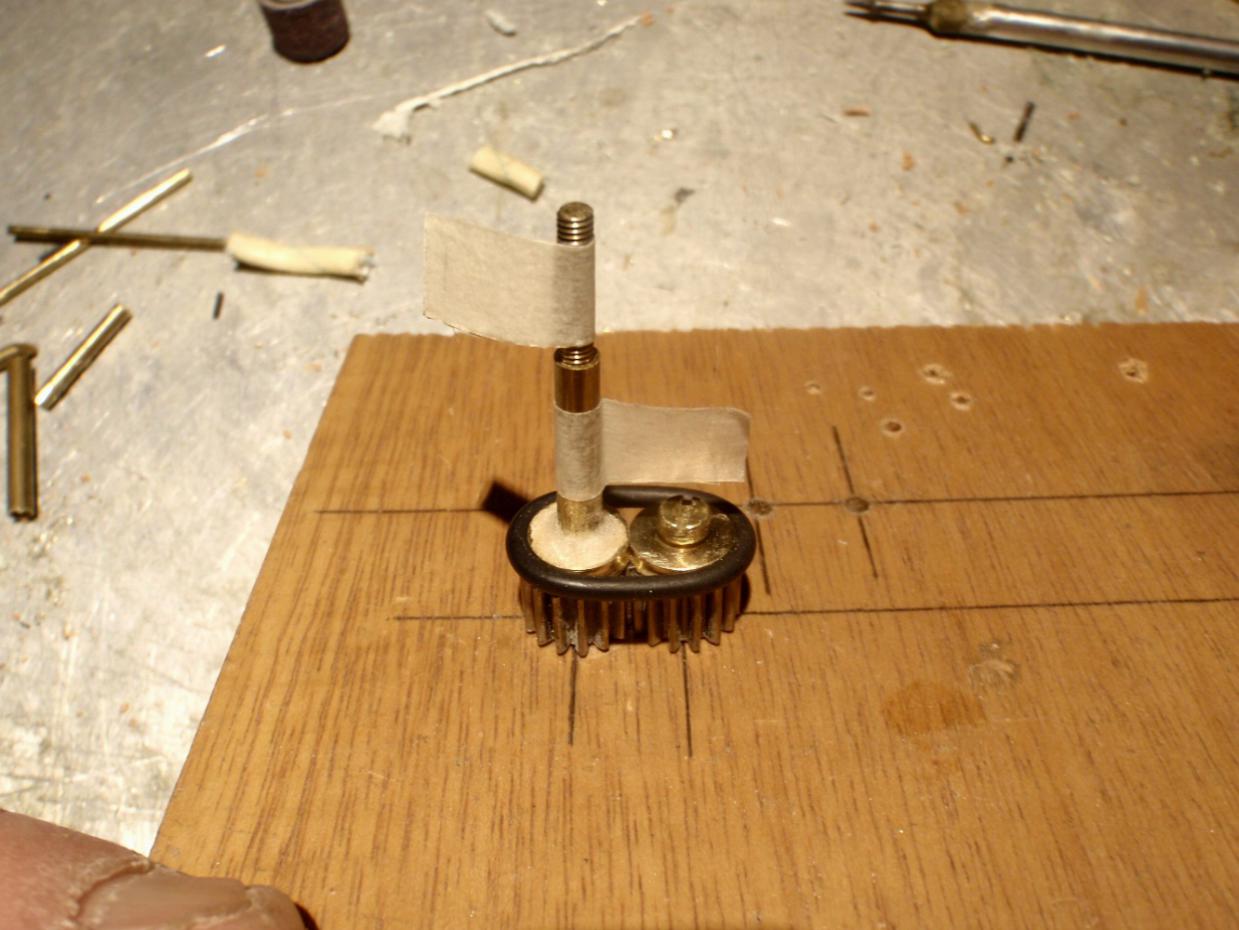

              Placing the needed O-ring
              Ready for a testspin.
              To my amazing it worked like a charm, it has some more friction due to the tension of the O-ring, more as my other gearsystem, but the idea can be used, all things where quickly glued together with CA and some baking soda.
              The size is only 1/4 of my other gears, and more important it's light and simple.
              Manfred
