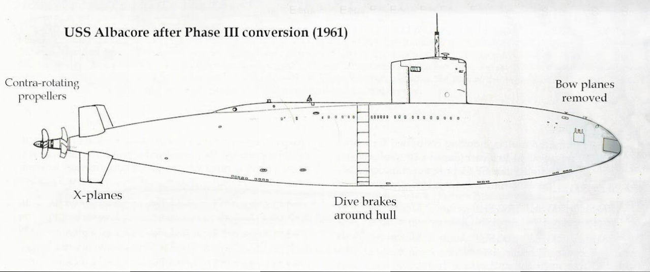

    good choice!
      Functional dive brakes?
      • Davidh
        • Nov 2010
        • 719
        You going all soft on me doing an American boat?
        Dave H
        • Peter W
          • May 2011
          • 511
          I'm with David here, that isn't Russian.
          Peter
            Busted. I'm sure that the original Russian plans were lifted by the CIA, and the rest is history. Anyway, its a nice size and it just looks GREAT! Oh, and it had dive brakes for god's sake; actual dive brakes.
              • 3746
              That is a scary thought, dive brakes being needed on our subs! This thing must be a rocket!
              Like your other builds, I look forward to learning from you.
              • gantu
                • 428
                Regards Gantu
                  Thanks Mate. That's a new photograph for me.
                    Do you have any more photographs of the brakes? Specifically, where they were located and how many there were. The photograph that you posted shows them further towards the rear than the proile sketch that I have. They also appear to be bigger. I read that there were ten in total so I'm assuming that they were equally spaced; five on each side; none on top and noe below? Also a photograph of the orward escape hatch would be good.

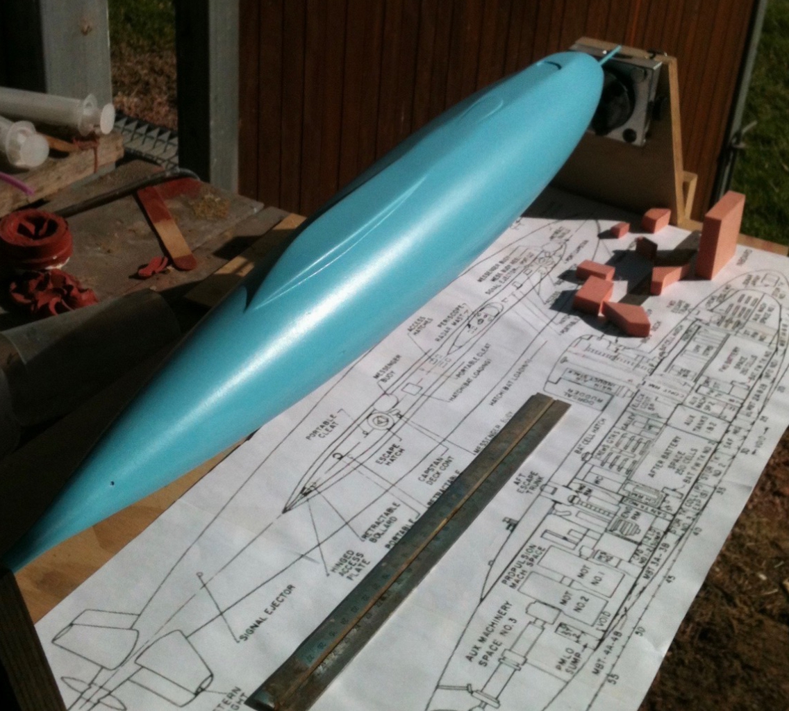

                      This is the progress so far. The basic hull shape is done but there may have to be some revisions when I get hold of the more accurate set of plans that are being sent to me. Stand by for change!

                        • 13973
                        Damned good start on the hull there, Scott. Are you going to cut off the tail-cone and produce that as a separate, hollow cast resin piece like what you did with the BALUGA? Doing so will give you the options of producing not only the phase-3 on up versions, but also the phase-1 and phase-2 versions with their very own unique features at the stern.
                        For the uninitiated: I'm working with Scott on this 1/96 ALBACORE kit. I'm working up the propellers, sail, masts, hatches, and control surfaces.
                          I love those drawings. The plan is to mount the hull on the jig and do all the marking out then decide on the best place to make the tail cone seperation point. I'll hollow mould the tail tone with options for each version ( which will reall just be the locations for plane shafts, I guess). I'm still battling with the National Broad Band Network to get some sort of bandwidth down here. Frustrating.
                            • 13973
                            Yeah. They're BuShips/NavSea drawings from the piping training aid book (TAB). A few flaws I've found have been corrected and on the copies I sent you, Scott. In that package are also copies of pictures Ellie and I took from a visit to the boat, now a tourist attraction off I-95. Also enclosed is a copy of an article I did for Sea Classics nearly forty-years ago …. yikes!
                            Send me three copies of that tail-cone and I'll build up phase-1, and phase-2 tail feathers and turn those units into production masters. Of course that means I'll have to build masters, tools and parts for the bow planes, and two more versions of the sail.
