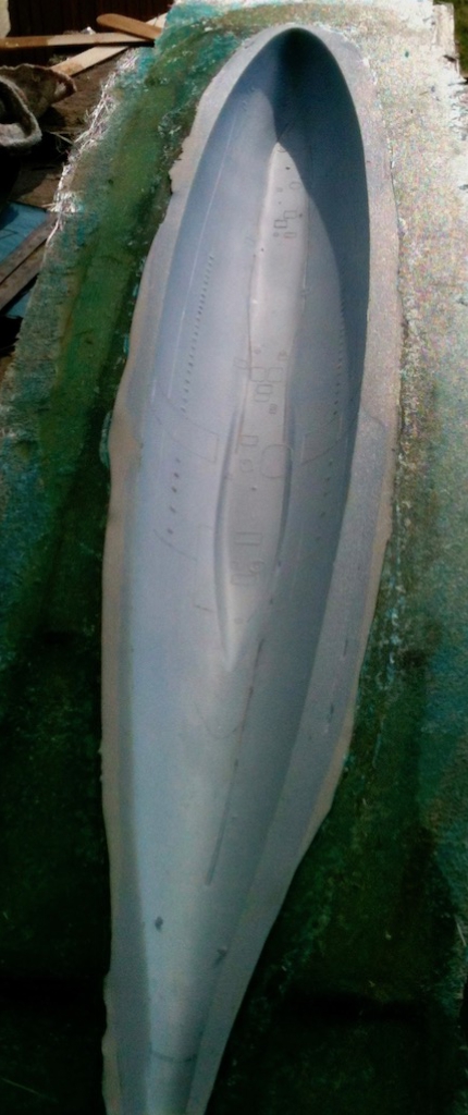

                    Progress. The moulds are done. Just waiting on the gelcoat to arrive.

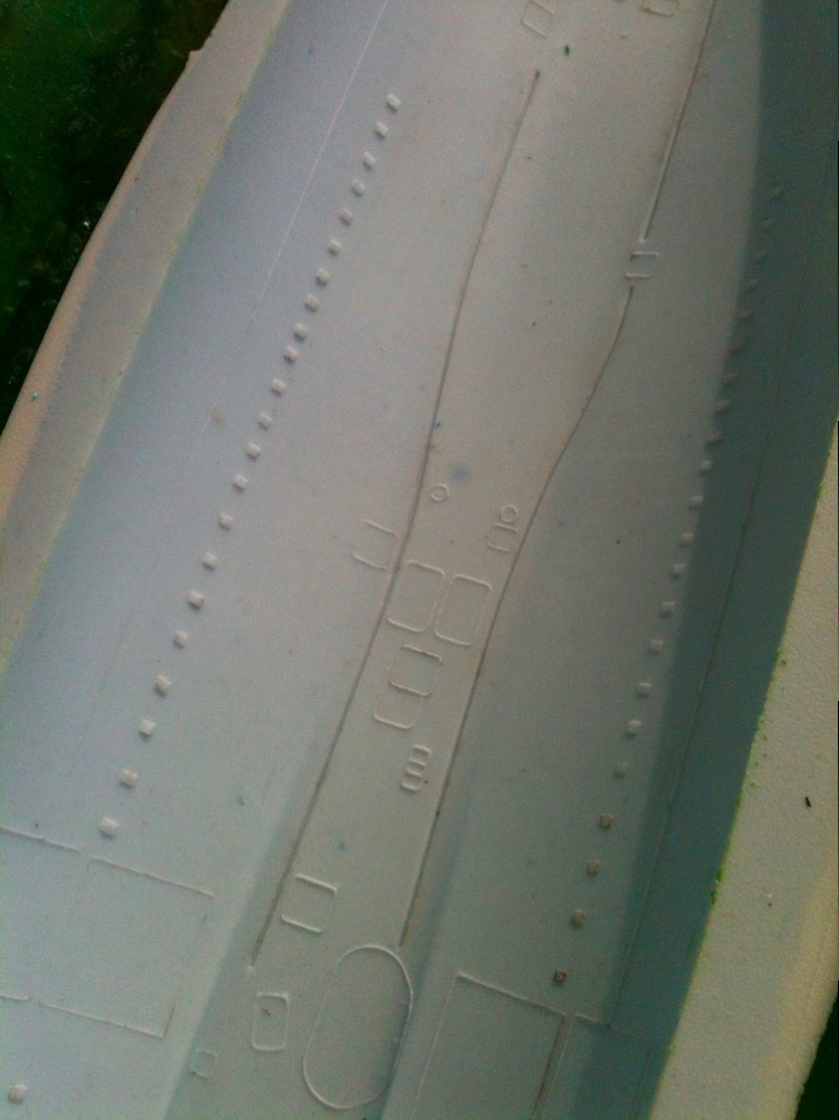

                    The detail looks to be OK.

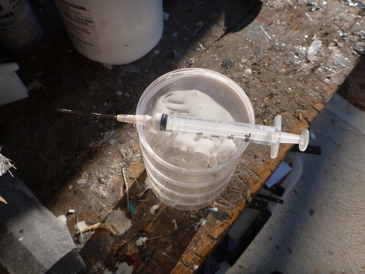

                      The moulds have some flaws in that there are air bubbles below the surface that translate into lumps on the surface of the moulded parts. This is the fix
                      The idea is to inject the silicone, squeeze out any air, tape over the hole and let it go off. Seems to work OK.

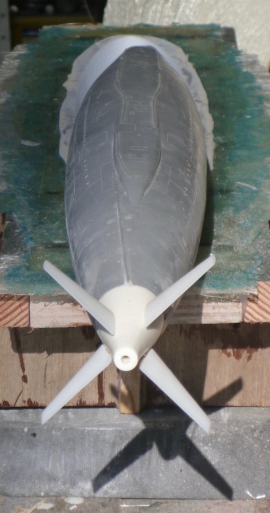

                            Time I kicked in a bit too on this project -- keep up my end of the deal. Refining the fillets and finish of the two propeller masters was today's work:
