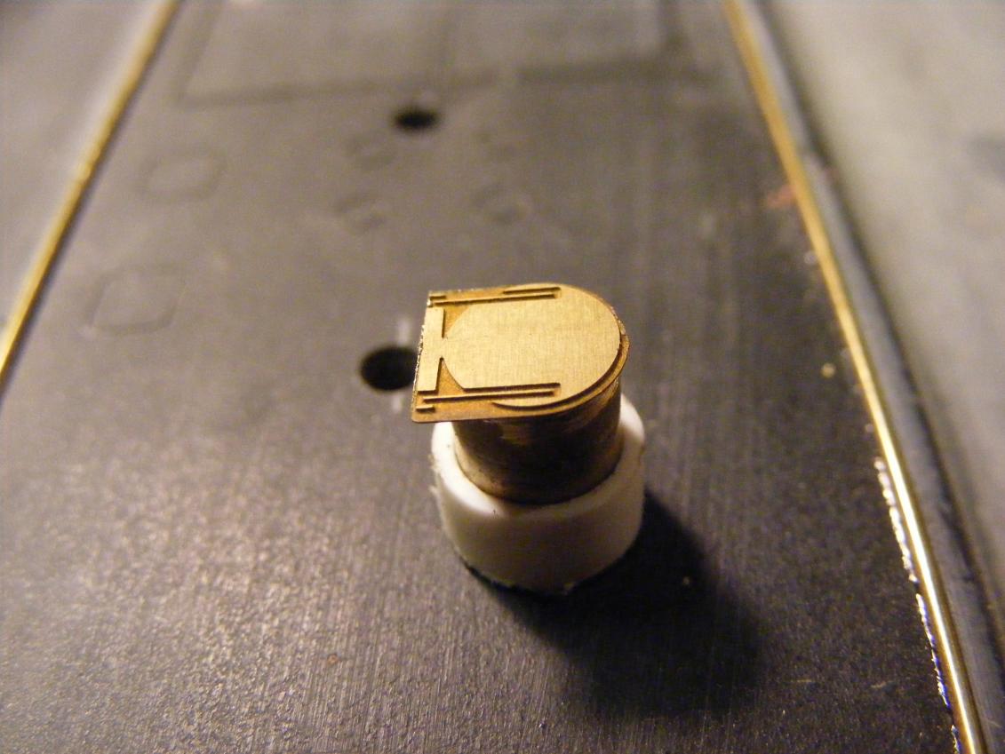

I actually found a plastic button at the sewing store already had the right arch to it for the rescue buoy on my type II uboat. the type that has a loop on the back that the thread passes through (not with the four little holes that go through it) all i had to do was cut the loop off the back and make the little detail on the top.[ATTACH=CONFIG]8733[/ATTACH]
This drawing shows the rescue bouy marker. Ill have to make one of these. Ill start with a plastic washer at 3/4" dia. Then ill apply some two part stiff apoxy to the top of it , than shape and sand it down to shape. Unless somebody has one already????????..........

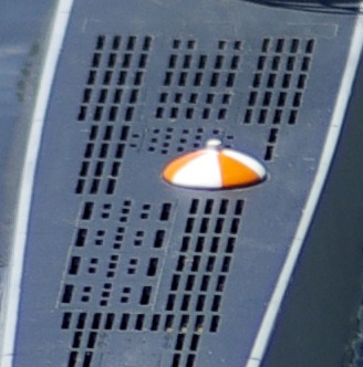

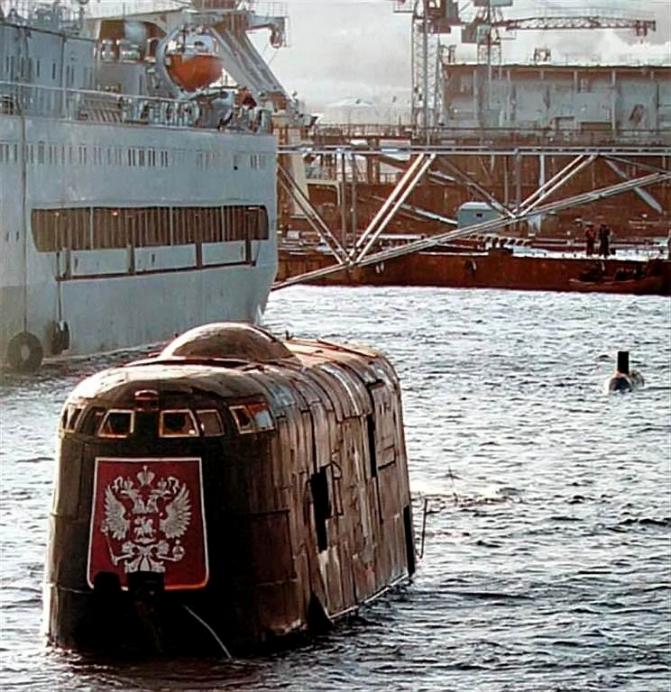

Here are some examples of the bouy marker that I am trying to reproduce.IT TAKES GREAT INTELLIGENCE TO FAKE SUCH STUPIDITY!Comment

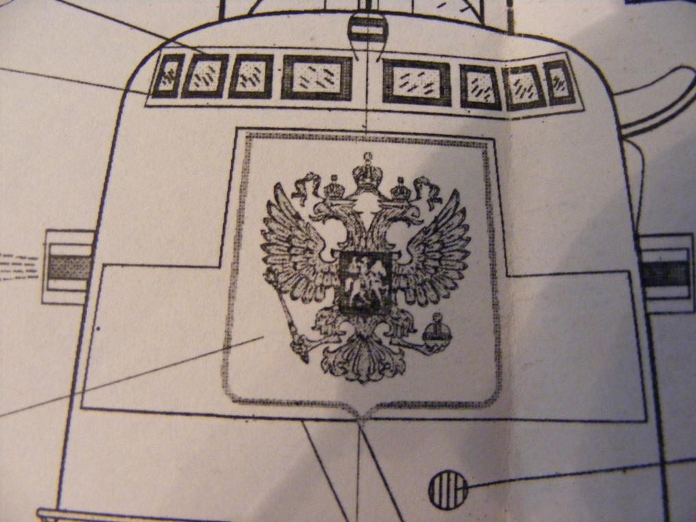

The emblem on the front of the sail on my dry transfer sheet is white. From these pictures it becomes apparent that I will have to paint a rectangle of red on my sail before I transfer the white decal. This looks like a job for Mr. Airbrush! I hope that I can find it.IT TAKES GREAT INTELLIGENCE TO FAKE SUCH STUPIDITY!Comment

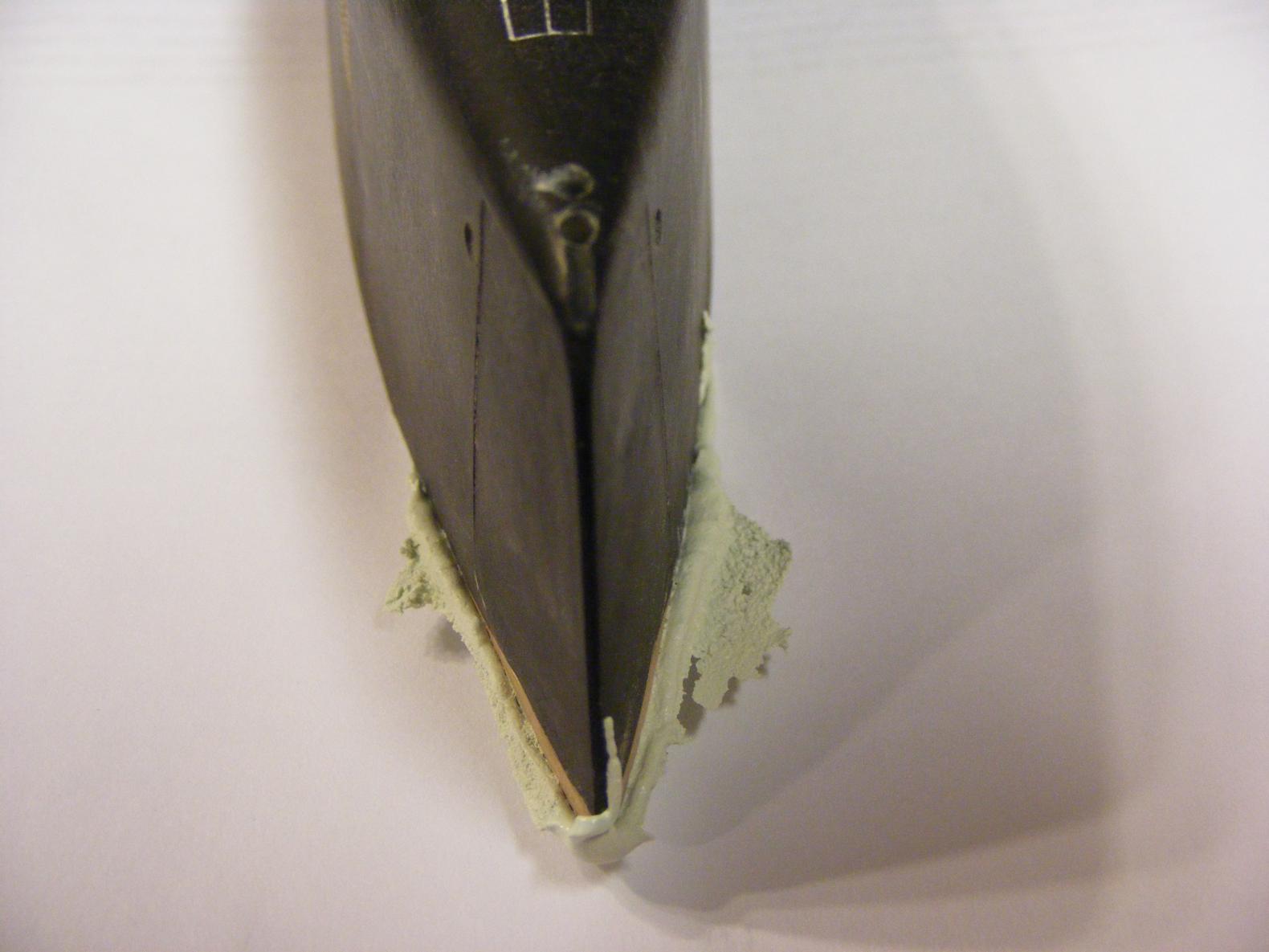

I finished all the scupper grilles last night and all the Bondo sanding. Now the next steps will be to re-establish the line between the upper black painted areas and the lower red painted areas. This line on the bow is gone because of bondoing the seam and sanding. I will use my laser projector to show me the line and then ill mark it with a pencil so that I can mask a correct line.IT TAKES GREAT INTELLIGENCE TO FAKE SUCH STUPIDITY!Comment
Hi Mark,[ATTACH=CONFIG]8733[/ATTACH]
Are you fishing to add yet another McLeod part to your OSCAR? I'm sure we can work something out...Kevin McLeod - Oscar II driver

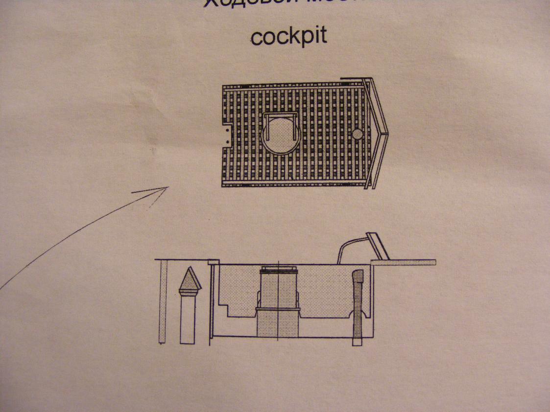

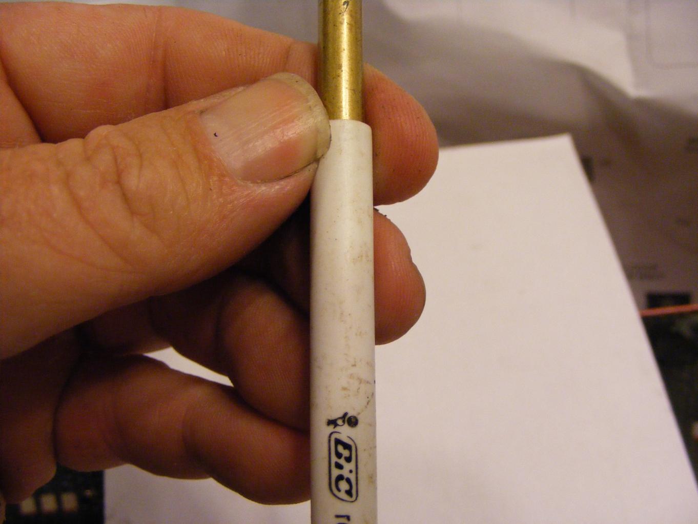

In this picture, if you look in the bridge opening of the sail , you can see a large diameter tubelike structure with a hatch on it. Thats the hatch that goes down thru the sail.
And here is the drawings detail of it and the bridge detail.

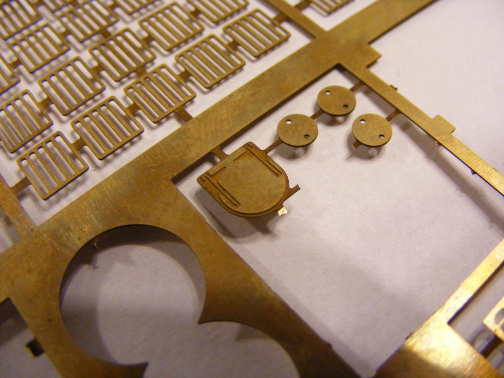

So then here is my rendering. The hatch shaft I made from brass tubing , 1/4" dia. and a Bic pen stub. The hatch itself came from the brass detail parts supplied.IT TAKES GREAT INTELLIGENCE TO FAKE SUCH STUPIDITY!Comment

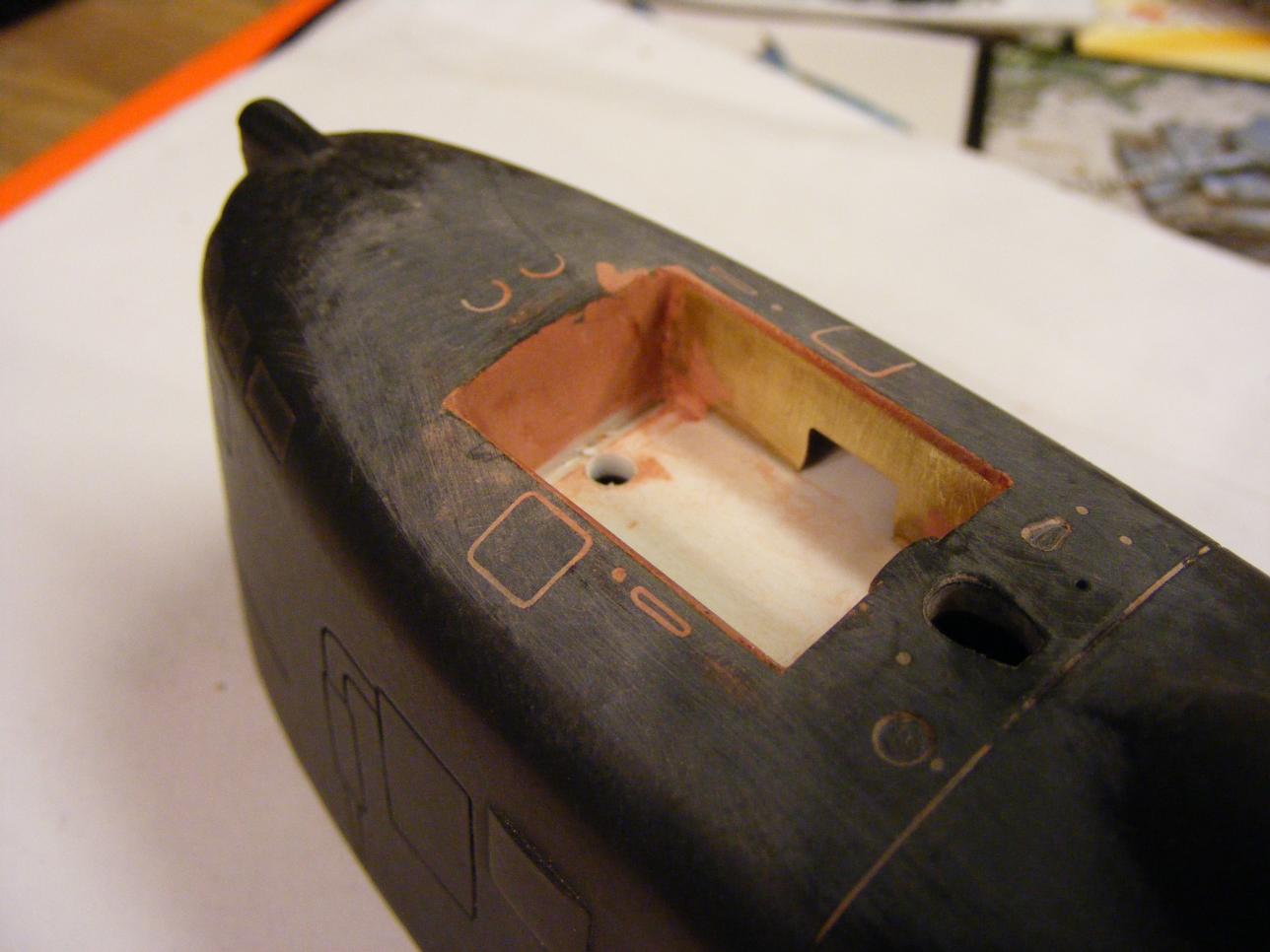

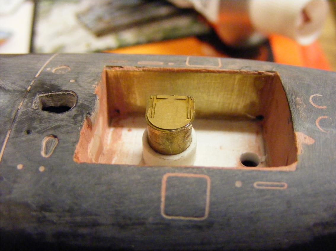

Of course the bridge internals will get some more putty and sanding to make it ready for paint. The hole you see in the floor of the bridge is for the forward periscope.IT TAKES GREAT INTELLIGENCE TO FAKE SUCH STUPIDITY!Comment

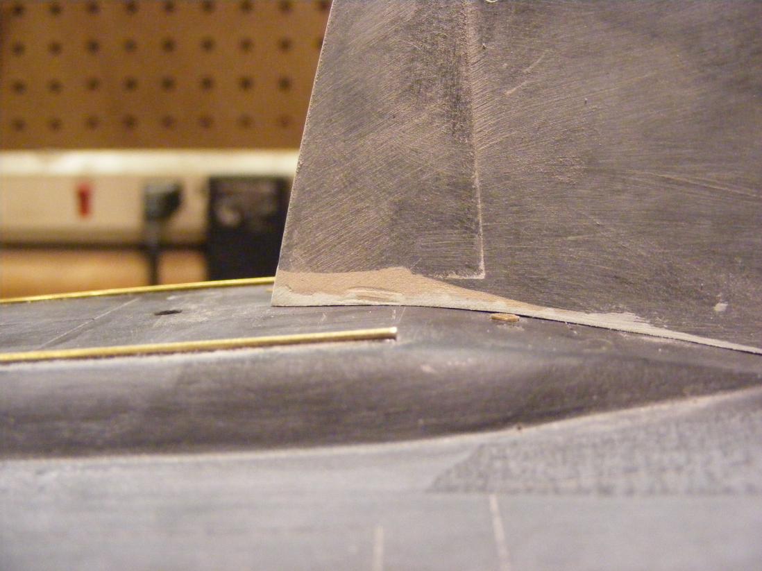

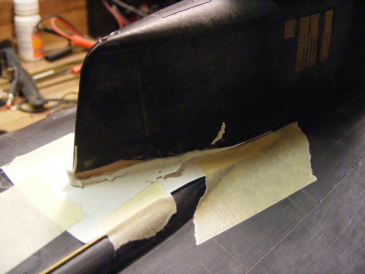

This is the rear of the sail where it joins the deck and you can see how the bondo has shrunk leaving a gap. To address this I did the same thing again with taping down to the deck a piece of freezer paper and applying Metal Glaze to it and "Smooshing" it down on to the hull on premarked lines.
Here you can see the results.
