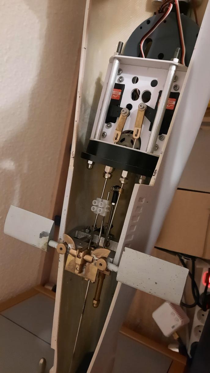

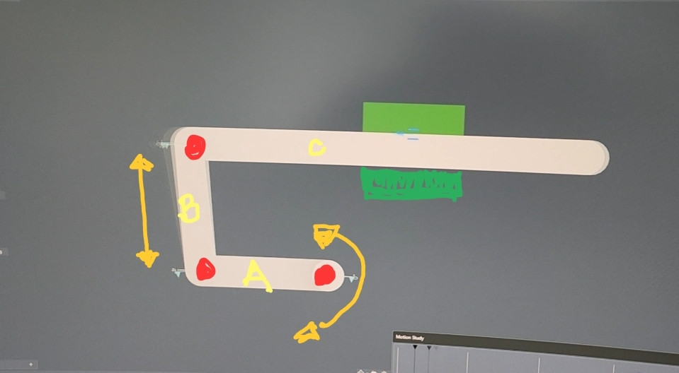

      Wouldn't it cause bending the control rod?
      As configured, yes. If you choose this method, you should use two bearing spred as far apart as possible to support the push rod.

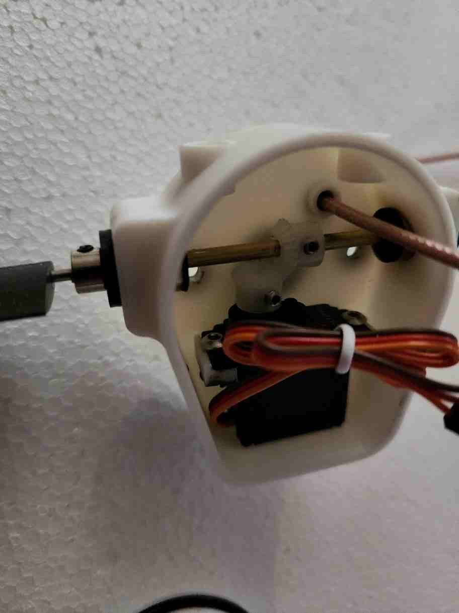

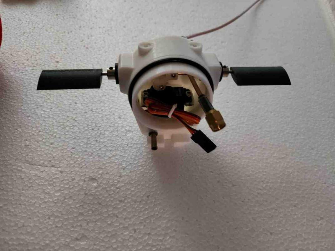

        Has anyone else tried bevel gears? They are 95% mechanically efficient.

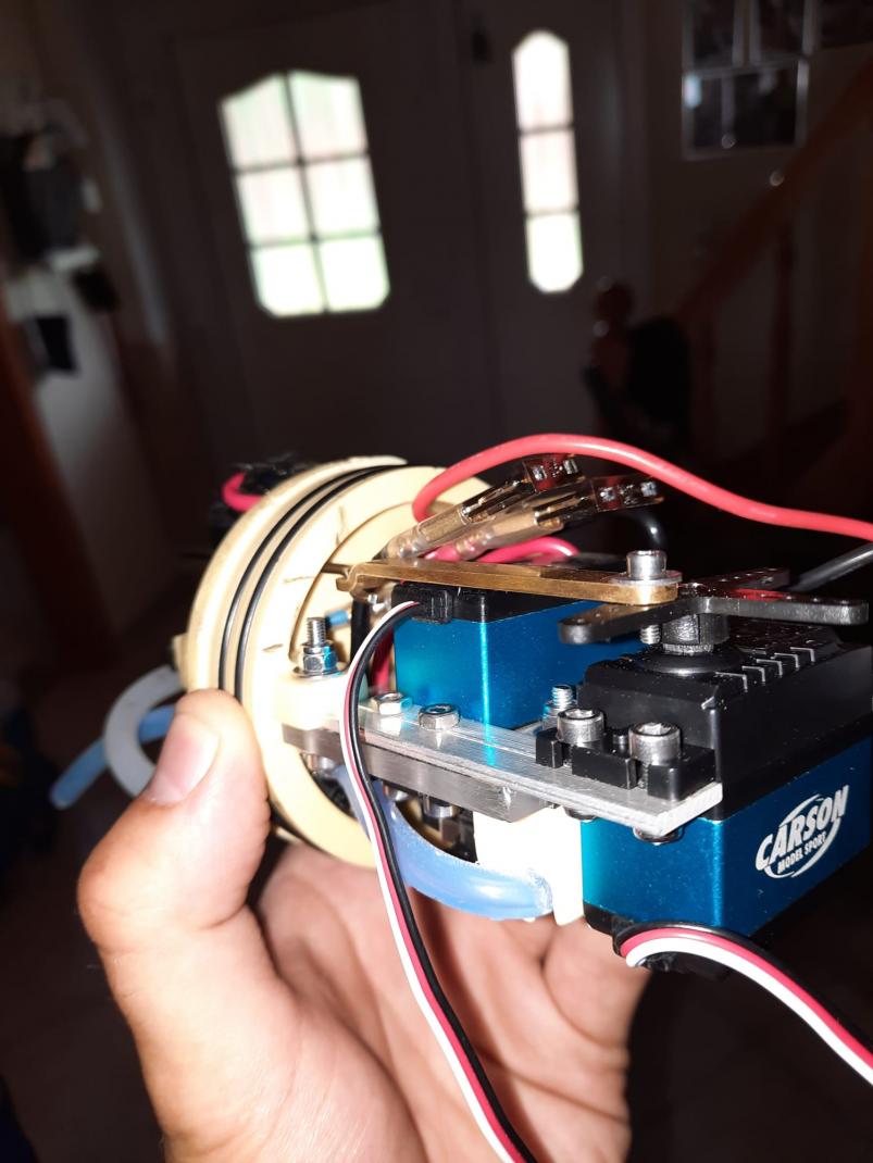

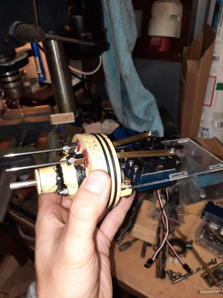

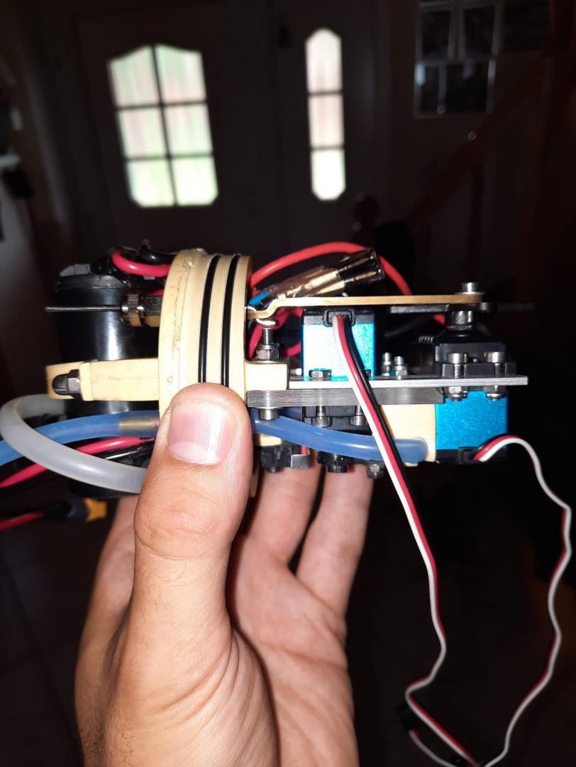

              My solution:
ID:	194847 Click image for larger version
              • Ed Kirk
                • Dec 2025
                • 91
                Excellent. Thanks for the video. Proved your point. Has utility.
                Nice - clean.
                  Originally posted by TuptubBuilder
ID:	194840 Click image for larger version
                  Interesting endcap you got there TuptubBuilder. Can you share some more info? Thanks
                    This is an excellent expose on linear servo solutions. Need to book mark this.
                    • TuptubBuilder
                      • 153
                      It's a modified RC-Shipyards WTC. I would elaborate more but I'm dealing with a family emergency.
