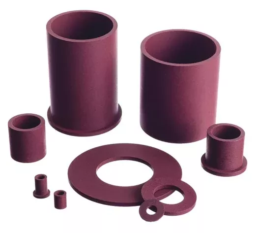

              5 minute assembly, Rulon bearings, Pushrod can can angle off center.
              I NEVER have moisture in my boats.
              A simple 1/8" pushrod seal
              FWIW, yes you can put Oilite in the wet, but Rulon (Also McMaster Carr) are designed to BE in the wet. NEVER need re-oiling. More forgiving in angular and concentric misalignment over time. Berfect for shaft component not only for shaft alignment, but thrust bearings.
