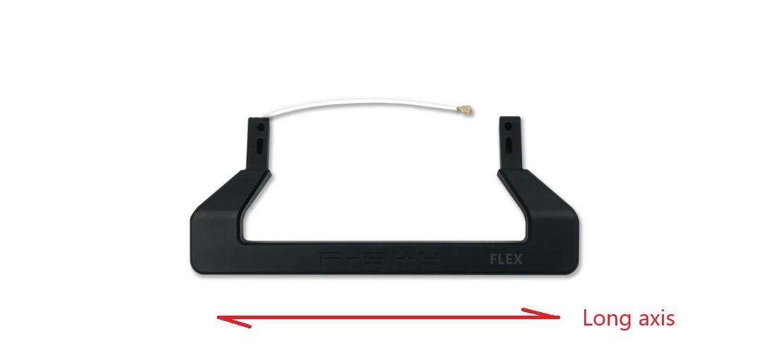

            Click image for larger version  Name:	Screenshot 2023-12-26 071436.jpg Views:	0 Size:	35.7 KB ID:	176926

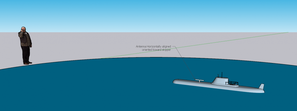

            The 900Mhz antenna in the X18/X20: So the emission "donut" wave pattern is perpendicular to the long axis of the handle. So if you're holding the TX between you and the boat as one normally does, and have the aforementioned long axis at right angles of the imaginary line to the boat, the "donut" is radiating at YOU and the boat up to the sky and down to the ground. As long as you're pointing that handle side to the boat, you're keeping it WITHIN the imaginary tire whose center is at the handle while pointing at you and the boat right angle to the horizon.
            From my understanding of what I've been researching anyway.
            Graphically represented like this...​
            The donut radiating from the TX naturally held pointed at the boat. You're at "Y", the long axis of the handle is represented by the "X" axis through the center of the donut. So the target boat is within the maximum radiation output of the TX. So would a drone be at 45 deg up or directly above you! For the record, this is in opposition to our 75 Mhz radios whose radiation donut is at right angle to this. Pointing those antennas at the boat as I've seen so many do is bad! Best way for those of course is keep the antenna pointed at the sky!
            Here is what the dipole antenna would best "see" from the boat's perspective, if placed optimally. The boat has now good possible reception across the horizon in any direction she's headed. The next best thing would be to angle it 45 deg or so. If laid flat along the long axis of the hull, it would match the TX pattern and would see best athwartships, when she's running at right angles to you.
            A good way to visualize best pattern matching as if the two "donut's" were two joined "links in a chain". TX vertical, RX horizontal.
            The point being for best performance, sorta point the handle (top of the TX) in the direction of the boat. While one should orient the RX antenna as best as one can, it's NOT a deal breaker and we'll no doubt see this proven over time. If you turn in place bringing the boat off in either shoulder direction, you have the least performance. The nice thing is as long as the handle (screen end) is pointed toward the boat you can hold it vertically or horizontally. It probably doesn't help to be like me gesticulating like a madman when speaking. No, don't be an "Ed".
                GOOD:
                NOT IDEAL:
