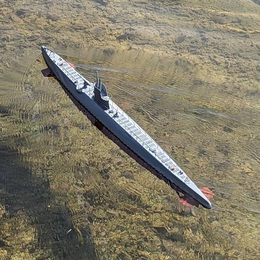

          BTW, I refitted a KRICK U25, now using LiPO, Brushless Motors, new shafts, clear lid, and above all, 900Mhz!!.
          Before...
          After...
          .Here's a video snippet of her by Bob himself at a previous run we did together. It starts at the Krick, but be sure to watch the whole thing.
          More Seaview progress, an RC boat battle and more - Update from the Nautilus Drydocks - 12-16-23
          v/r "Sub" Ed

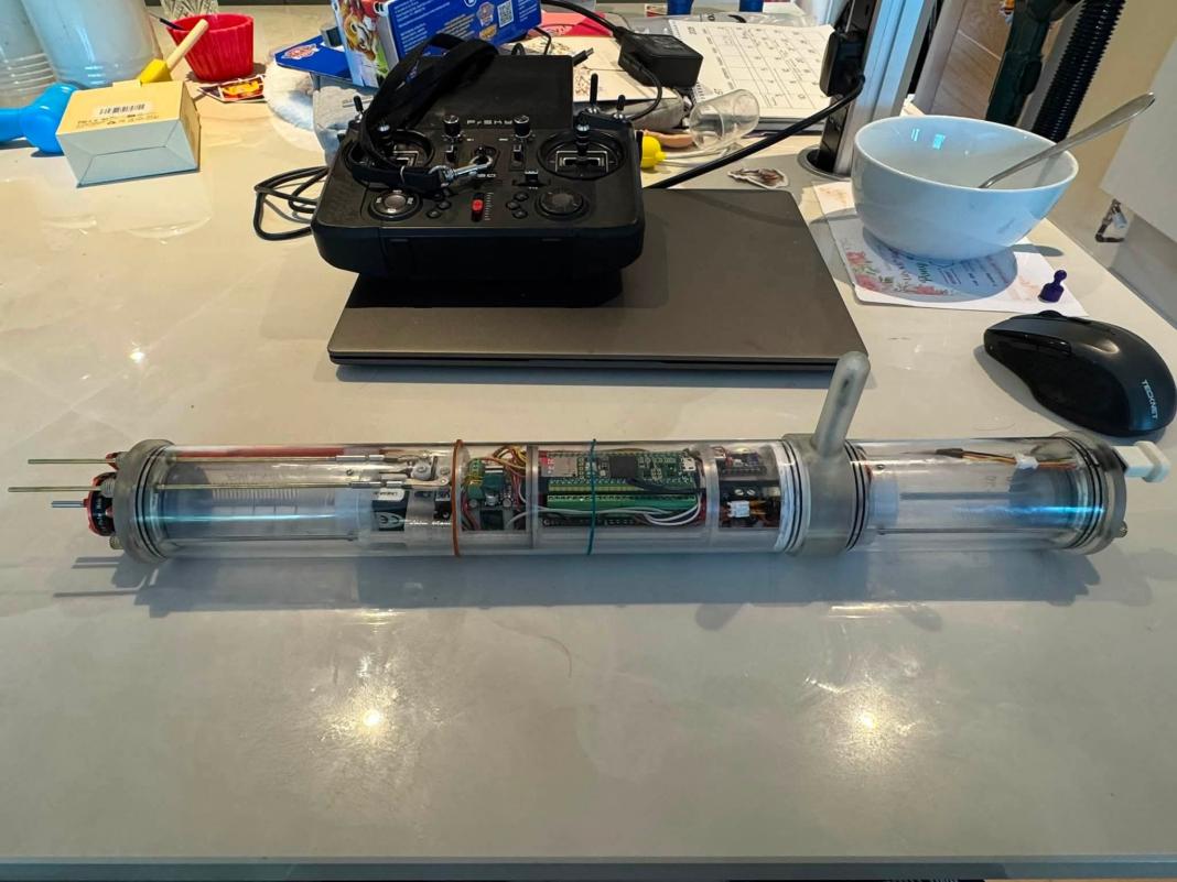

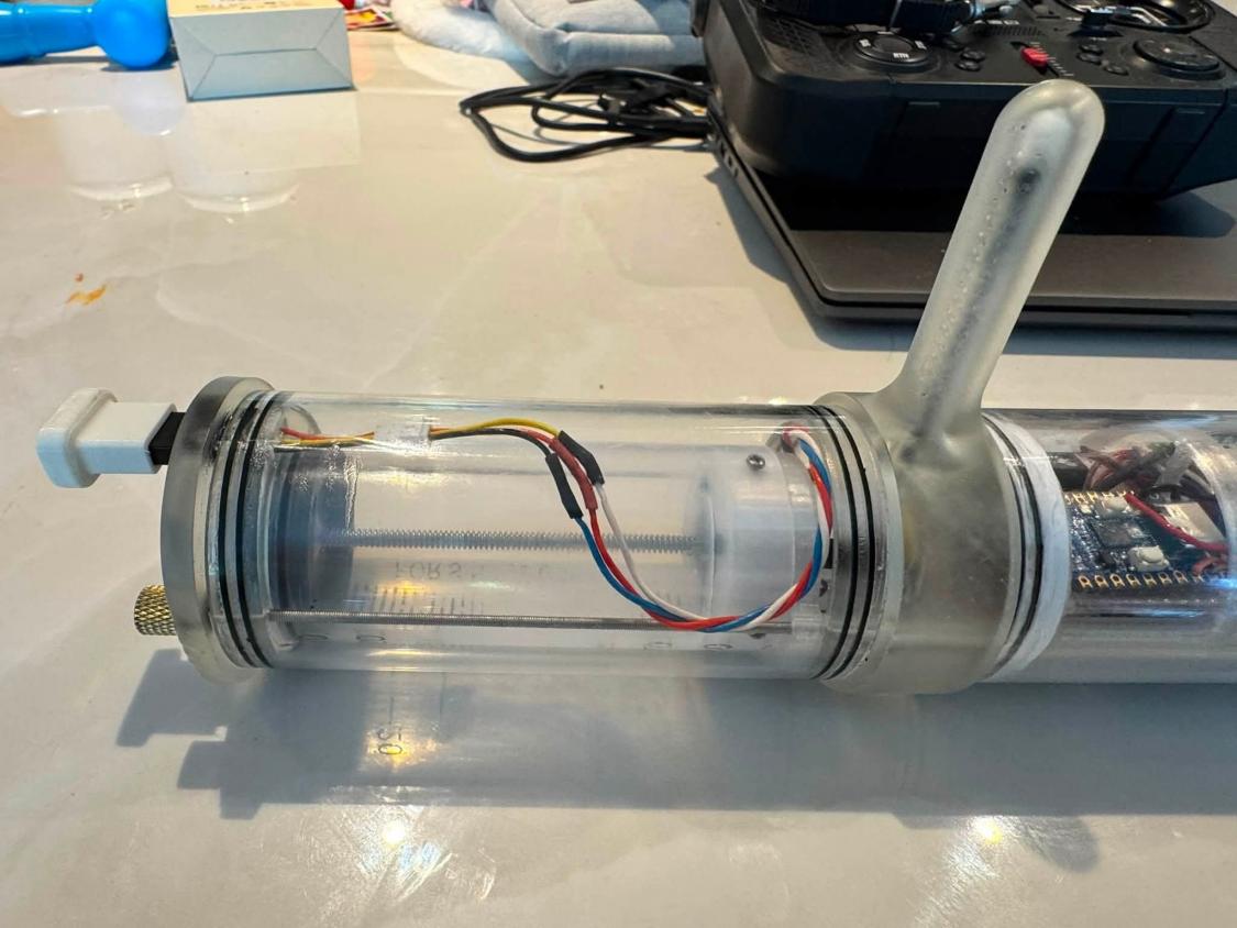

                I am ruining a TBS Crossfire Diversity with two dipoles on SMA connectors n my 212. I have space in the upper half of the WTC to run them crossed at about 30 degrees and at an angle up toward the bow. I had to work around the remote control, and the lower half of the WTC is taken up by a rather large battery. I figured that most of my running the side of the boat is presented to the radio, so this geometry seemed ok. it worked on the green water first run. I would need to do some moving of components and desoldering to get a more vertical orientation on the antennas.
                I did lose telemetry below 4 feet or so. I was able to run the sub out at 50-60' submerged. I did have a few geometries where responsiveness dropped. Seeing this thread I will have to go back and test that some.
                Sometimes if the connection gets spotty, try rotating your radio about the line between you and the sub to cut polarization mismatch losses. It can help. It does not help if you are in the receiving antenna null.
                Note, as an RF systems engineer (not quite the same as an RF engineer or an antenna engineer) this thread makes sense.
