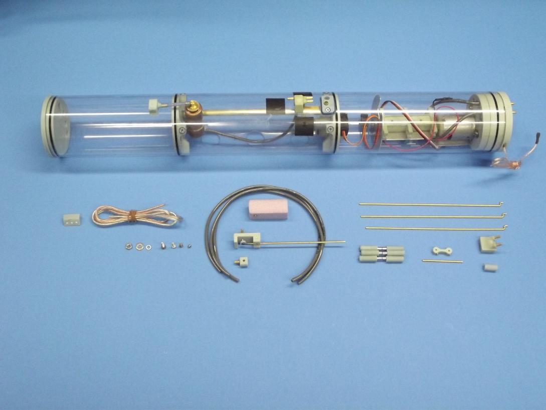

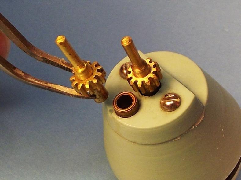

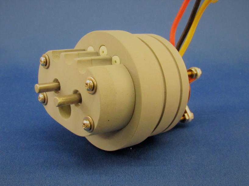

      David, what size SD did you use in this conversion?
        • 13934
        #168
        2.5", two-motor.

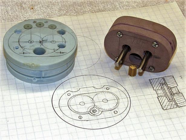

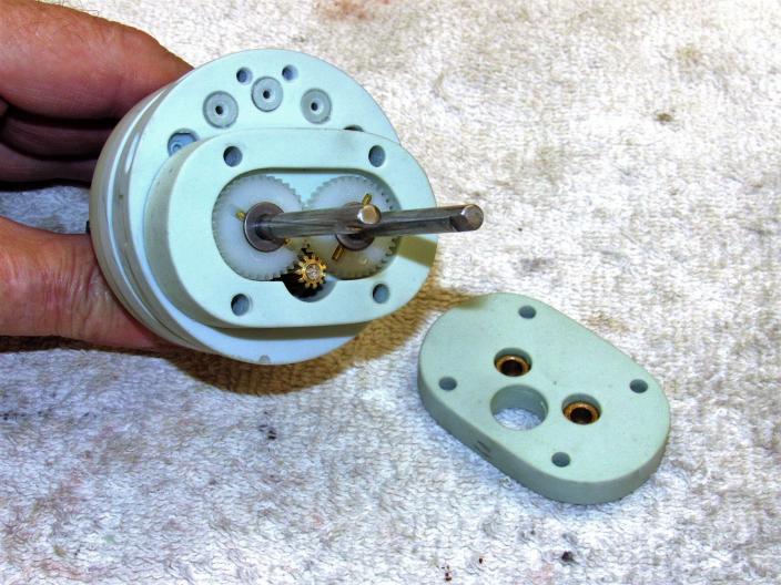

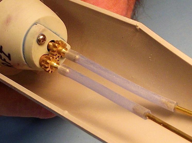

ID:	156295 David, am I correct that the Props should rotate in opposite directions? In the photo I see one motor using a pinion to rotate two Spur gears which in my mind would rotate the props in same direction?
            Click image for larger version  Name:	3AD309FF-EFE3-4810-8FC1-A8DAD0BAB2DC.png Views:	0 Size:	46.8 KB ID:	156294
              • 13934
              #171
              Nope.
              The two output spure gears mesh and have to rotate counter to the other. Only one of them engages the pinion gear. Example follows:

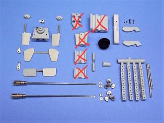

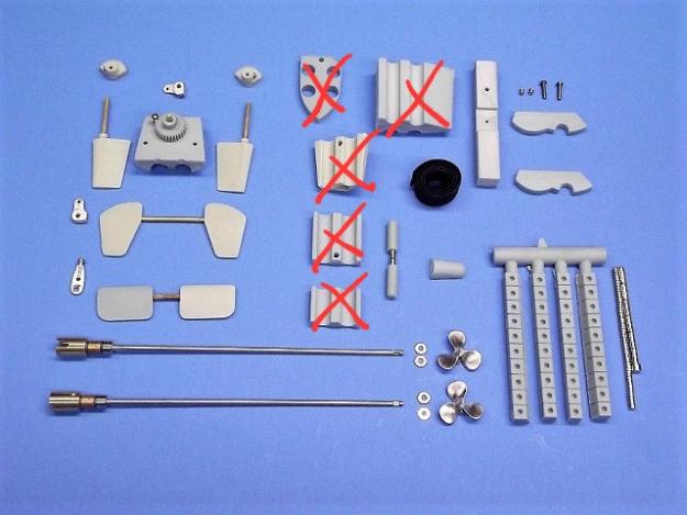

                        Would be possible to get the following Type IX fittings; Resin fore and aft diveplanes, rudder mechanism, drive shafts, bearing mounts, dogbones, props and magnetic hold downs? Click image for larger version
                          Nope. NIS.

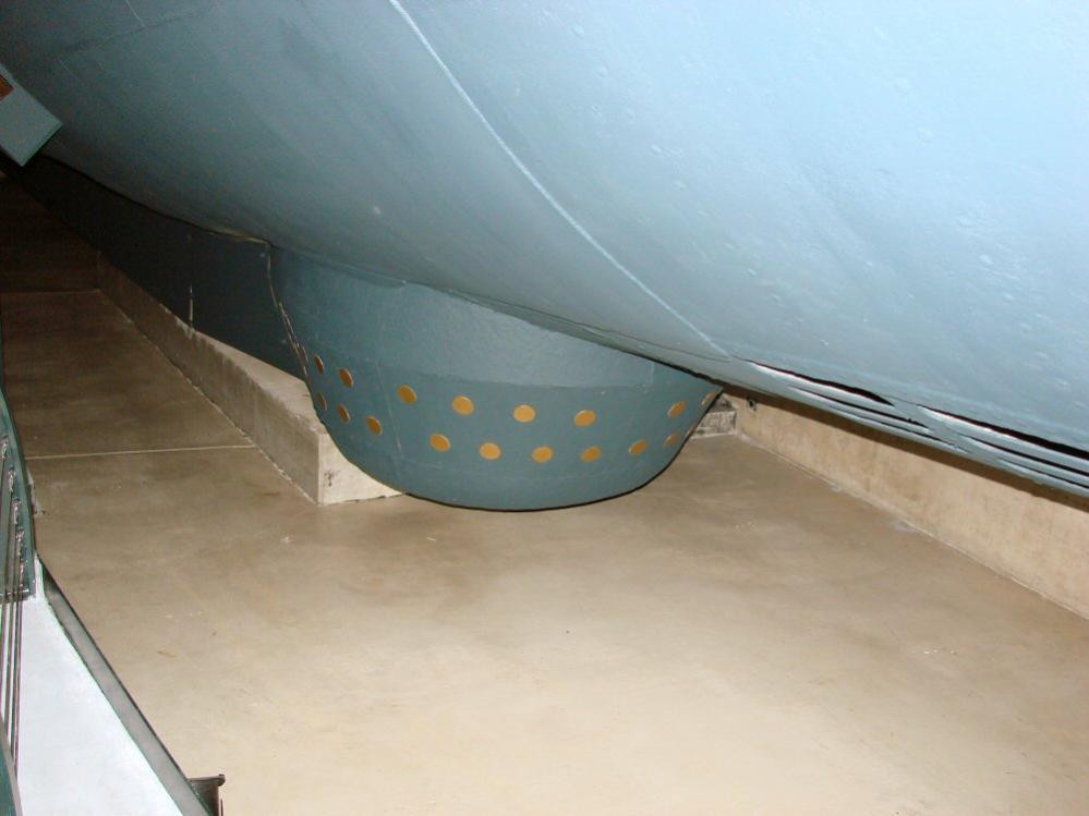

                            BTW, the sonar dome is a Balkon Great Sonar array. They were fitted as standard equipment on Type XXI, s and on the Type XVIIB's, and some Type VII's and Type IX's too as here. Looking at the date this thread started (12 years ago?), this is probably old been there don't that. but I have fun researching it anyway so there...lol.
                            Reading about the U-505's German operational history, **** what a unlucky boat! Even the skipper committed suicide int he control room shooting himself with his pistol in the head on duty. Seems as a war relic U-505's good fortune only changed only after being captured. The first warship captured at sea by the USN since the war of 1812. The British however captured U-boats several already beforehand mentioning then so I don't repeat another U-571 movie boner. Thats another story, the Hollywood versions Americans won the war single handed right? When Operation Burma was released in 1944 with Errol Flynn, was the same thing. No mention of Gerneral Slim, PM Churchill was so ****ed he had the film banned in the UK.
