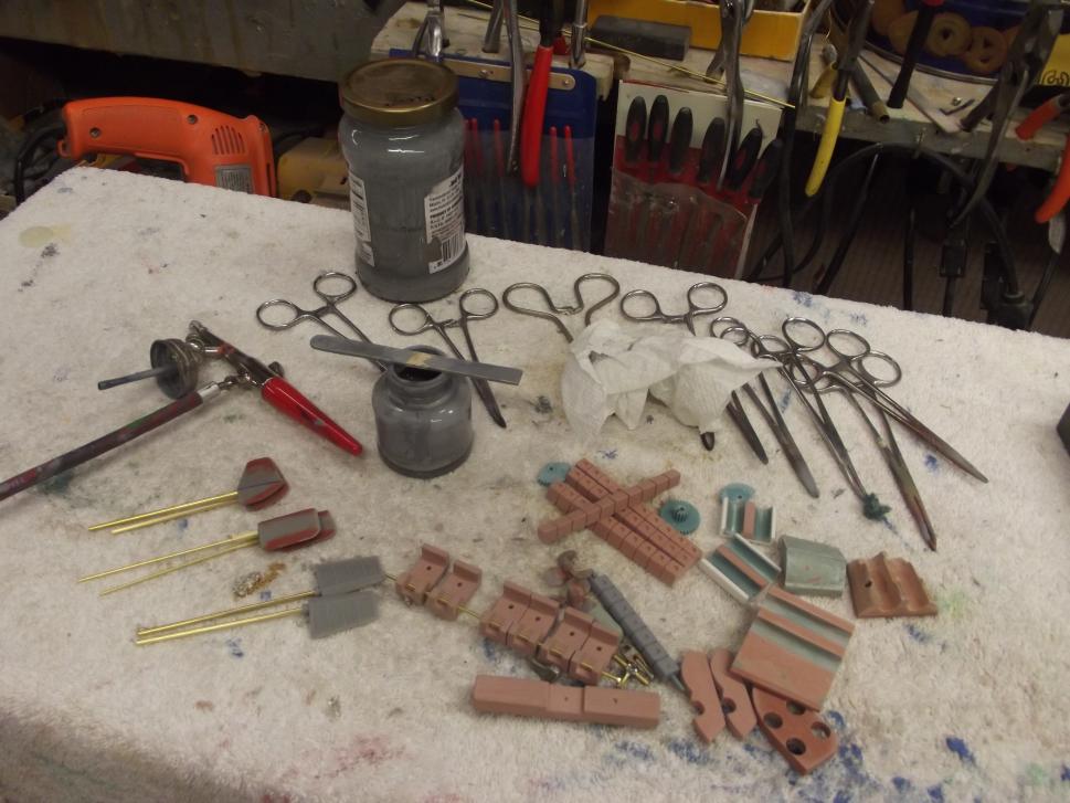

    #91
ID:	89267Click image for larger version
ID:	89268Click image for larger version
ID:	89269Click image for larger version
ID:	89270Click image for larger version
ID:	89271Click image for larger version
ID:	89272Click image for larger version
ID:	89273Click image for larger version
ID:	89274Click image for larger version
ID:	89275Click image for larger version
ID:	89276Click image for larger version
ID:	89277Click image for larger version

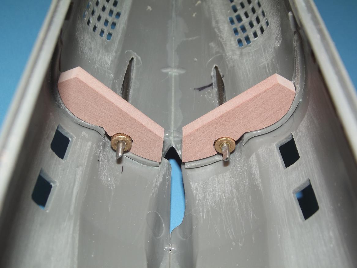

                  #98
                  You say Norbert Bruggen; Isn't he? And, talking about the building of the model, may be I've missed something but, What about those square opennings in the lower part of the hull?

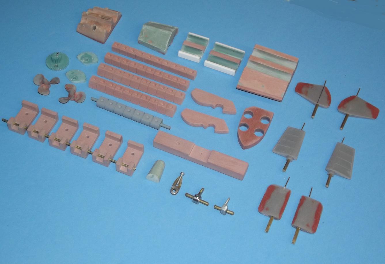

                        #101

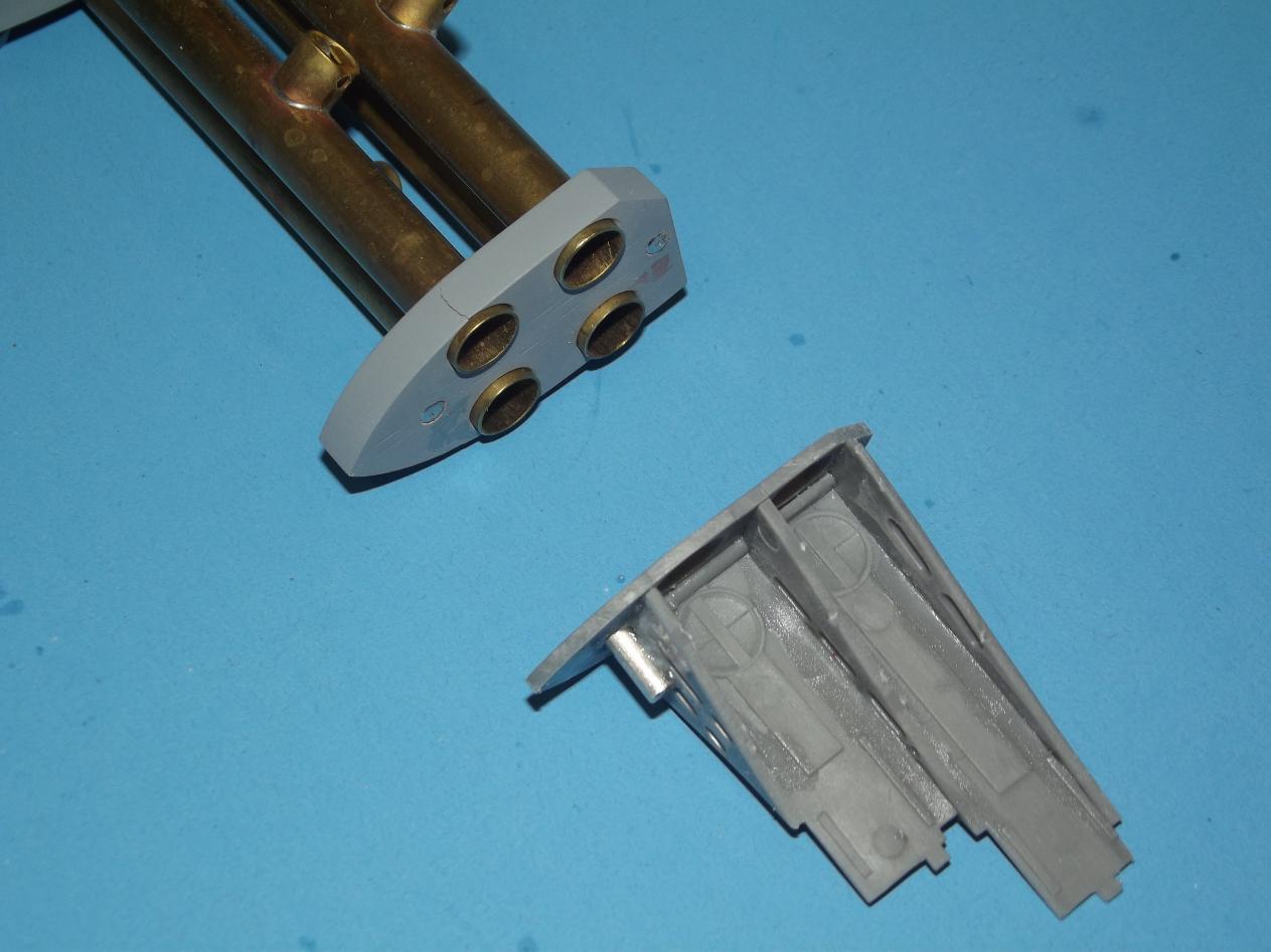

ID:	89290Click image for larger version
ID:	89291Click image for larger version
ID:	89292Click image for larger version
ID:	89293Click image for larger version
ID:	89294Click image for larger version
ID:	89295Click image for larger version
ID:	89296Click image for larger version
ID:	89297Click image for larger version
ID:	89298Click image for larger version
ID:	89299Click image for larger version
ID:	89300Click image for larger version
ID:	89301Click image for larger version
ID:	89302Click image for larger version
ID:	89303Click image for larger version
ID:	89304Click image for larger version
ID:	89305Click image for larger version

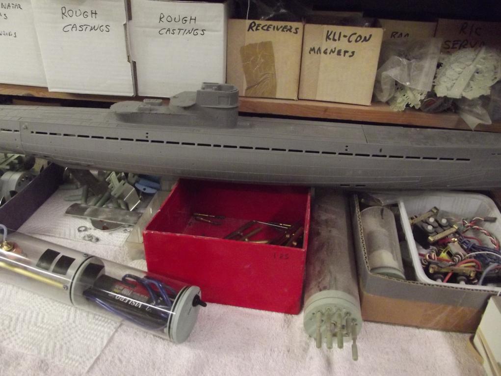

ID:	89340Click image for larger version
ID:	89341Click image for larger version
ID:	89342Click image for larger version
ID:	89343Click image for larger version
ID:	89344Click image for larger version
ID:	89345Click image for larger version

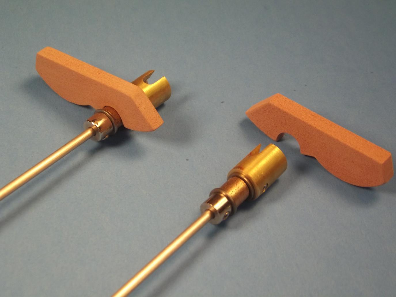

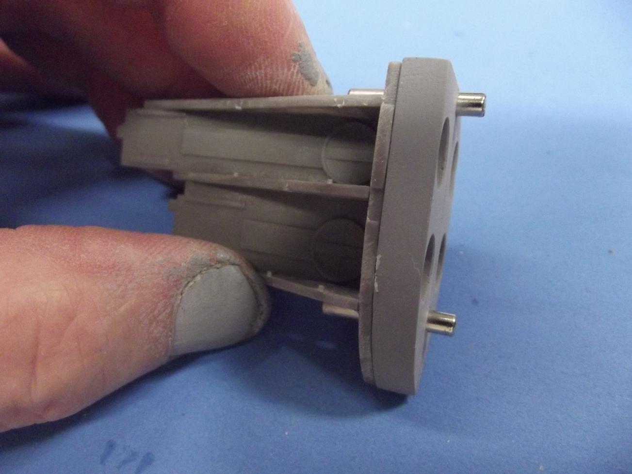

                              #104

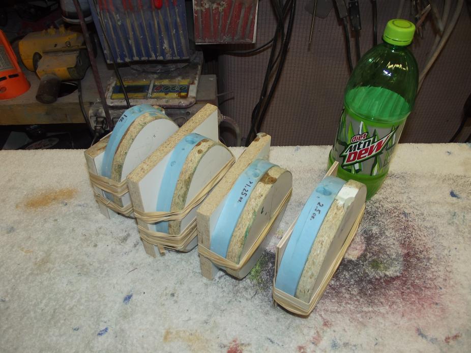

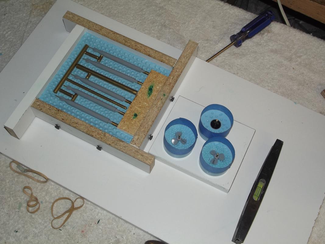

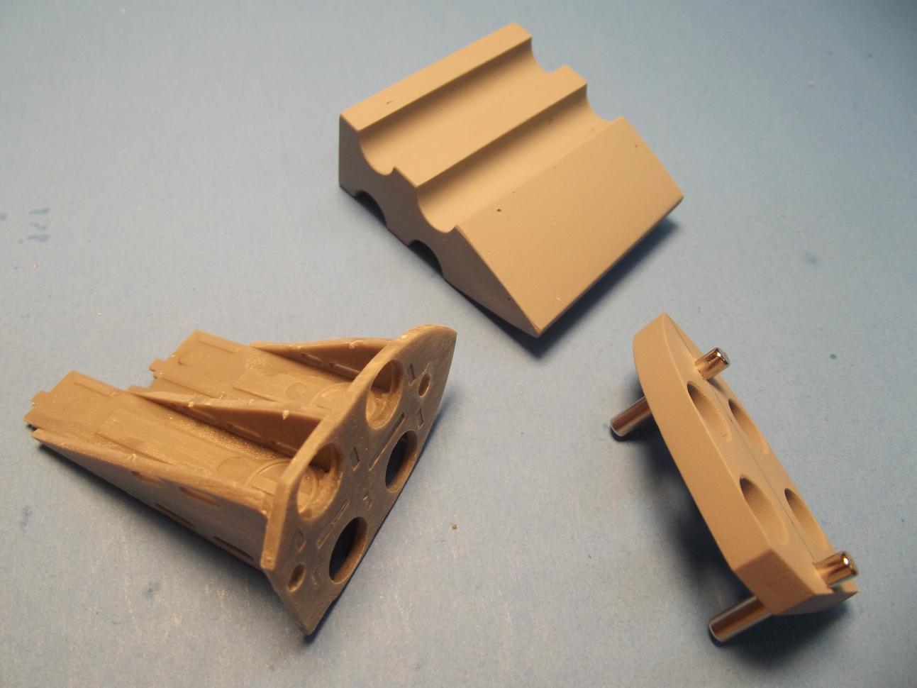

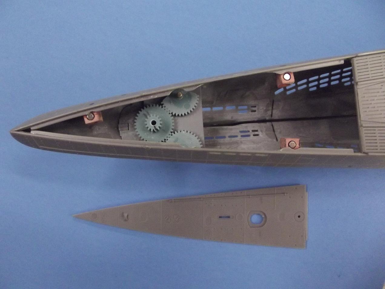

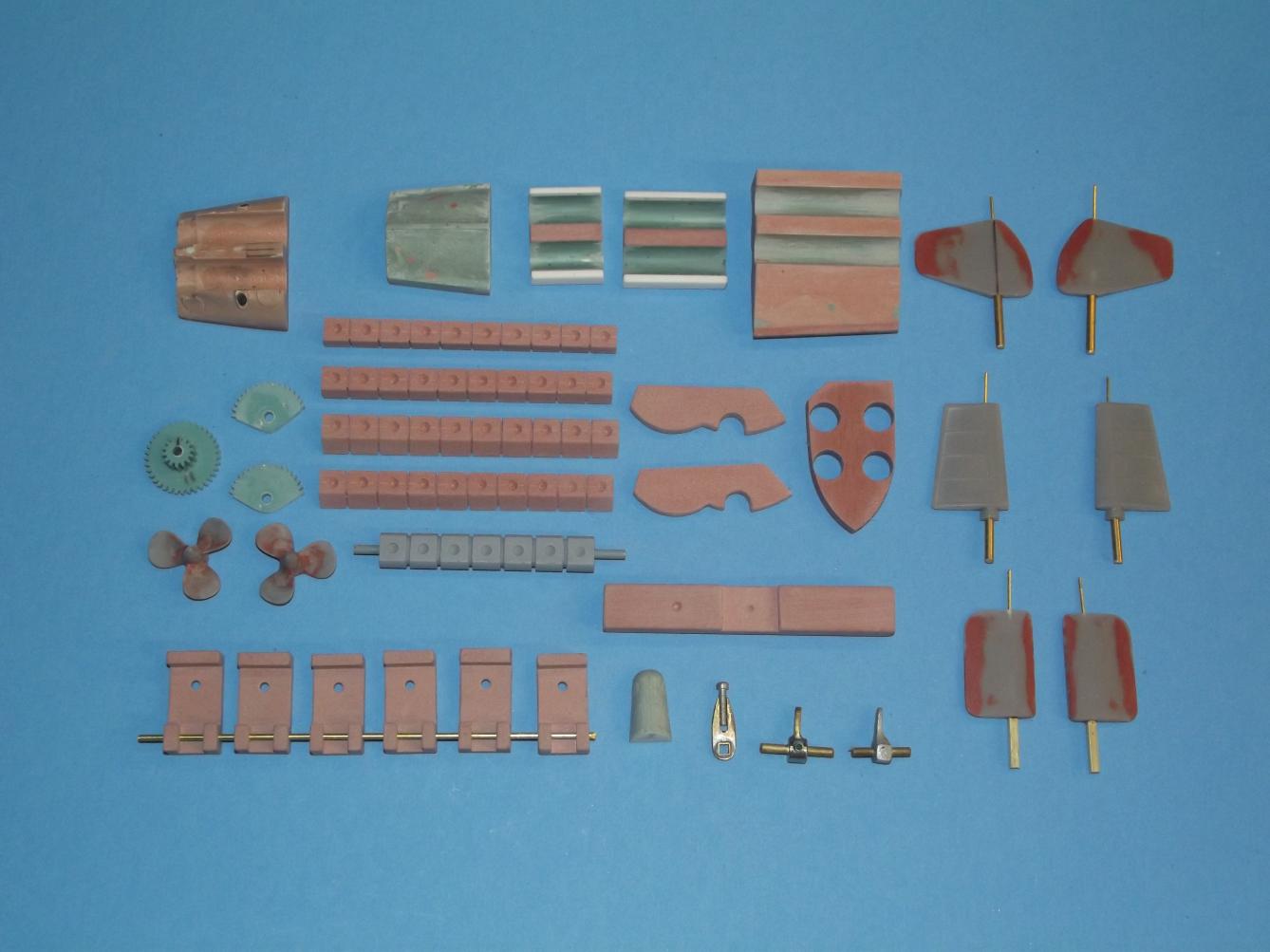

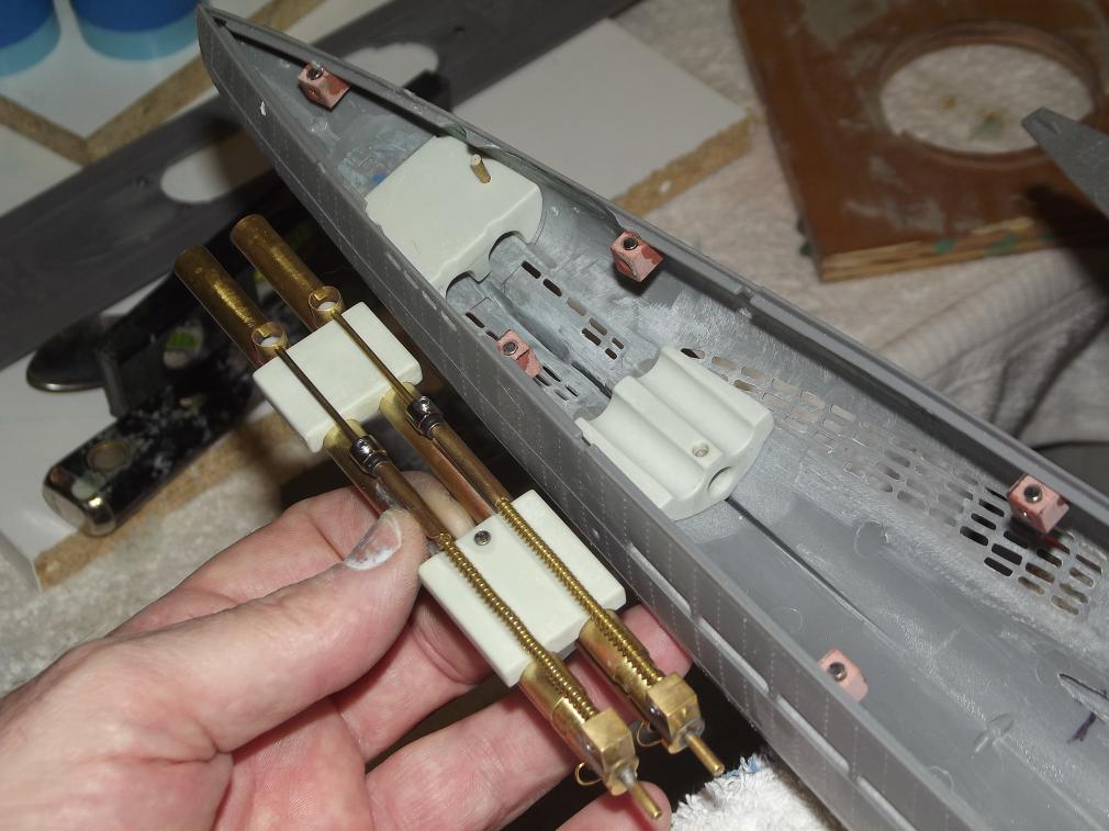

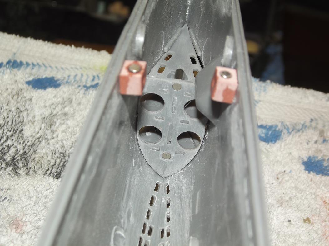

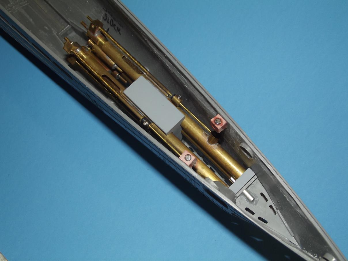

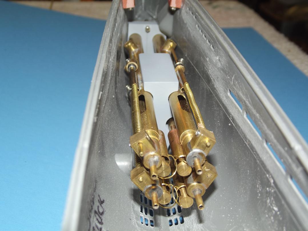

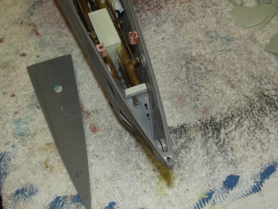

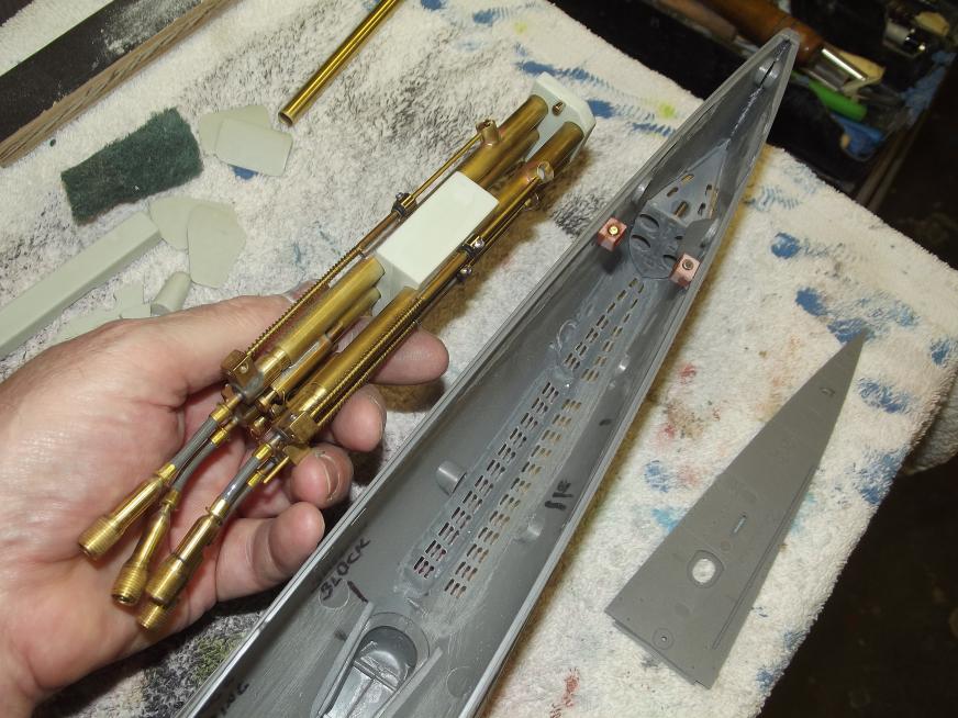

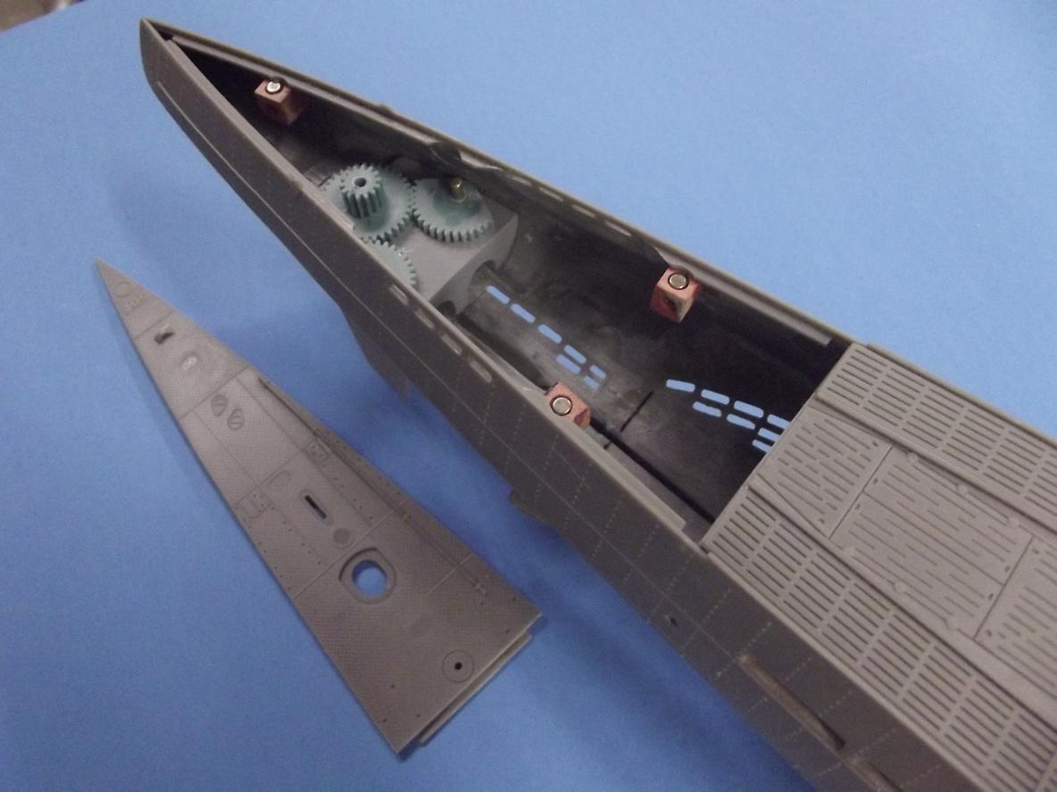

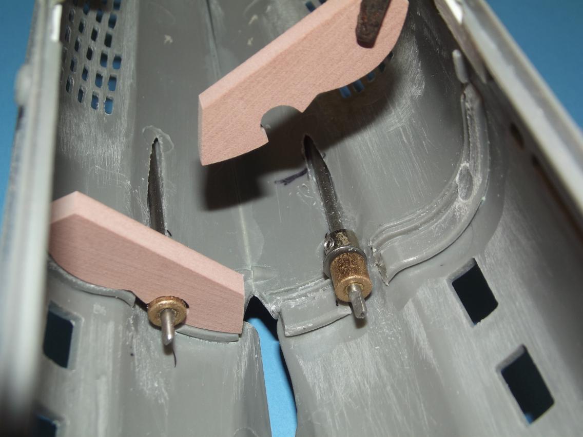

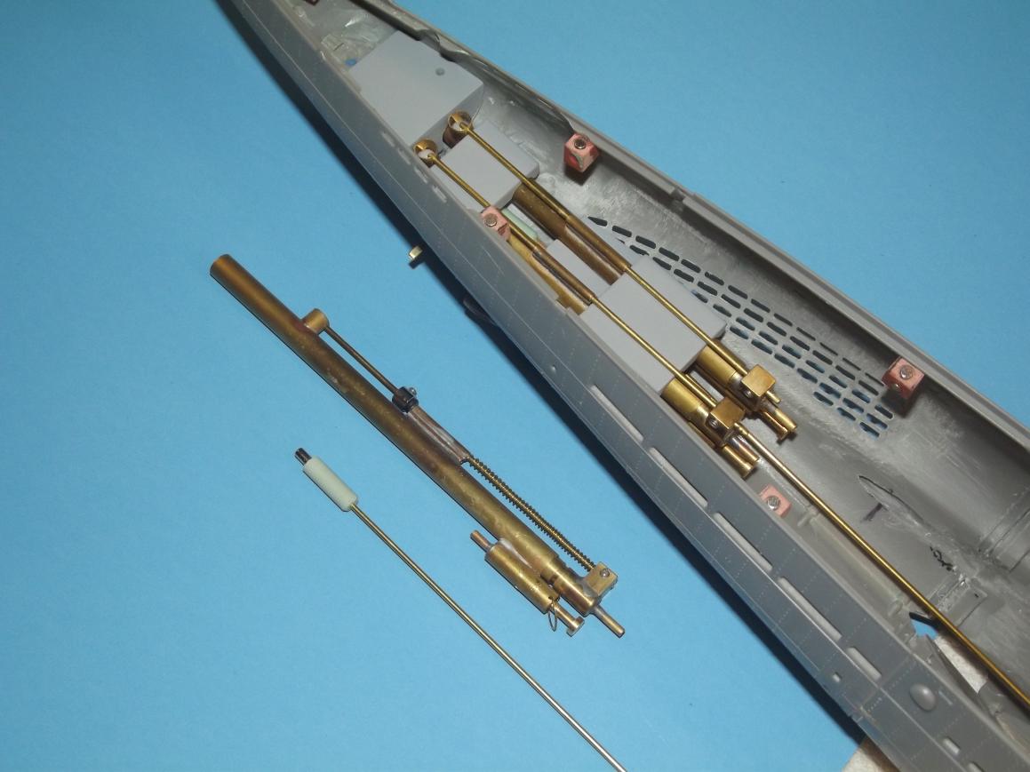

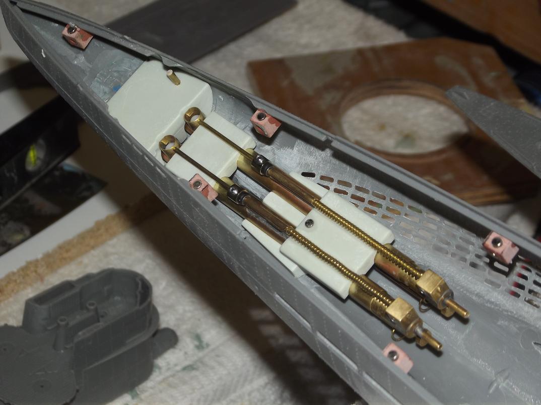

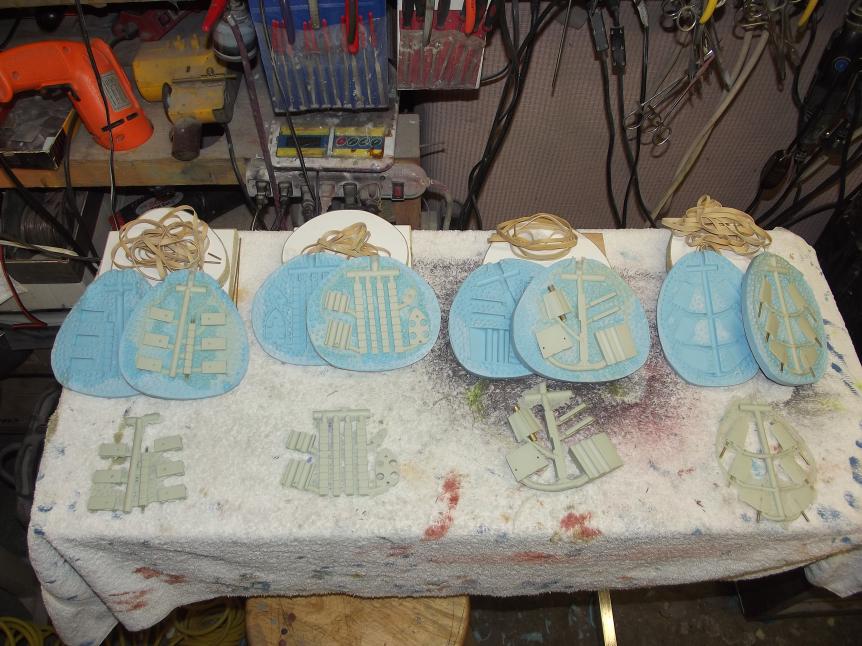

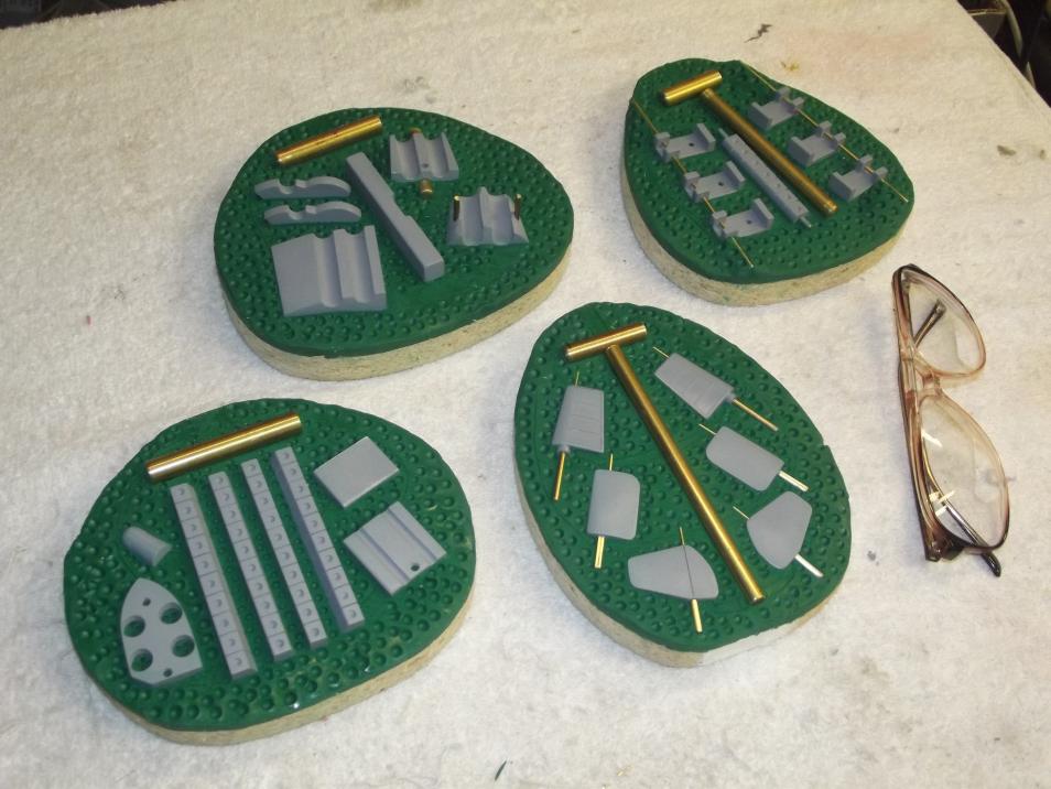

                              Resin parts are cast, and the first set employed aboard the first Revell of Germany 1/72 Type-9 kit Mike and I received from Germany. Not too surprisingly, everything fit perfectly. Note that only magnets are used to index and hold the forward and after torpedo nests in place.

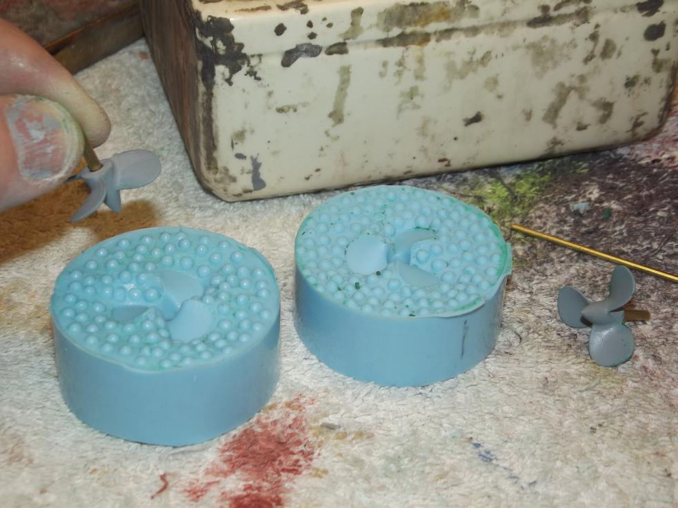

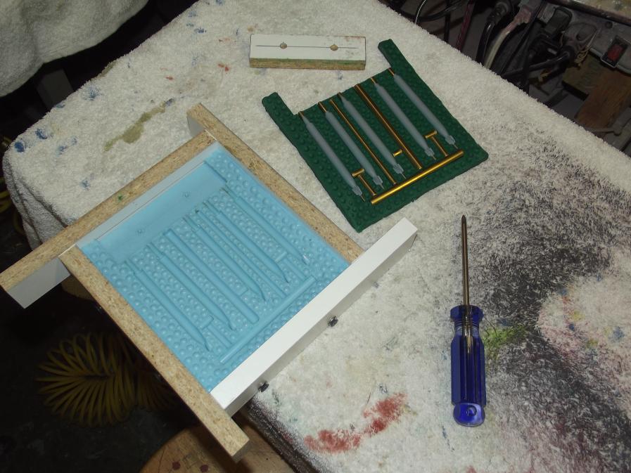

                                #105
                                G'morning, M!
                                Great stuff, as usual!
                                A couple of questions, if I may-

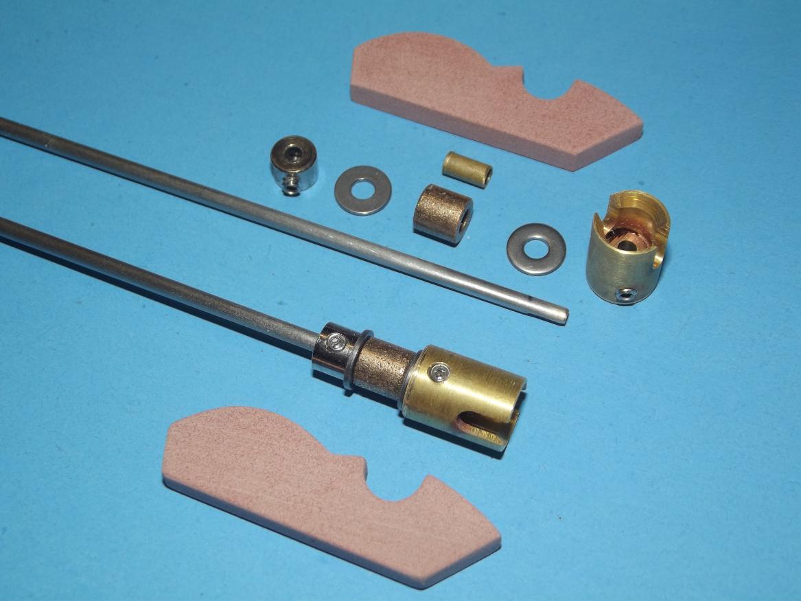

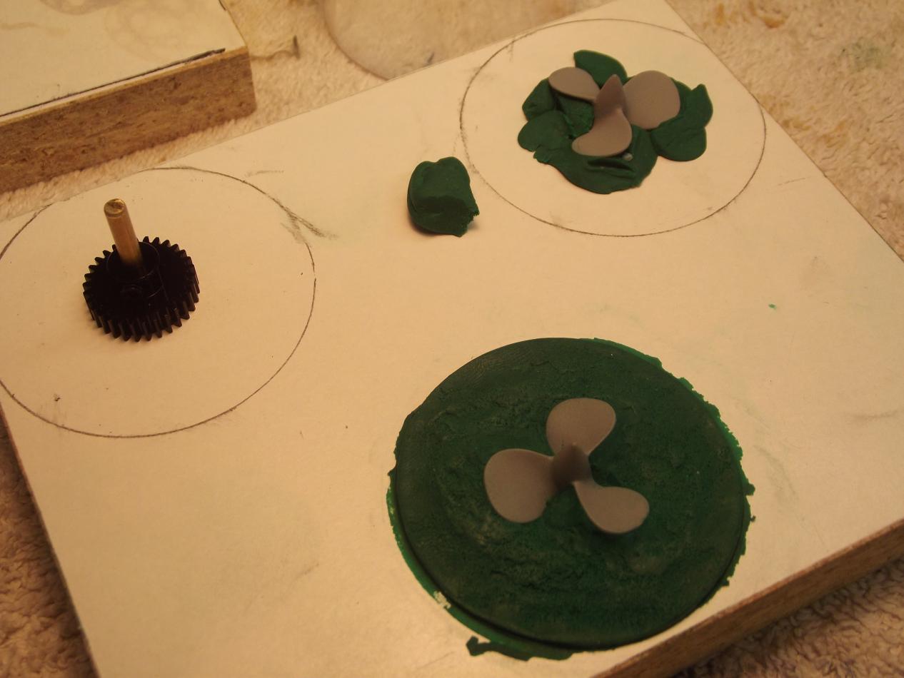

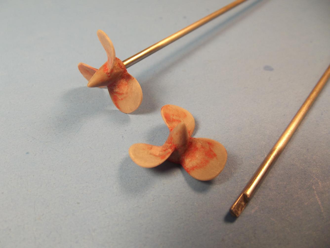

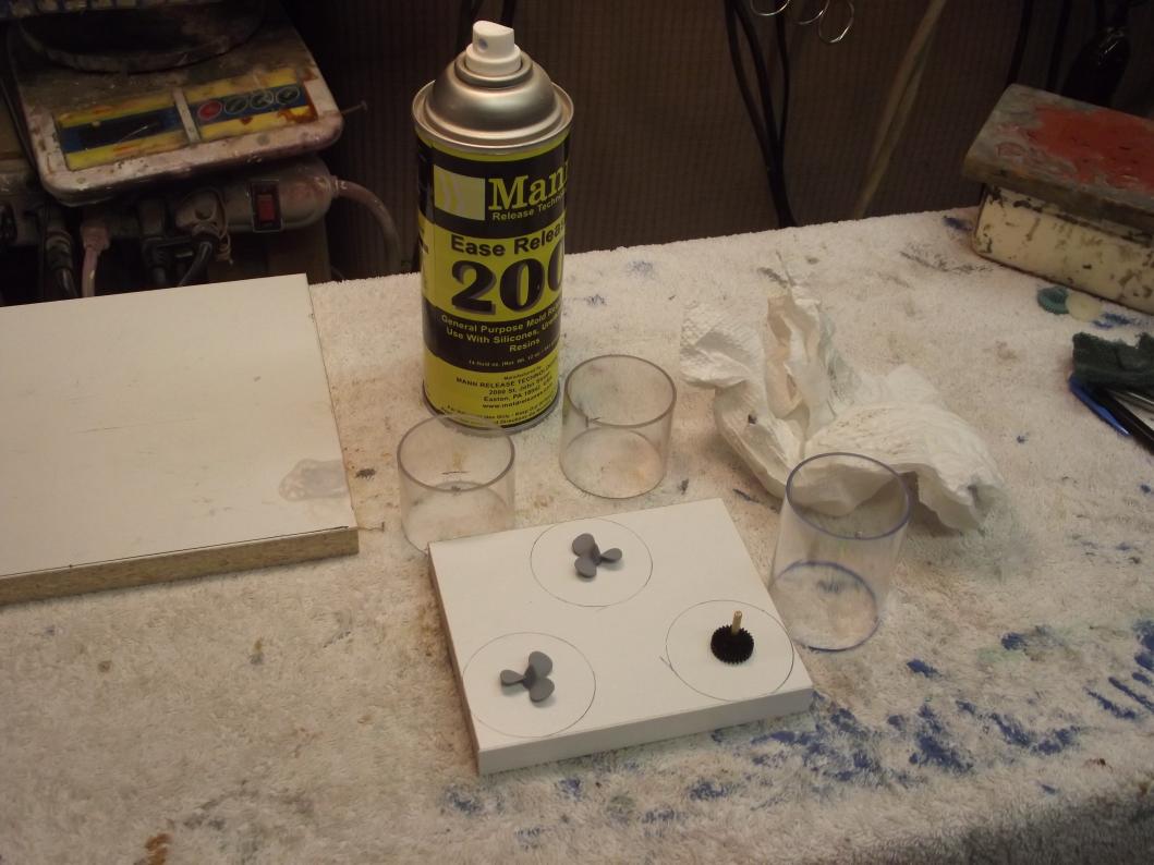

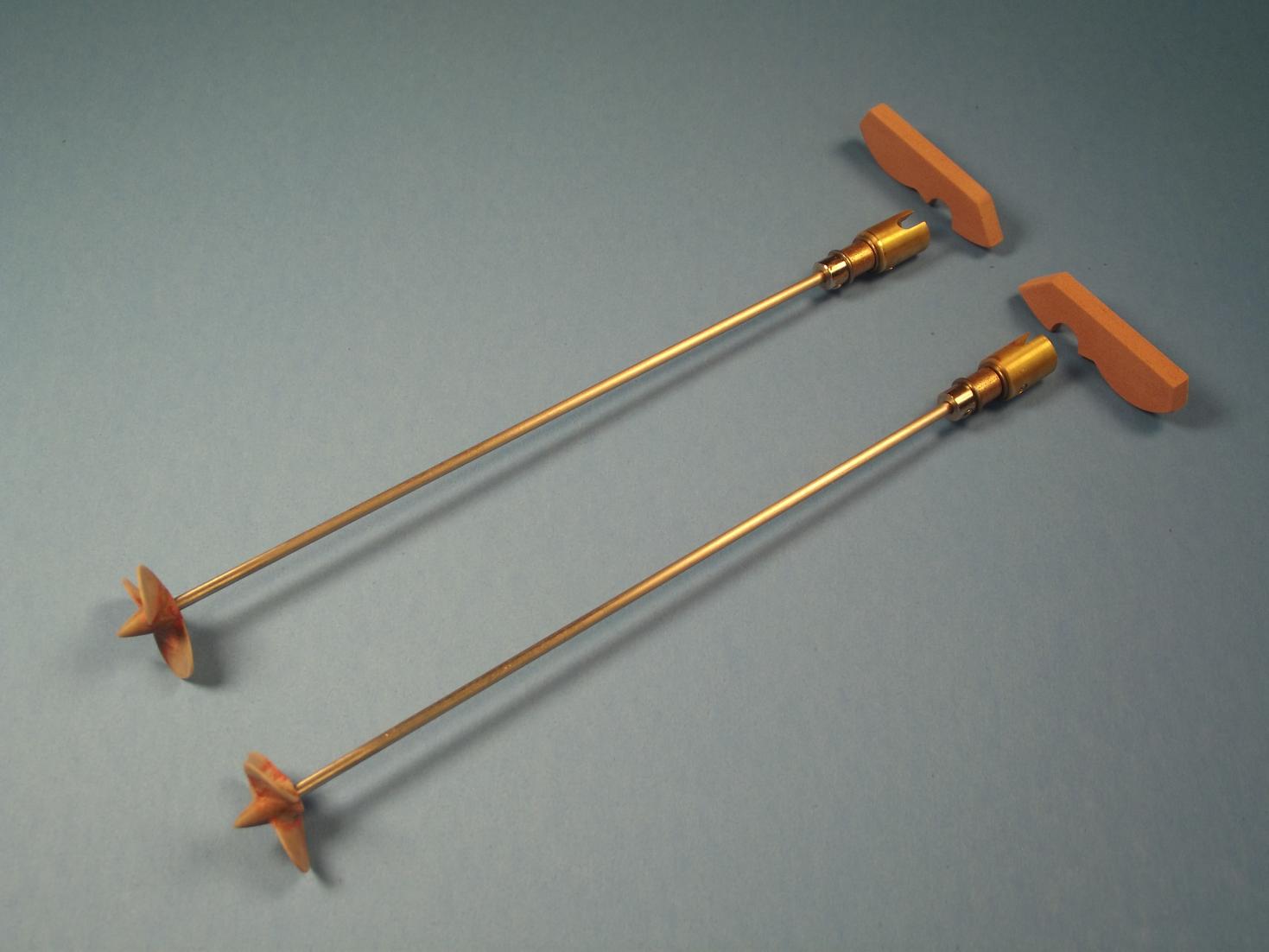

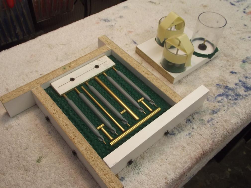

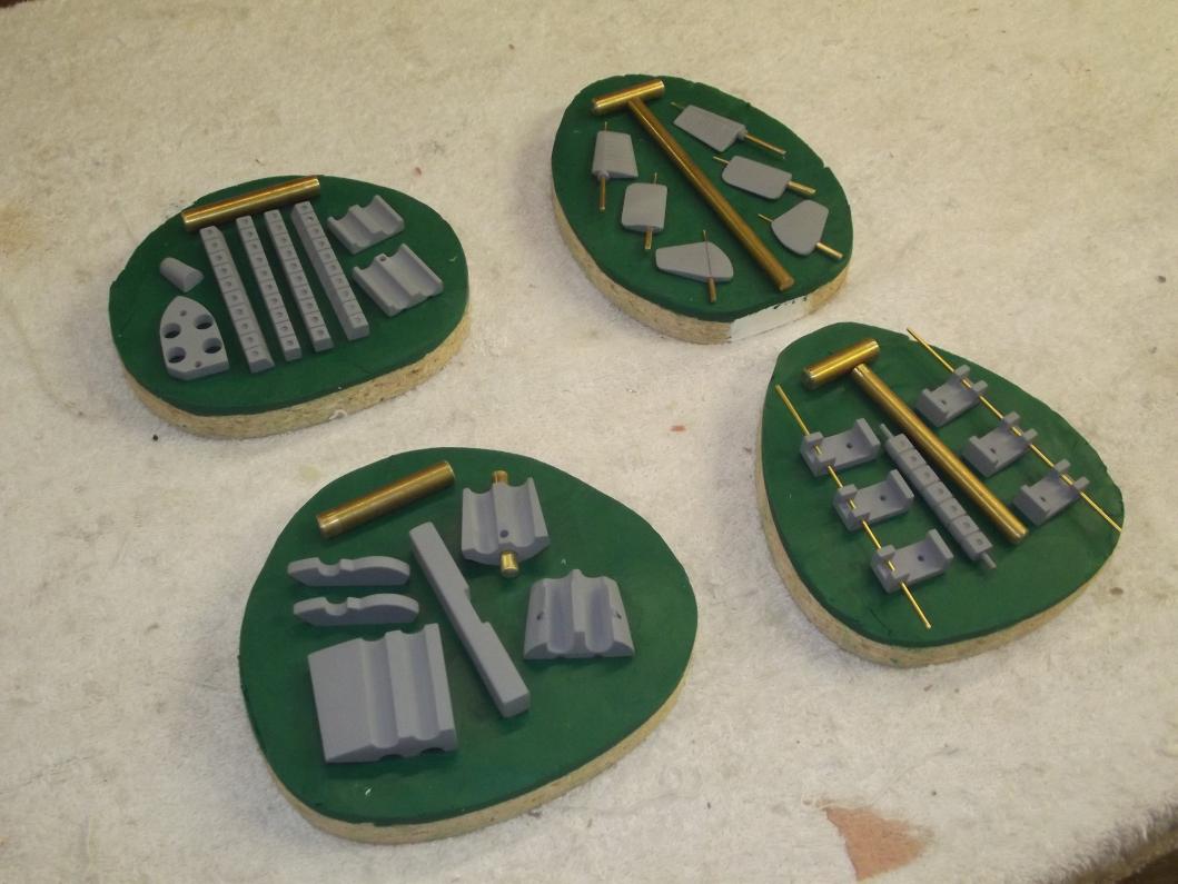

                                1. What type of RTV do you use for prop casting? Is it a special type of high-temp silicone? Also, I assume you pour white metal into the molds to cast the props?

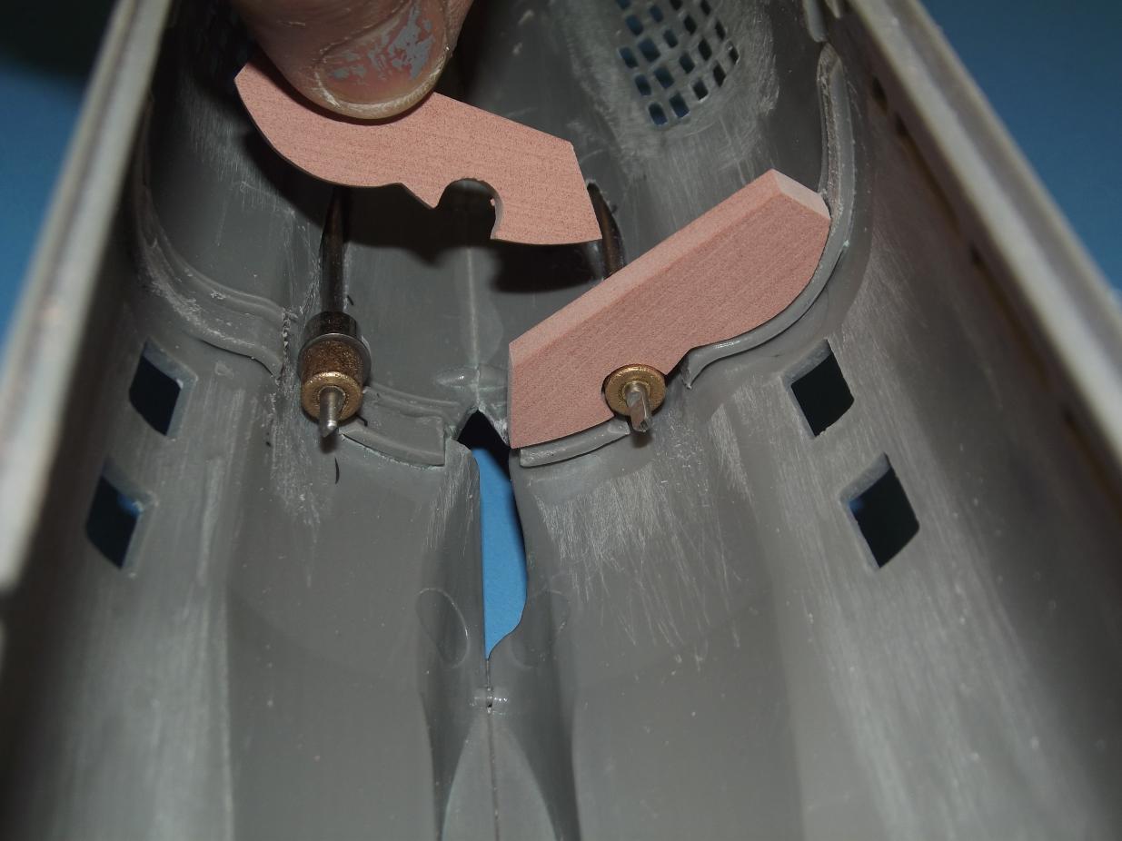

                                2. You utilize renshape blocks to hold the magnets which secure the decks Is renshape impervious to water retention?
                                Have done quite a bit of patternmaking using renshape, but never in a wet environment.
                                Your assistance, as always, is much appreciated!
