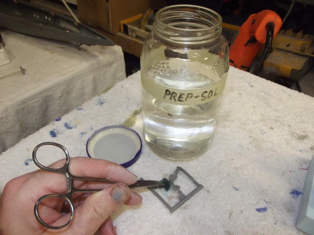

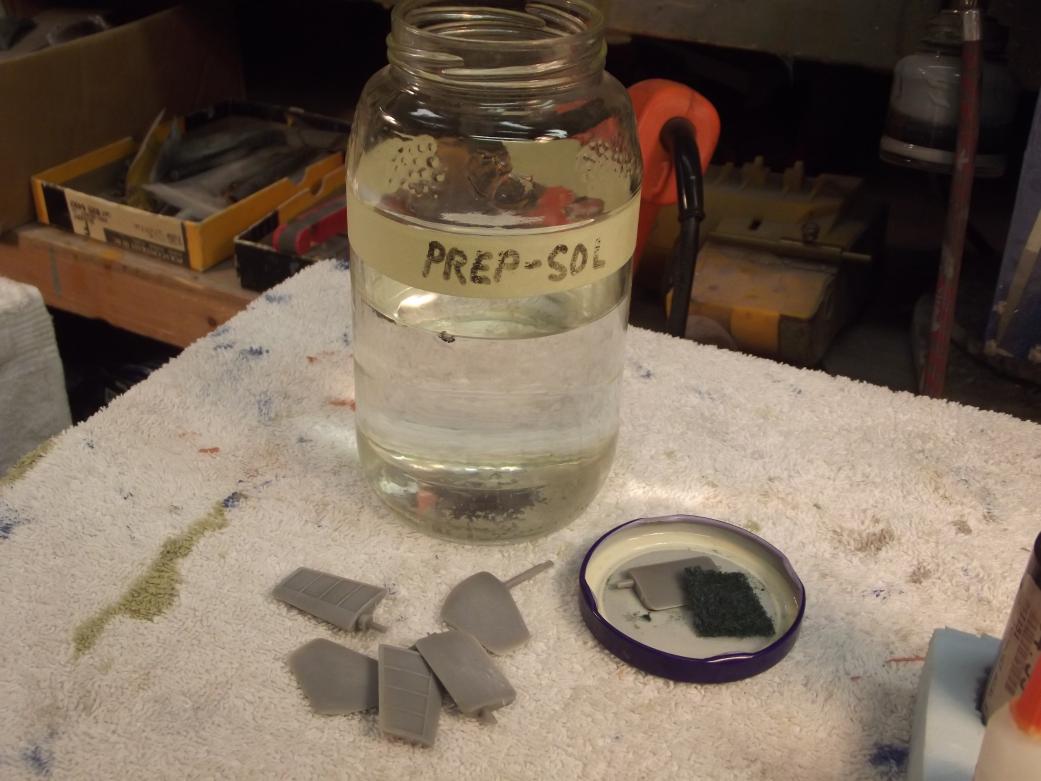

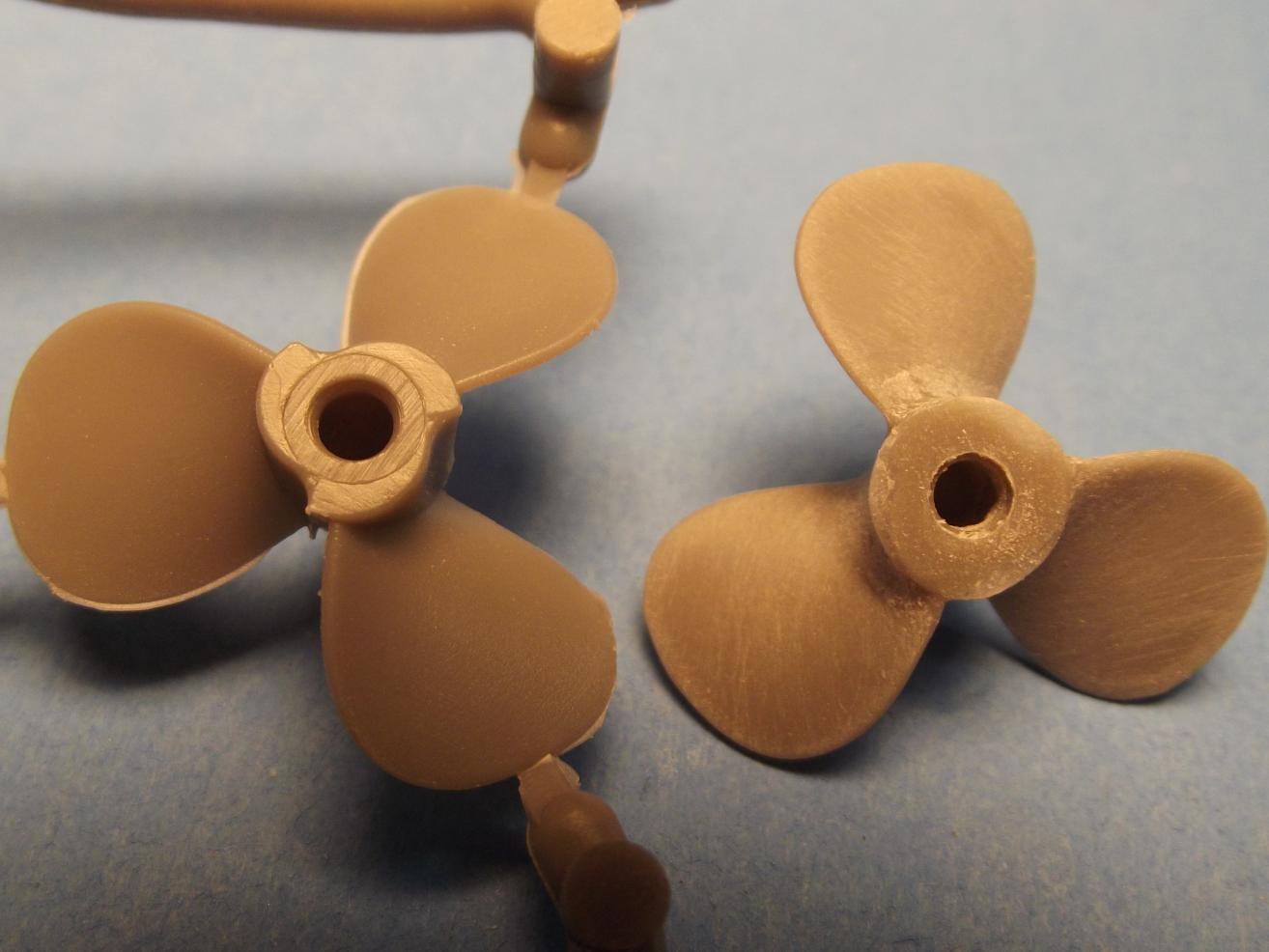

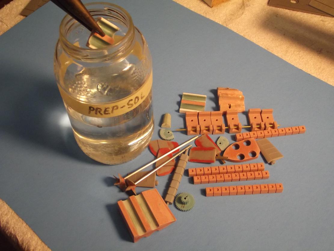

    What is in your prep-sol? And you use it for plastic only or?

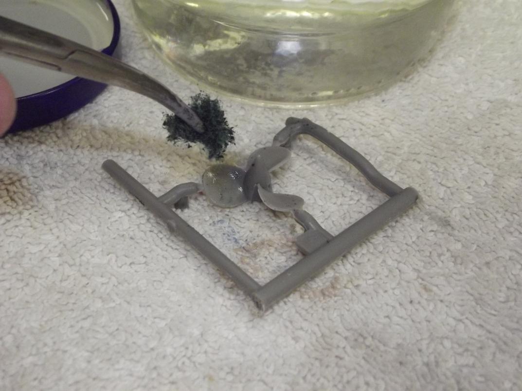

        Tom:
        Prep-Sol is a mild hydrocarbon based de-greasing liquid. Marketed at the car refinishing crowd. Strong enough solvent to cut grease and dirt, but mild enough to not melt or craze polystyrene and most other plastics. I scrub kit parts with a Prep-Sol saturated abrasive pad.
        As you know, all injection formed kit parts retain a bit of the sprayed on mold-release agent applied to the metal tools used to form the trees -- the amount of retained mold-release on the surface of the parts being a function of plant protocol, and where along the application phase your parts were shot. Always assume your parts were shot immediately after the last misting of mold release and are heavily coated with glue-filler-putty-primer-paint inhibiting gunk.
        Hence the need to clean the surface of all polystyrene, GRP, and resin kit parts.
        Using Prep-Sol is easier than scrubbing the parts with scouring powder, stiff brushes, and lots of water.

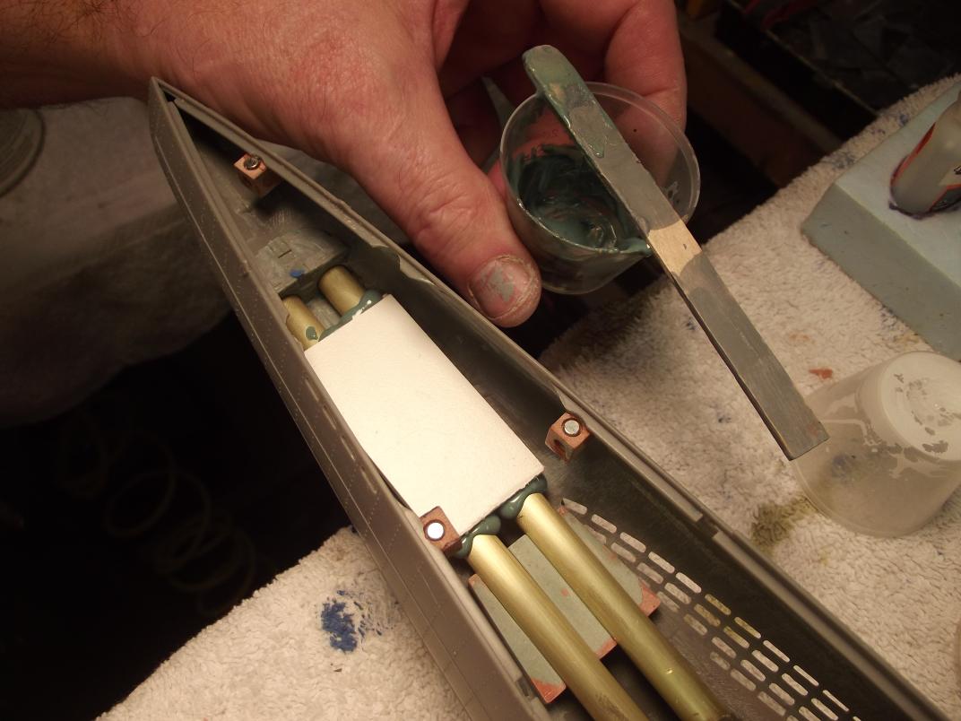

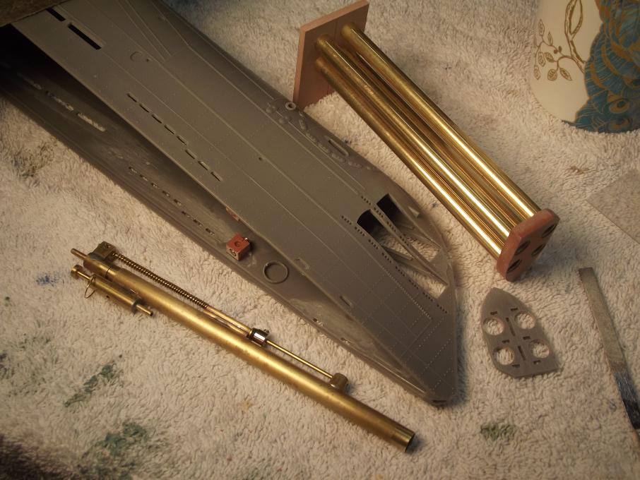

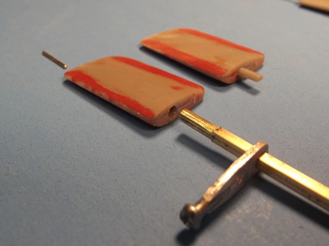

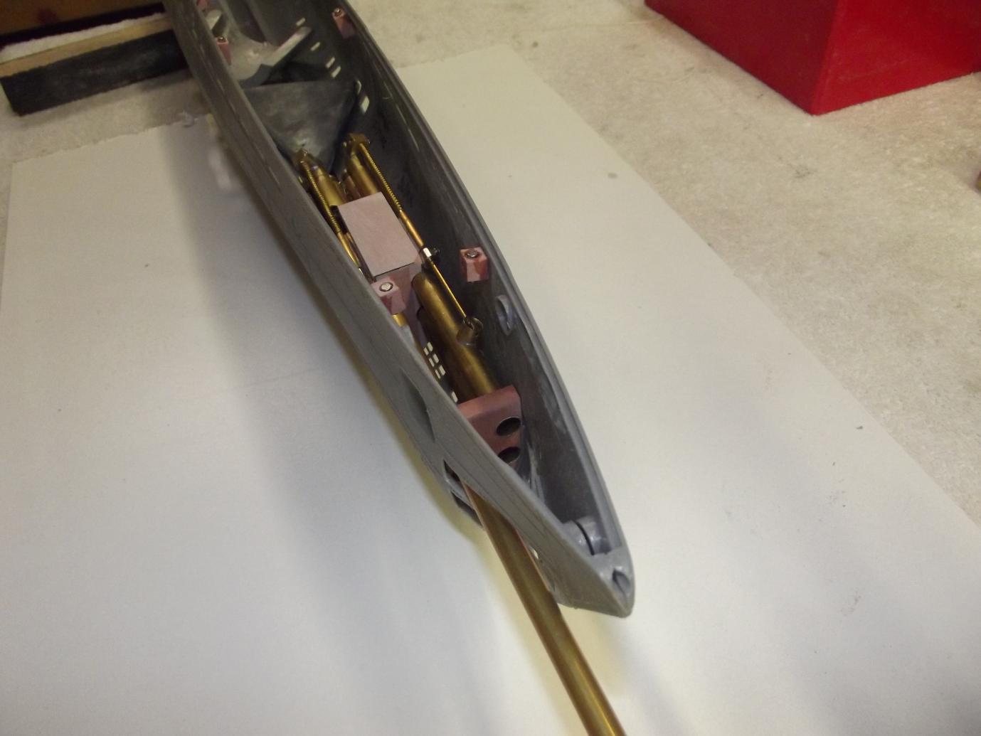

ID:	89213Click image for larger version
ID:	89214Click image for larger version
ID:	89215Click image for larger version
ID:	89216Click image for larger version
ID:	89217Click image for larger version
ID:	89218Click image for larger version
ID:	89219Click image for larger version
ID:	89220Click image for larger version
ID:	89221Click image for larger version
ID:	89222Click image for larger version
ID:	89223Click image for larger version
ID:	89224Click image for larger version
ID:	89225Click image for larger version
ID:	89226Click image for larger version
ID:	89227Click image for larger version
ID:	89228Click image for larger version
ID:	89229Click image for larger version
ID:	89230Click image for larger version
ID:	89231Click image for larger version
ID:	89232Click image for larger version
ID:	89233Click image for larger version
ID:	89234Click image for larger version
ID:	89235Click image for larger version
ID:	89236Click image for larger version
ID:	89237Click image for larger version
ID:	89238Click image for larger version
ID:	89239Click image for larger version
ID:	89240Click image for larger version
ID:	89241Click image for larger version
ID:	89242Click image for larger version
ID:	89243Click image for larger version
ID:	89244Click image for larger version
