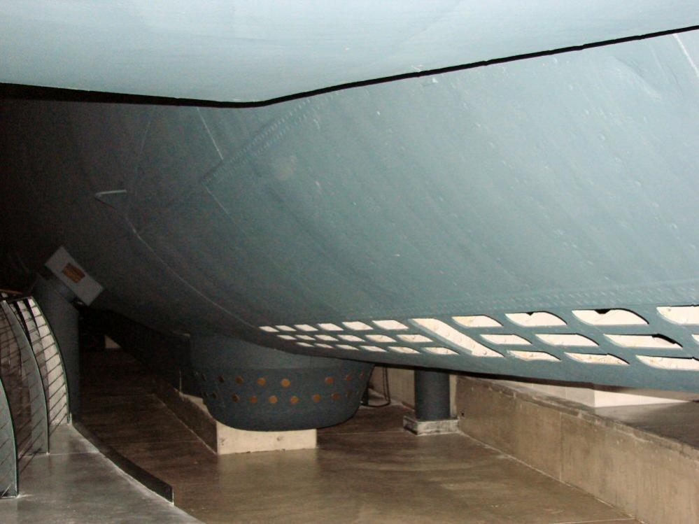

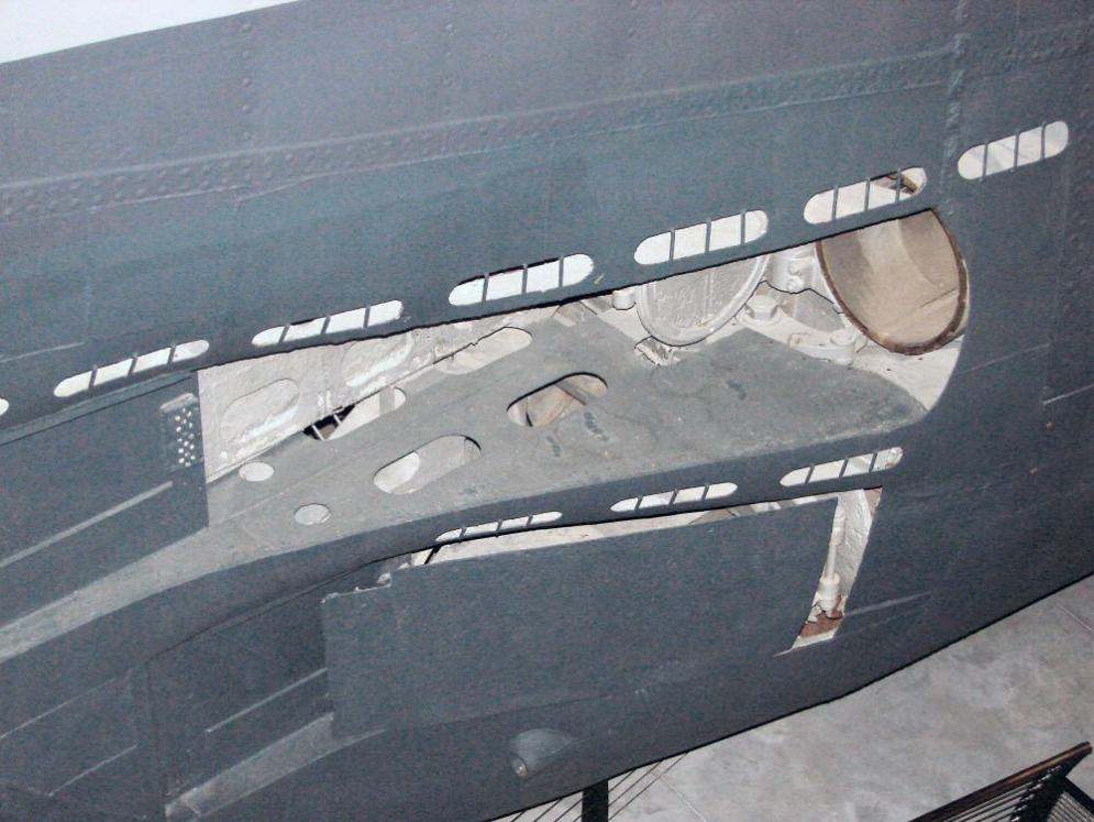

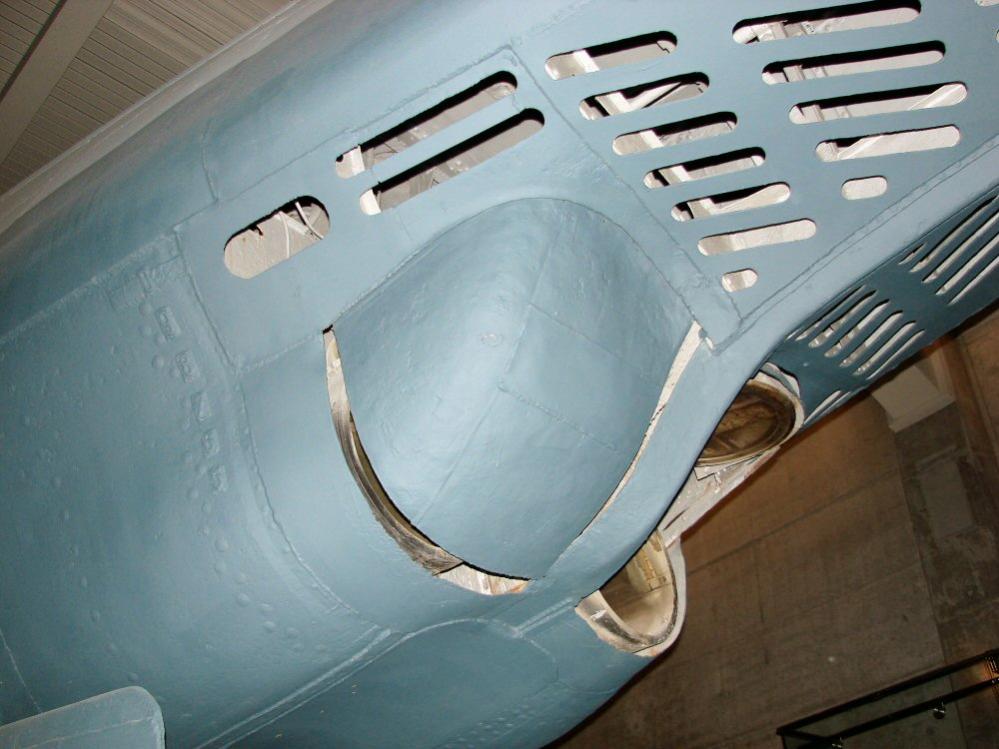

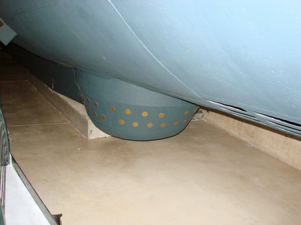

                        Since Dave said that they modeled it after U505, I started searching thru everything I could find on the U505 Sonar Dome. I came up with these plus a few others.
ID:	84963Click image for larger version
ID:	84964Click image for larger version
ID:	84965Click image for larger version
ID:	84966Click image for larger version
ID:	84967Click image for larger version
ID:	84968Click image for larger version
ID:	84969Click image for larger version
ID:	84970Click image for larger version
                          • 14011
                          I love those shots, Mark. Keep them coming please. And I so appreciate that the museum configured the boat with closed and opened shutter-doors/muzzle doors. What a wealth of prototype information here.

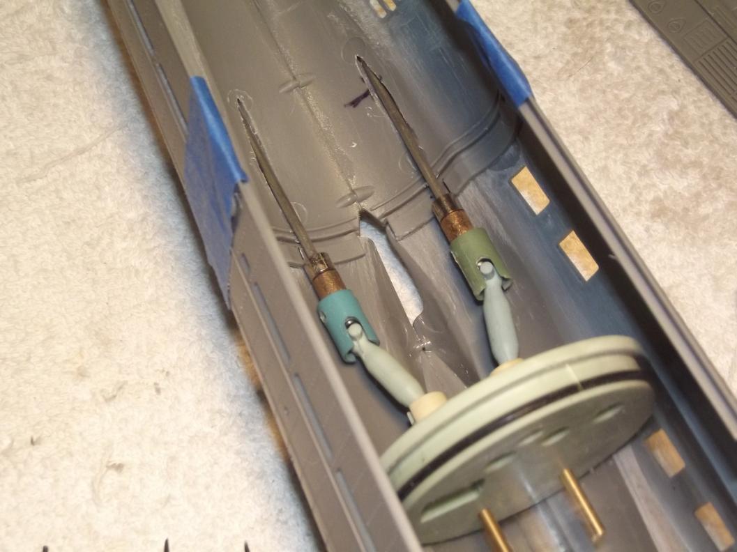

                            • Scott T
                              • May 2009
                              • 414
                              I know this will make you mad!

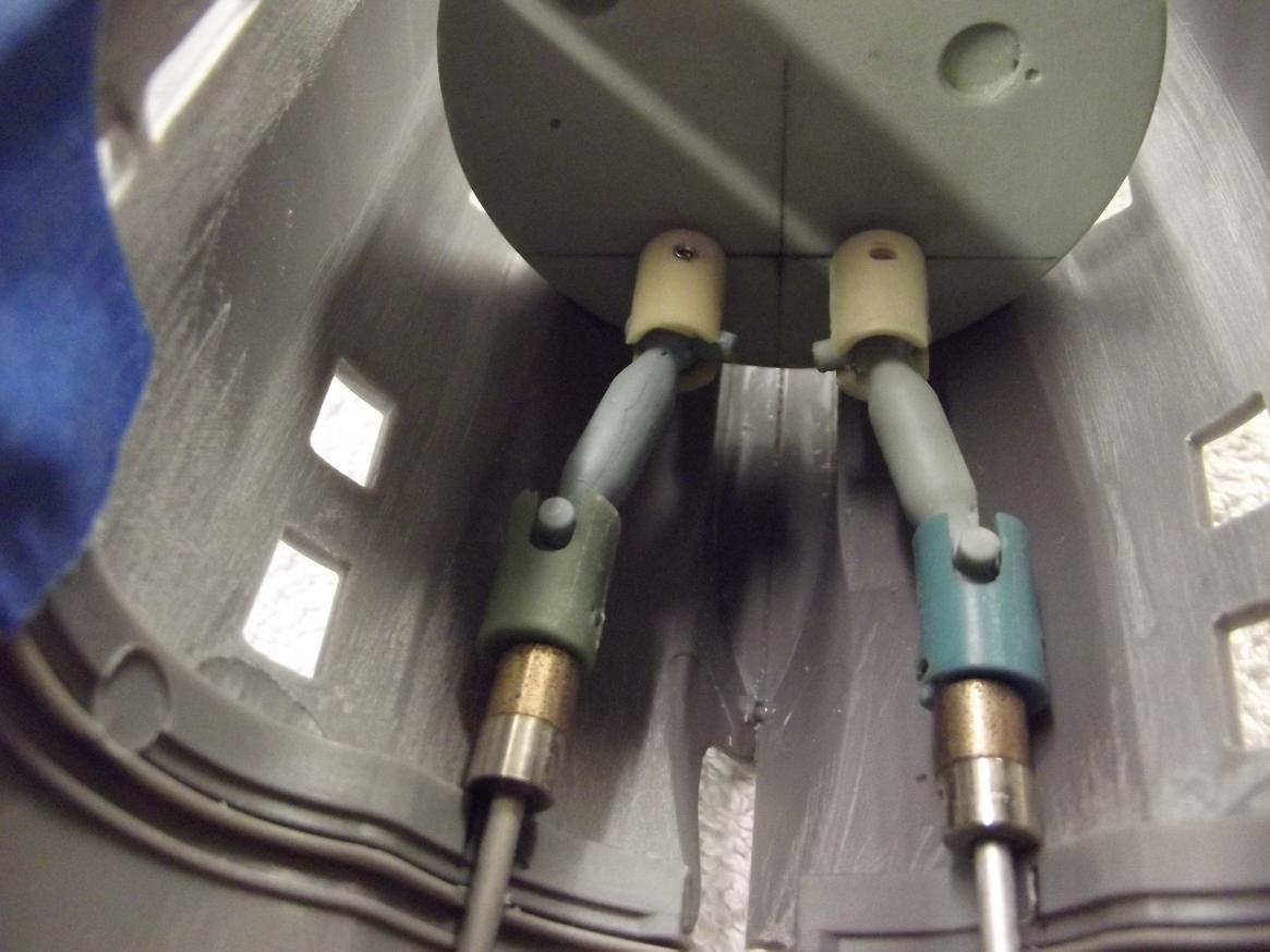

                              You can do better on the shaft alignment. Go the extra Mile. You have the ability, I do not.
                              Scott T
                                • 14011
                                Scott T
                                Not at all. Critical examination and constructive comment is always welcome. And your statement is fact.
                                However, I don't have the luxury of time. The arrangement I've established remains as is as it has to serve several shafting arrangement, not just the Type-9's.
