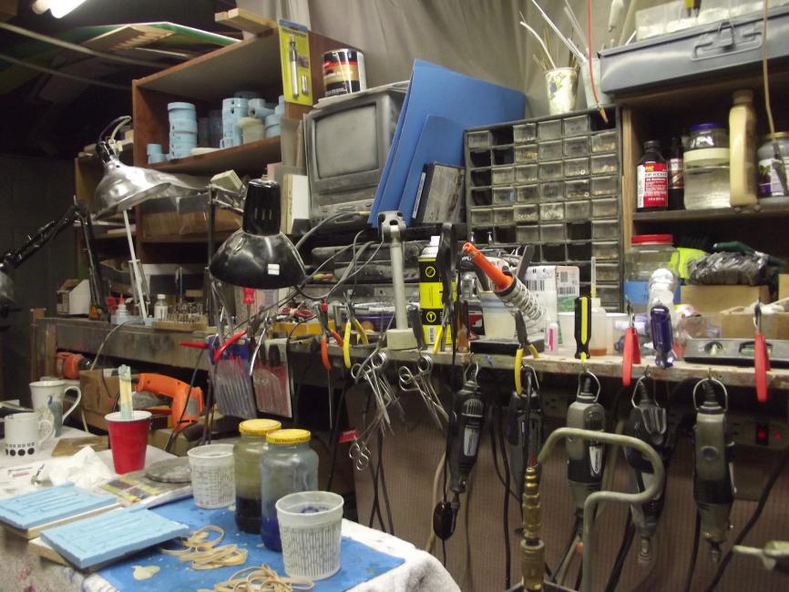

    OMG!! The mans got 15 Dremels hanging on his work bench.

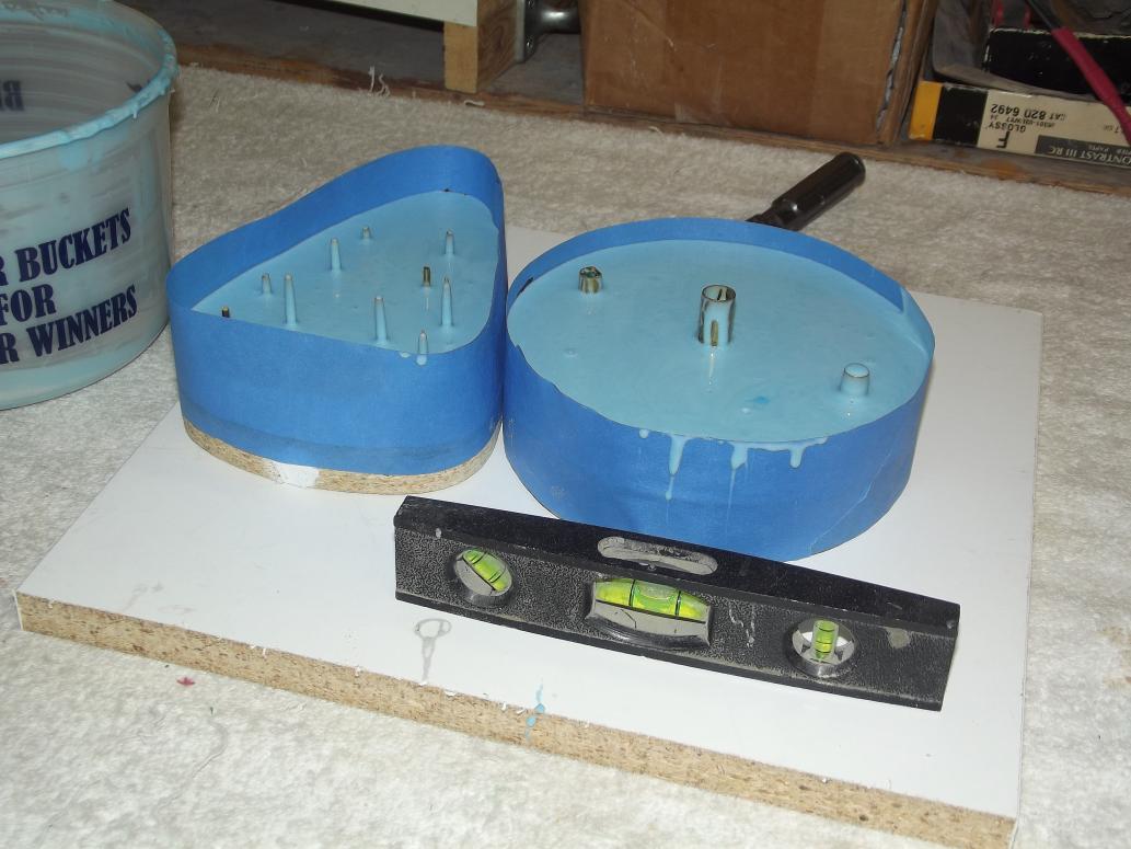

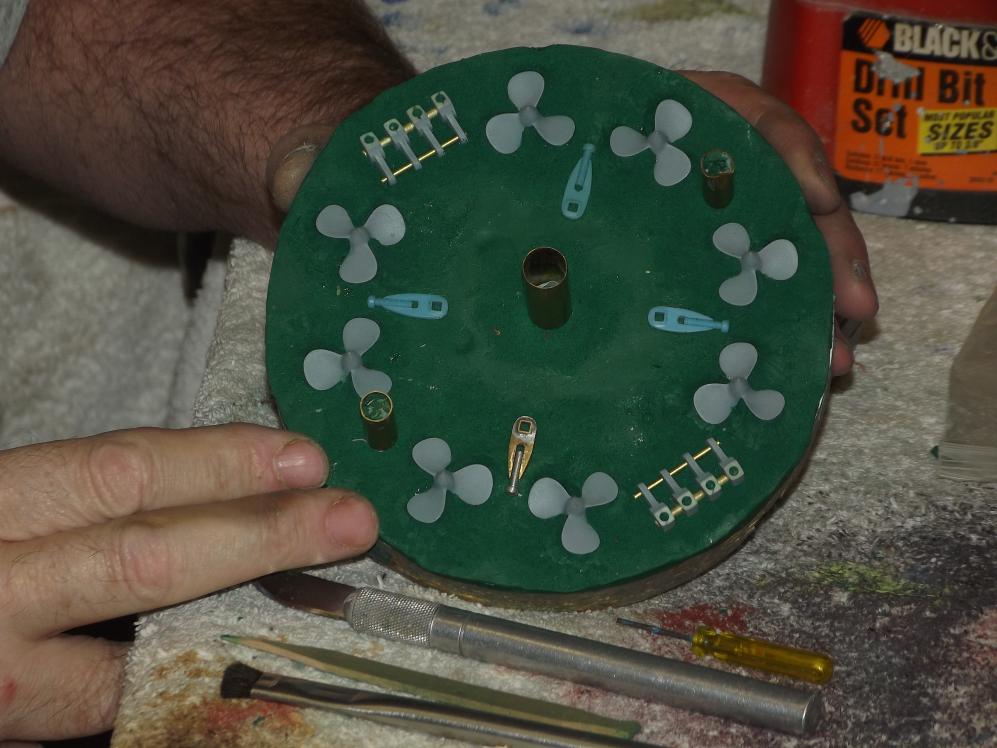

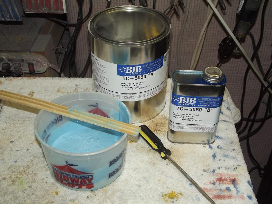

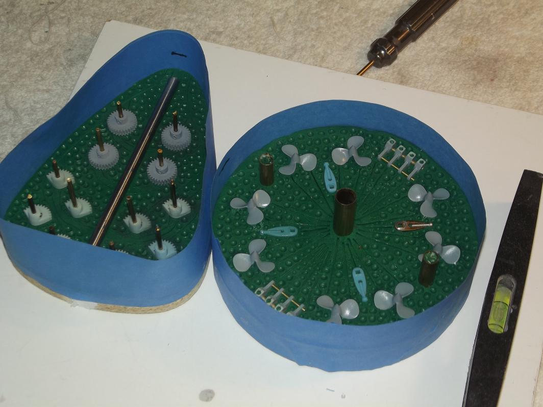

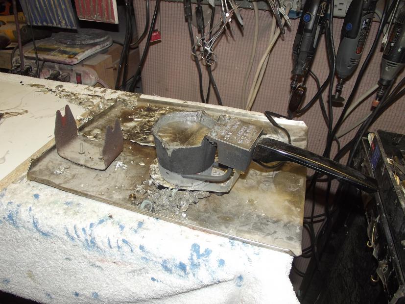

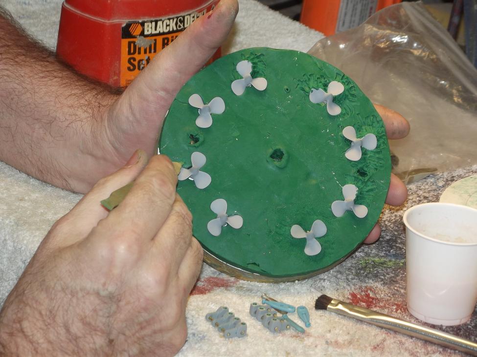

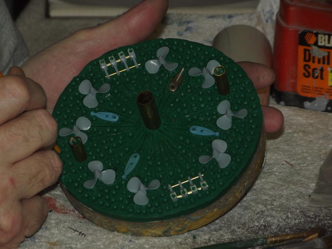

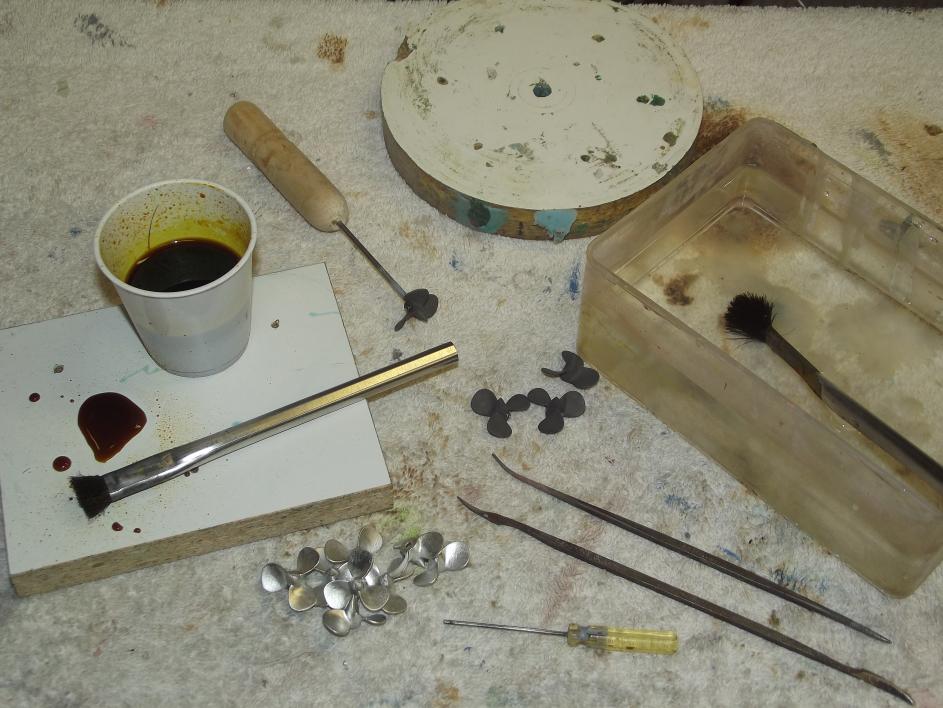

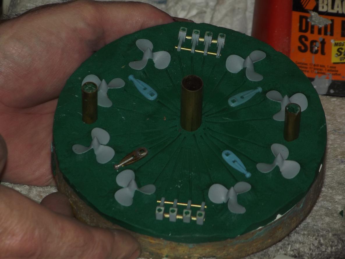

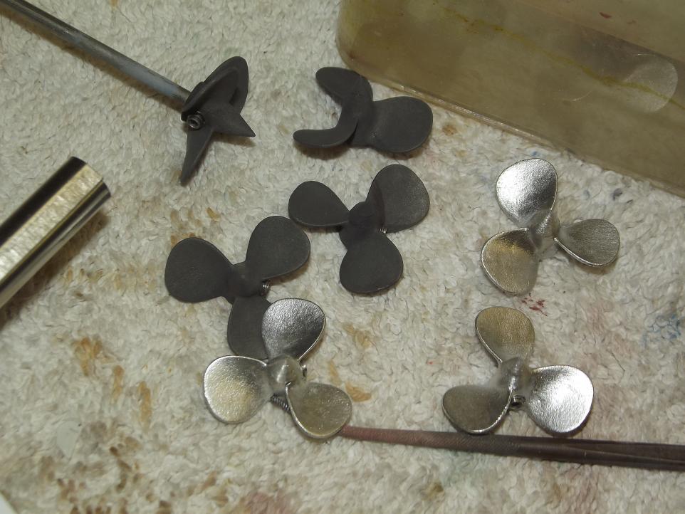

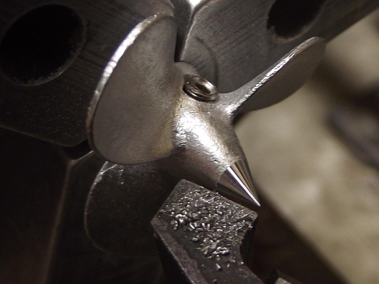

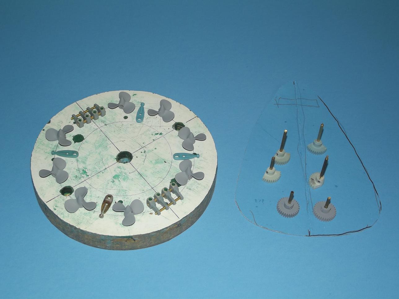

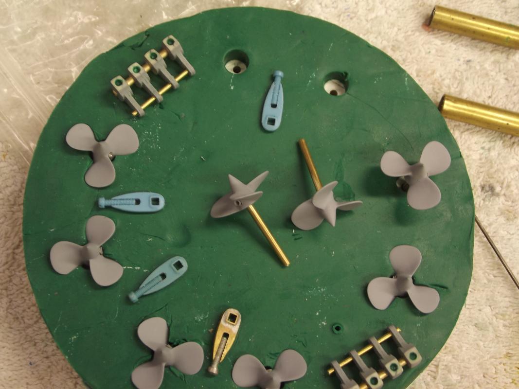

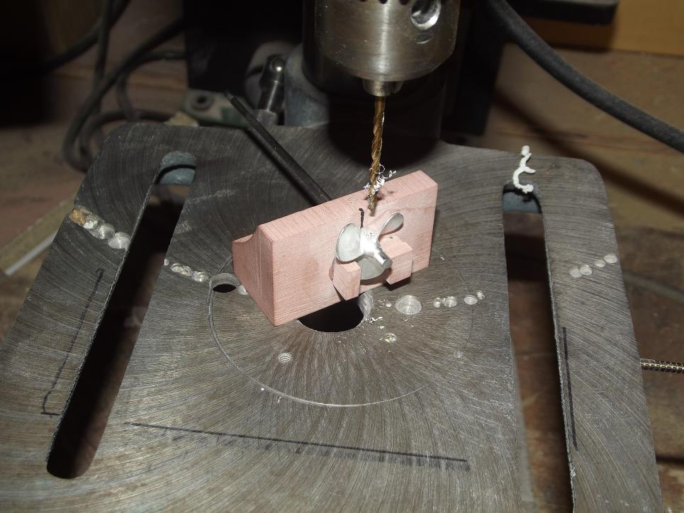

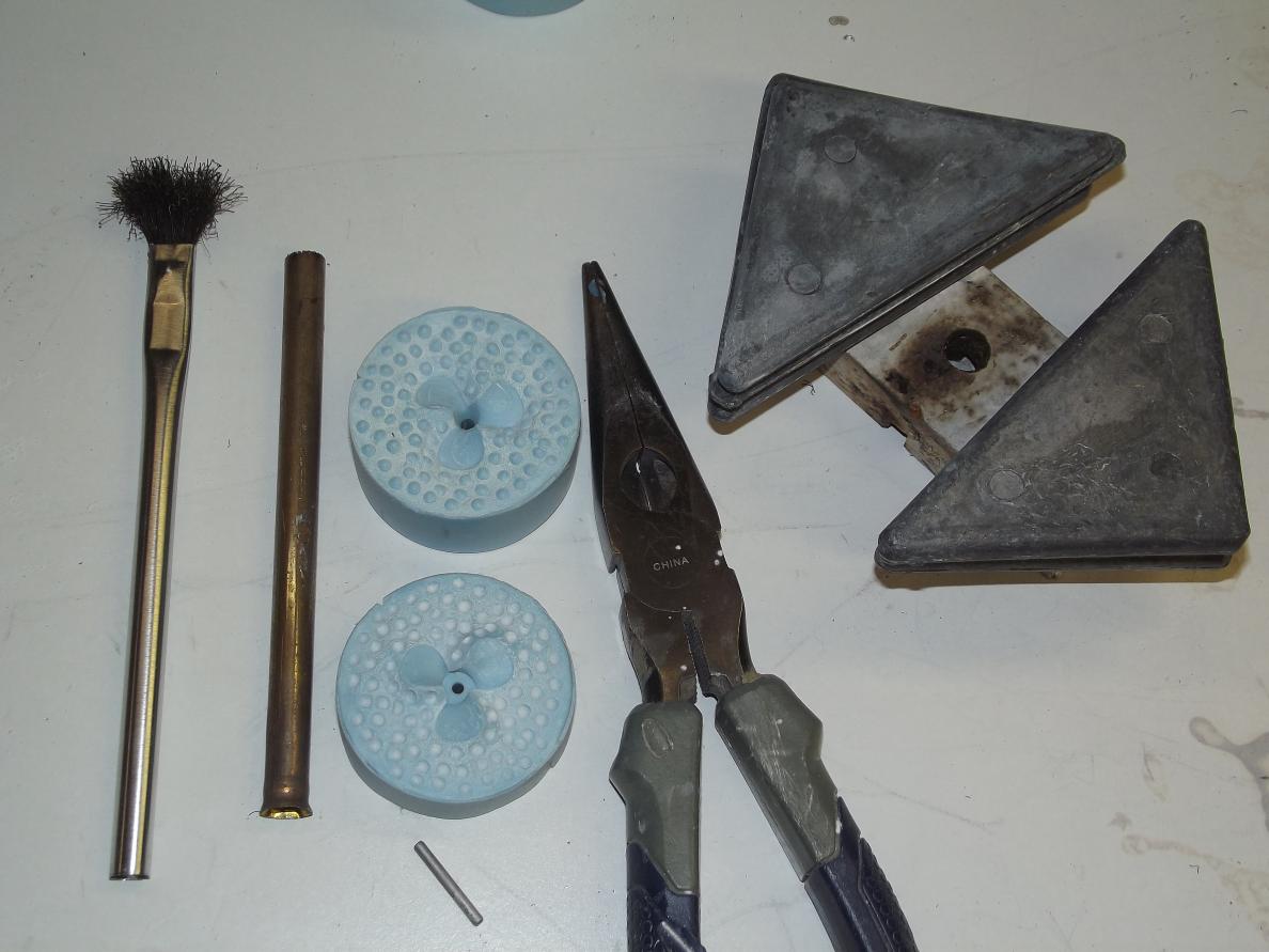

      1. What type of RTV do you use for prop casting? Is it a special type of high-temp silicone? Also, I assume you pour white metal into the molds to cast the props?

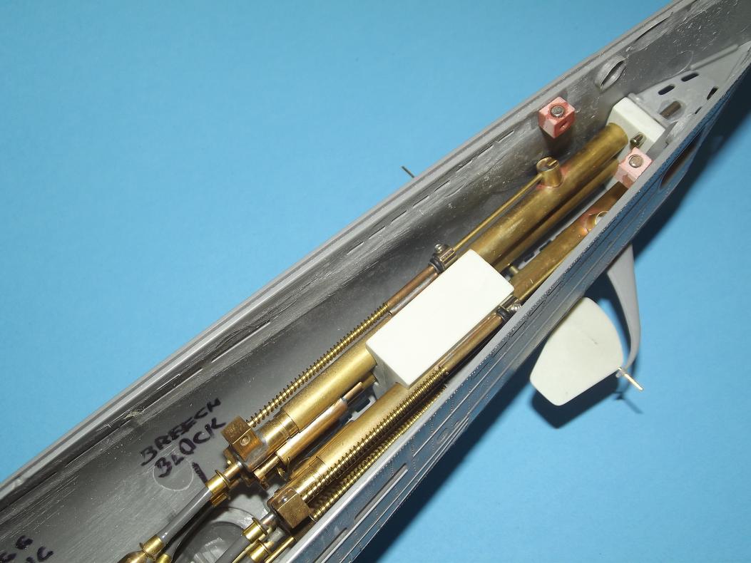

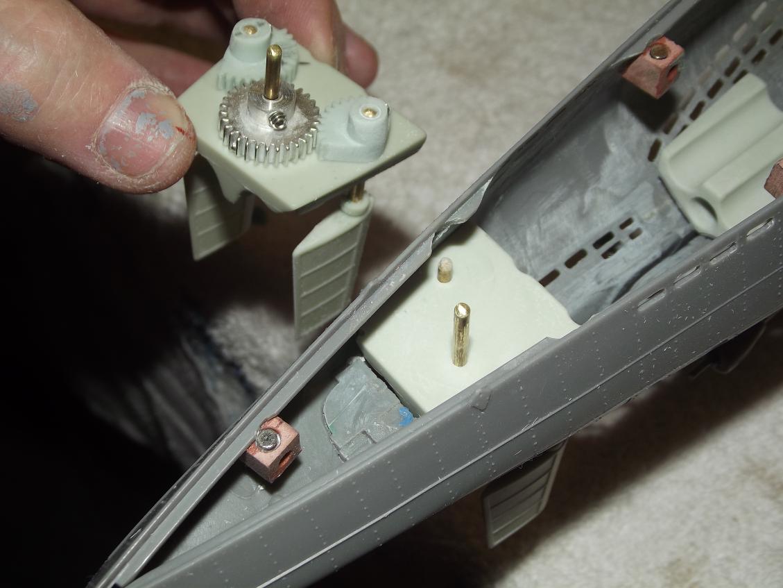

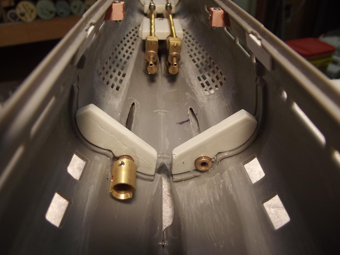

      2. You utilize renshape blocks to hold the magnets which secure the decks Is renshape impervious to water retention?
      Have done quite a bit of patternmaking using renshape, but never in a wet environment.
      Your assistance, as always, is much appreciated!
      Crazy-1, out!!!

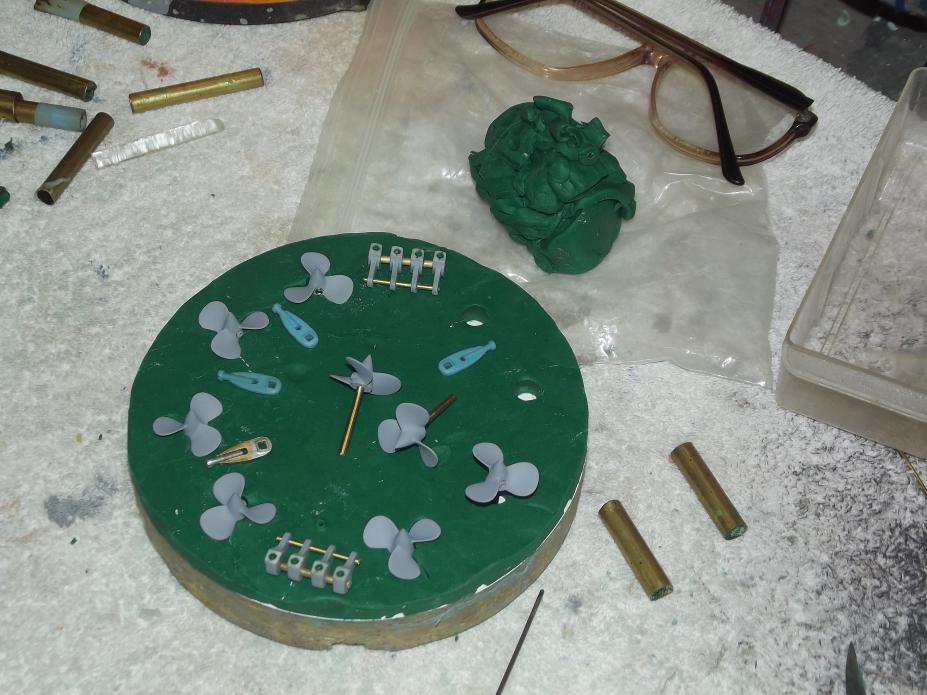

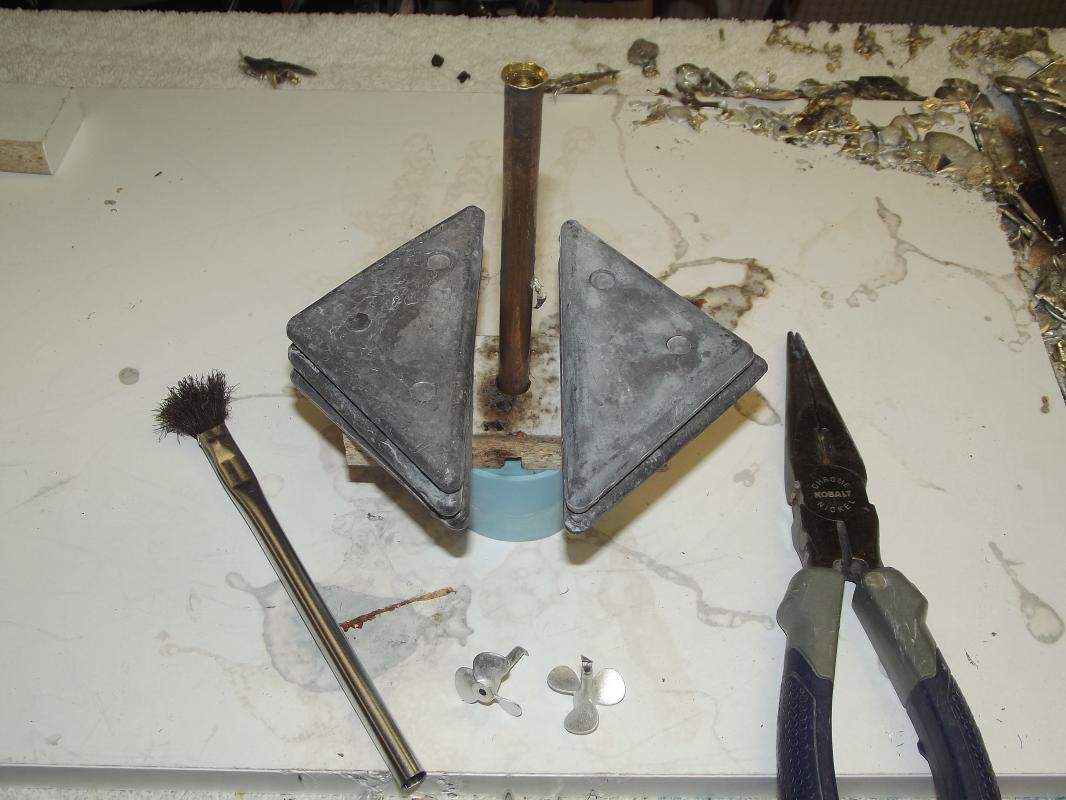

      BJB Inc's. TC-5050 Platinum-cure RTV. Yes, white metal; 95% Tin, 5% Antimony. I'll have some shots of the casting process tonight for you.
      RenShape is a closed-cell dense foam, so won't water-log. The one in this model are atypical from the production magnet foundations -- those will be cast resin. I love RenShape!

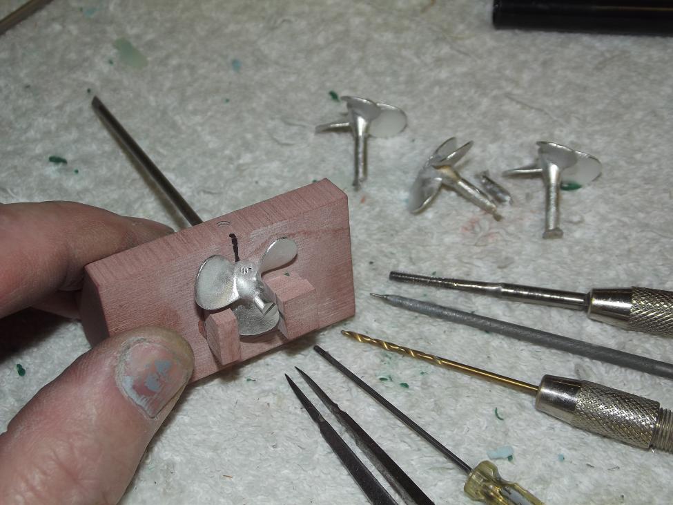

        Thanks, M!!

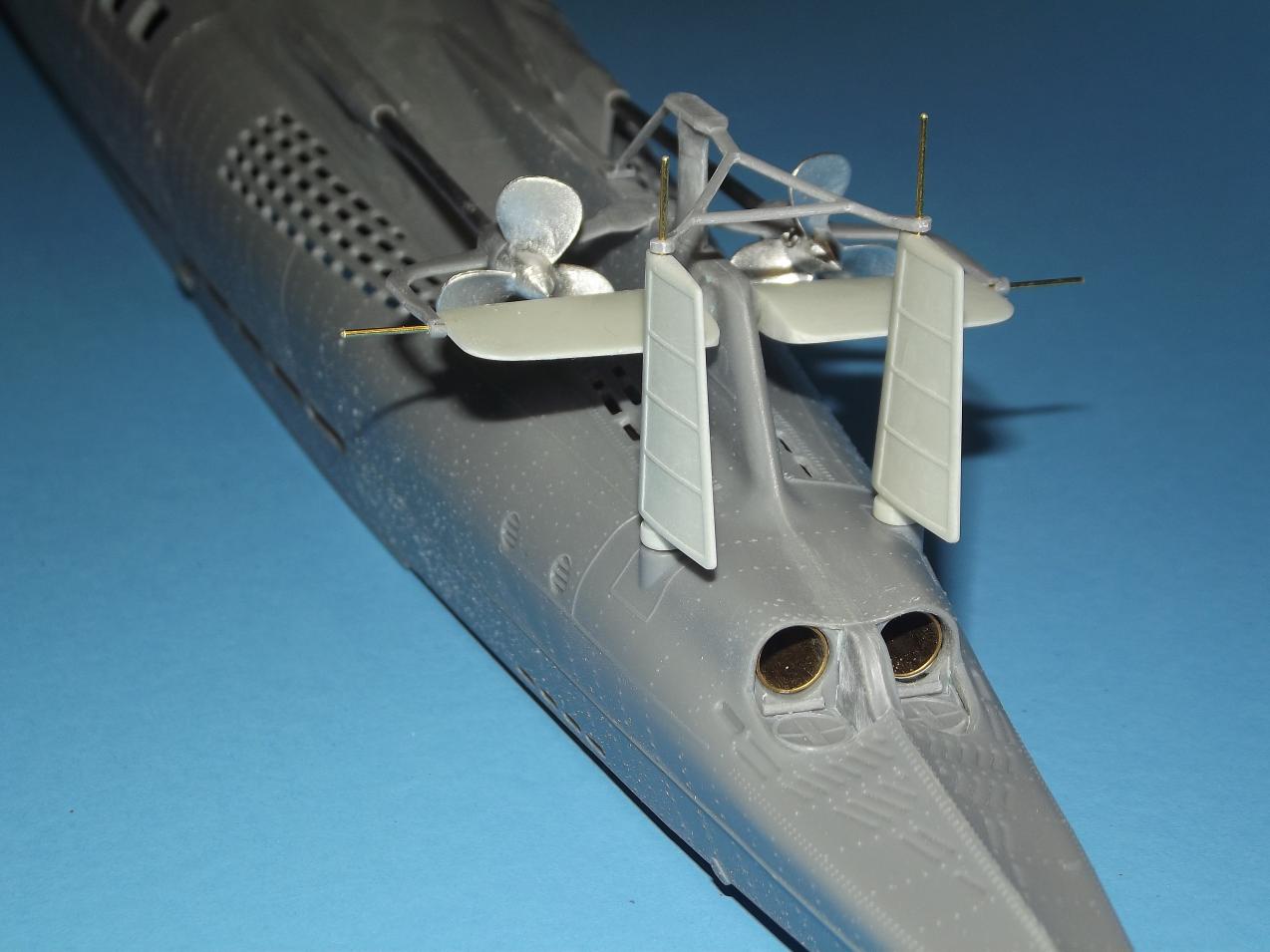

        The reason I asked about the prop casting is that I still have a really small 1:350 Hobby Boss USS Virginia that I'd like to, eventually, r/c. The plastic prop provided is seriously flimsy, and not sure how else to rectify the situation other than fabbing one from white metal. Of course, any alternative suggestions would be great! Epoxy or resin dip, mayhaps????
        While waiting for things to dry on my Skippy, I'm still in the process of trying to develop a viable 1" o.d. (?) wtc for the little "Ginny"! I'm pretty confident that I can pull it off. I think she'd make a pretty neat little dynamic diver for really limited sized "bodies of water. Film at eleven!! ( Or not!! Hah!!)
          • 2639
          #109
          Fab one from brass sheet and stock. The boss will be fiddly work, but it's doable.
          For a 1" WTC, I would bypass normal extruded plastic tubing, and think seriously about making my own composite tube by winding some glass tape, saturated in epoxy resin around a mandrel. This could be something simple like a wax candle of the right diameter, or aluminium tube. The latter would need to be treated with release agent. Once cured you should be able to obtain a release by putting the tube in the freezer for a few hours, the aluminium will contract more than the glass tube, and you should be able to knock it out.
          The reward for the hard work will be an optimal tube, light but strong, with a minimal wall thickness giving you more room inside.

            Thanks, Subculture!!
            I had considered that, but it's a 7-bladed prop which is only 1/2" in diameter!!
            At 67, I don't think I can afford to burn out quite that many brain cells!!
            Harbor Models has a 1/2" diameter prop that will most likely be o.k. It's 4-bladed, but the prop is shrouded anyway so it would be fine, but for such a small sub, I'd be a little concerned with the extra weight!! ( Got foam???)

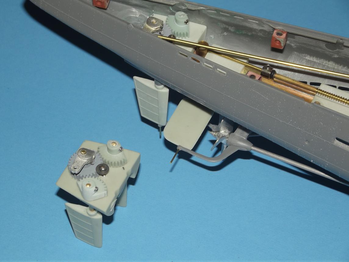

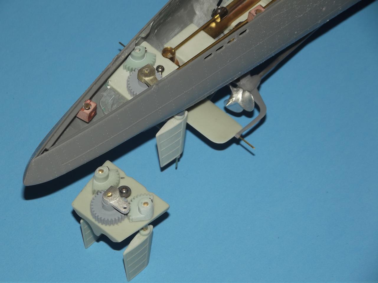

              #111

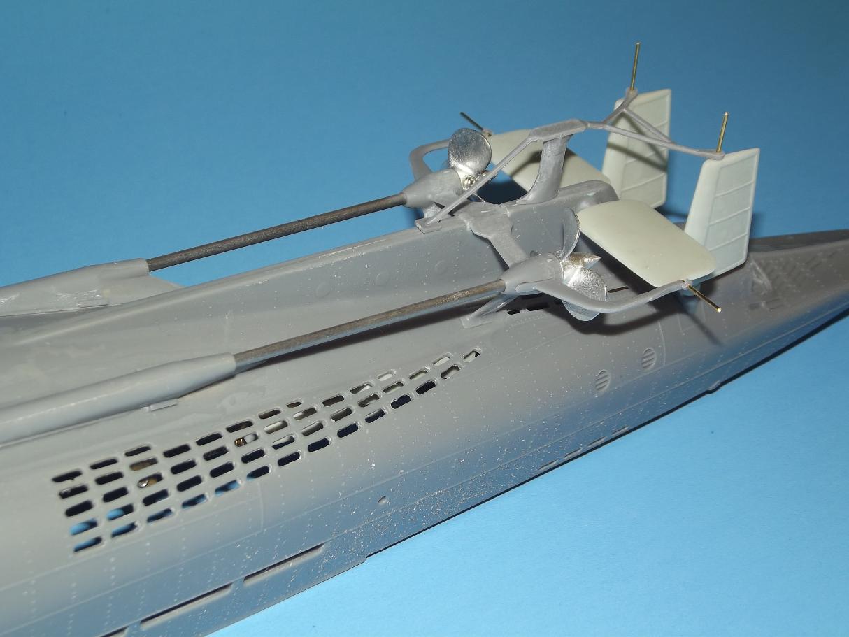

ID:	89405Click image for larger version
ID:	89406Click image for larger version
ID:	89395Click image for larger version
ID:	89396Click image for larger version
ID:	89397Click image for larger version
ID:	89398Click image for larger version
ID:	89399Click image for larger version
ID:	89400Click image for larger version
ID:	89401Click image for larger version
ID:	89402Click image for larger version
ID:	89403Click image for larger version

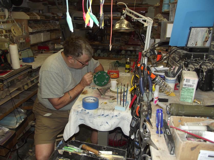

              Last edited by Kazzer; 01-03-2014, 09:56 AM. Reason: Had to show him working! No wonder the orders take so long to get out!

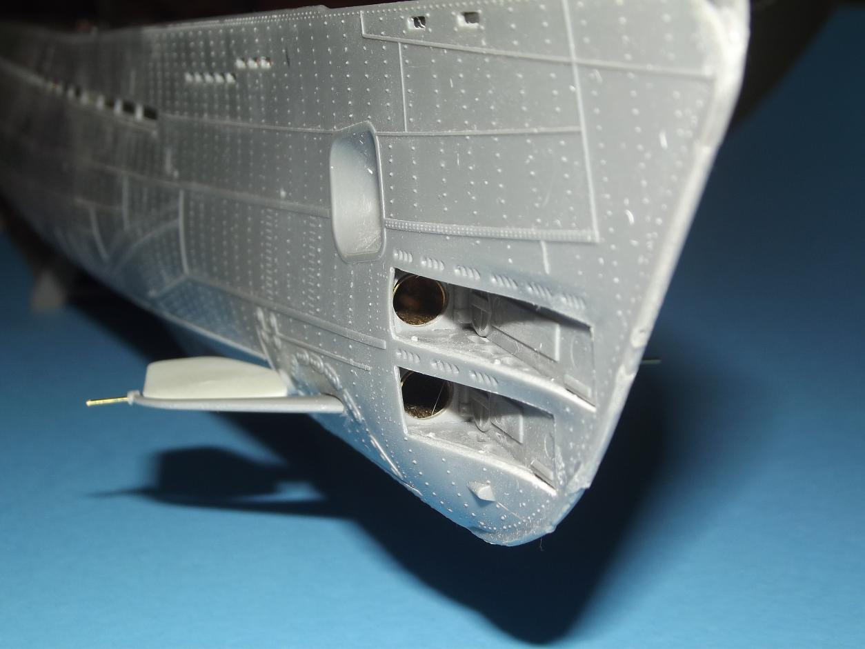

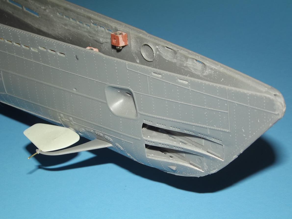

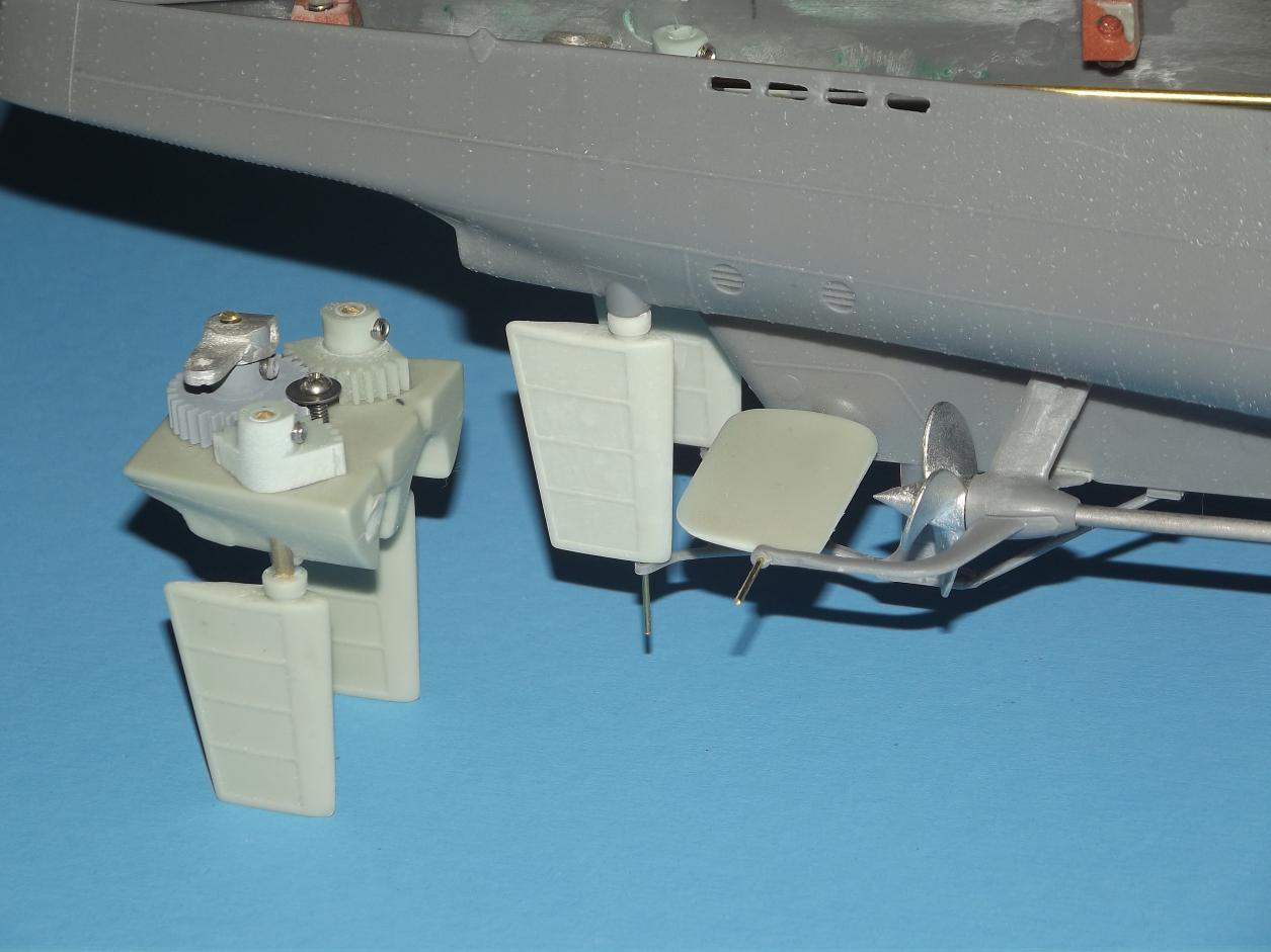

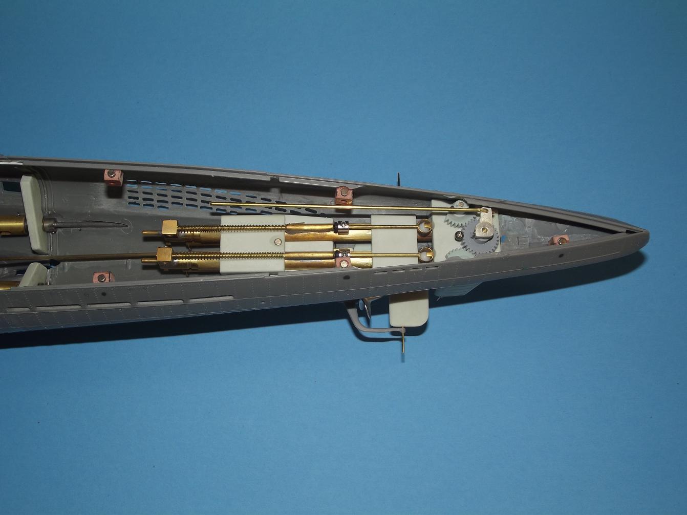

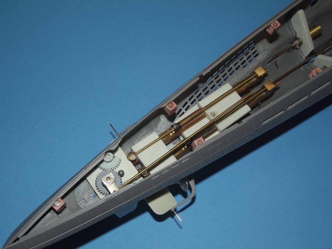

                #112

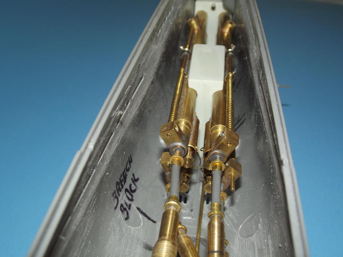

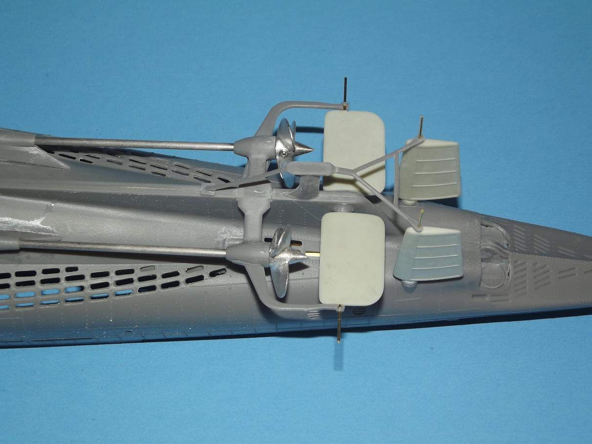

                Amazing how the fitings are being done and how they fit inside the sub. I'm start thinking that HWSNBN took part in the desing of the sub model. Pay special attention on the picture from the great man doing "Spanish yoga" (as siesta is also known), closely watched by the Door's Guard.
                  • 13974
                  #113
                  Spanish Yoga. Ha! I call it, the hideous afternoon nap. I know its time to drag my fat ass back to the shop when Mr. Cat puts his fresh-from-the-litter-box paws on my face.

                    Also, thanks for the prop-casting photos.
                      • 13974
                      #115

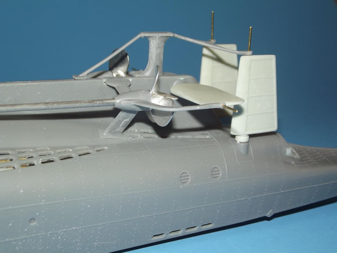

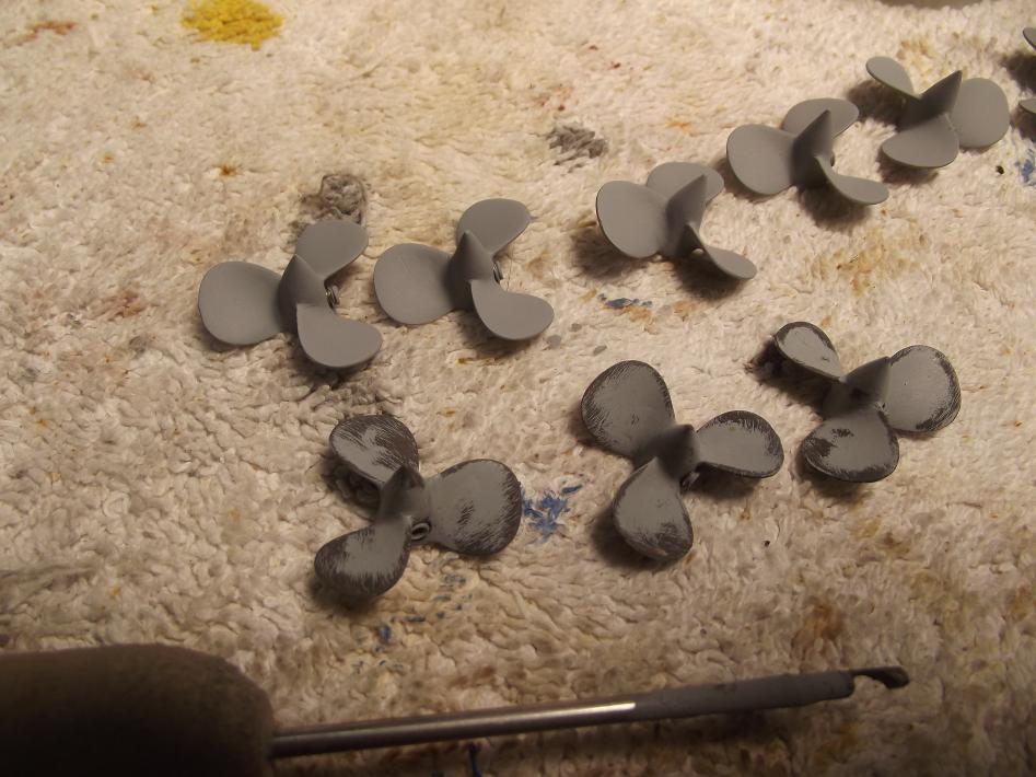

                      Those propellers will be cleaned up, ganged into a disc type metal-casting tool which in turn will be used for production work.
                        • 13974
ID:	89427Click image for larger version

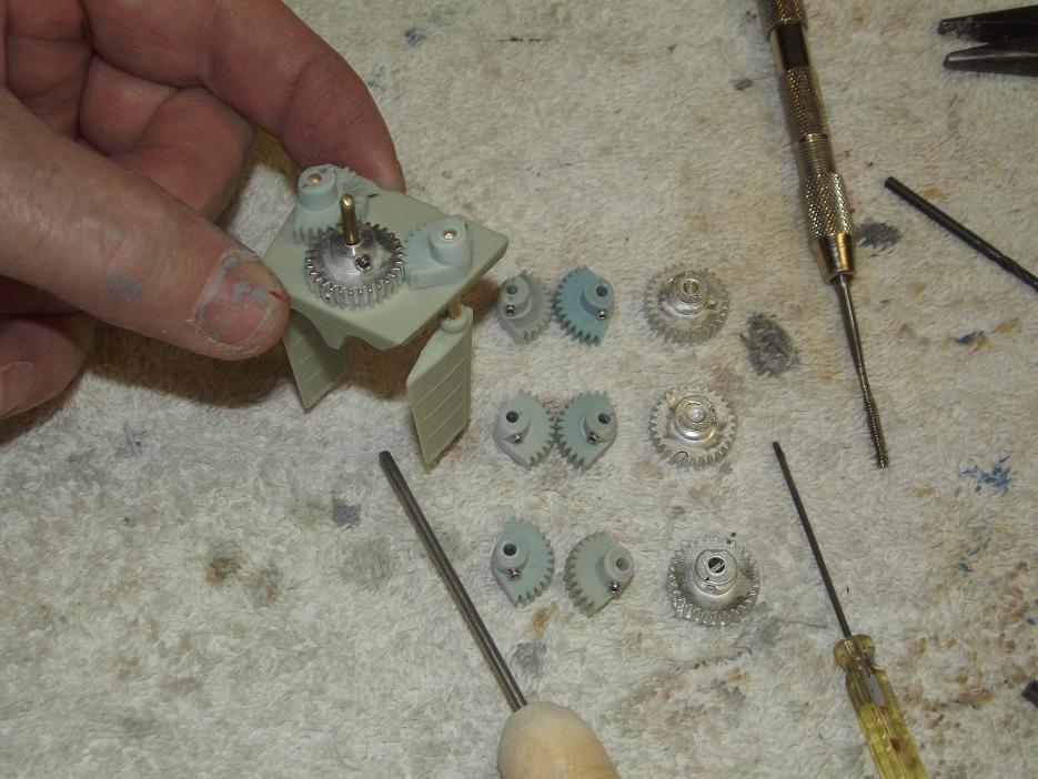

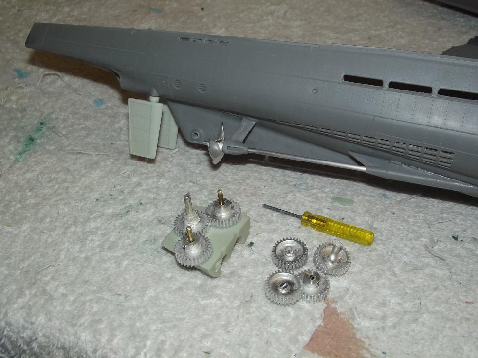

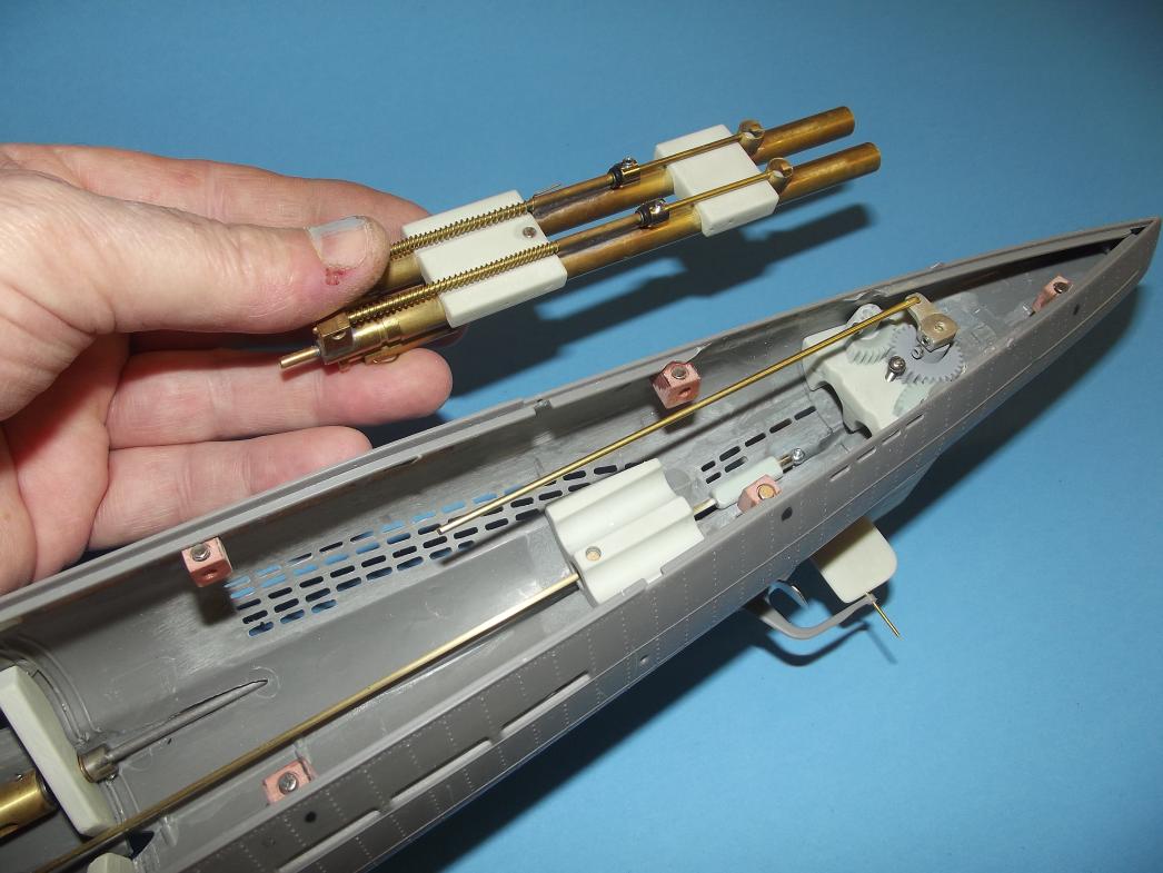

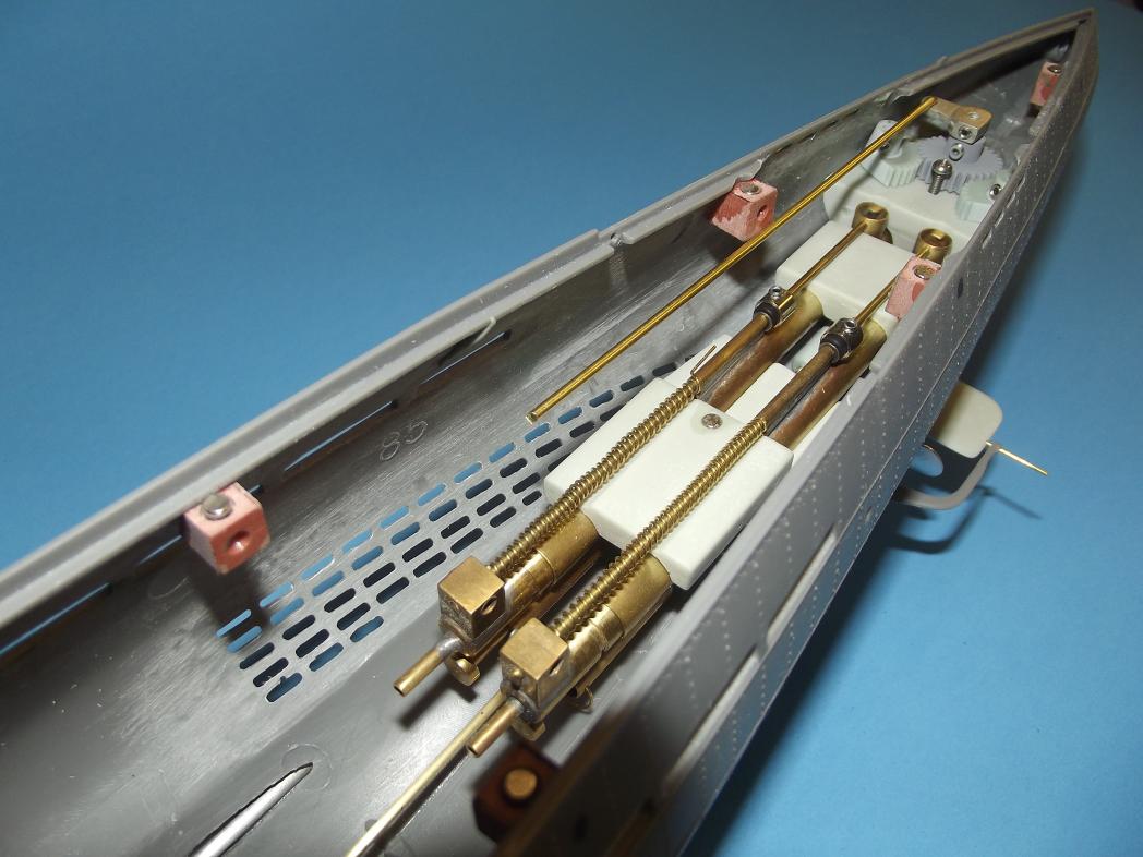

                          #117
ID:	89452Click image for larger version
ID:	89453Click image for larger version
ID:	89454Click image for larger version
ID:	89455Click image for larger version
ID:	89456Click image for larger version
ID:	89457Click image for larger version
ID:	89458Click image for larger version
ID:	89459Click image for larger version
ID:	89460Click image for larger version
ID:	89461Click image for larger version
ID:	89462Click image for larger version
ID:	89463Click image for larger version
ID:	89464Click image for larger version
ID:	89465Click image for larger version
ID:	89466Click image for larger version
ID:	89467Click image for larger version
ID:	89468Click image for larger version
ID:	89469Click image for larger version
Name:	DSCF8479 - Copy.jpg
ID:	89470Click image for larger version
ID:	89471Click image for larger version
ID:	89472Click image for larger version
ID:	89473Click image for larger version
                            #118
                            Superb engineering, i love it

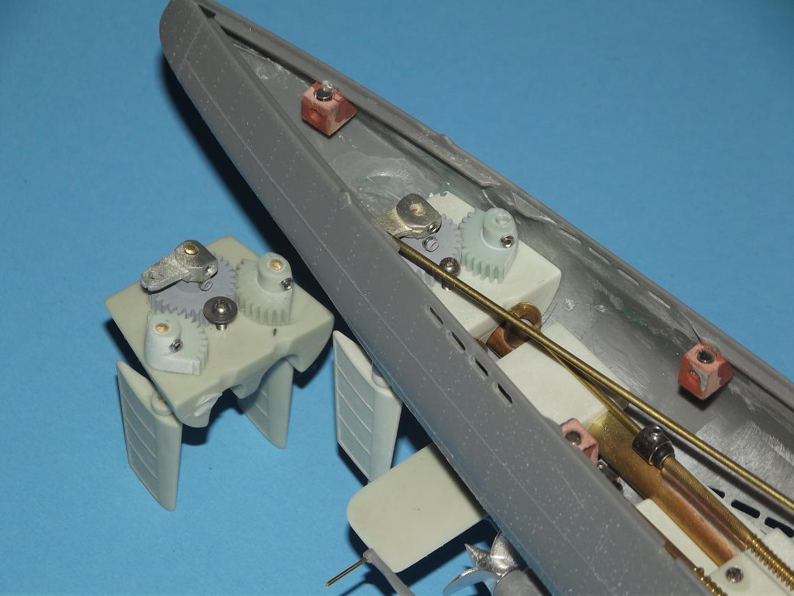

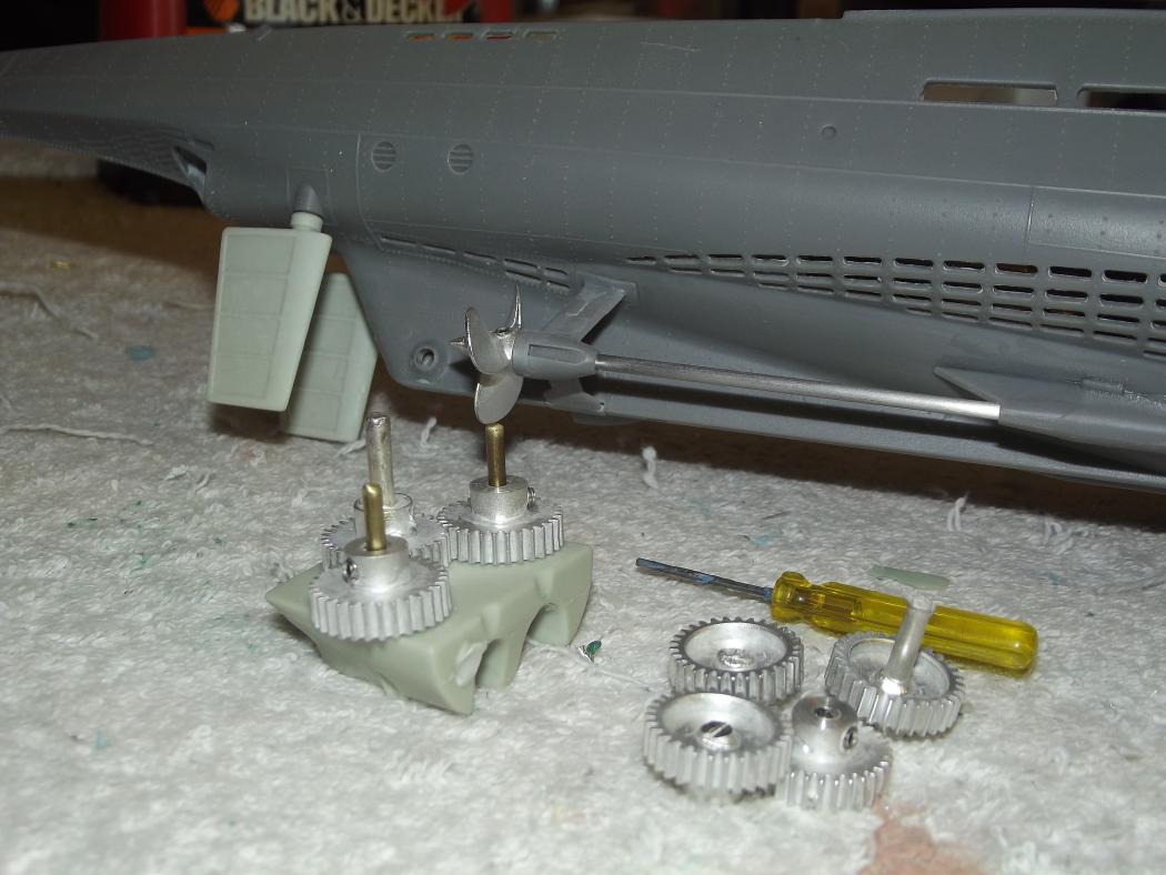

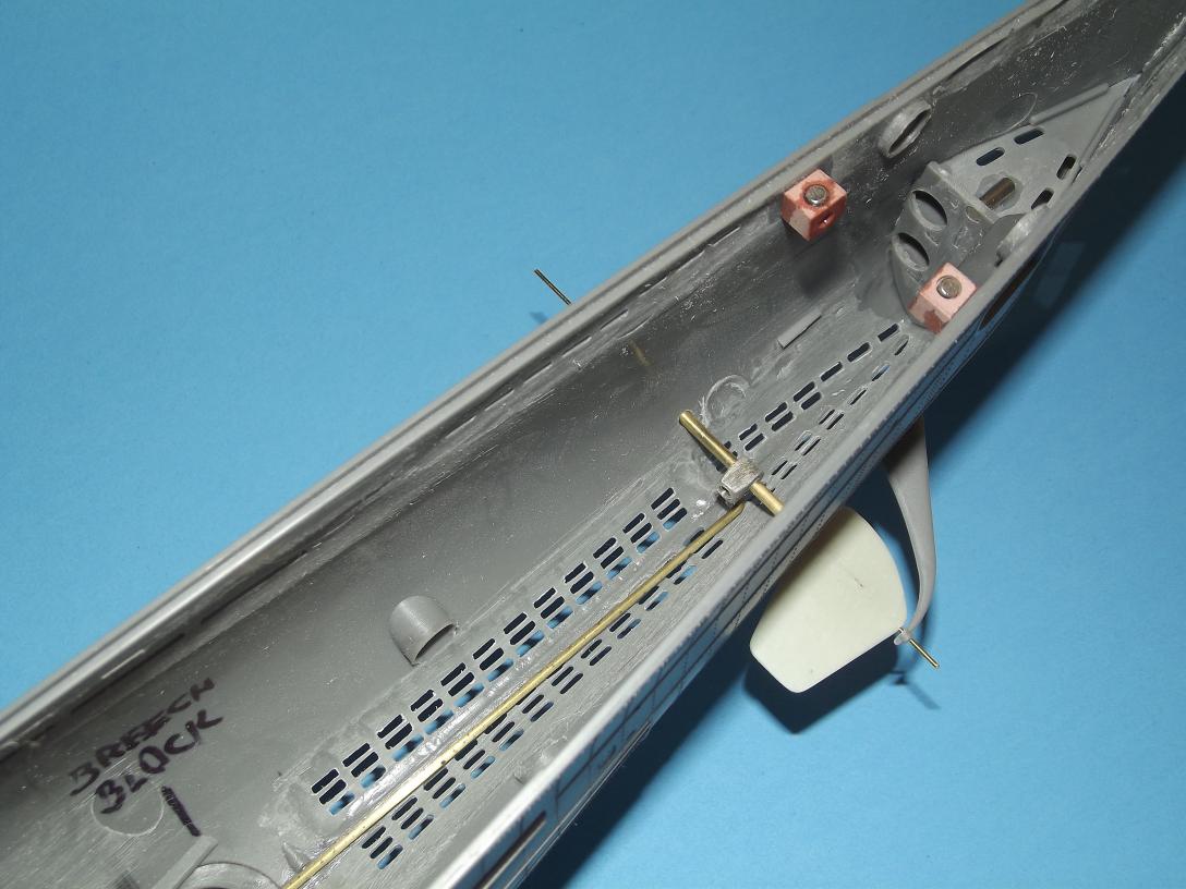

                              #119
ID:	89482Click image for larger version
ID:	89483Click image for larger version
ID:	89484Click image for larger version
ID:	89485Click image for larger version
ID:	89486Click image for larger version
ID:	89487Click image for larger version
ID:	89488Click image for larger version
ID:	89489Click image for larger version
ID:	89490Click image for larger version

                                #120
                                Really like all the locating depressions on your molds!
                                Makes for dang near prefect registration!!
                                Good one, M!!
