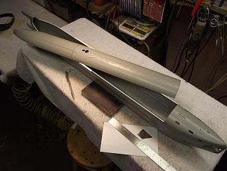

    and so............
ID:	174015 Click image for larger version
ID:	174016 Click image for larger version
ID:	174017 Click image for larger version

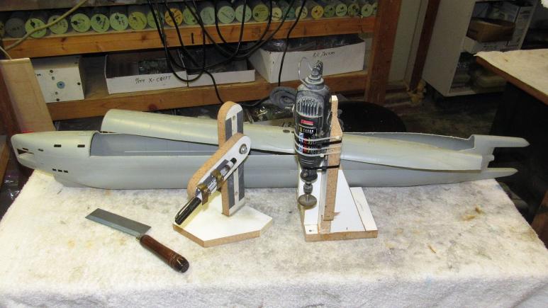

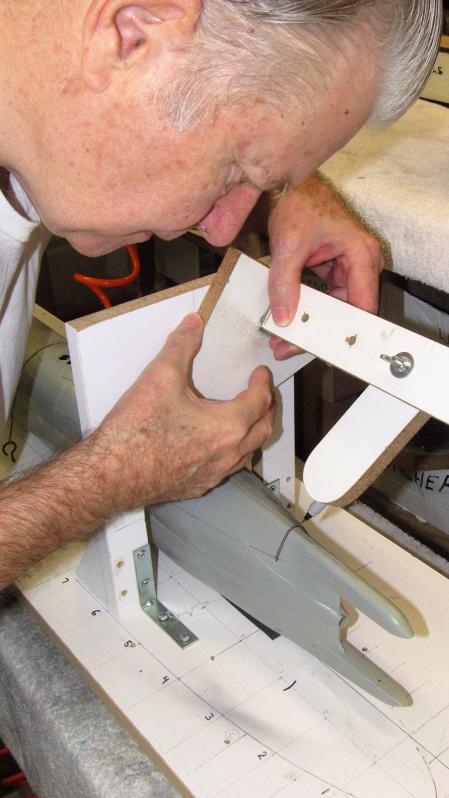

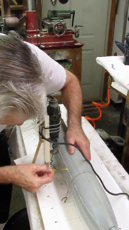

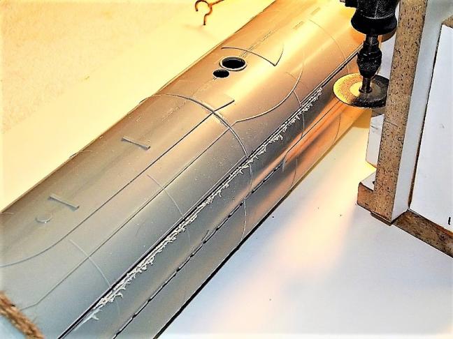

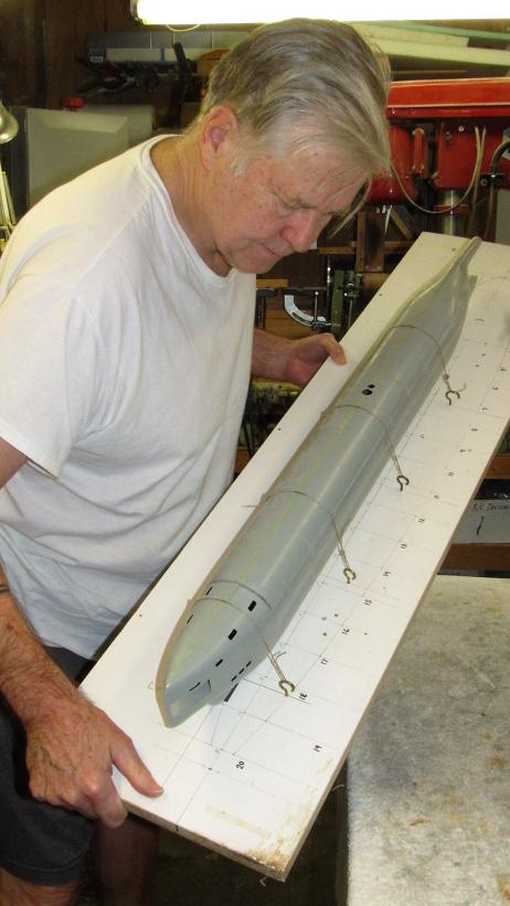

    David which cutting wheel did you use? Also, I assume a low RPM like 10,000-15,000?
      • 13890
      #32

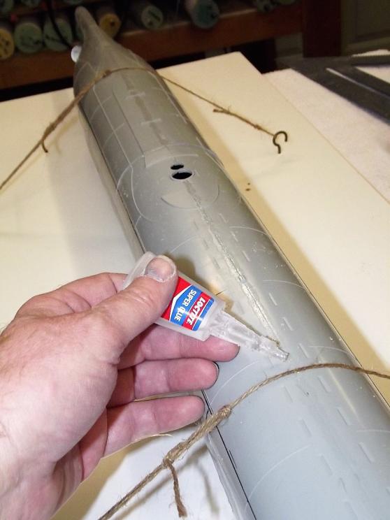

      A very thin diamond wheel at maximum speed. The trick is to feed into the work in the direction of the wheels rotation and to make the feed in very short, light of pressure, stabs into the work. Don't try for a cut-through on the first pass. It takes about an hour to make the two longitudinal cuts this way. Take your time; don't rush; don't push; and ensure that the model is very, VERY, VERY secure to the worktable or you'll **** it all up! There is a strip of #100 sandpaper glued to the worktable to keep the models keel from sliding, and the twine retaining straps are sinched down tight and temporarily glued to the top of the hull.

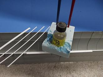

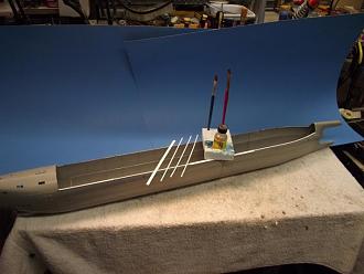

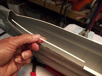

                      How to make up material lost to kerf.
ID:	174047 Click image for larger version
ID:	174048 Click image for larger version
ID:	174049 Click image for larger version
ID:	174050 Click image for larger version
                      David, is this plastic stock and what thickness, or does thickness depend on thickness of kerf lost?
