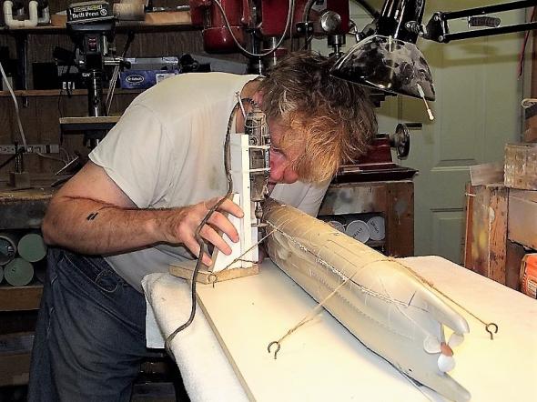

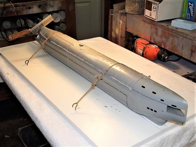

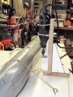

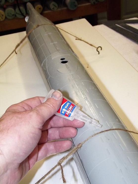

                    • 13706

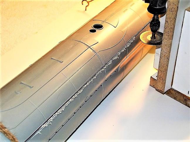

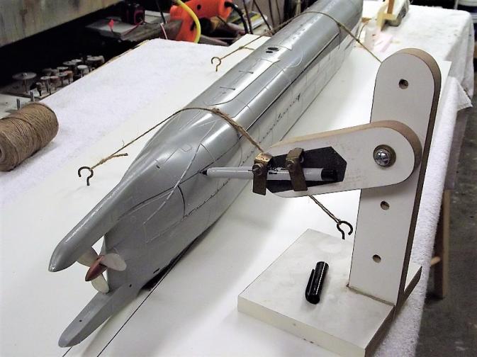

                    Originally posted by tifosi12
                    I had that fittings kit and used it in my Bronco kit. The best part was the rear section to hold the prop. Some parts were less helpful (e.g. the crew) and I couldn't get the bits to hold the hull together to stick at all. Tried everything but they constantly broke off. I ruined about 3 Bronco kits in the process trying to get the hull cut in half and fit, but gave up eventually. That's when I decided not to do a plastic kit conversion ever again and instead 3D print stuff going forward. Never looked back.
                    Like so........................

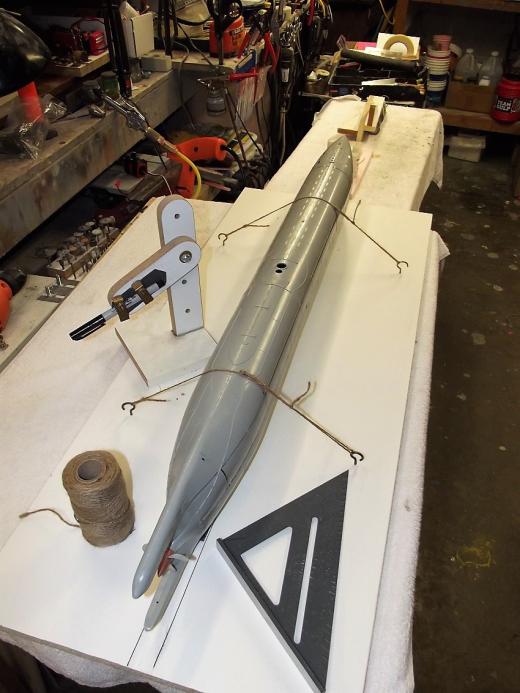

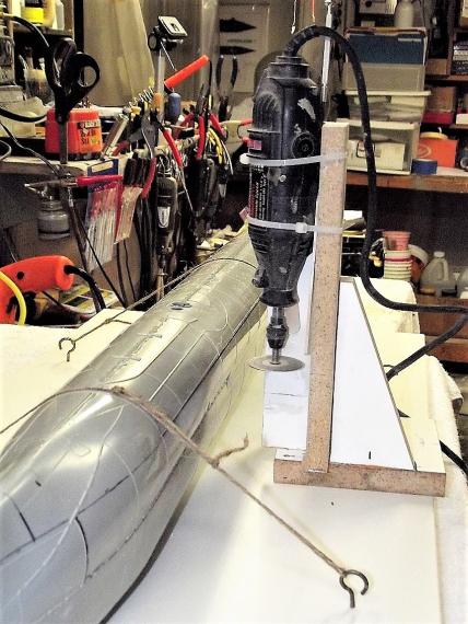

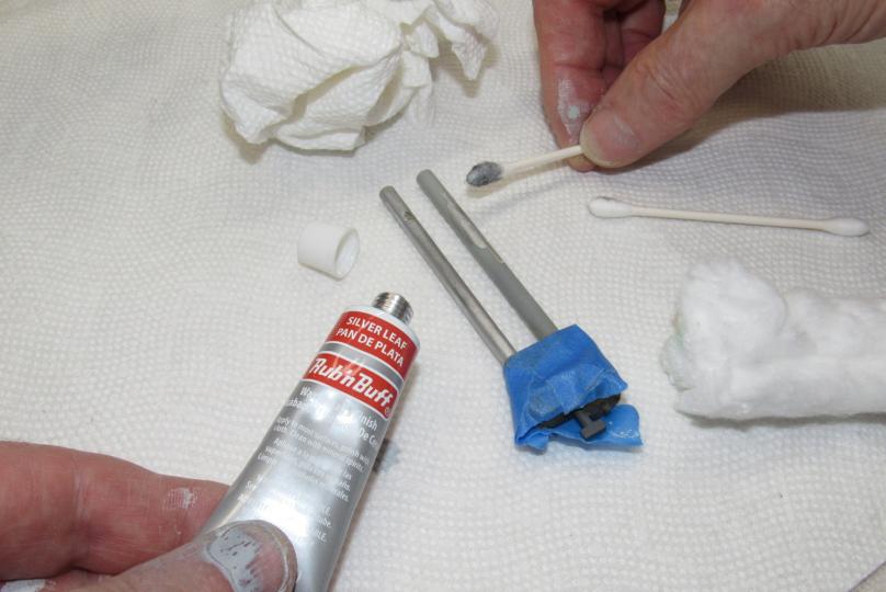

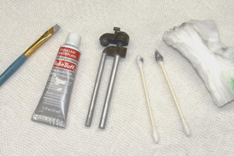

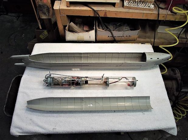

                      • 13706
                      and so............

                        • 1574
                        Good job. I’m going to attempt it soon.

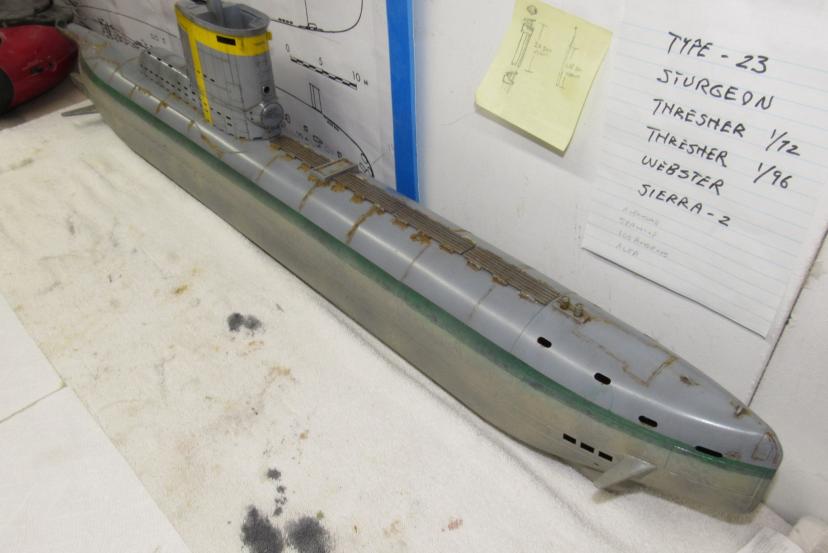

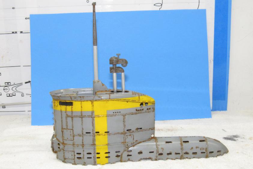

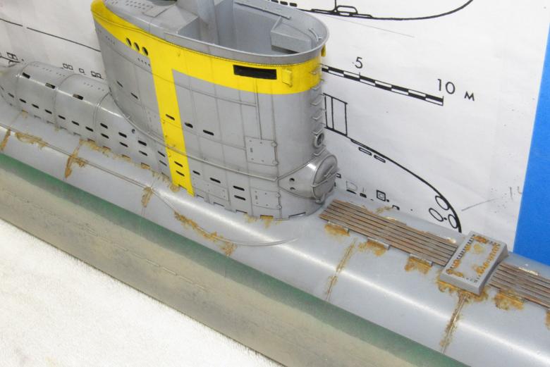

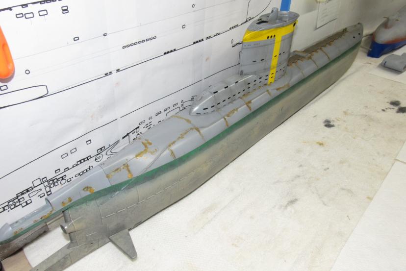

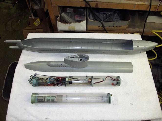

                          • 13706
                          The finished product. Just before the 2028 SubFest event:
