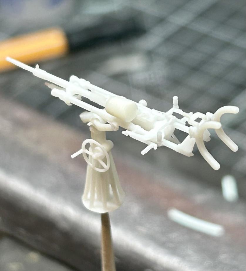

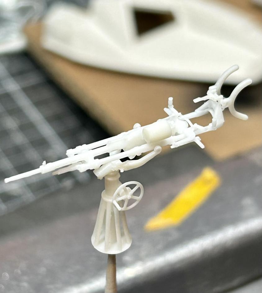

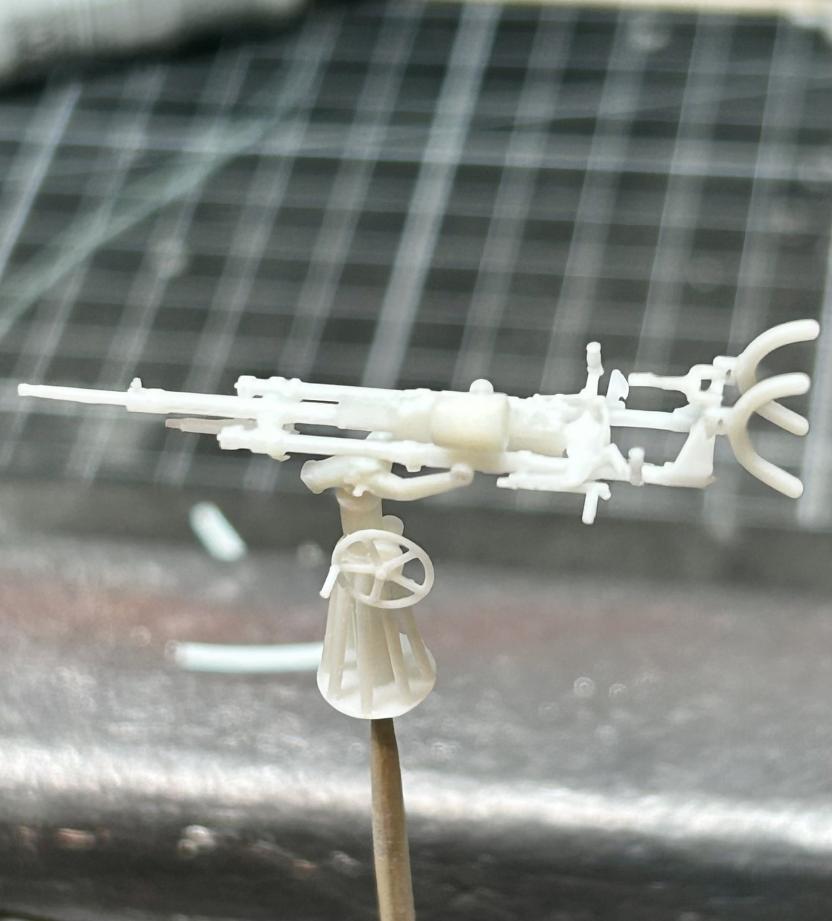

            It actually worked out quite well. After a few tries I managed to 3D-print all parts of the 20 mm Madsen deck gun for my 1/72 scale Type II submarine Vesikko. Primer + paint should be the easy part….
            Click image for larger version  Name:	Vesikko-155.jpg Views:	0 Size:	57.5 KB ID:	192762
            Click image for larger version  Name:	Vesikko-156.jpg Views:	0 Size:	61.4 KB ID:	192763

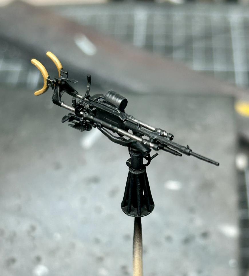

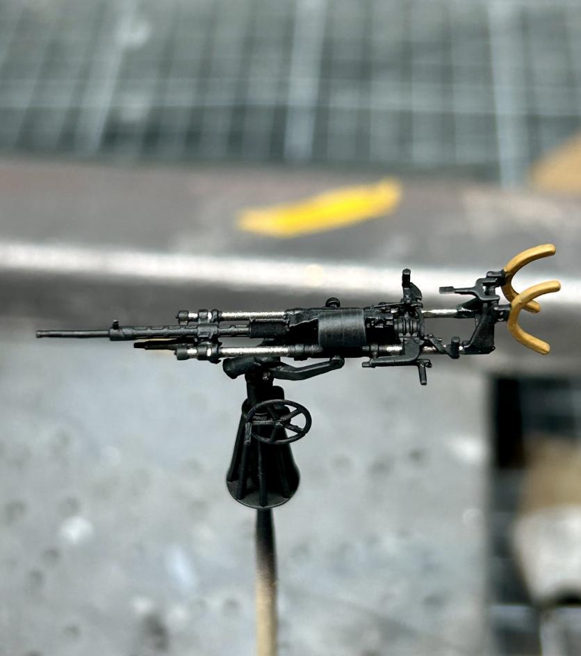

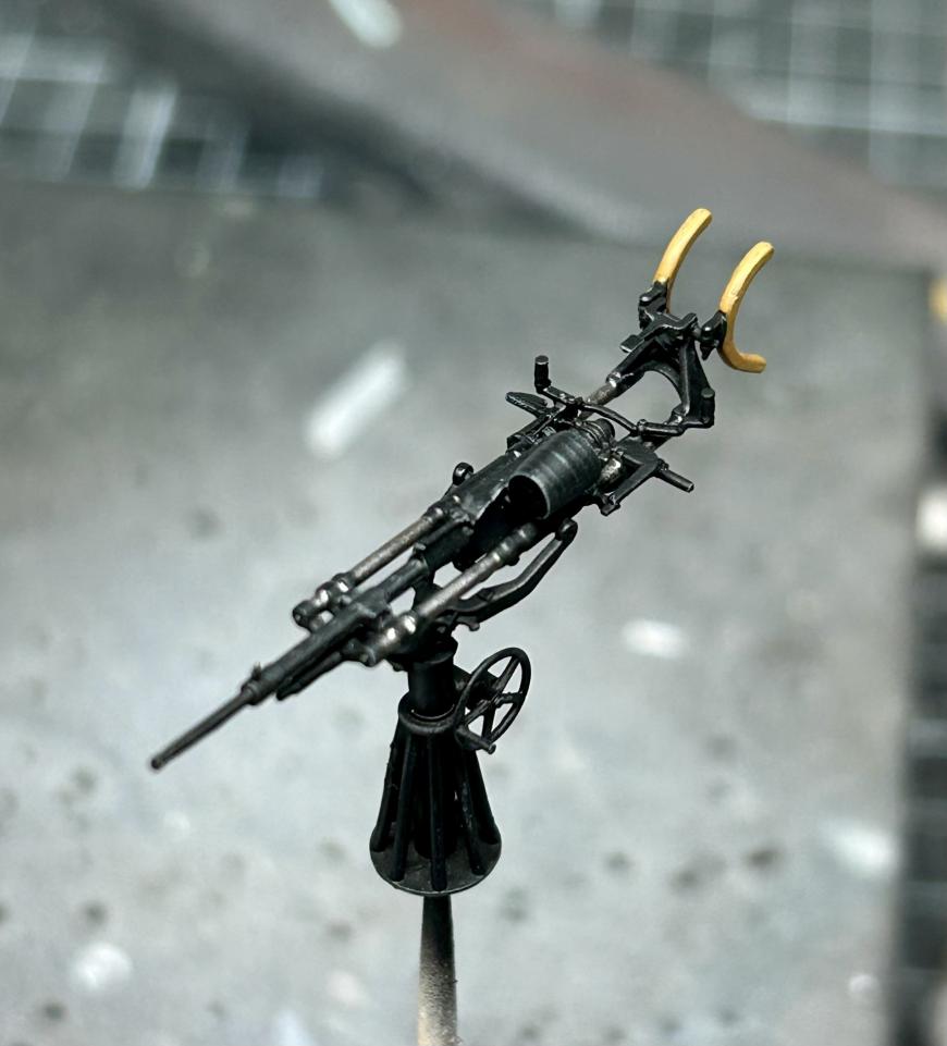

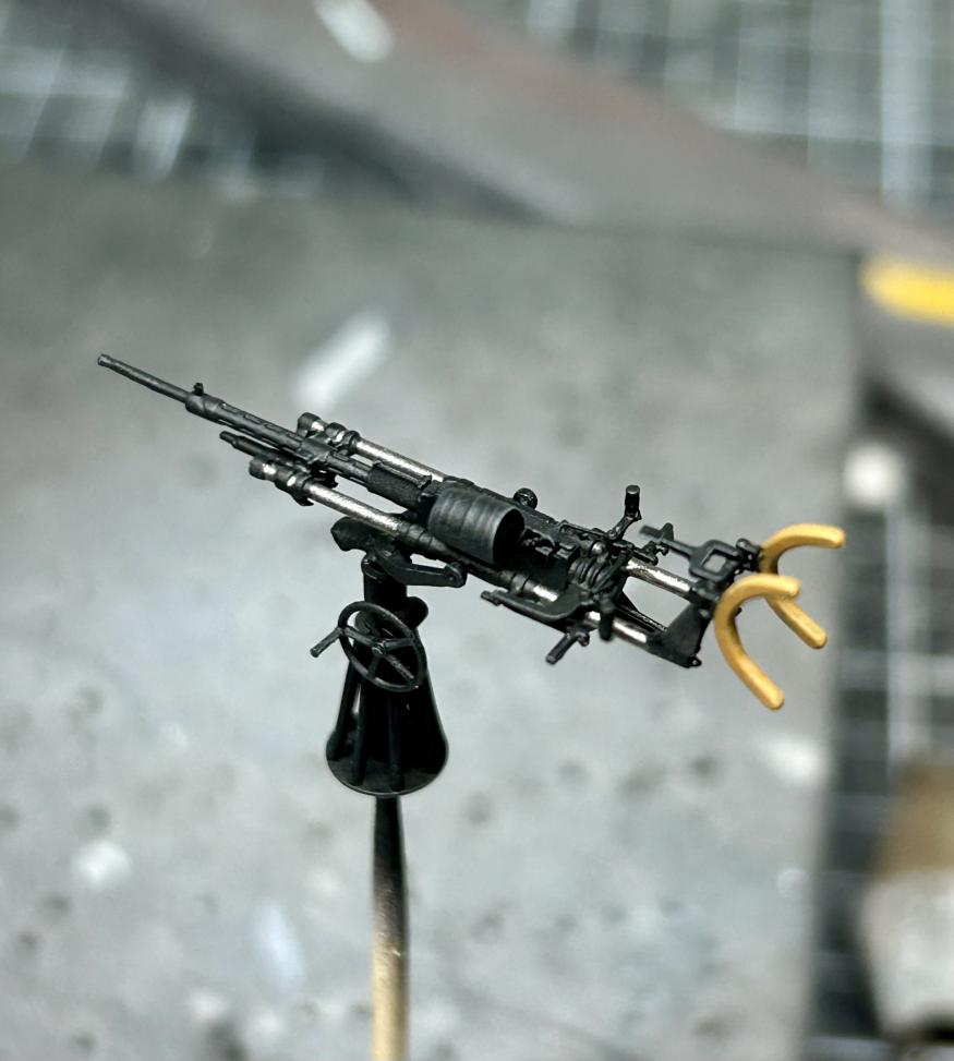

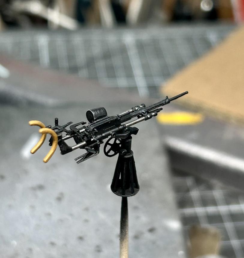

                Madsen 20mm AA gun is done. Looks good even in a macro photo. For size comparison: this is a gun on a toothpick . Still waiting for decals to continue the build of the submarine that this gun is meant for.

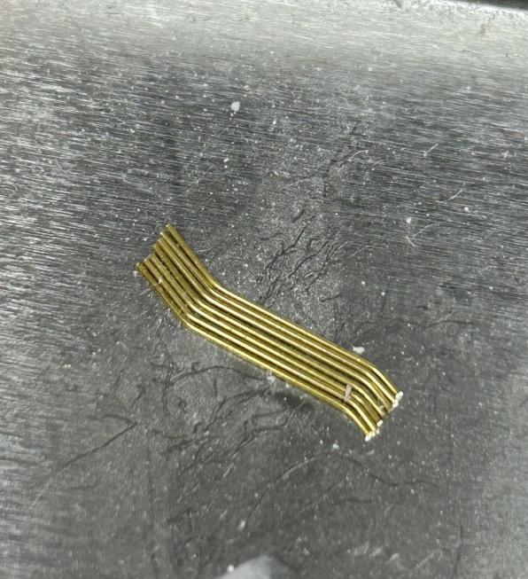

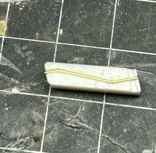

                  Still waiting for the rivet decals from the US.....on their way. So I worked a bit on the remaining details. The kit's railing is far too clumsy. 1 mm diameter struts would translate to 72 mm columns in real life. Not scale at all. So I copied the method shown on a similar kit on youtube (https://youtu.be/hdhhQDrhcuY?si=iQVUHjmJ3rNOKOfy). I use 0,4 mm outer diameter brass tube for the railing struts. There are not all straight, but there ist a set of curved and angled ones. To get theses right, I designed a master pattern and 3D-printed it. This pattern was then used to bend the struts....worked astonishingly well!

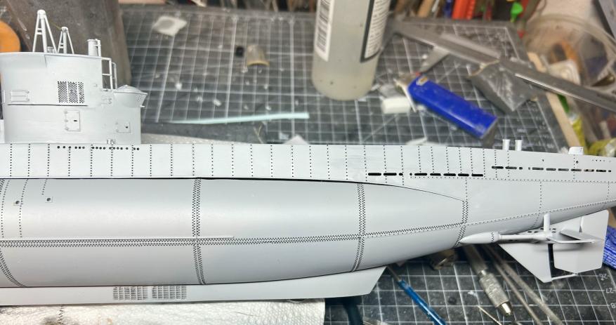

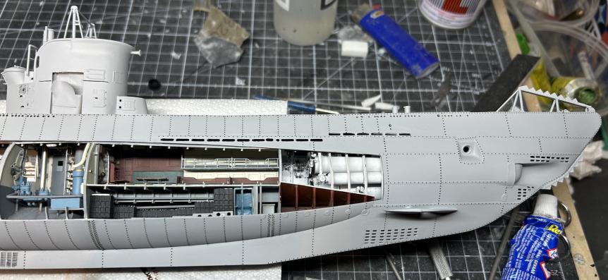

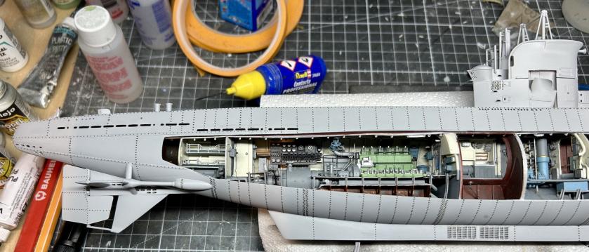

                    Finally got more Archer Transfer rivet decals from the US via snail mail. So I finished the starboard side of the Vesikko and sealed the rivets under a thin layer of clear coat. Port st next....

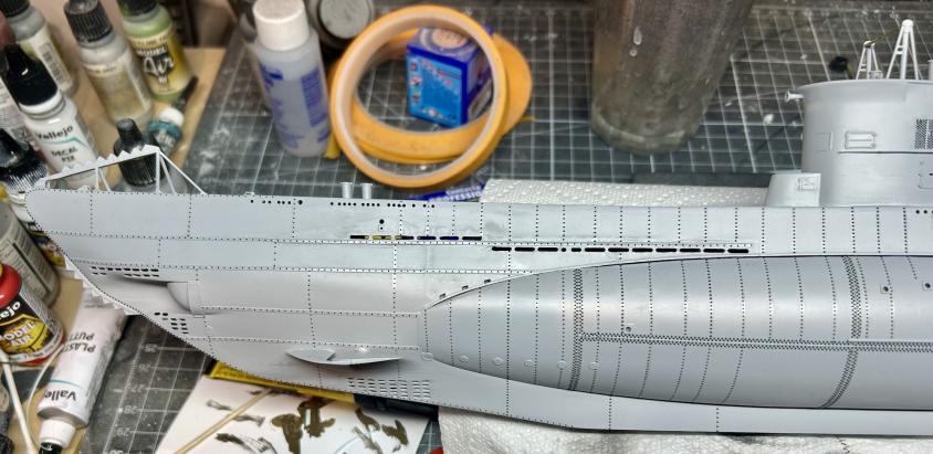

                          Rivets, rivets, and more rivets….and not done yet. But things are coming together quite nicely on my 1/72 scale Type II submarine Vesikko.

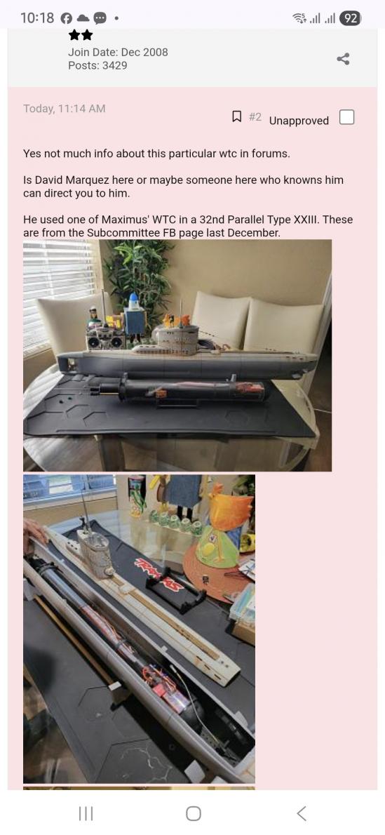

                            I have a question: I posted an update and after saving the post appeared red and it was flagged "not approved". This morning the post is gone.....what did I do wrong?
                              #104

                                Been hit with spammers. If you post a certain number of times or too many pics or anything else the forum software doesn't like, you'll get flagged. I'll get to approving them. Just live with it.
                                It's that or we deal with tons of spam on the site.
