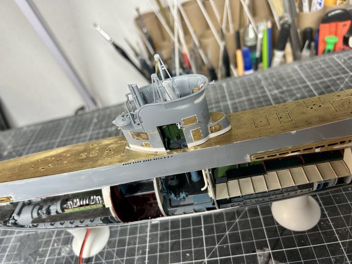

                The main parts of the boat finally are coming together. I glued the conning tower into place, and voila, looks like a submarine. You may notice the white line at the base of the conning tower. Well, that's a deviation from being in scale. Under the tower the boat is single hull. Including the interior for me means, that I have to put a pressure hull inside the outer hull of the kit and on top of it the pressure cylinder of the conning tower. So I have about 1mm outer hull 2 x 0,5 mm inner hull and then about 0,5 mm floor thickness of the pressure cylinder. In total that put me about 2,5 mm too high which I had to compensate by adding styrene sheet material....A bit annoying, but it won't be visible after painting

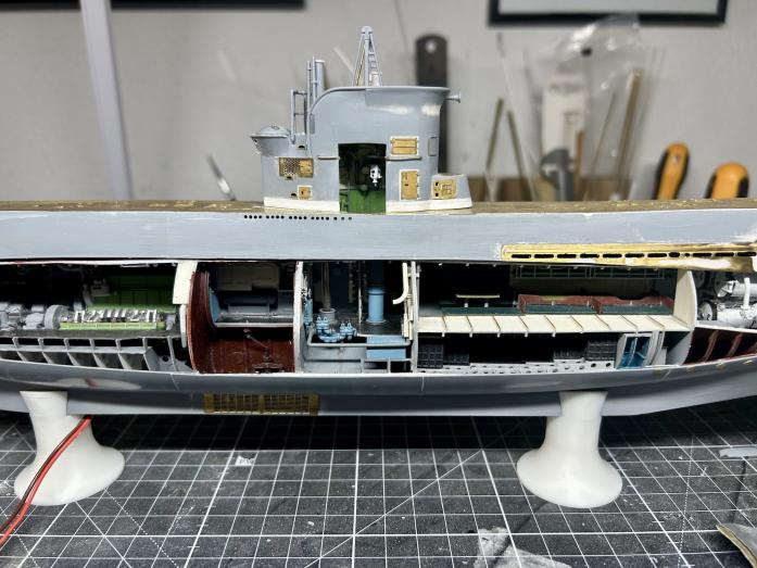

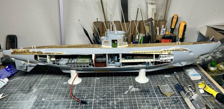

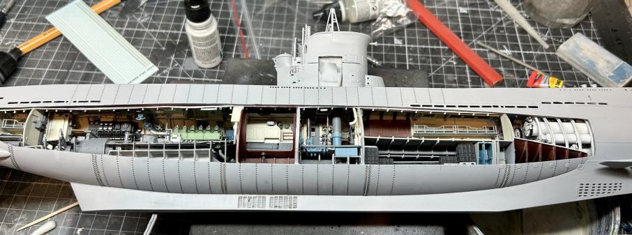

                            Rivets, rivets, and even more rivets. Vesikko was not welded but riveted together. The kit lacks these details, so I decided to add them myself using Archer Fine Transfers surface details. Quickly ran out of my remaining sheets, so I ordered some more. I hope they still exist and the website I ordered from is no scam.

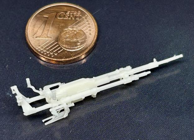

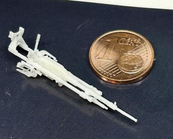

                              3D-printing oof the Madsen deck gun...took some tries, as in 1/72 the thing is tiny, but so far so good.
