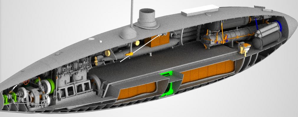

              And the control linkages in the ful CAD-model:

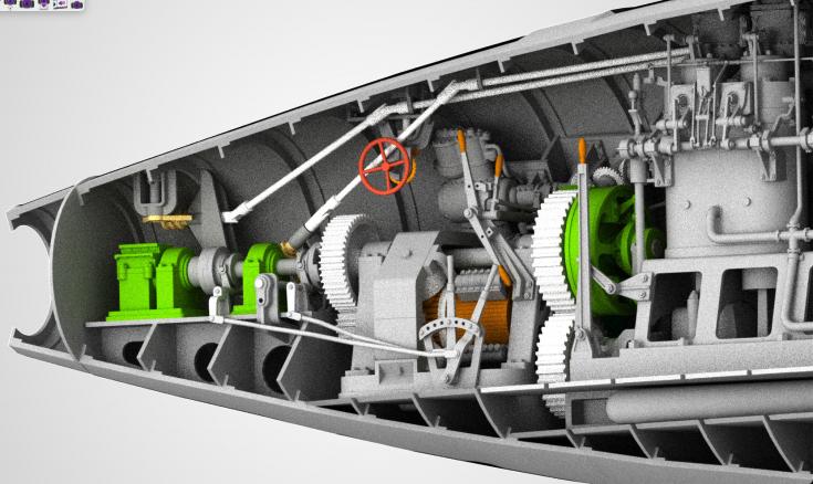

                More bits and pieces....I added the drive for the exhaust box (the one with the red wheel). All the exhaust lines of the four cylinder Otto motor ran into a single box, from which the exhaust gases were expelled. The box had a water-tight lid, that could be opened and closed, an early variant of a modern exhaust main valve. The actuation of the lid was driven by a push rod that was moved by a thread rod driven by a bevel gear that was actuated by the red hand wheel.

                  Were there any kind of covers around the gears or were they open to the inner space? I presume one could easily get ones fi gers or clothing cought...
                  A greatly detailed model, Dr.!
                  • DrSchmidt
                    • Apr 2014
                    • 1393
                    #99
                    From the drawings and photos I know, they were not covered. Sub sailor meat grinder......

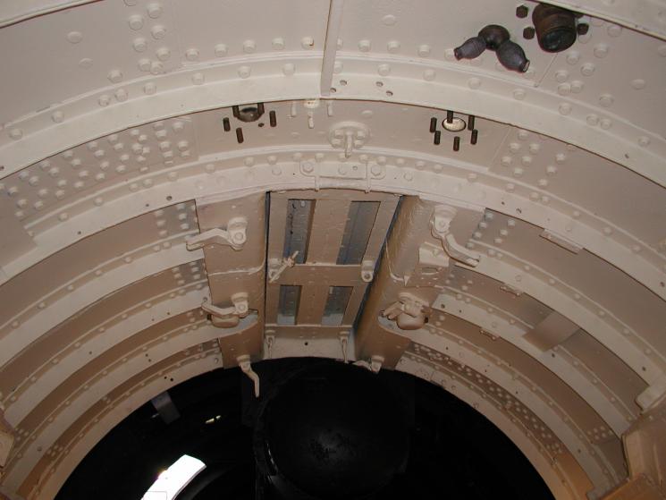

                      More detail work, This time the torpedo loading hatch. A rather large rectangular cut through the hull and 3 frames. I think that makes for an excellent structural weak pint in the hull, The hatch was closed by a rectangular plug, that was held down with a set of bolts and nuts.

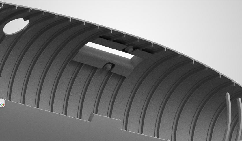

                          And integrated into the CAD model...

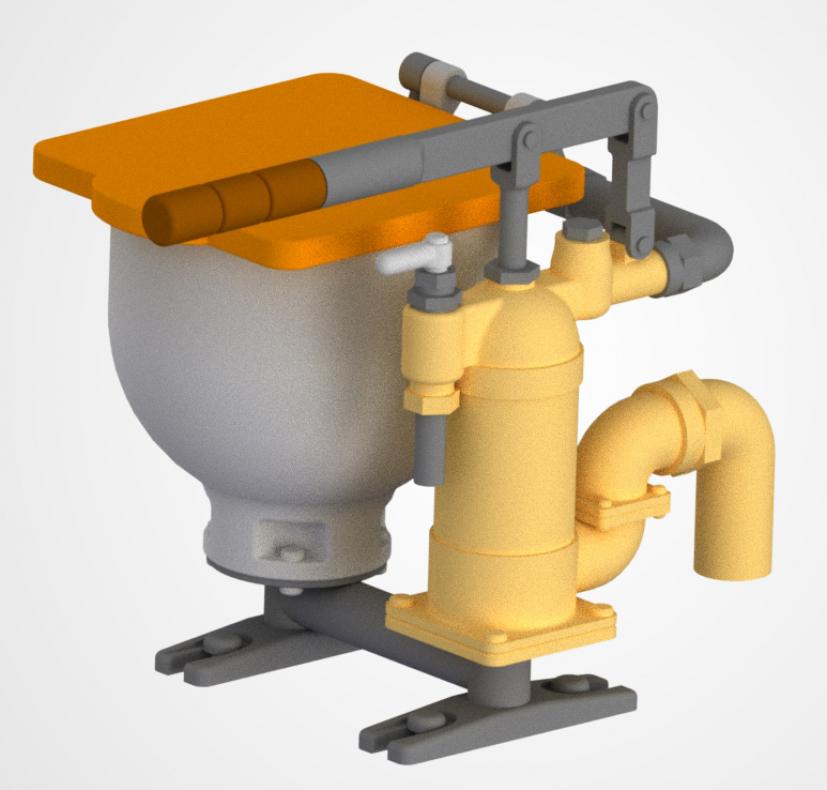

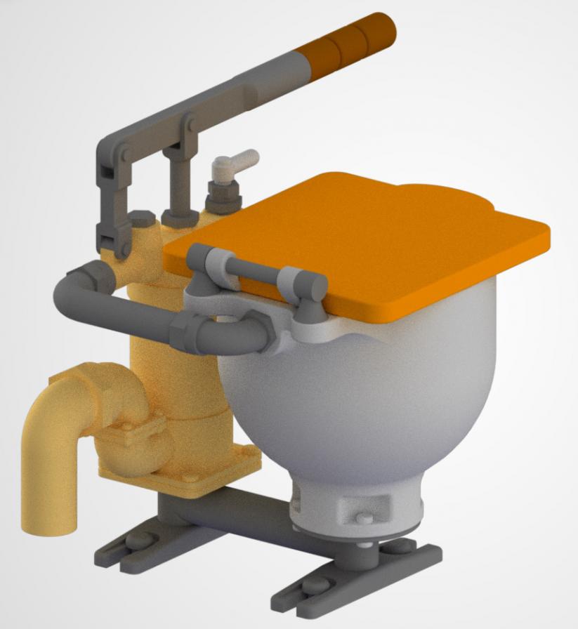

                            And of course Holladn hat a toilet....not a very private one:

                              #104
                              I like that pump!
                              seems the design didnt change much till ww2
                              • DrSchmidt
                                • Apr 2014
                                • 1393
                                #105
                                As I had no detailed pictures or drawings, I took a design from 1920, hoping that it mateches what had been installed on the Holland.
