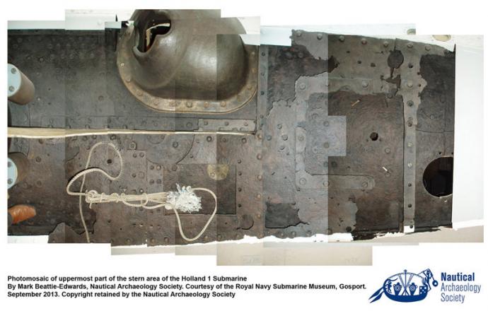

    I beleive the periscopes on the four boats were all slightly different, certainly differences between Holland 1 and Holland 5, the latter I believe got the first one.
    Here's an image of Holland 1 periscope base.

      That's an awesome foto which would have saved me quite some time. So I might redo the cowling again....that's my current version:

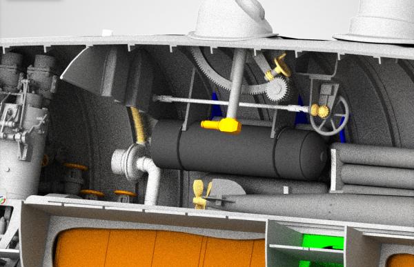

                  Some mor details about the interior of the periscope installations....

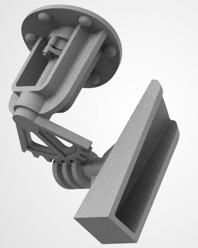

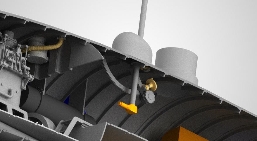

                    I added the support structure for the periscope actuator and in the back the hand wheel to drive the rear dive planes....

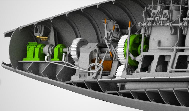

                      #85
                      After the depth control I'm working on the rudder controls. The Holland could bee steered from three positions: deck, conning tower and a seated position under the periscope. Every position had it' own steering wheel, and all those wheels were connected via a central gear box to the drive train to the stern....the central position under the conning tower with the gear box is almost done.

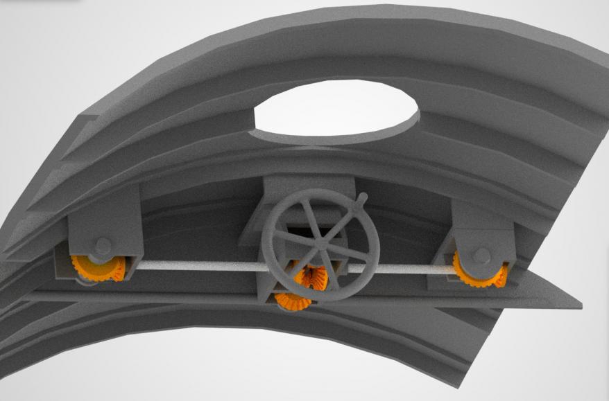

                          #87
                          Thanks!!!

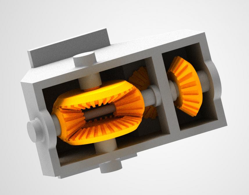

                          Progress on the rudder controls: on the left of the central wheel is the gear that connects the controls to the drive shaft that runs all the way back to the stern where the rotation is translated into rudder tilt.

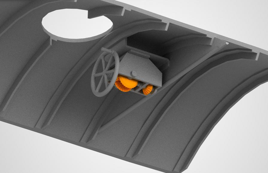

                            #88
                            And with the right gear, that connected the steering position for suberged cruise with th rest of the rudder actuators. Not really fly by wire...

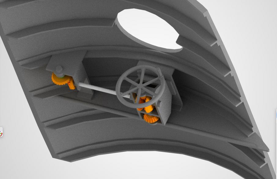

                              #89

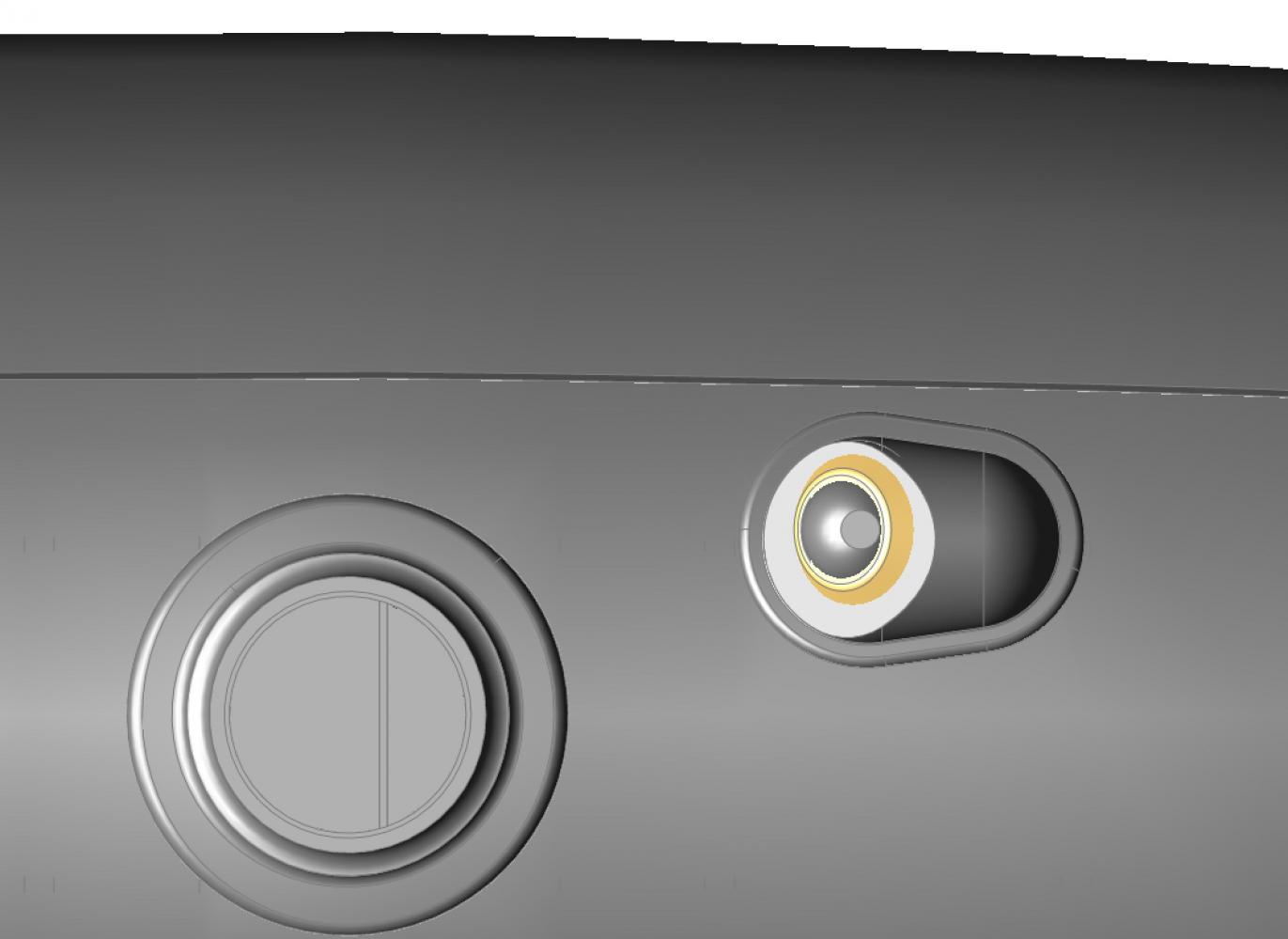

                              Still working on the drives for the control planes. I finished the outboard feedthrough for the rudder. Outboards there was a stuffing box surrounded by a frame holding the bearing for the worm gear driven rudder lever axis. The worm gear was positioned by a metal box, that was bolted to one of the circular frames.
