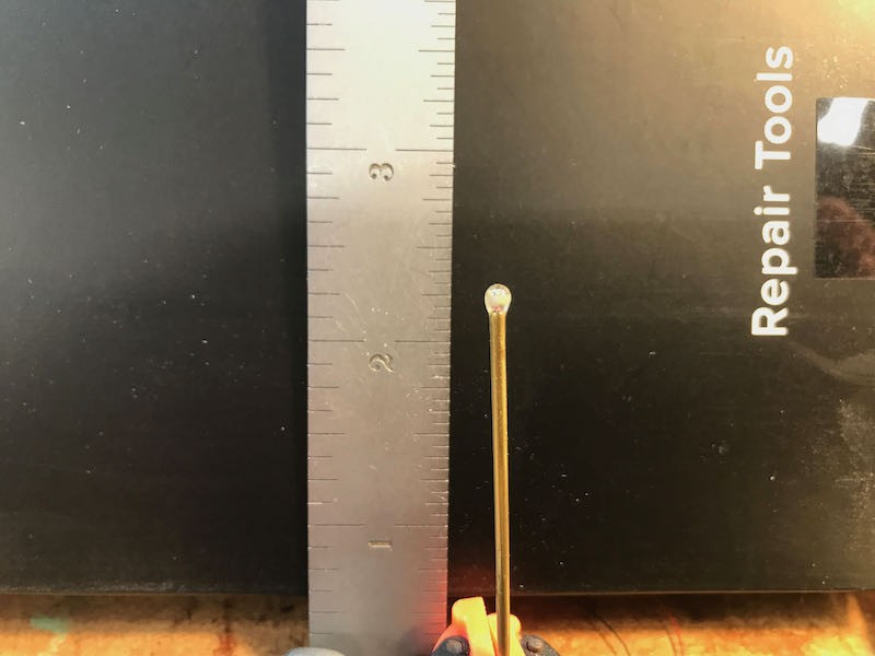

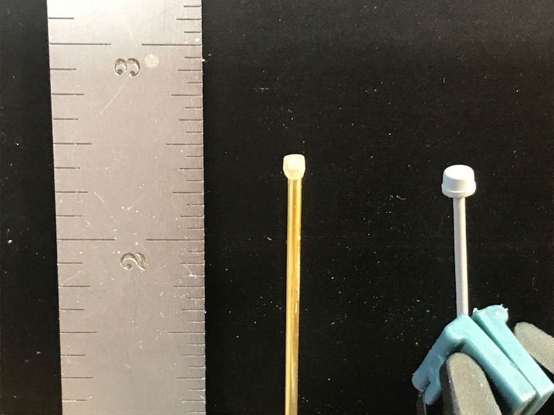

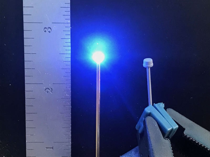

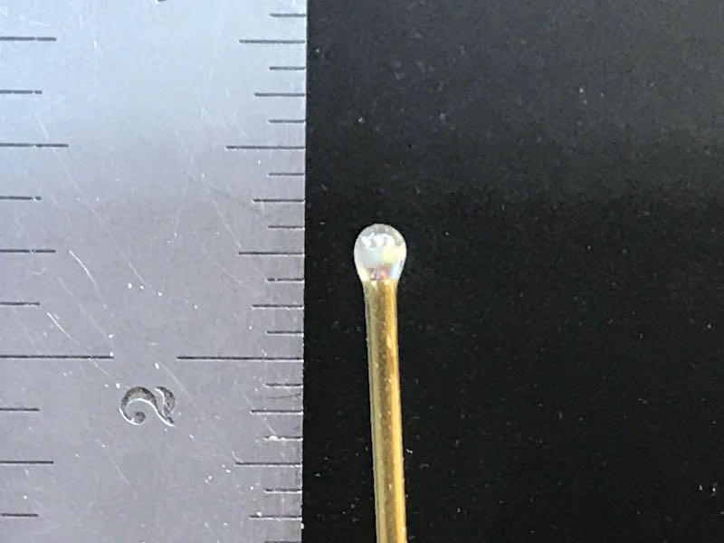

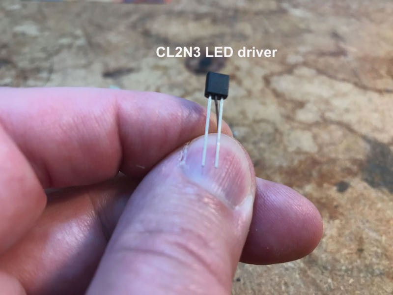

                            I was not able to find 360 degree LED's so i went with 0402 LED's from Amazon. With a caliper they measure around 0.060, so they are very very small. They only illuminate 120 degrees like a few of you mentioned. After testing the LED's, I put some CA on the backside to seal the connections. I then carefully slid two of them back to back into a 1/16" brass tube and glued them together. I then used epoxy and dipped the LED's in upside down and let the epoxy dry. I did this three times to build up the epoxy. You can see how crystal clear the epoxy is. I then wet sanded the side down with 400 and 2000 grit paper. I filed the top flat and wet sanded with 2000 grit. The sanding gave a a frosted effect. Each LED will get a CL2N3 driver. The input voltage to these can be from 5 to 90 volts and the output will always be 20ma no matter what the input voltage is. With resistors, if the voltage drops, the current drops and the LED will get dimmer. So as long as the LED spec is 20ma, the CL2N3 will always supply 20ma. You can see what I made in comparison to the faux beacon that came with the Skipjack kit. With two of them back to back, I get the effect I was looking for. Now I just need to install it and get the Bluno Beetle setup.
