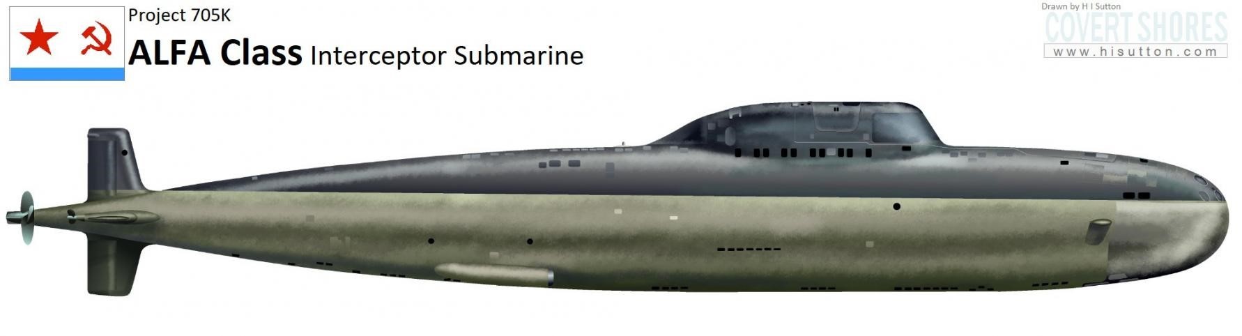

    Originally posted by Ken_NJ
    Back to practicing on paper, by accident I got this streaking to look like streaking and somewhat like what David did on this Russian sub, although his is more washed out. Will have to give it an over spray to see how it looks that way.
    But do I want the above to be how the weathering will be on the Skipjack? Probably not.
    And I still have to work at getting something reasonable close to this.
    And this.
    Now you're cook'n!
    You big goofball, you just won't quit, will you!?...
    Soon you'll be teaching me.
    (On knees screaming to the heaven's: "I've Created A Monster!!!")

    replied
    And this.
