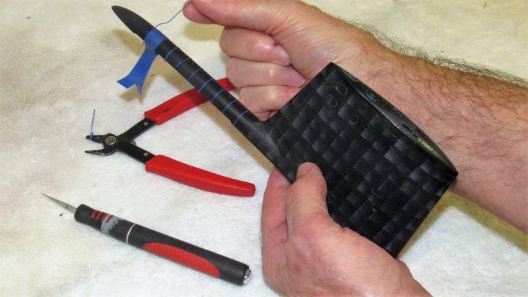

            Got my Pasche H airbrush. I painted a sheet of poster board black with a clear coat. Now it's time to practice oil canning as per all of the info that David posted.
            A few posts on David's technique's
            https://forum.rc-sub.com/forum/tips-...arkings-part-2
            https://forum.rc-sub.com/forum/gener...457#post156457
            Click image for larger version  Name:	IMG_3945.jpeg Views:	0 Size:	53.3 KB ID:	157865
            I can count the number of vertical and horizontal squares he did on this Skipjack sail to determine the widths and heights of the maskings. My sail is black so I'll be mixing up a light gray acrylic mix to experiment with on the black poster board sheet. Lets see how this goes! How hard can this be?

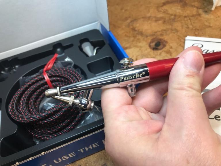

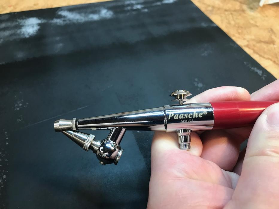

                        Having a problem with the Pasche airbrush, no paint coming out. I have the number 3 tip in and moved it all the way in and out. The paint is thinned to water consistency. Adjusted the air from 20 to 40 pounds. I feel air coming out the tip, no line leaks. Tried the cup and 1 oz container. Still no paint coming out. Any ideas? For now will try other airbrushes while I iron out these issues with the Pasche. Any ideas guys?
                        • Bob Gato
                          • 898
                          #42
                          Try it without paint.. maybe straight thinners. If it sprays with straight thinners then it's probably not the airbrush more like the paint is not thin enough or the air pressure is not high enough ...I see in an earlier post that you've used it -good possibility that it's just clogged with dried paint. Take it completely apart and check all the internals especially inside the cone and the feed orifice.. you should be able to blow through it... You said air is coming out of the tip so that's not a problem with the needle. I used to shoot catalyzed polyurethane aluma grip.. no matter how I blew it out I always would blow it out with mek after I'm done but paint would still build up and eventually I had to disassemble and soak it in paint stripper.. you're not going to have that problem but I do think you're going to need to disassemble it and clean all the paint out of it with a solvent.

                            Bob, this is the first time using this Pasche airbrush. Earlier posts were with other types. Below is what I'm having a problem with. No long needle and innards to clean up, just the feed from the paint container.
                            I have it cleaned up from my first shot of it. It does spray thinner OK. And I had the nozzle off, after I put it back together it sprayed thinner. I'll retry paint another day.

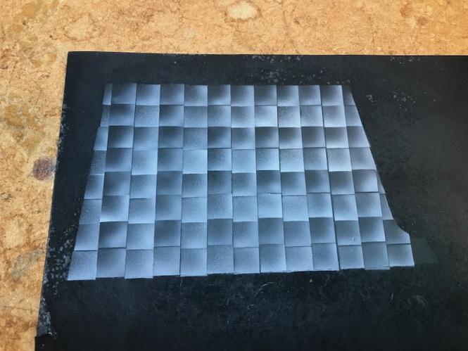

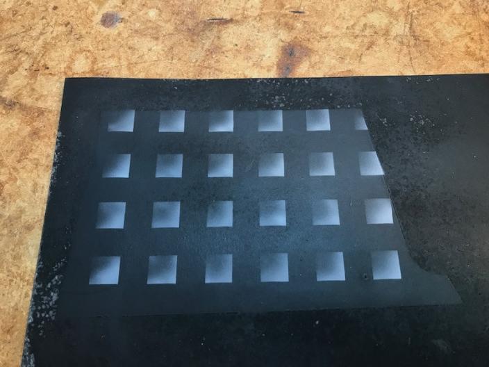

                              My first attempt at practicing on poster board. Is the color to light? The paint is value 3 on the gray scale chart. Each square is 15/32" x 15/32".
                              Some of the problems I see. In the last pic I have the registration off and I applied the paint too heavy and inconsistently between squares. I was trying to apply with the far corner the heaviest and the two opposite corners lighter. Kinda like you see snow accumulating on windows.
                              David? What do you think?

                                • 3768
                                #45
                                Ken,
                                Some of the squares are a bit too heavy, but you are practicing so no biggie. You could remark and do a little black or try spraying a very thinned down almost black wash over the top of it and see if it gives you the toned down look you want. Also when you do your clear coat it will also darken a bit. In some ways, you have added pre-shading and you may be surprised how it will look when you are done.
