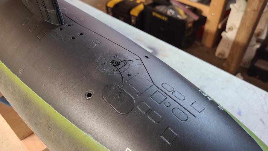

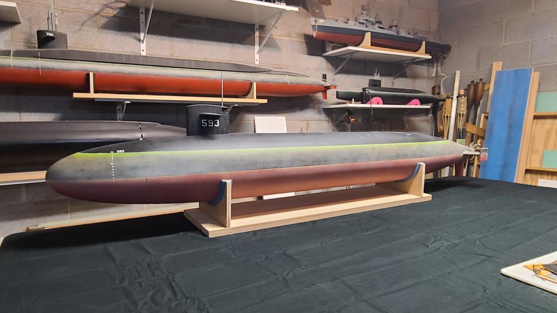

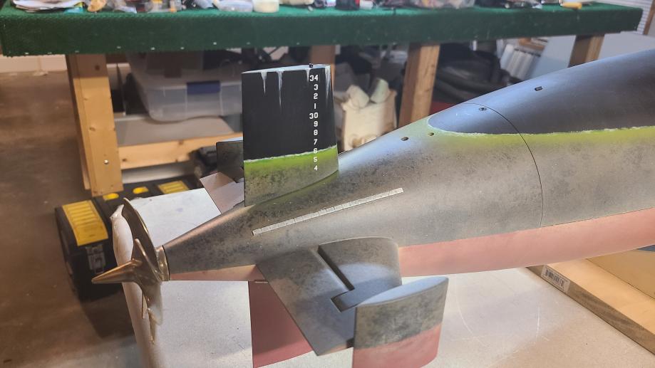

                This has been such a helpful thread. I tried most of the techniques outlined on my Thresher and I really like how it turned out. Thanks again David!

                  Blueback rudder.
                    Remarkable workmanship! I know I have made this statement to you many times, but your skills are so appreciated, and the fact that you are so willing to share these wonderful skills, with explanations, and photos with us is fantastic!! Thank you very much David!!
