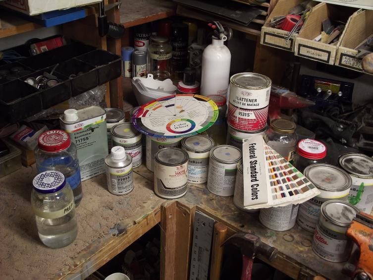

    The decanted rattle-can paint has four magic ingredients: the pigment, a resin binder, thinner/solvent, and a propellant.
    You need to let the propellant boil off for a day, at room temperature, in your container -- which, during the propellant boil-off, must be sealed with a very loose lid or you'll have a paint explosion (likely in the wee hours of the night when everyone's asleep -- "hey, honey, look at all the pretty colors on the ceiling... and the walls... on the cat... and the floor... and in my hair!").
    Click image for larger version  Name:	IMG_0094 (2).JPG Views:	0 Size:	44.6 KB ID:	152837
    As rattle-can paint is formulated to squirt out the small nozzle atop the rattle-can, the paint requires no further thinning.
    As the thinner/solvent is very volatile it will eventually go away unless your container is tightly sealed. Shelf-life is a year or two.

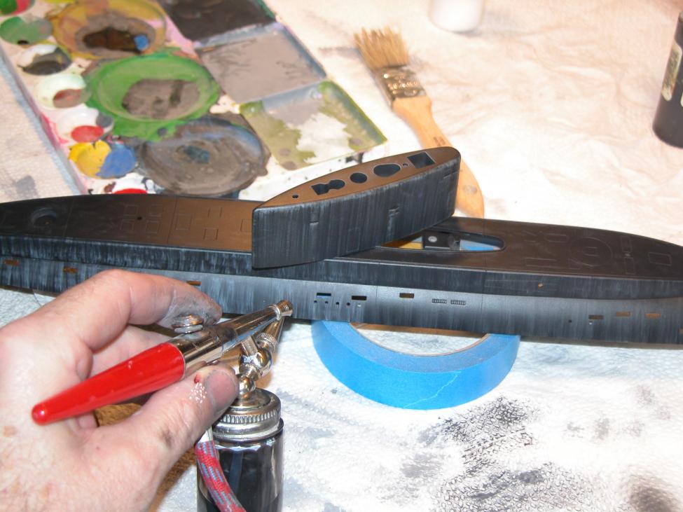

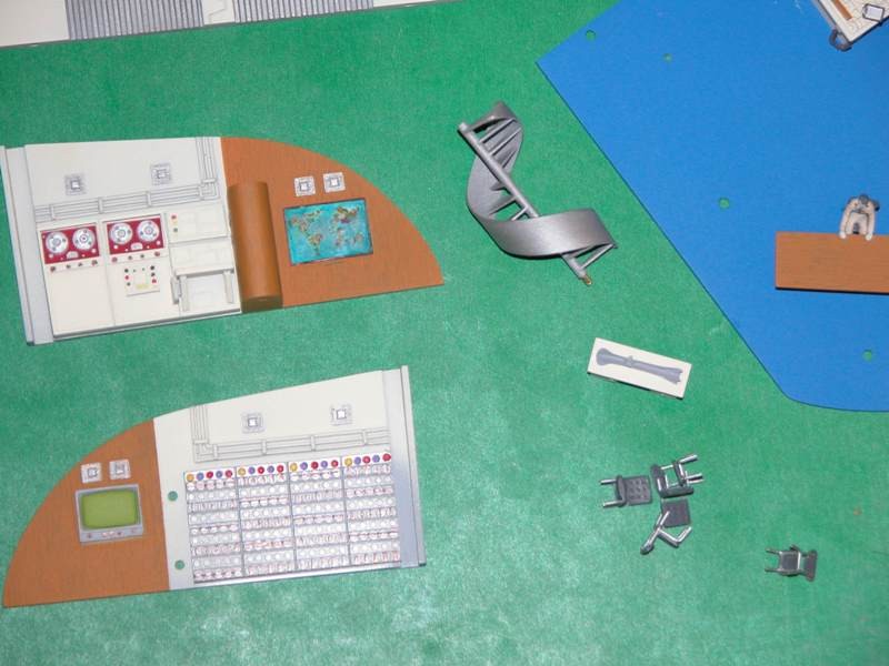

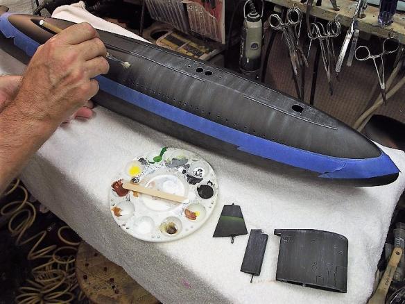

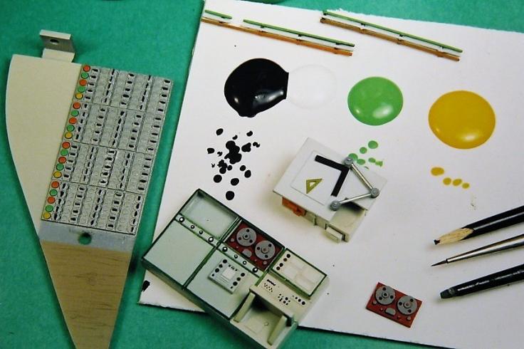

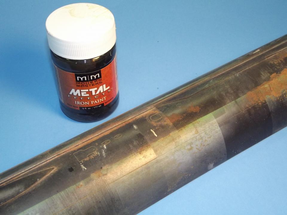

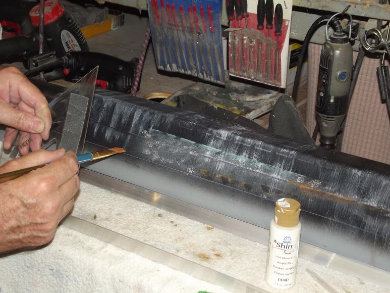

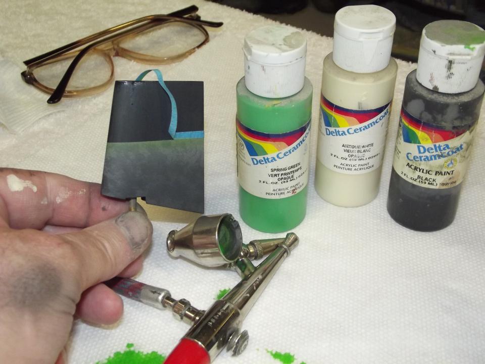

                  God! Finally I'm dealing with a real talent in search of new (and what he will discover to be a wonderous technique) way of doing things. OK. I now extract my nose from your butt.
                  Yes, the fun stuff is done with air-dry, water-soluble acrylic paint. Keep in mind once dry it is no longer water-soluble, so if you make a boo-boo you can abrade it off without damaging the base color -- that's why the clear coat between the two, a sort of shield that permits you the opportunity to scrub away boo-boos without having to re-paint the entire ****ing model again. The work goes vary quickly if you accelerate drying with careful use of a heat-gun.
                  Click image for larger version  Name:	DSCN0157.JPG Views:	0 Size:	77.7 KB ID:	152879

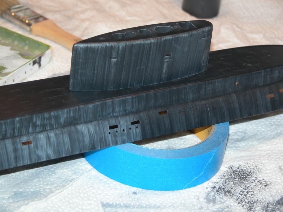

                  Yes, the streaking is Acrylic too (sigh).
                  Click image for larger version  Name:	DSCF0470.JPG Views:	0 Size:	50.6 KB ID:	152874Click image for larger version  Name:	DSCN0035.JPG Views:	0 Size:	77.3 KB ID:	152878
                  The streaking will be way too exaggerated. You tone it down with a misting of the base color. Half of this streaked model is in the raw, and the other half is getting a mist coating of the base color to make the display more presentable.
                  Click image for larger version  Name:	DSCN0033.JPG Views:	0 Size:	87.9 KB ID:	152877
                  Flat clear-coat dries quicker. And is the absolute last coat after all the weathering and markings are in order. But, between operations it matters little if the clear protective coat (shield) is flat or gloss.
                  And use an automotive quality clear-coat system for that last coat. It gives you the ability to control the sheen and cures to a very tough surface not as easily damaged by handling, and collisions as the 'hobby' and 'box-store' paints.

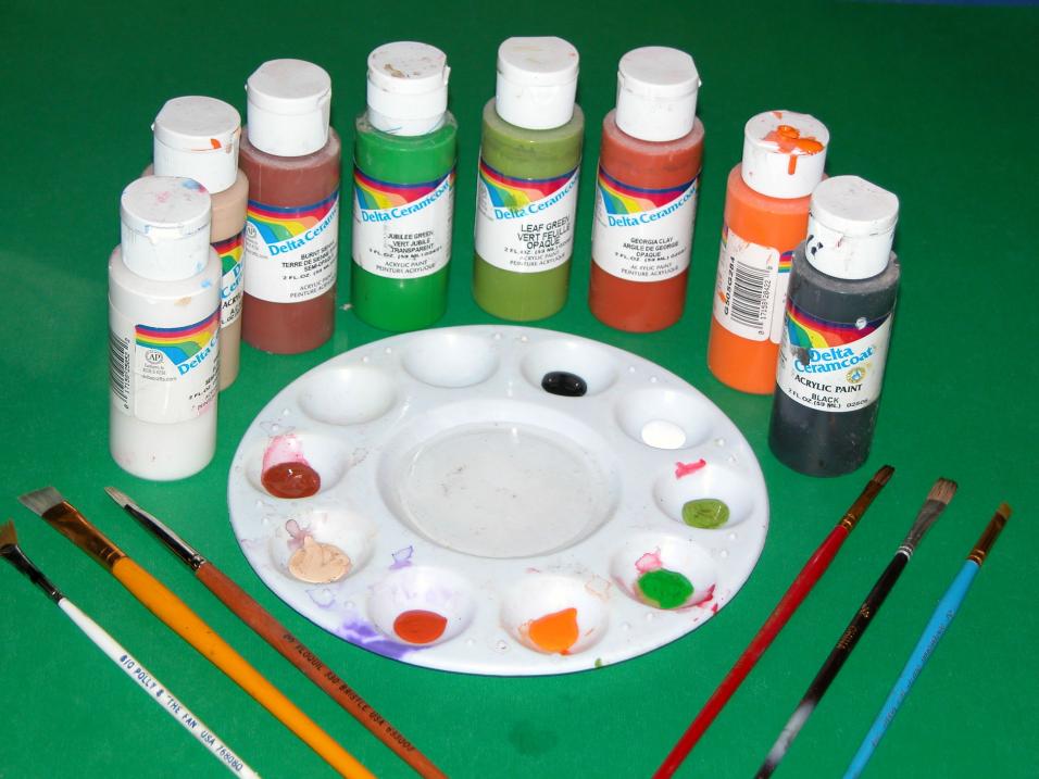

                    Does the acrylic brand matter much? You're using Delta Ceramcoat. And they have all sorts of choices, pastel, brights, flashy etc. I probably need only basic colors?
                    https://www.amazon.com/Delta-Creativ.../dp/B01MFGW2ON
                    I know acrylic over enamel is fine. The mist coat is enamel. Am I screwed with mist coat enamel over acrylic? (Maybe here comes the yelling?) Maybe as long as the acrylic is cured a few days enamel mist is OK?
                      • 13997
                      Brand difference. None that I've been able to qualify.

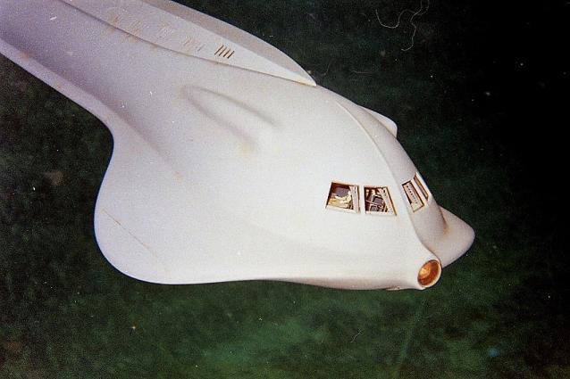

                      Click image for larger version  Name:	DSCN0019.JPG Views:	0 Size:	51.7 KB ID:	152885
                      These items were spray and hand-painted with Walmart acrylics. These 'observation compartment' inserts have weathered both lake and swimming pool water with no ill effects.
                      Click image for larger version  Name:	DSCN0018.JPG Views:	0 Size:	53.0 KB ID:	152884Click image for larger version  Name:	PICT0054.JPG Views:	0 Size:	83.3 KB ID:	152887Click image for larger version  Name:	DSCN0079 (2).JPG Views:	0 Size:	85.5 KB ID:	152888Click image for larger version  Name:	DSCN0084.JPG Views:	0 Size:	93.1 KB ID:	152889Click image for larger version  Name:	PICT0130.JPG Views:	0 Size:	36.9 KB ID:	152890Click image for larger version  Name:	PICT0121.JPG Views:	0 Size:	32.4 KB ID:	152891

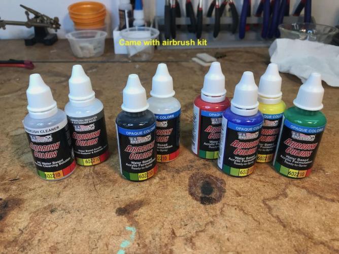

                        Sharing my experience so far.
                        I bought some acrylic paints from the craft store. They were only 79 cents each. These paints will need to be thinned before spraying. I also have some the same colors that came with the airbrush kit which are ready to use. I also bought airbrush cleaner and reducer from Amazon. So now I'm ready to go. I added some paint to a gravity feed dual action airbrush and sprayed some on plain paper and cardboard. I felt pretty good about it. So I started mixing black and white for gray on the masts with the store paints and added reducer to thin it out. The base colors on those masts came out good for me. For the mottle I mixed up a darker gray and splotched on the dots and masked and sprayed other portions. I then placed some of the dark gray on a sheet and mixed some white to lighten it up for a lighter shade for the mottle effect. Maybe the base gray is a little on the dark side? The the snorkel I spray Testor's Aluminum color which is enamel. The periscope's were sprayed with Testor's enamel silver. With the enamel I cleaned the airbrush with regular paint thinner. With the acrylics I used the Amazon airbrush cleaner. I have a little touch up work to do.
                        Now that I got started using the airbrush, I can get use to this! Opening up a whole new way of painting!

                          'Air-brush Reducer' Waste of money. Water!
                          KISS.
                          • Ken_NJ
                            • Sep 2014
                            • 1006
                            Right. Acrylic is water based. Thanks.
                            There are all kinds of videos on YouTube for thinning with all kinds of liquids. Water makes sense!
