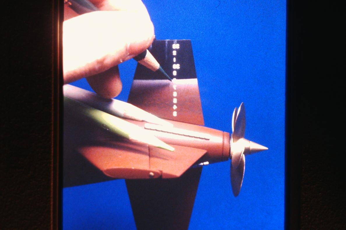

      Ken,
      You could always do this!! :-)))
Name:	ALFA BOAT FINISHE !.jpg
ID:	160804Click image for larger version
Name:	ALFA BOAT FINISHED 2.jpg
      OH MAN! Am I in for it now!! Forgive me David, the devil made me do it!!! :-))

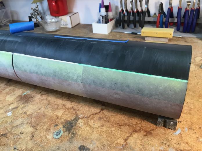

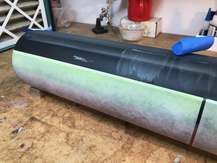

              Testing with artist oil paint and oil crayons
              Trying the oil crayon I drew a straight line on construction paper. It seems that it goes on like chalk, grainy. Tried it on the test article, it did the same. Something to get use to I guess.
              I then placed two pieces of painters tape on the paper about 1/8 inch apart, simulating the width of the scum line. I applied the white oil paint from a tube with a brush. It can be applied in different densities so it does not look like one solid line. Checked it the next day after about 18 hours. I can smudge it with my finger. The oil paint needs longer to dry. I applied a thinner coat (the squarish section in the lower left corner) and applied heat with a hair dryer. That dried well. Also applied heat to the lines I previously painted. The heat worked there as well. So I learned if using artist oil paint from a tube, apply in thin layers, and use heat to help it dry faster. I read online there are additives that can be added to facilitate it drying faster, not going there.
              On my test article PVC hull I will try the tube oil paint in multiple thin layers and apply heat and wait a day and maybe more heat. Multiple layers will have some spots more solid looking and other spots a lighter look, that multiple density look. Then smudge some green oil crayon to give it a worn look. All in theory. Hopefully my theory works. Some sort of a plan.

                  Thanks David. While I am waiting for the scum line to dry on the test article, had to finish the oil canning on the exhaust housing. The oil canning that David says he could not find any existence of on page 52 of his todays work thread.
                  So here is my oil canning. It will be covered by a misting of the base color eventually.
                  This is sitting in front of a heater trying to get dry.

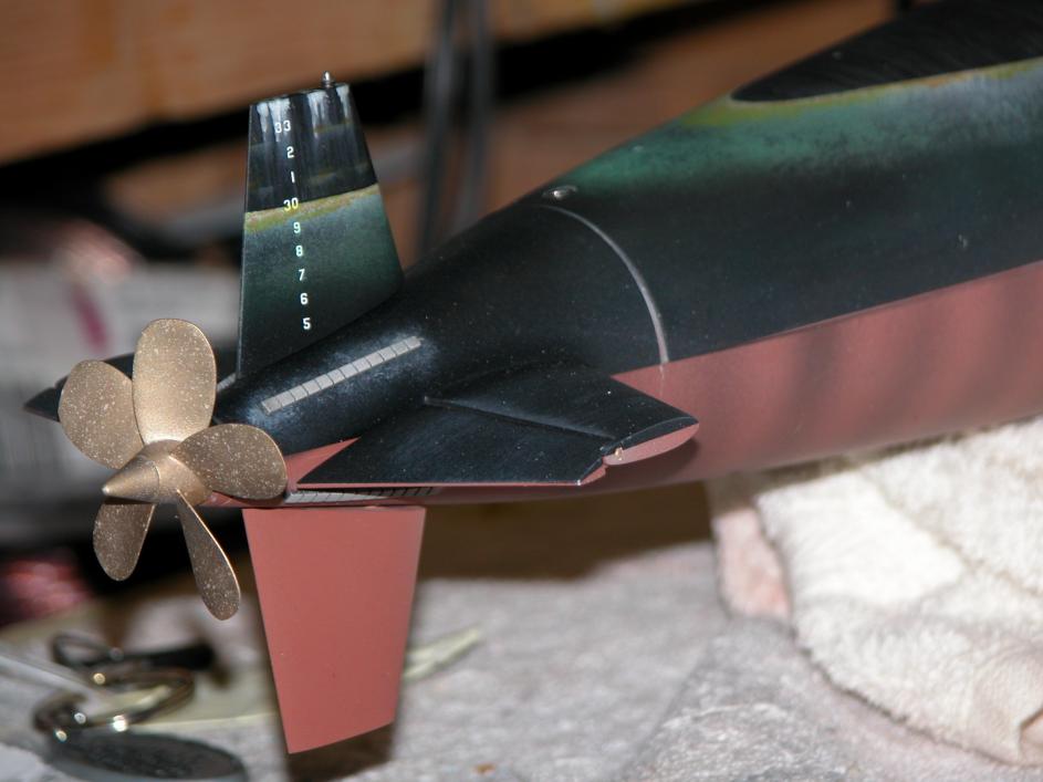

                          What he said! But, the draft marks shoulda gone on first, as the weathering would be over top of them, too. On the hull, the bottom draft mark is at the main axis of the boat. On the rudder the bottom number is near the bottom of the rudder blade.
                          • Ken_NJ
                            • Sep 2014
                            • 1006

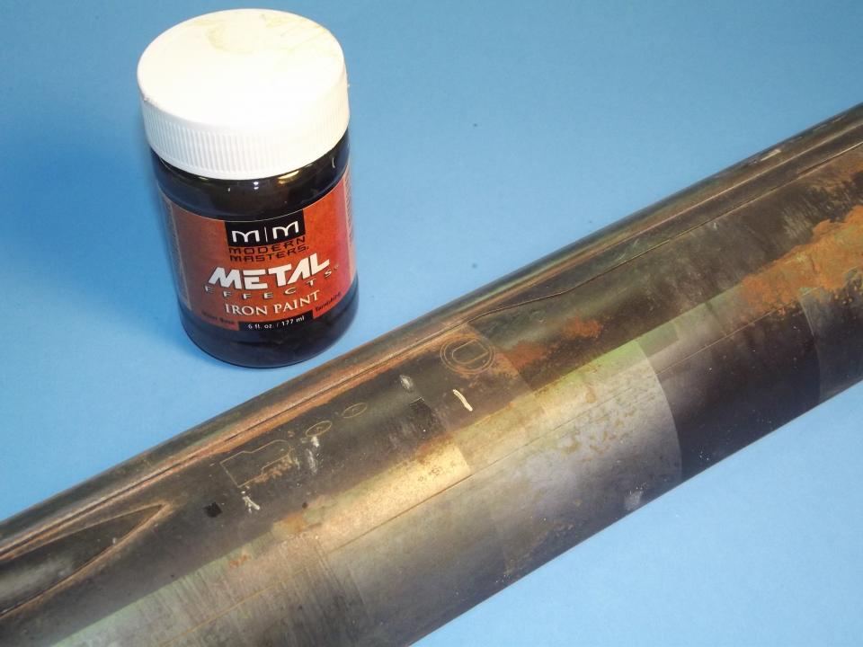

                            #163

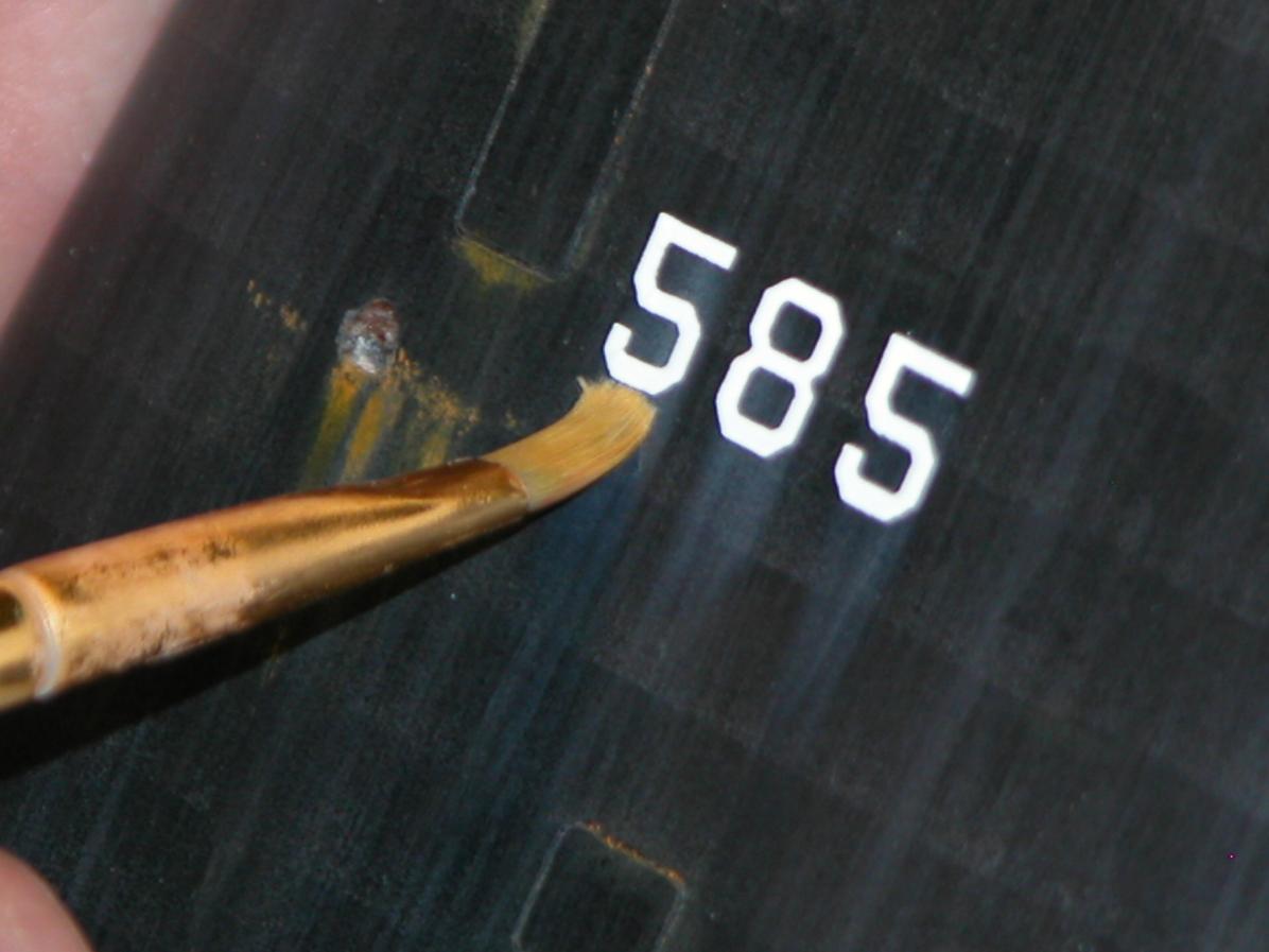

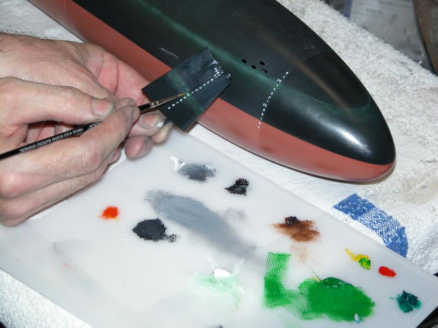

                            I realized the markings should have gone on before the weathering. Oops. I was so fixated on my intricate weathering, I missed that.
                            David, what do you use for rust? A mixture of some sort?
                              • 13998
                              #164
                              No. You're good -- the markings go on after the weathering. Use well thinned out acrylics to over-coat the markings to reflect the degree and color of the weathering that surrounds them.
                              Burnt-Umber, oil paint, or a slurry of iron filings suspended in a binder, brushed on, and when dry hit with a mild acid.
