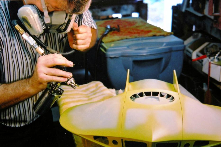

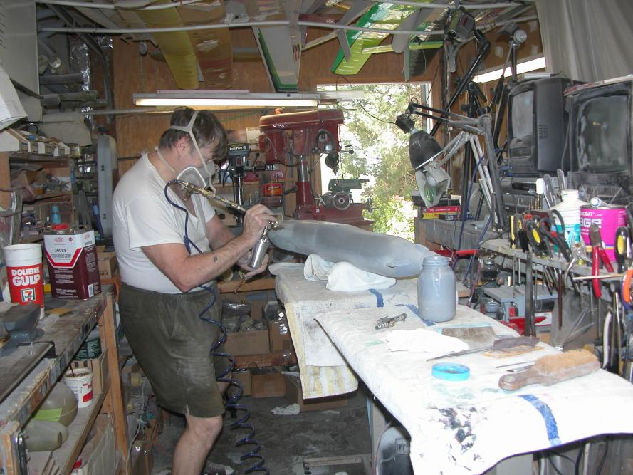

                  As posted above I am diving into Airbrushing. Since my shop is in my garage and in the winter I rather not open the garage door and have no windows, should I invest in a Painting Booth? Any suggestions on ventilation needs. I will wear a good respirator mask, and I am not concerned with overspray.

                    Don't bother, unless you're doing a mass spray job that actually fogs the air (beware open flames like furnaces, and gas type water-heaters). Use a charcoal mask and bail to the house after cracking some windows. Regroup, and do it again till the job is done.
