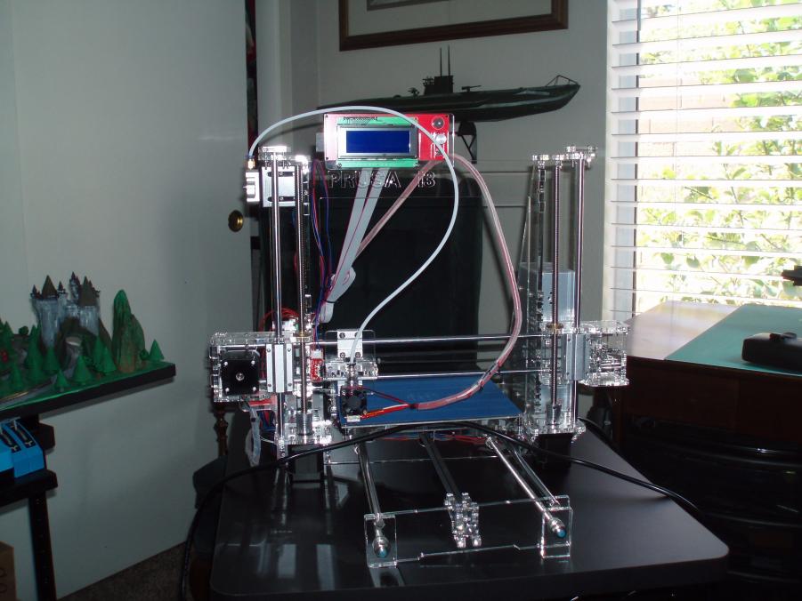

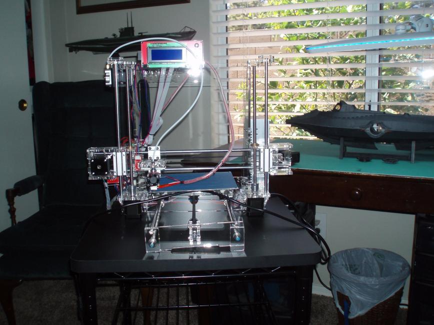

        As you can see, the Nautilus is on my work bench and ready for some serious work!! But along the way I wanted to share with you my precious (Sunhokey) Pursa i3 printer is back with me again! I built this printer from a kit 8 years ago! Perhaps some of you that are into 3D printing remember this kit from the past! Just had to share with you what a beauty she is! OK! Enough! On to the Nautilus build!
        I am going full out on this build in every respect! And with some needed help along the way, it will be a full diving sub with some lighting and special effects.

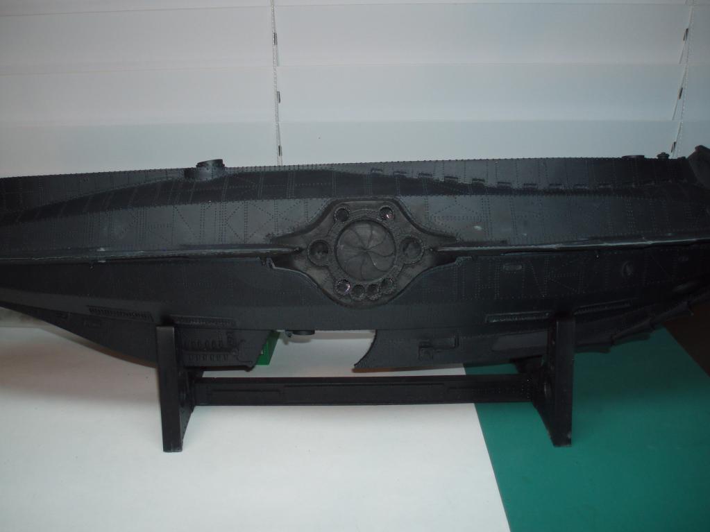

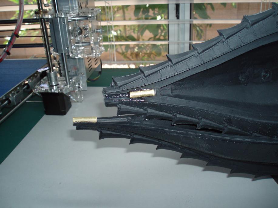

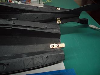

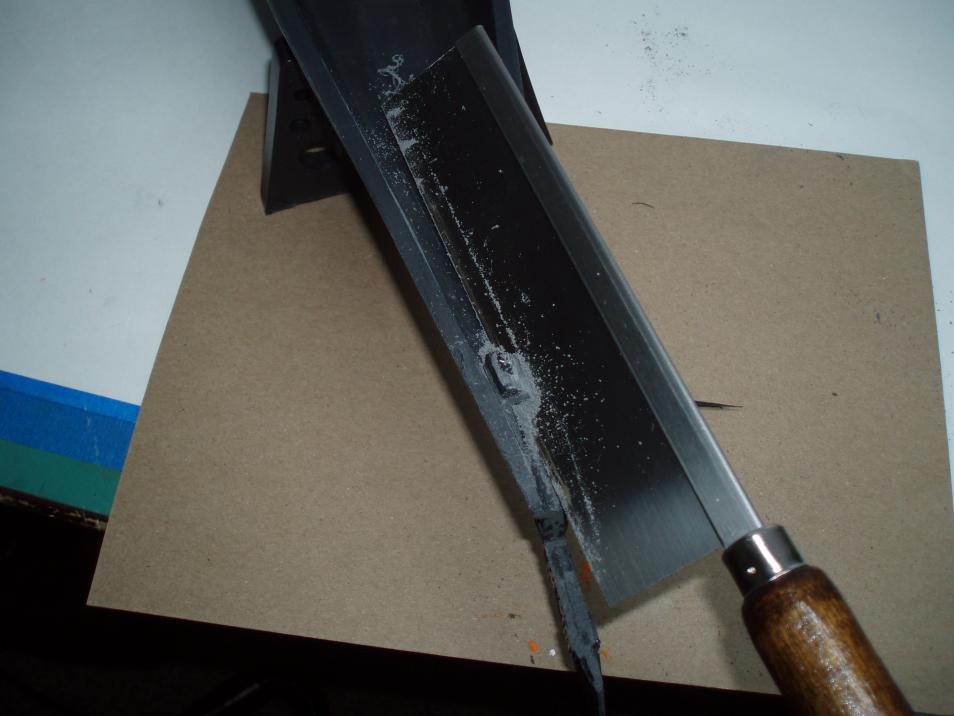

          Now that my HL Hunley is complete, I can now my resume the Disney Nautilus build! I Have the stern cut off and the mounting system complted!
          Click image for larger version  Name:	P4130001.jpg Views:	0 Size:	55.9 KB ID:	148993Click image for larger version  Name:	P4130012.jpg Views:	0 Size:	60.8 KB ID:	148994Click image for larger version  Name:	P4130003.jpg Views:	0 Size:	57.3 KB ID:	148998

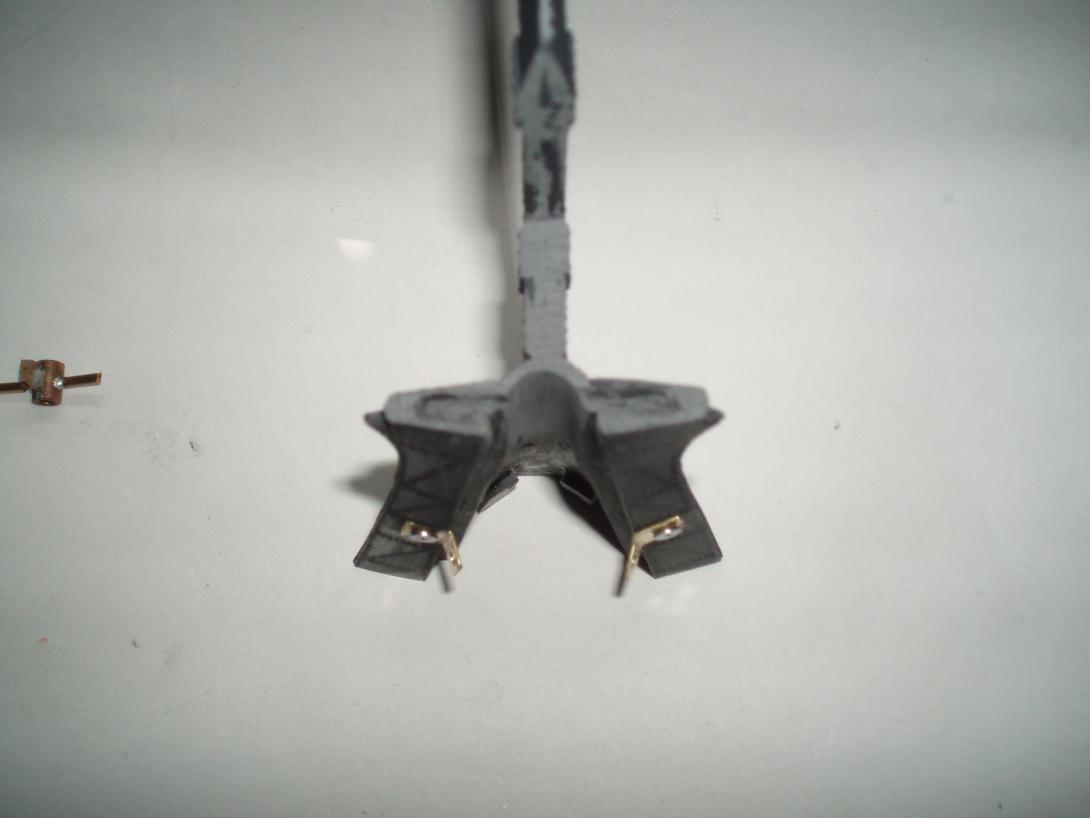

          I have also completed the bow hold down assembly as well! I am trying to follow Bob Martins 5 YouTube assembly videos on the Disney Nautilus, as well as David M's photos and suggestion on this build!
          Click image for larger version  Name:	P4130400.jpg Views:	0 Size:	67.6 KB ID:	148995Click image for larger version  Name:	P4130004.jpg Views:	0 Size:	61.9 KB ID:	148996Click image for larger version  Name:	P4130005.jpg Views:	0 Size:	67.0 KB ID:	148997
          Thanks to both Bob and David for all the great building information they have for this Nautilus build!

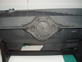

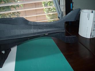

              Today I installed the port and starboard salon frames, and did some fill in around the outside of the frame as needed! I also cleaned up the bottom and top of the hull.

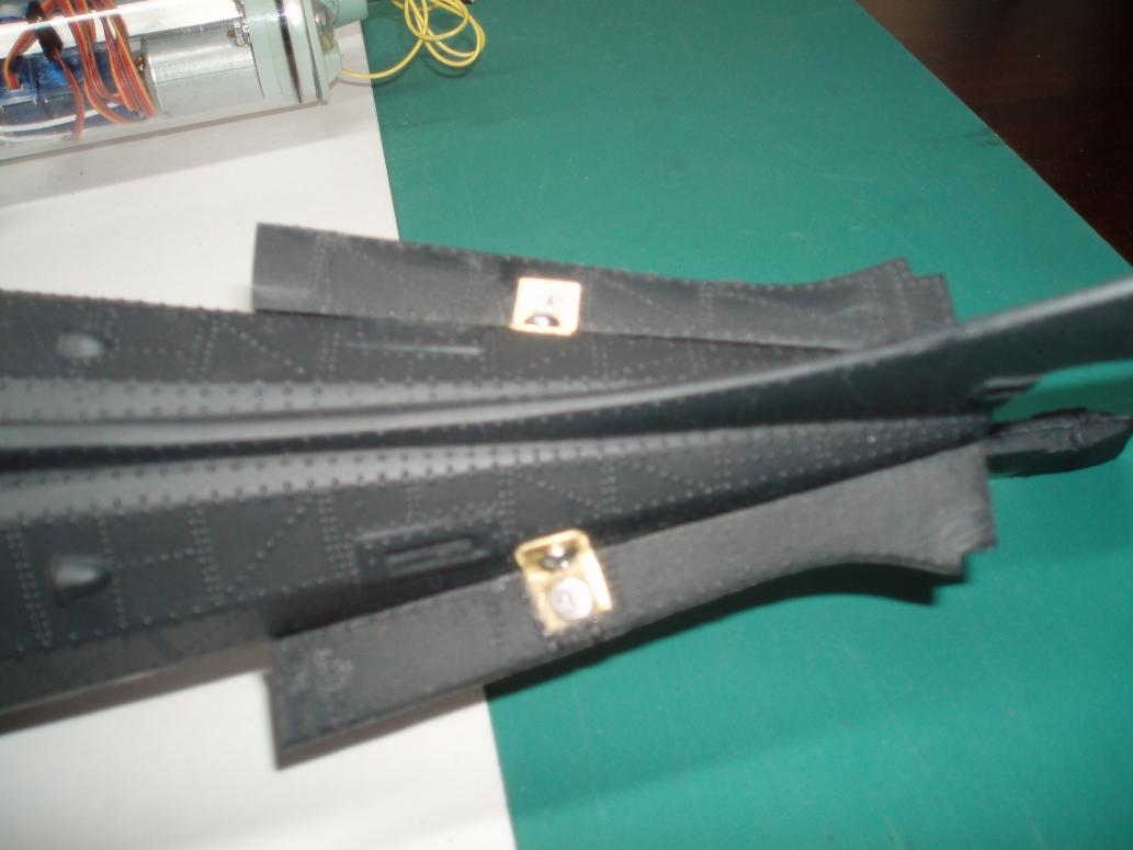

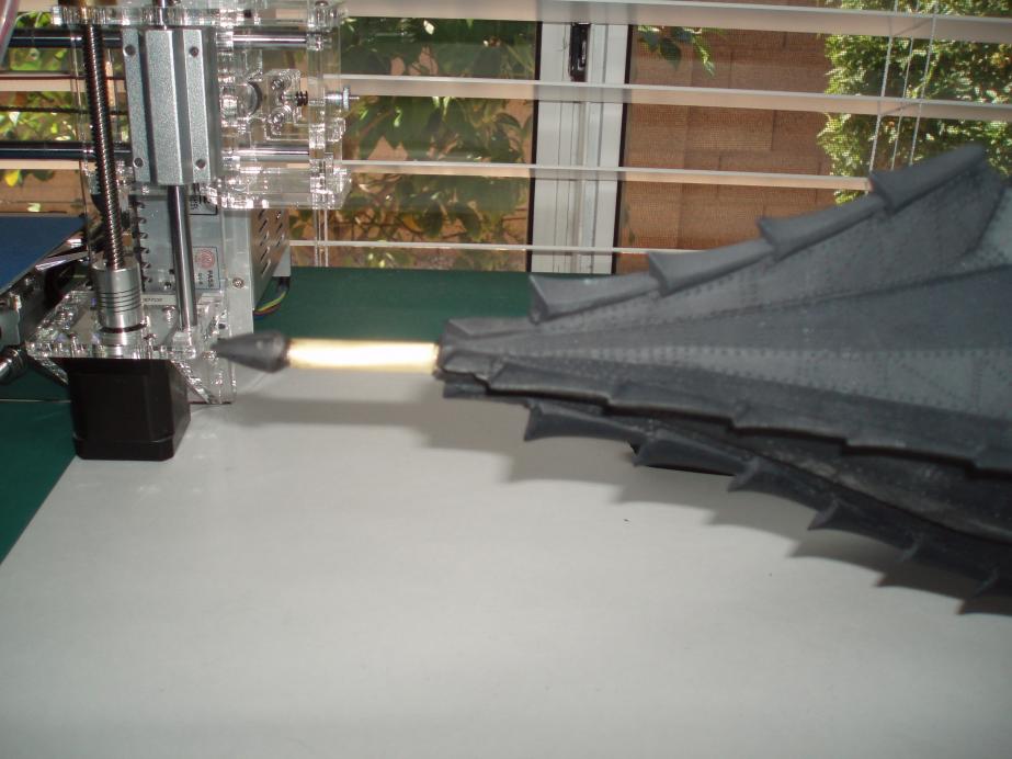

                  Today I worked on the stern of the boat, and notched out the area around the prop shaft exit. In order to install the prop shaft adaptor that will allow the prop to move up and down in a slight vertical movement to allow the boat to submerge and surface more effectively!
                  Click image for larger version  Name:	P4170003.jpg Views:	0 Size:	39.4 KB ID:	149084Click image for larger version  Name:	P4170004.jpg Views:	0 Size:	41.0 KB ID:	149085
                  There was some material removal to allow this fitting to be installed. If you go to Nautilus Drydocks you will see this installation and how it will operate on his YouTube!

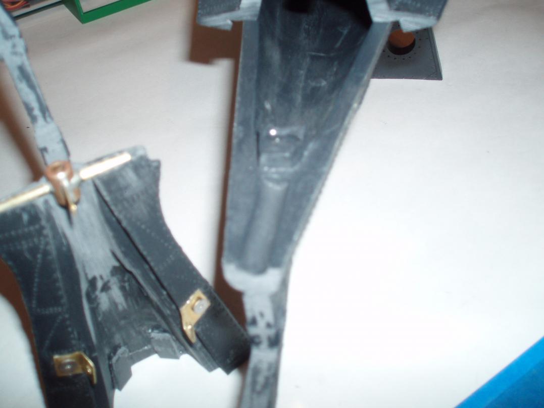

                      In order to install the prop shaft adaptor, I am going to have to remove more material from the bottom of the hull at the stern. This will allow the movement required for the shaft adaptor to work correctly!
ID:	149092Click image for larger version

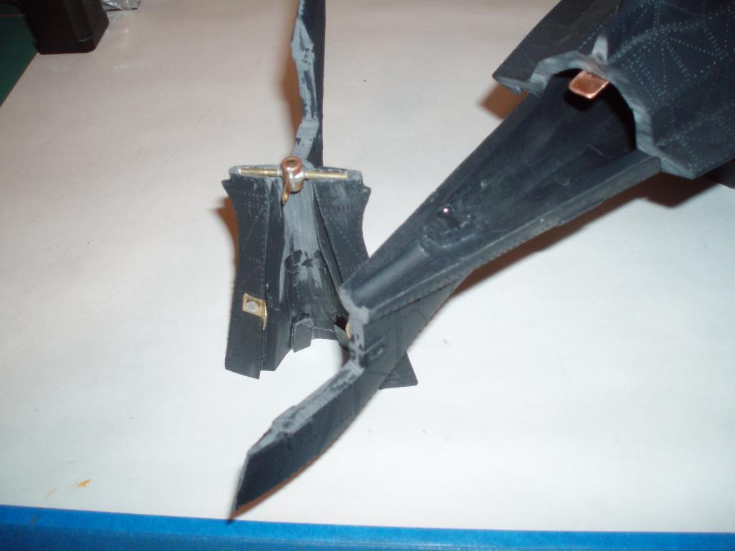

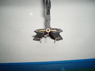

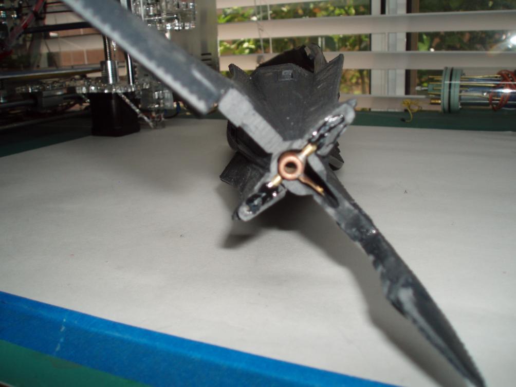

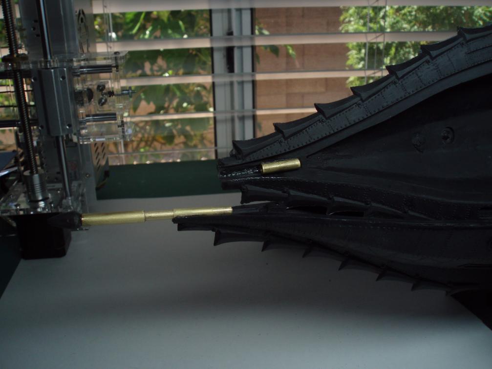

                              I have completed the stern prop shaft adaptor system on the upper hull and the lower hull!
ID:	149102Click image for larger version
                              As stated above, this stern prop shaft system will allow the prop shaft and prop to move in the vertical up and down.
                              I have really learned one thing about the Disney Nautilus build, there is a lot of cutting and material removal for the build! You just have to take your time, and have the tooling!
