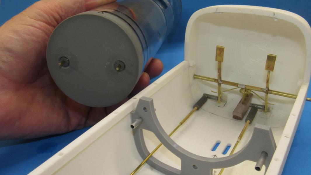

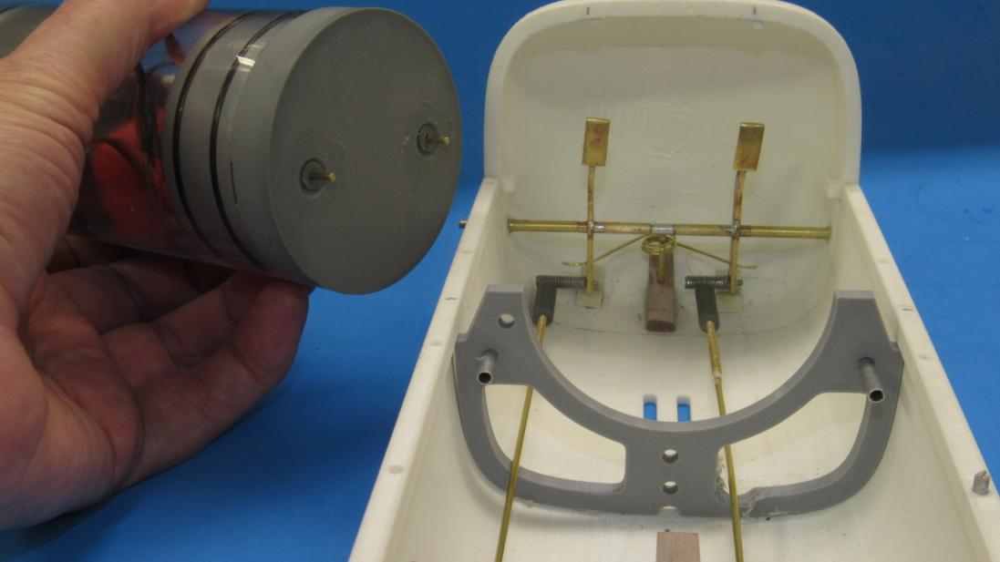

    A unique feature of this little r/c submarine is that the two servo outputs are at the front of the SubDriver, not the back. I'll have to device a pair of bell-cranks to translate motion back to the control surface pushrods. Tomorrow's task.
    Here I've marked out the location of the pivot rod that will pass through holes in the bow becoming the axil about which the two translating bell-cranks will rotate.

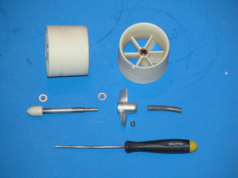

            For shafts 1/8 and 3/16 what threads go on those?
            I need to order threaded bushings.
            #6-32 and #10-24?

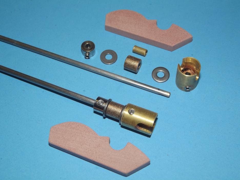

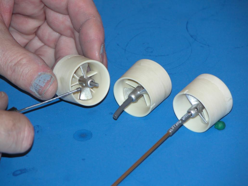

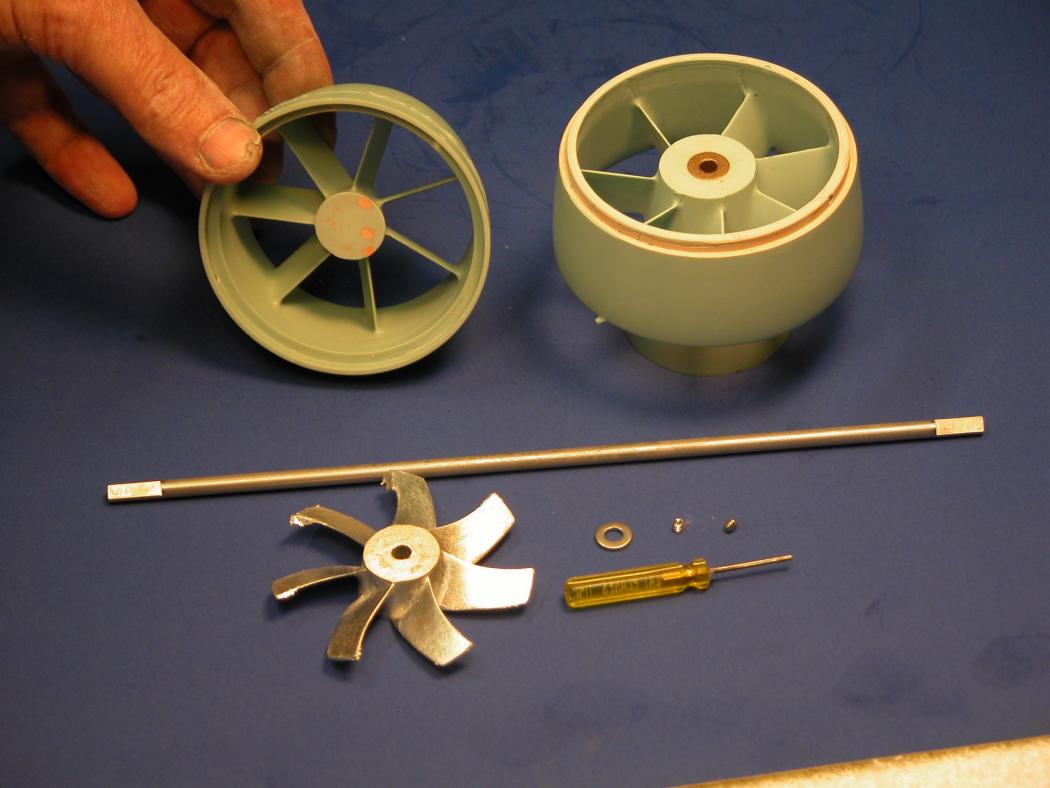

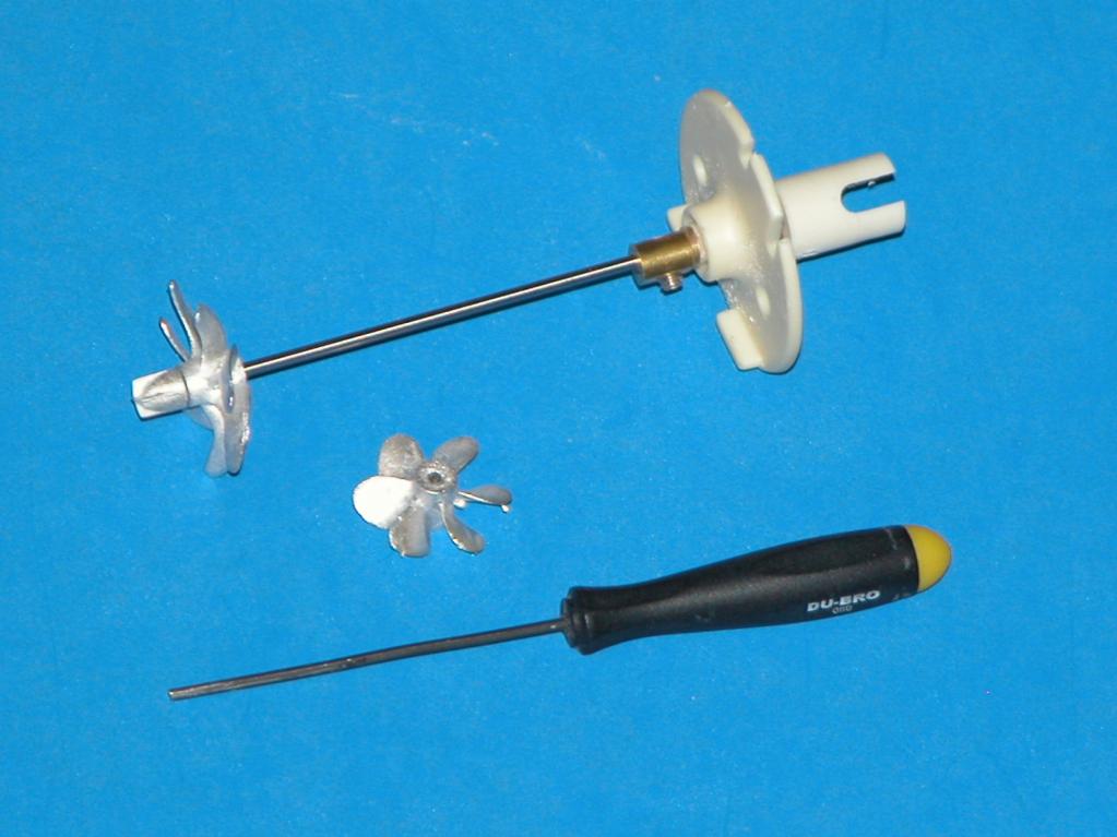

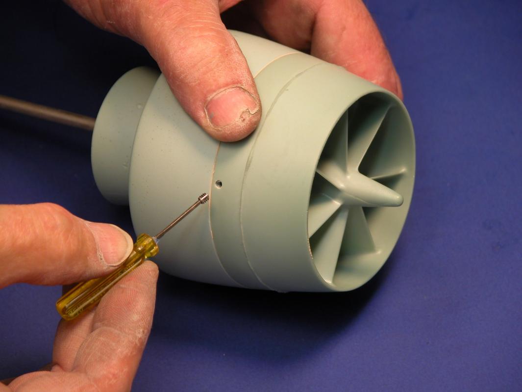

              Hey Bart,
              I don't thread those size shafts, I use set screws to make up items to them. I'll grind a flat at an end of the shaft that will receive a set-screw that secures the item (wheel-collar, propeller hub, or universal coupler) against axial and rotation with a tight fitting set-screw.
              If I were to thread these I would go with a 4-40 for the .025" shaft, and a 6-32 for the .137" shaft.

                  #413
                  Hey Bart,
                  Ok thks David, your way will result in better centering.....not everybody is able to cut a thread with a die.....most of them will end with a wobbling propeller.

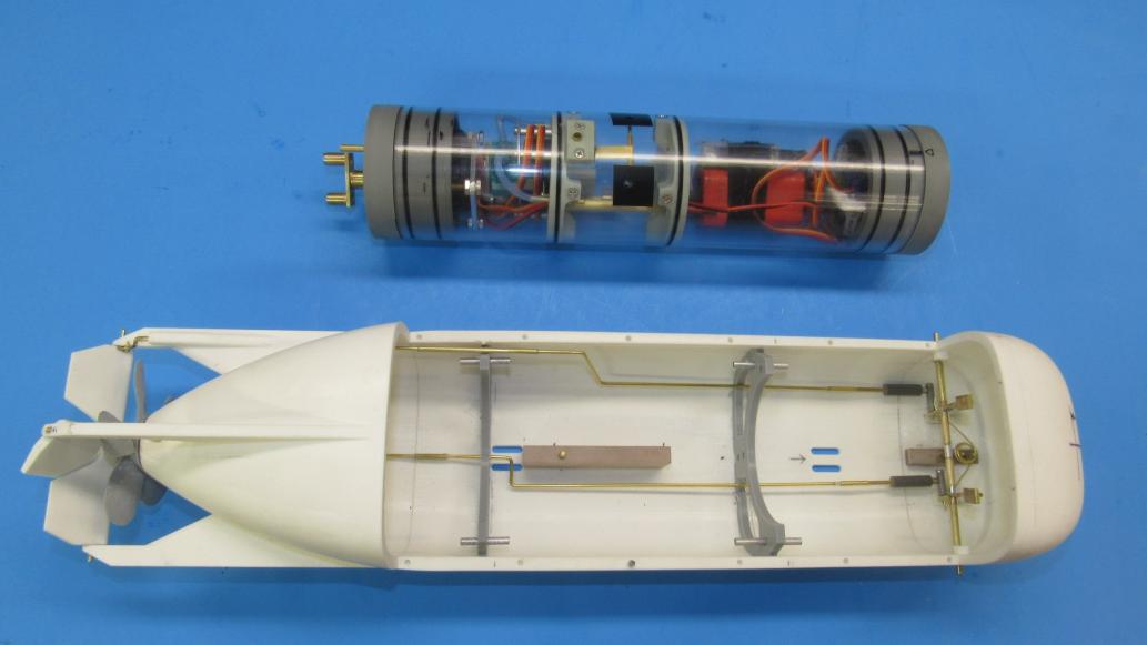

                          Anyway, What's the reason for forward location of the servos?

                            First I get this thing to work, later I finesse things to permit an open cockpit.
                            The tight confines between stern and after end of the SD precludes the traditional linkages and running gear coupling.

                              Is there positive connection between the servo push rods and the "pedals" on the dive planes and rudder control arms, or do they just abut against each other?
                              If its the latter, is there a spring that maintains tension on the pedal arms to move them back when the push rods retract back?
                                • 13982
                                #420
                                The SD's pushrod pushes against the top end of its bell-crank. The two bell-cranks share a common spring that pushes them at the bottom.
