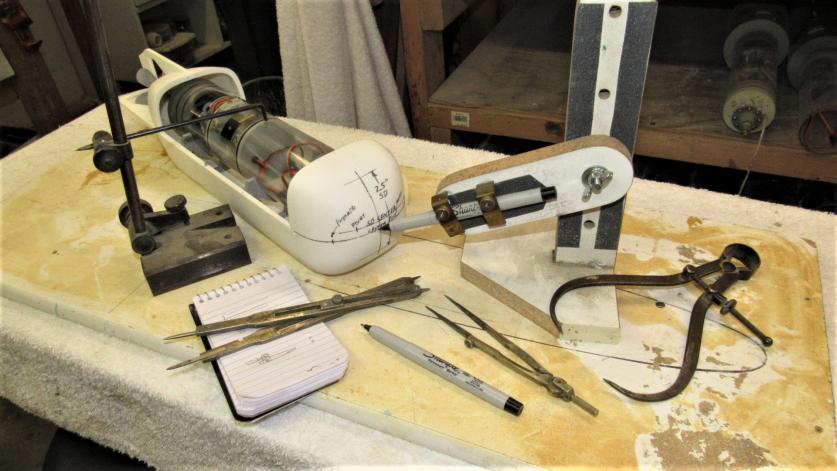

              Darrin Hataway has produced a 3D file of the SEAL's swimmer delivery vehicle, MK-8. It's a four-man, wet type conveyance used by the frogs to commute to and from 'work'.
              Darrin printed one up and sent it to me to evaluate for possible commercial sale. The hull and appendages are well formed. The fit is tight and part break-down is simple and well thought out. It's an easy kit to assemble.
              I built a custom SubDriver to fit -- that module providing the guidance, ballast, and propulsion needed to animate the eventual r/c submarine. Today's task was to work out the running gear and to mount the two principle control surfaces.

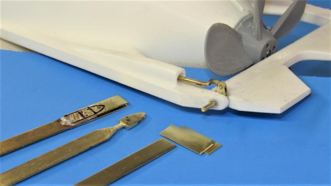

                              Here's a tease, pal:
ID:	143998Click image for larger version
ID:	143999Click image for larger version

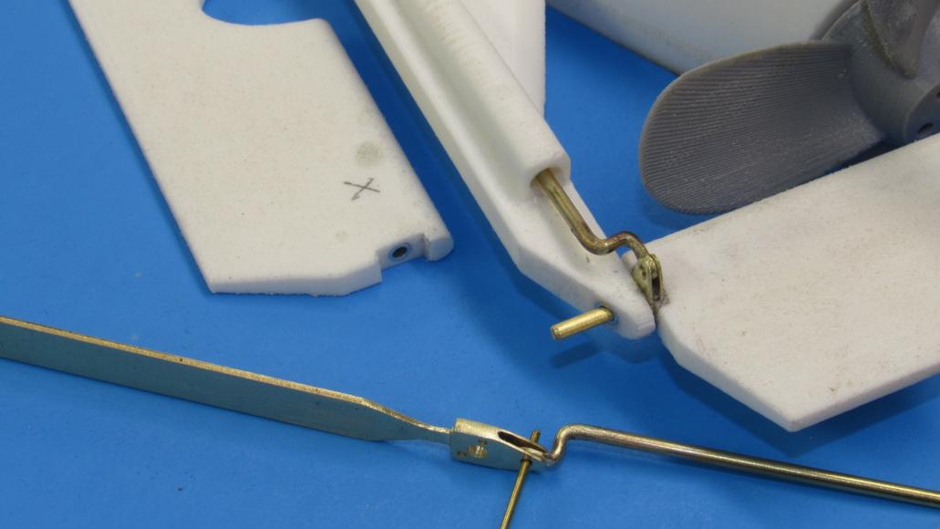

                              Alter your file to put those pushrods in line with the control horns so there's no Z-bend at the end where the clevis makes up to the horn.
