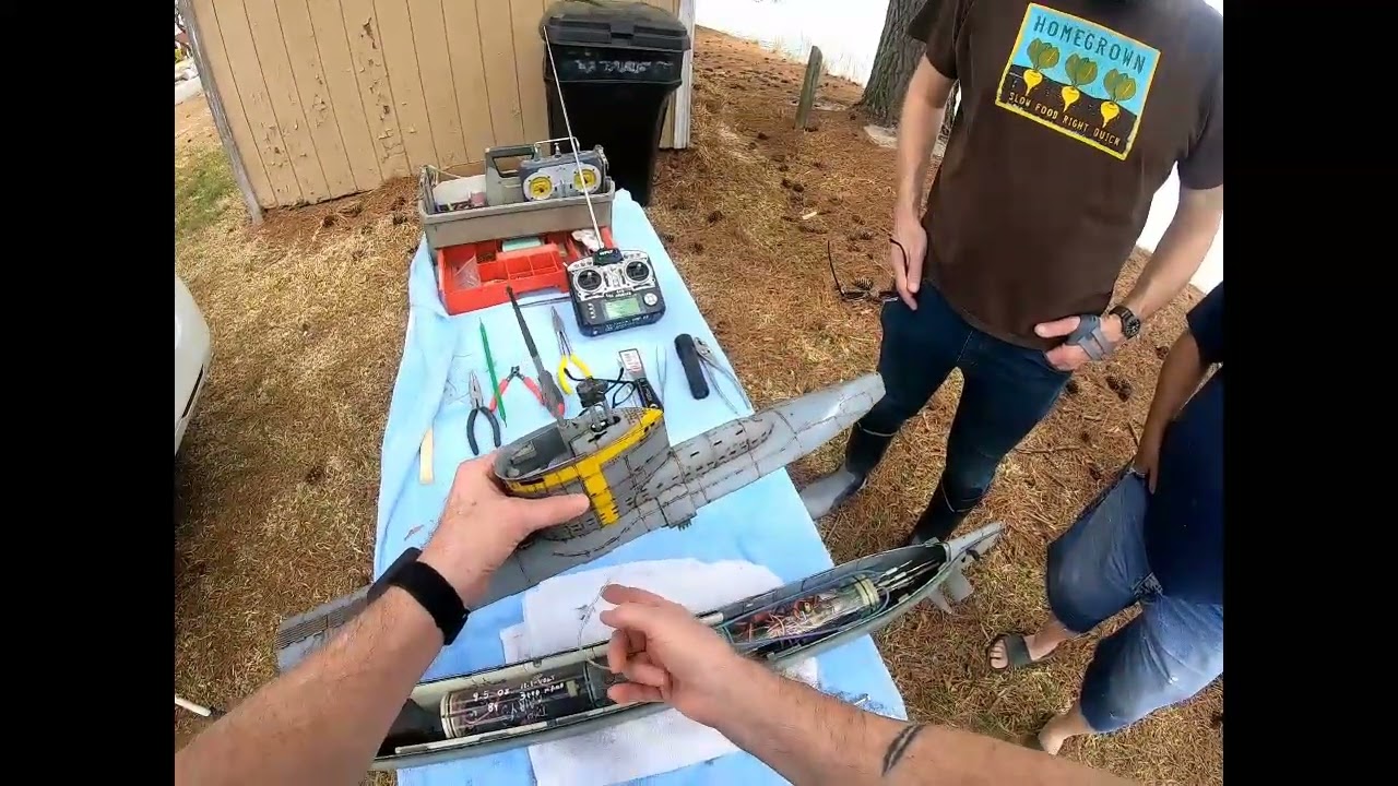

                          #2892
                          Looks like the gremlins are back. Didn't you have the same pitch problem in the past?
                            • 13982
                            #2893
                            This is either the fourth or third Bronco 1/35 Type-23 I've assembled and driven. And all of them misbehaved the same: wildly unstable in pitch once submerged. All had a well working angle-keeper, and at least two of them featured a depth-keeper as well. All had the longitudinal c.g. placed at the center of the hull.
                            Two days ago, I radically changed things by moving weight and WTC forward to place the c.g. about four inches forward of its previous position. This to place the c.g. well ahead of the likely center of pressure, making the boat dynamically stable about the yaw and pitch axis. This change (I hope) will permit the vehicle to 'weathercock' to the flow; getting away from this awful pitch oscillations that likely results from the c.g. and c.p. being too close together. I'm guessing that the c.p., shifting back and forth with each change of angle of attack transits ahead, then behind the c.g. with each pitch swing is the problem. I'm thinking that my type-23's are experiencing a form of the dreaded 'inertia coupling' phenomena some aircraft get into.

                              #2894
                              From a physicist perspective: Does your pitch control have an adjustable controller, i.e. the proportional part? Oscillations can be the result of the proportional part of a controller being set to high. If possible, make the controller less sensitive by reducing the proportional part.
                                • 13982
                                #2895
                                Thanks. If the current 'fix' does not work I'll vary the angle-keepers sensitivity, as you suggest. That should get out of any stern plane device induced ocillations by getting away of the boats natural frequency about that axis. Good stuff, sir.
