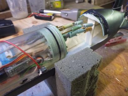

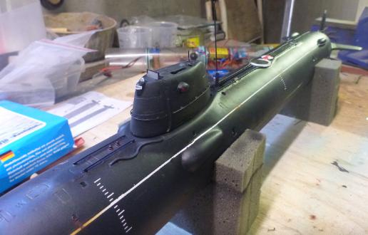

      Final fitting of all the bits and pieces and the rear safety rails.
ID:	112261Click image for larger version
        #63
        First trials in the water today.
          #64
          Dives OK but comes up arse first. More trimming required. Also has a ferocious torque roll at present.
