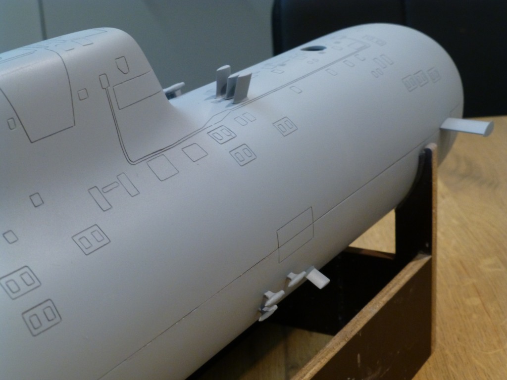

        #243

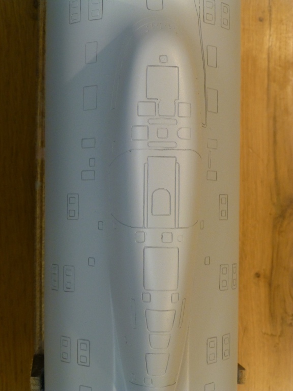

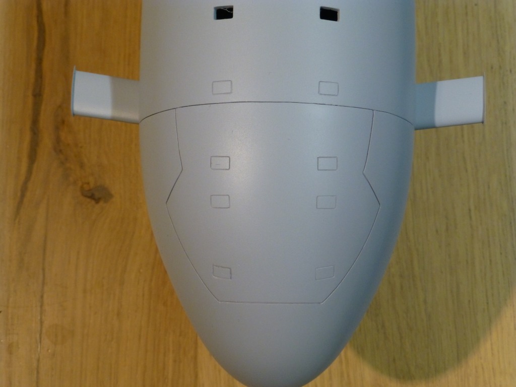

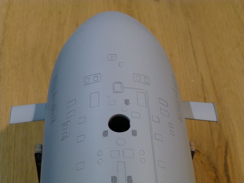

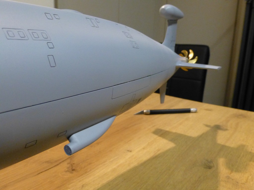

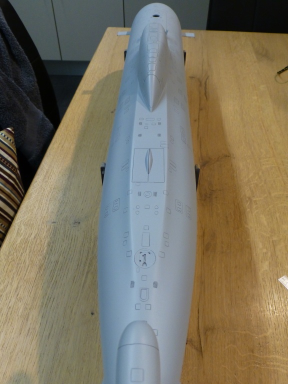

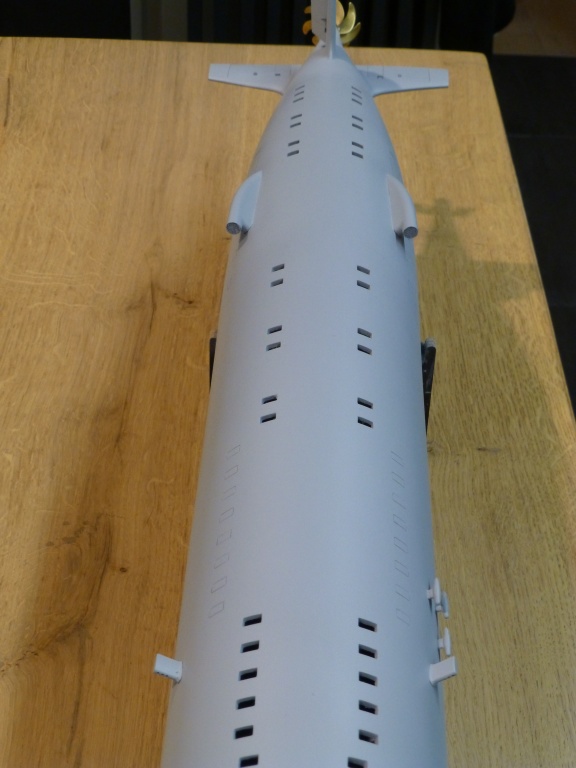

        With exeption of the railing and safe guard all parts are on.......next up is the transportation box and in water trimming.

          What an accurate and crisp job you did of the scribing. Oh, almost forgot ...
          ... I HATE YOU!

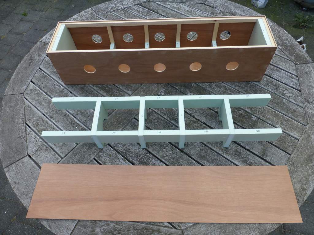

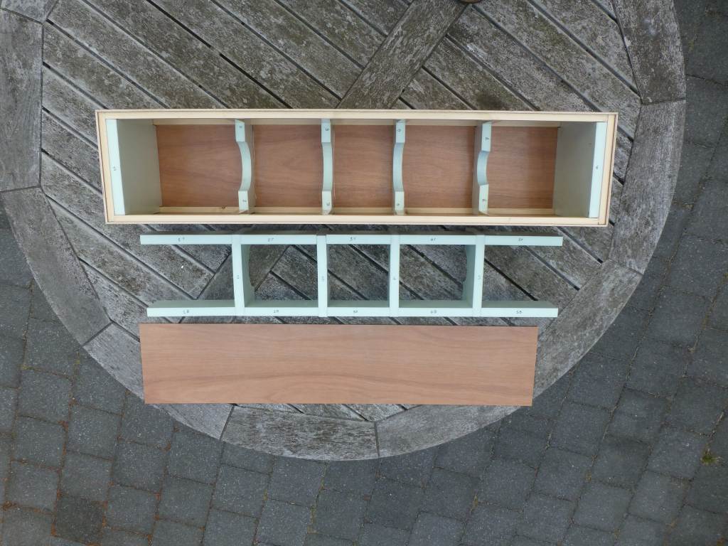

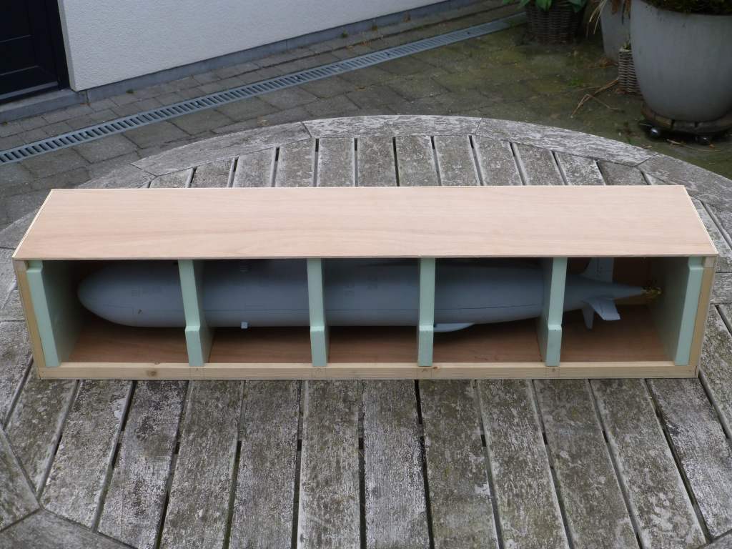

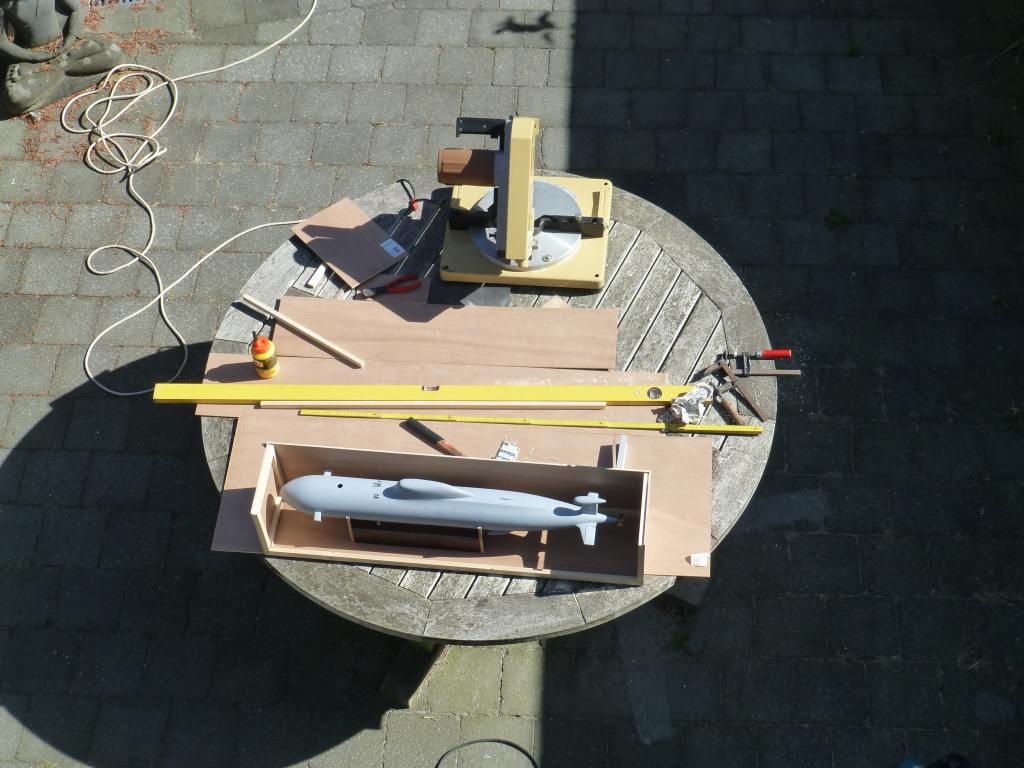

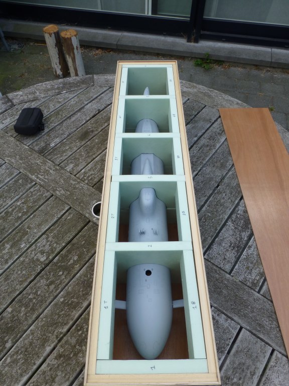

              WIP on the transportation box.......I made it almost exactly as per David's guideline I found on the forum (monkey see monkey do). http://forum.sub-driver.com/forum/ge...96-seawolf-kit post #4.

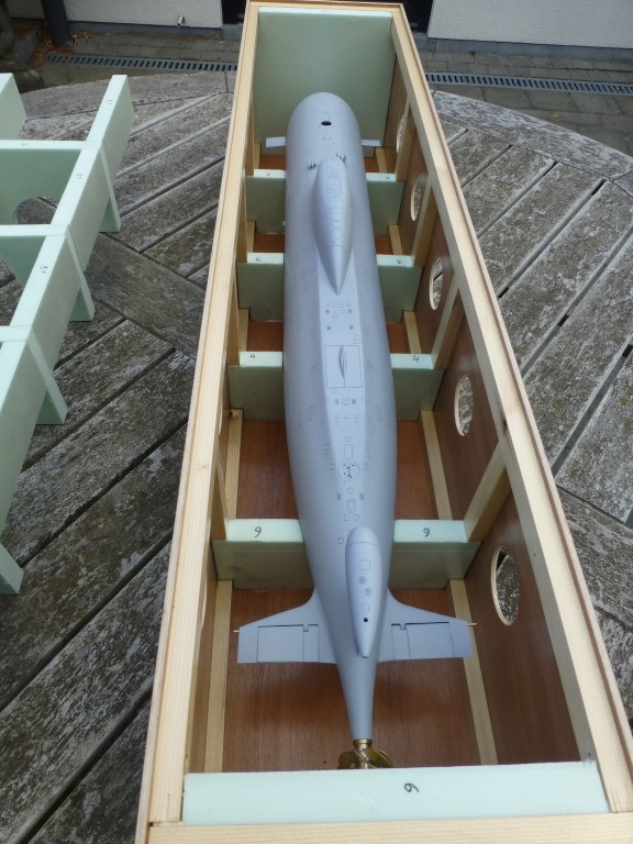

                #247

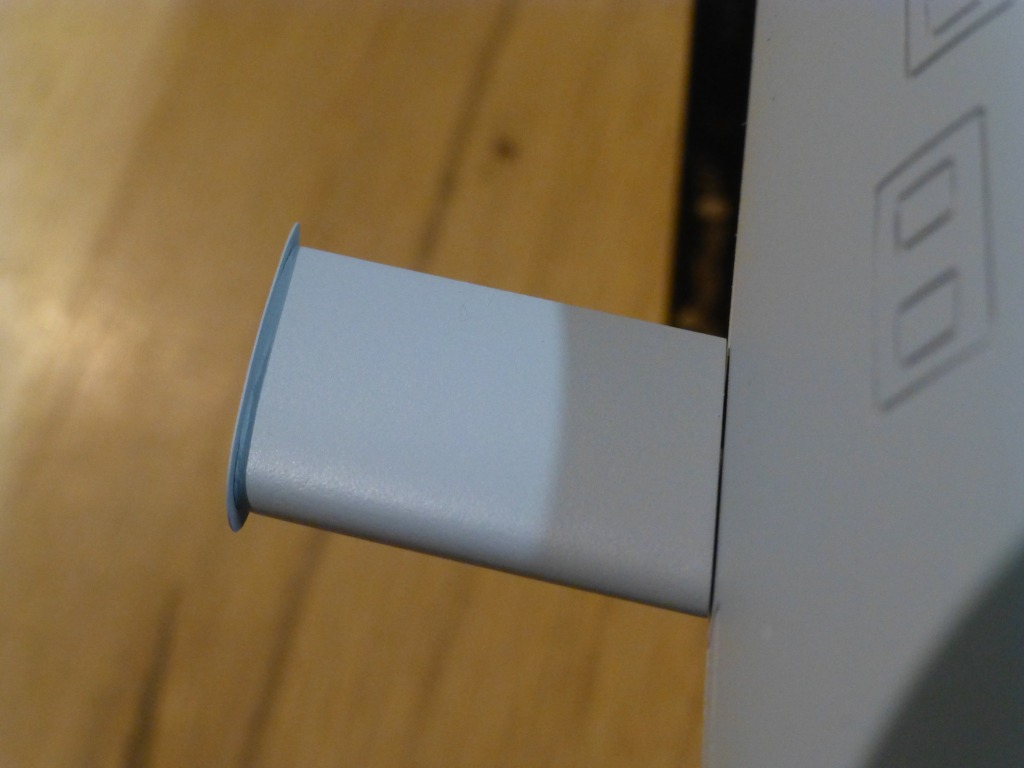

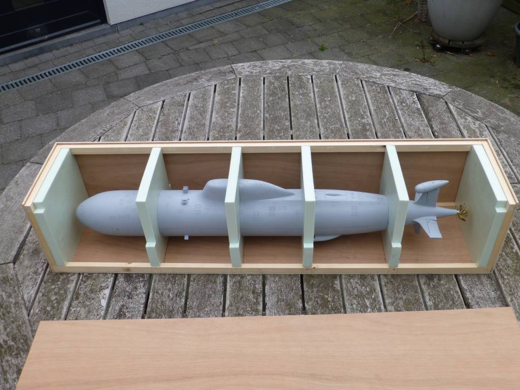

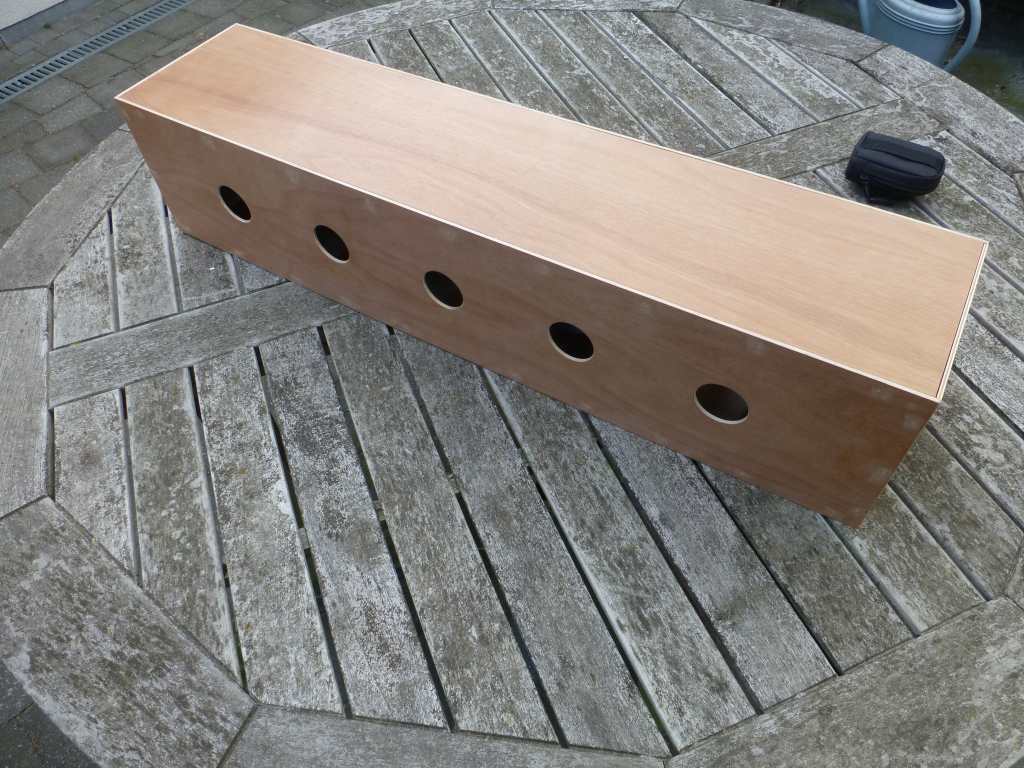

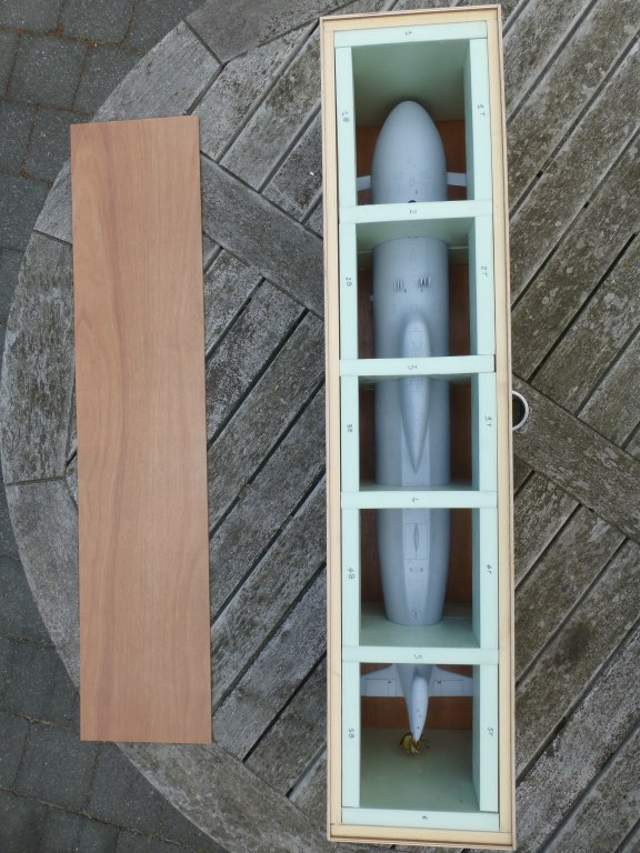

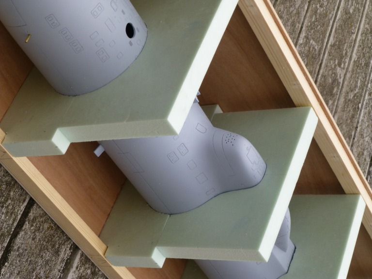

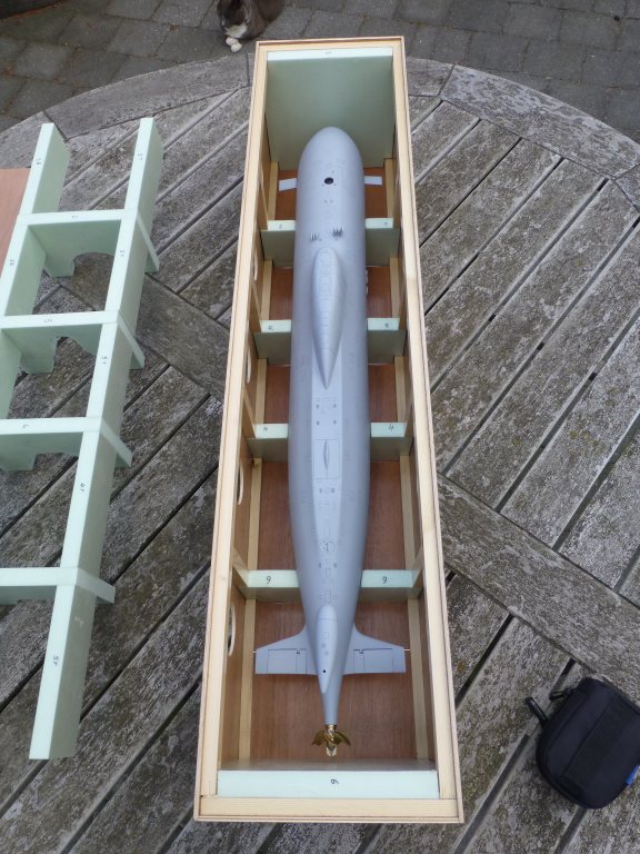

                Fabricated securing arrangement upper and lower hull
                Connected fwd dive planes
                Finished transportation box, every compartment is provided with his own vent holes

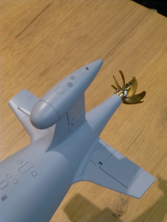

                Yes on the pictures the towed array pod is not in line with the centerline of the sub....don't worry she is not yet fixated.
                Will do some IW trimming this evening.
                Grtz,
                Bart

                  • 3758
                  #248
                  Bart,
                  You are a craftsman. From that outstanding Akula to the box it is being put in, you show a great ability that surpasses most of the RC submariners out there (myself included). You are an inspiration.
                  Peace,
                  tom

                              was almost perfect without doing anything......her ass was slightly to light......she was floating on the towed array pod, I have to make the towed array pod free flooding…..good thing I didn’t glued the sucker in place yet.

                                Pod is free flooding now.....in ballast trim is good....although I'm not able to blow the ballast tank empty.....will do some investigation by elimination of possibilities.
