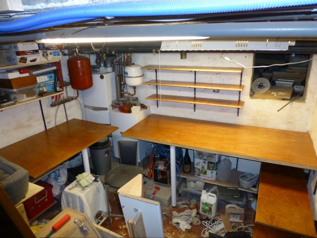

                        It has been awhile, busy times @ work, awaiting spare parts, carry out jobs around the house. yeah you are wright full of excuses to cover up I was just sitting on my butt doing nothing. I started to reorganize my workshop/basement. Installing new shelfs fabricating new worktables. I tried and managed to get the most out of the small place. Some more varnishing and boxing up to do and I'm ready to go. Work in progress.

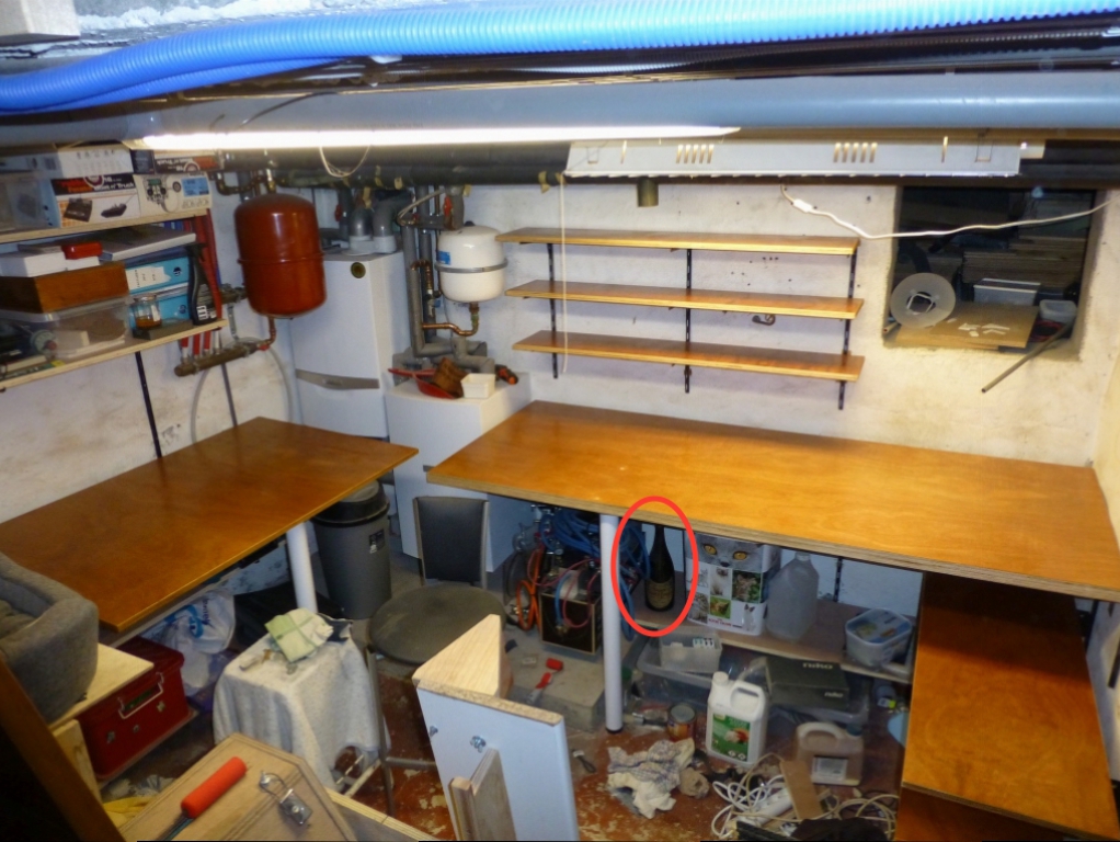

                          #267
                          Hummmmmm. I think I have spotted the reason for your quiteness of late!

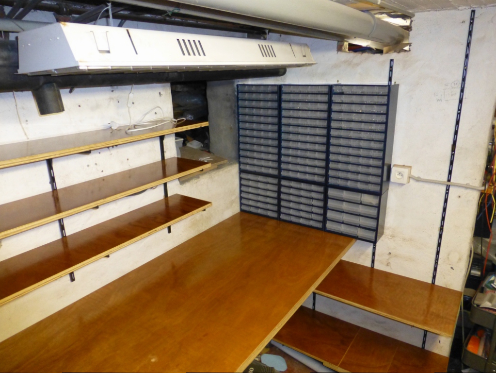

                                #270
                                The small drawer organizers arrived today....it starting to look like a real workshop.
                                The 300m³/hr (175 CMF) extraction range hood will be ordered tomorrow.
                                Grtz,
                                Bart
