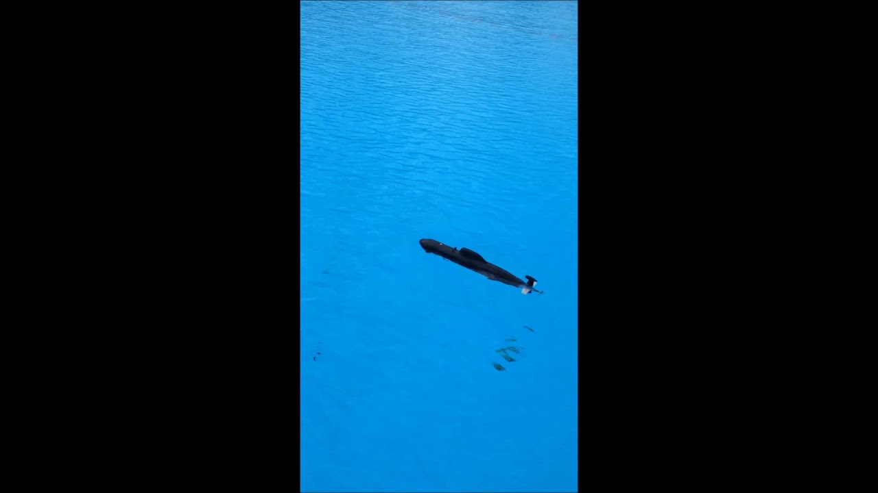

    It's not a big issue Andy, it’s just something I must keep in mind when making props in the future. If you have a look @ the pictures of my prop you will see the position of the blade tip is quite far aft. I was expecting it would give quite a strong rotating moment to the sub, no surprise here.
    Probably I will make a few morevariants to see which one works best.
    grtz,
    Bart

    Nice work. I'm surprised the prop is causing you big issues. The pitch looks a bit on the high side for a single screw, but not excessive. Increasing the weight of the boat can help with torque roll to some extent.
    A good pitch to diameter ratio for single screw subs with large multi-blade props is between 0.5-1. Raboesch scimitar props are around 1:1 and they work very well, but as your boat is a wet hull it may benefit from something even lighter in pitch, e.g. 0.8.

    Today it was the first time I took command of a sub.
    All went well, she sailed and dived…and came up.
    As a full time noob I pressed the time-lapse button of my phone recording the dived part, so that’s nice to see….I’m sorry for that.
    Observations made:
    • I had the boat trimmed perfectly. Dived the tower sits 5-10mm out of the water.
    • Not a drop of water was ascertained in the SD.
    • She turned like the real one…..awful, horrendous.
    • At 1/3 of throttle she was sailing realistically (you can see it in the video).
    • The fwd dive planes are a little too small (they are on scale) she dives but only at full throw of the stick and I need to help by trimming the rear dive planes to bring her ass up. Once under water she keeps her depth like a pro.
    • The pitch of the prop is too high, when I make my next prop I need to bring the pitch back gradually toward the blade tip. The rotating moment of the prop is to big now especially when going ahead from ‘dead in the water’. The speed of the sub does not increase from 50% to full, this is also an indication the pitch is to high, the prop needs to be flatter.
    • The magnetic pushrod connectors sometimes disconnect when she sails astern with rudder hard to PS.
    All the a.m. are minor things and probably I will not fix them, most of them are due to the fact that I built her scale wise, and I want to keep her that way.
    Grtz,
    Bart
